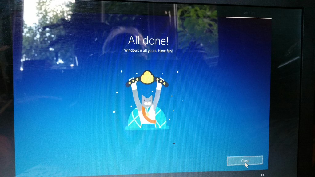

It finally finished at 6.35 pm that's nearly 4 and a half hours plus last night.
Then I get this jolly sign 😕 😡.
Luckily I'm not running a business!!

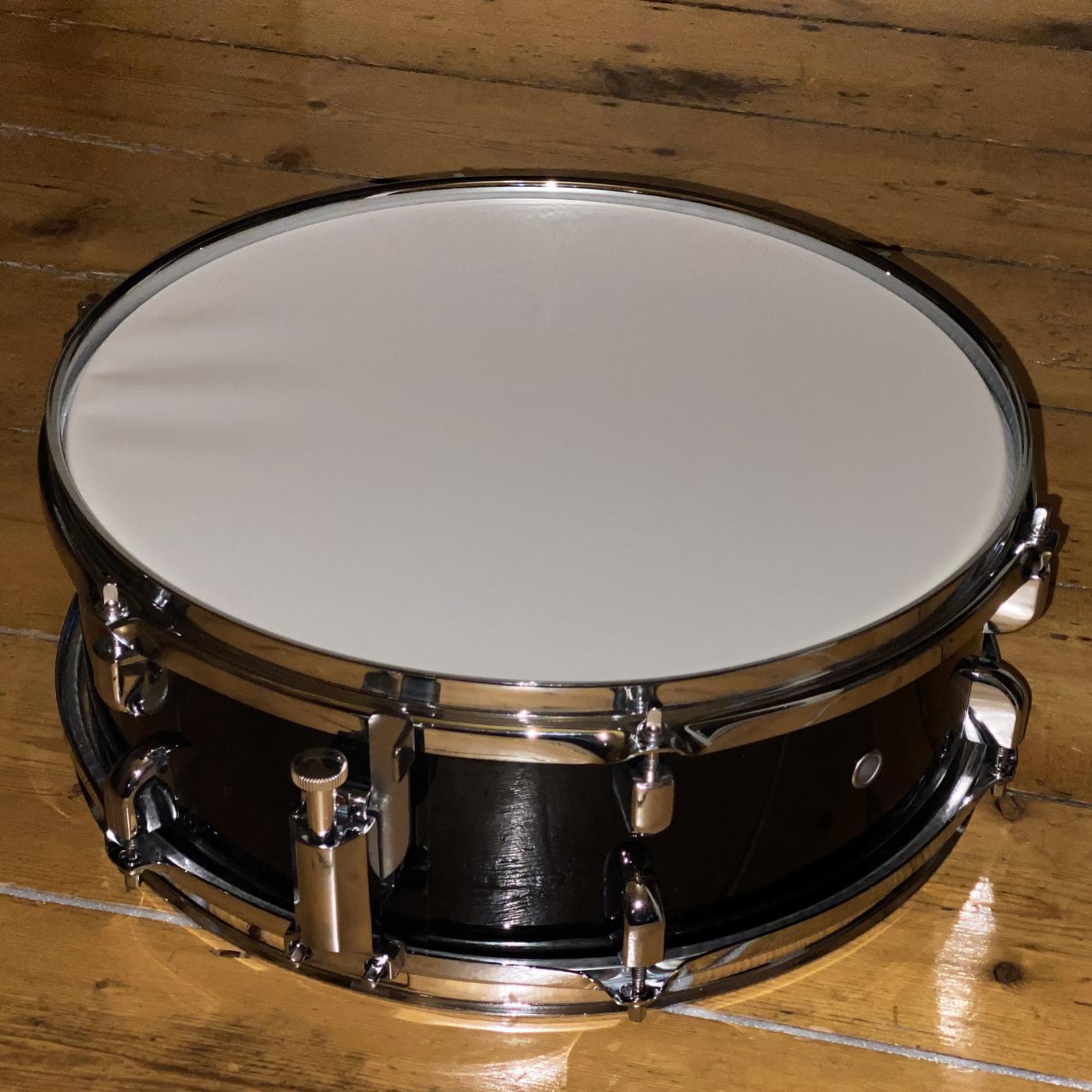

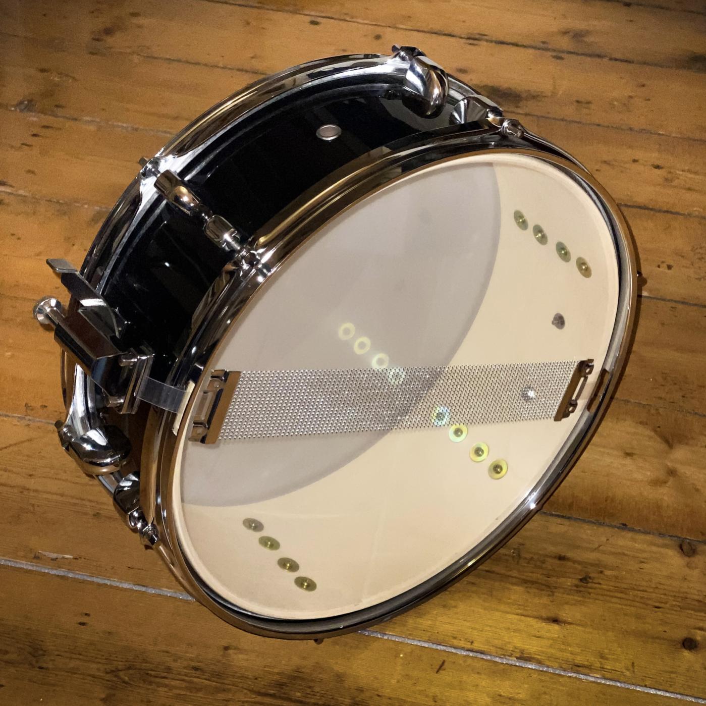

I bought a while ago a snare drum like this. I intend to cut in half and experiment with some exciters. For an odd reason it is still in the box, but in about a week or so I'll have time and space to dedicate myself to the DML cause.
On the same line, another musical instrument could be a 12" tambour .
This is the snare drum I just unboxed. The drum heads should be identical but they can be replaced any time, there are are many options and materials. The nice thing is that the heads are tunable.

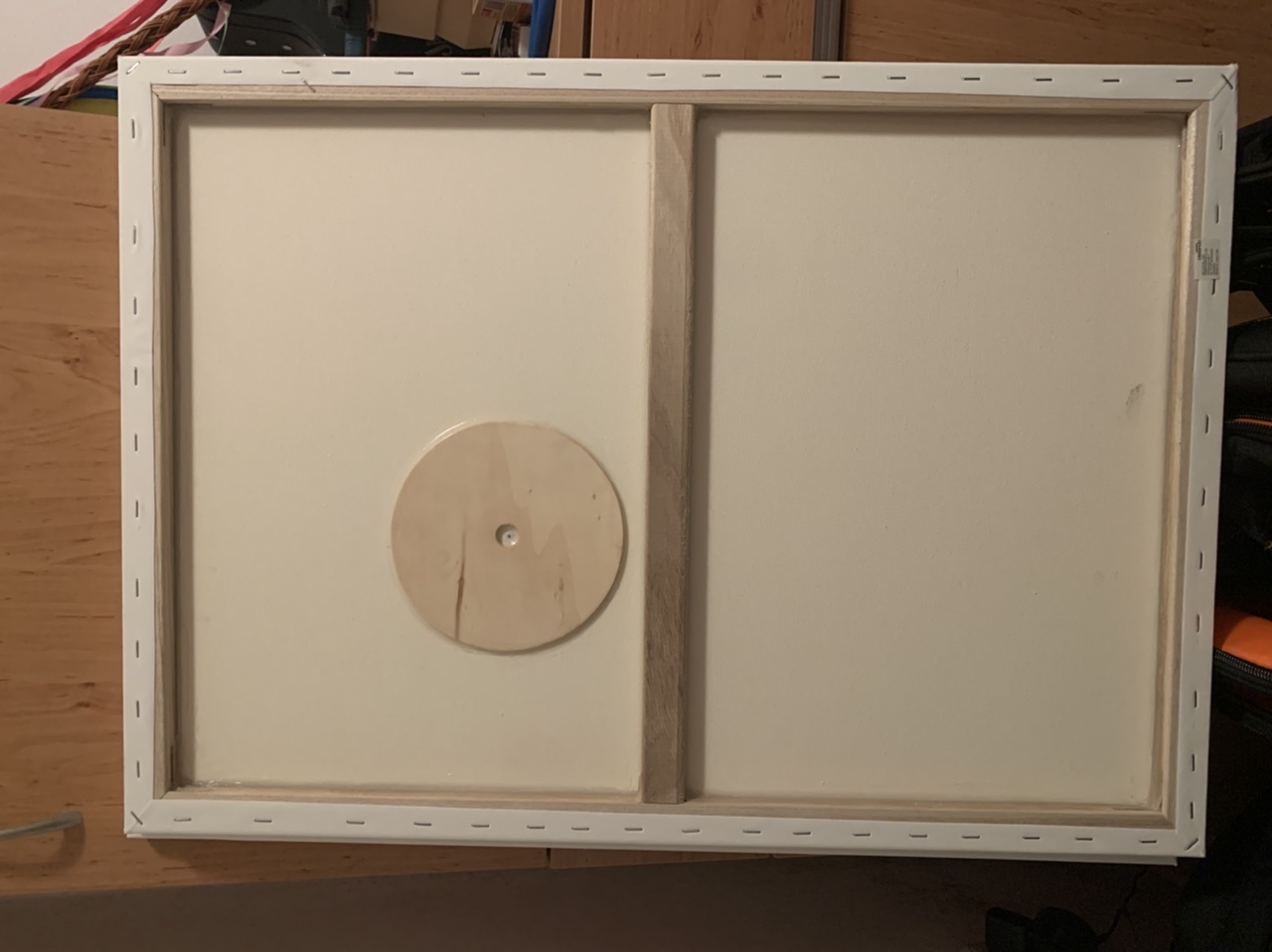

These are mine - work in progress - ca 70 x 50 cm with ca 15 cm diameter circle. The bar in the middle prevented center placement, so I chose some random location. Glued with transparent silicone and a silicone bead around the whole frame. The circle should be ideally in the center of the canvas and the hole was suggested by someone a few posts back.
Edit - I yet have to cut the spine for the transducer - it will be glued to it not to put any load on the canvas.
