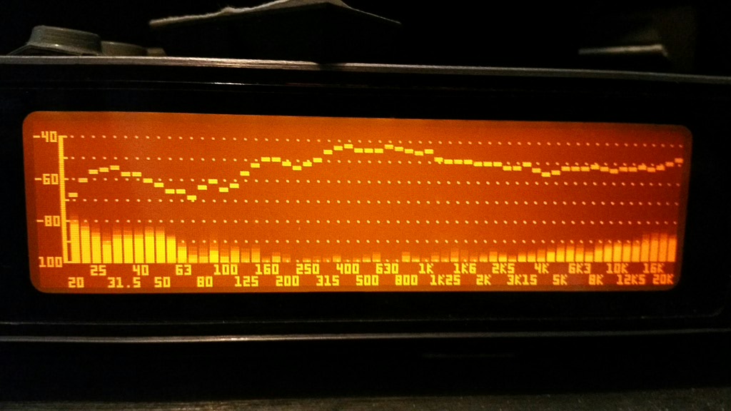

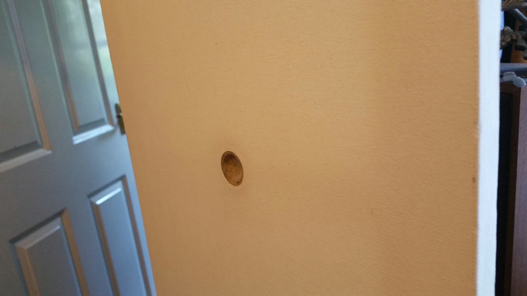

I tried to tap one in to the frame but it was too long ,so I'll have to saw it down a bit.
While doing this I forgot about the dome😱
I now have a concave dust cover come tweeter .
I've drilled a hole at the back of the spine so I can try and push it back again, but the frequency response is unchanged ,so as long as it does not produce bad sounds like the harder materials , it could stay this way,we shall see.
Picture of concave and response.
Steve.

Here's some pictures .
The first is the art panel now with a coat of 50x50 pva on the front, not much change, I hoped it would shink a little more.
The second is the same panel with some wood pushed under the fame to tighten it up a bit.
The response in the 25hz has moved up to 40hz, and filled in the dips up to 125hz , this was at 12inches of course .
Still very weak below 125 hz.
The third picture is of the 6x9 inch veneer panel, very similar to the art panel..
Both OK above 125hz but the in room response of the veneer panel drops a little more so would xo about 150 to 160 .
Steve.
