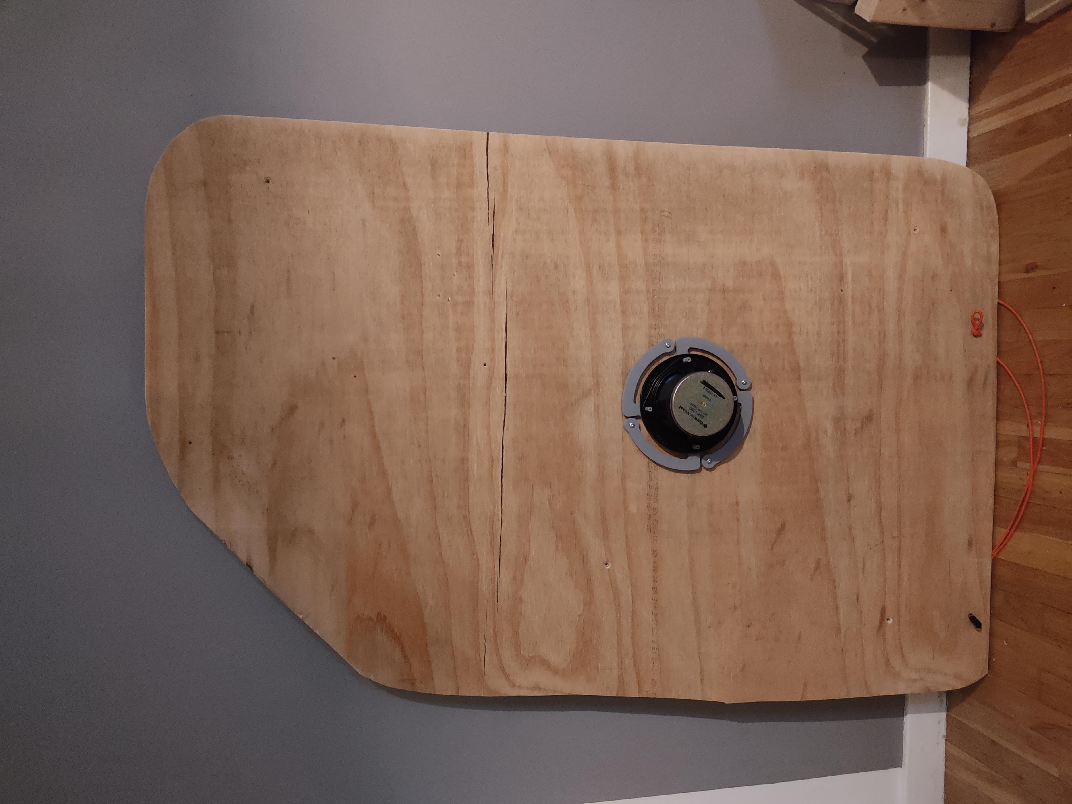

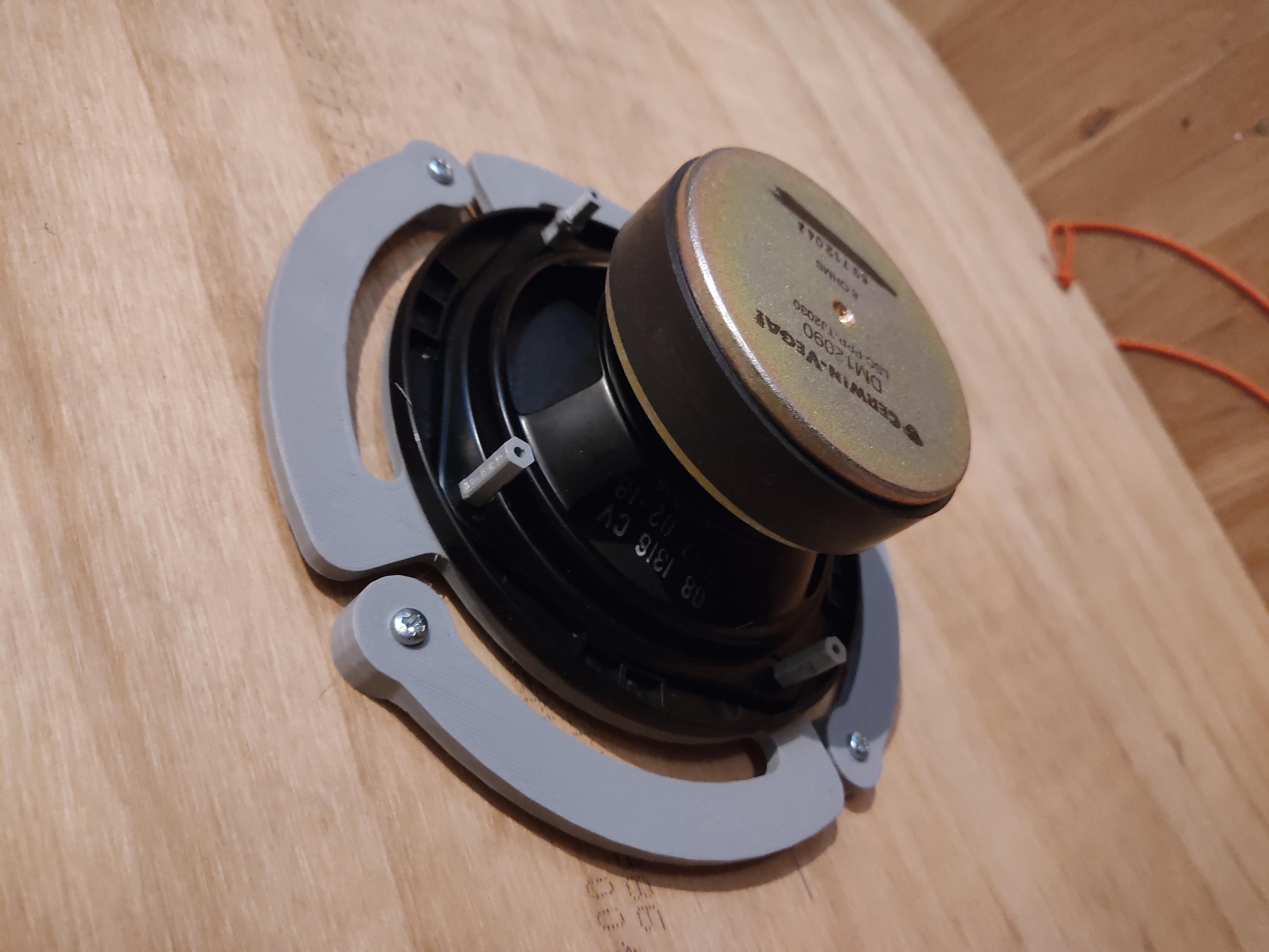

After seeing the videos by Tech ingredients on youtube and reading here I wanted to try to build a DML speaker of my own. Initially I planned to buy an exciter and suitable material for the panel.
However I had the neccesary materials on hand to make a first attempt.
I got some spare 12mm plywood. Approx 120cm X 96cm so I used that.
The driver was placed 2/5 from each side of the panel.
I got a spare Cerwin Vega DM12090 midrange driver from a Cerwin Vega E312 speaker.
I 3d printed an 28mm adapter that i JB welded to the voice coil so that it could touch the plywood and a hole were drilled to allow for a m4 screw to pass through and attach to a nut and washer on the back side.
I 3d printed a flexible attachment to fix the speaker to the plywood.

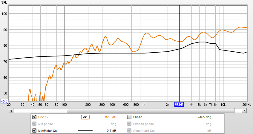

I took a frequency sweep measurement with REW of the driver in its original enclosure to compare to the DML speaker. I used a Rode NT-USB mic with its calibration curve entered to REW.
Unfortunately I forgot to turn off loudness on my reciever prior to the measurement so I left it on for all measurements, the comparison is the most intresting.

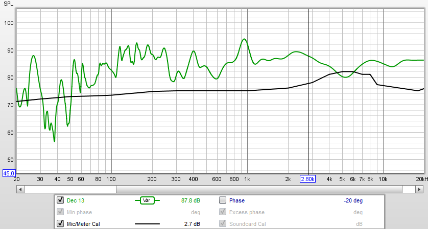

I also measured the DML speaker with REW
I tried to cut the width of the board to see the change in frequency response, it shifted the lowest frequency higher in the range.
For listening I'd say they sound fantastic compared to the midrange driver alone (not using the woofer or tweeter of the E312 speaker).
Initial opinions on the result, my reference is Dali 606 floorstanding speakers. The reciever used was Sankyo SRC 4040.
DML has some advantages in terms of sound quality. My first impression is that the sound is very clear and less messy.
However
Bass is completely lacking, I need to use loudness and max out the bass to get any bass.
It's not very loud, at max volume before distortion it's not enough to annoy any neighbours.
So this DML has an upper hand in some terms, I'm curious if there is more potential to meet the requirements as a main home system.
This was a quick and fun first try.
I suspect based on looking at the design of Dayton audio exciters that the arms on the attachment I designed was a bit thick. (5mm).
I do have a bass driver from a Sony ss A505 speaker I could try next to see if the base response could improve. This is because I'm wondering what part of the speaker influences the low range response. I think the effects of the cone is eliminated when a driver is converted to an exciter, so the motor, spider and surround should determine the response.
However perhaps the Sony woofer would do better in this respect.

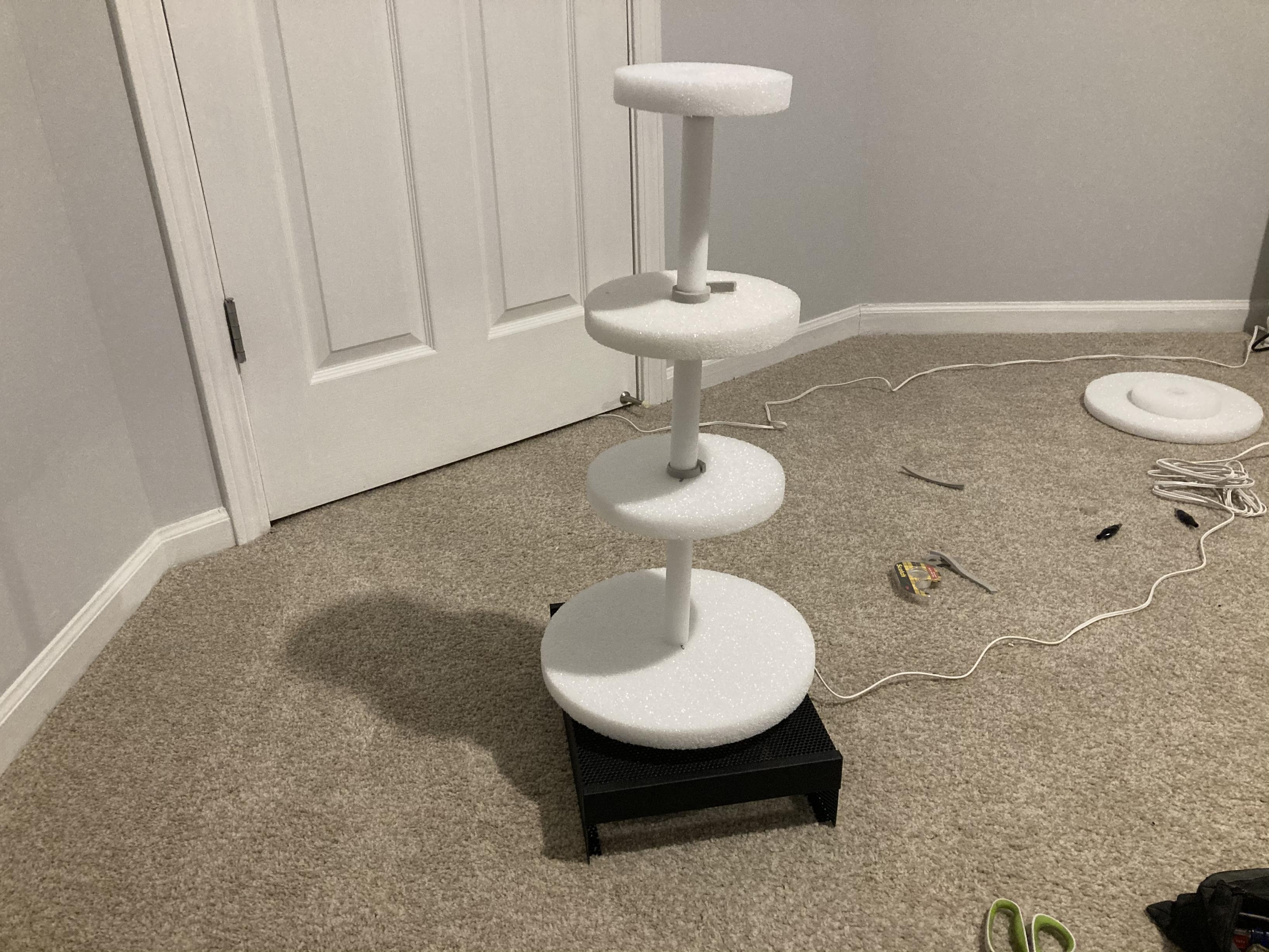

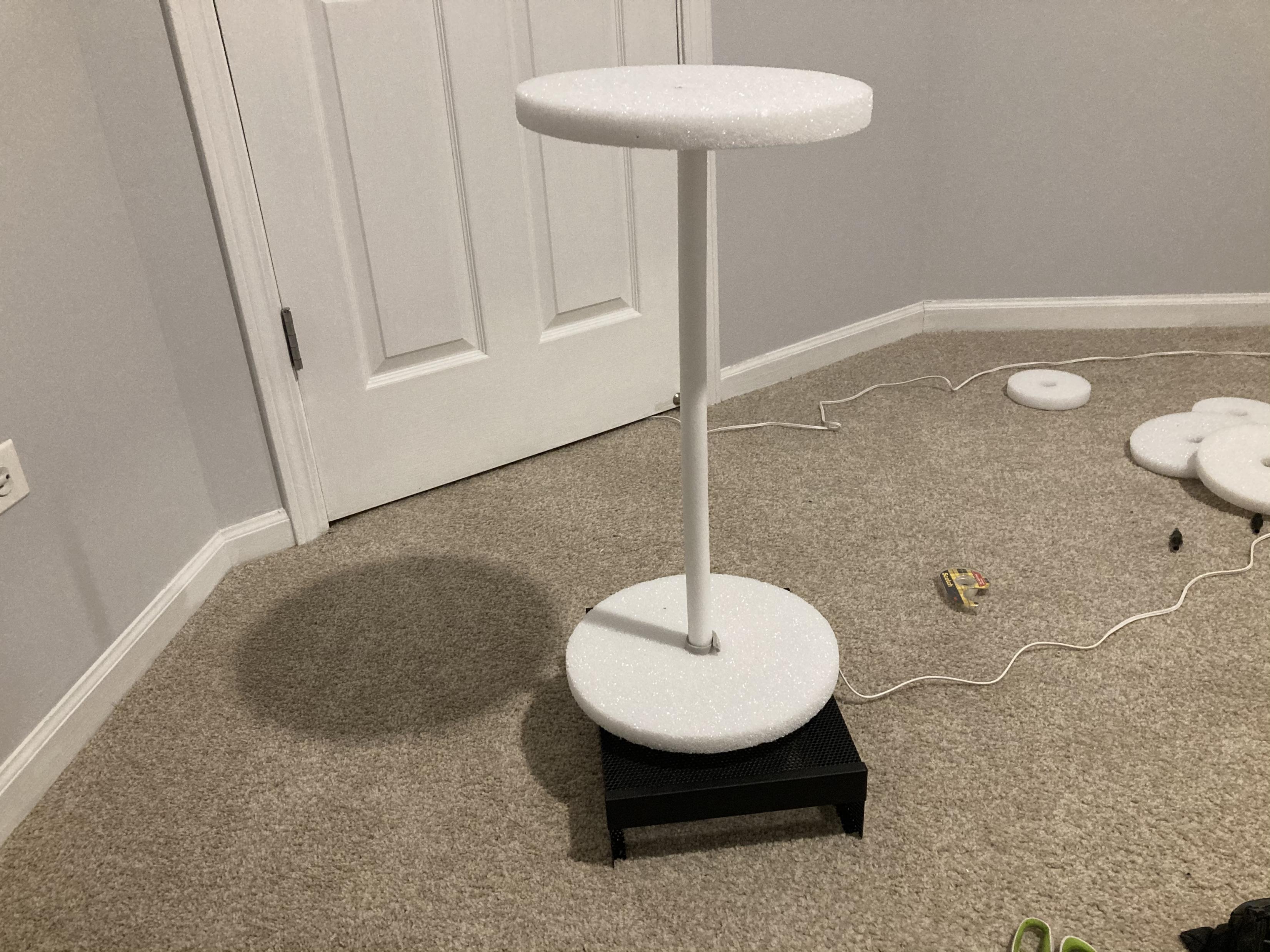

I built the PGodas. No scientific testing whatsoever was done though. My ears confirmed some ideas and fears. No matter how many discs I add, there just isn’t excellent bass with exciters. In this case I used Visaton exciters, which unfortunately look to be made in China. I also think that matching disc sizes creates more interaction nulls/peaks. They sound like speakers for sure, not super great though. They do solve my pet peeve about exciters, the super brightness is tamed.
These get top heavy quick even when using styrofoam. Despite the lightweight of material, a lot of leverage is created by the vertical length and double sided tape doesn’t want to hold while doing temporary testing. I think this might be worth pursuing for someone else. I only want full-range speakers—no subs.

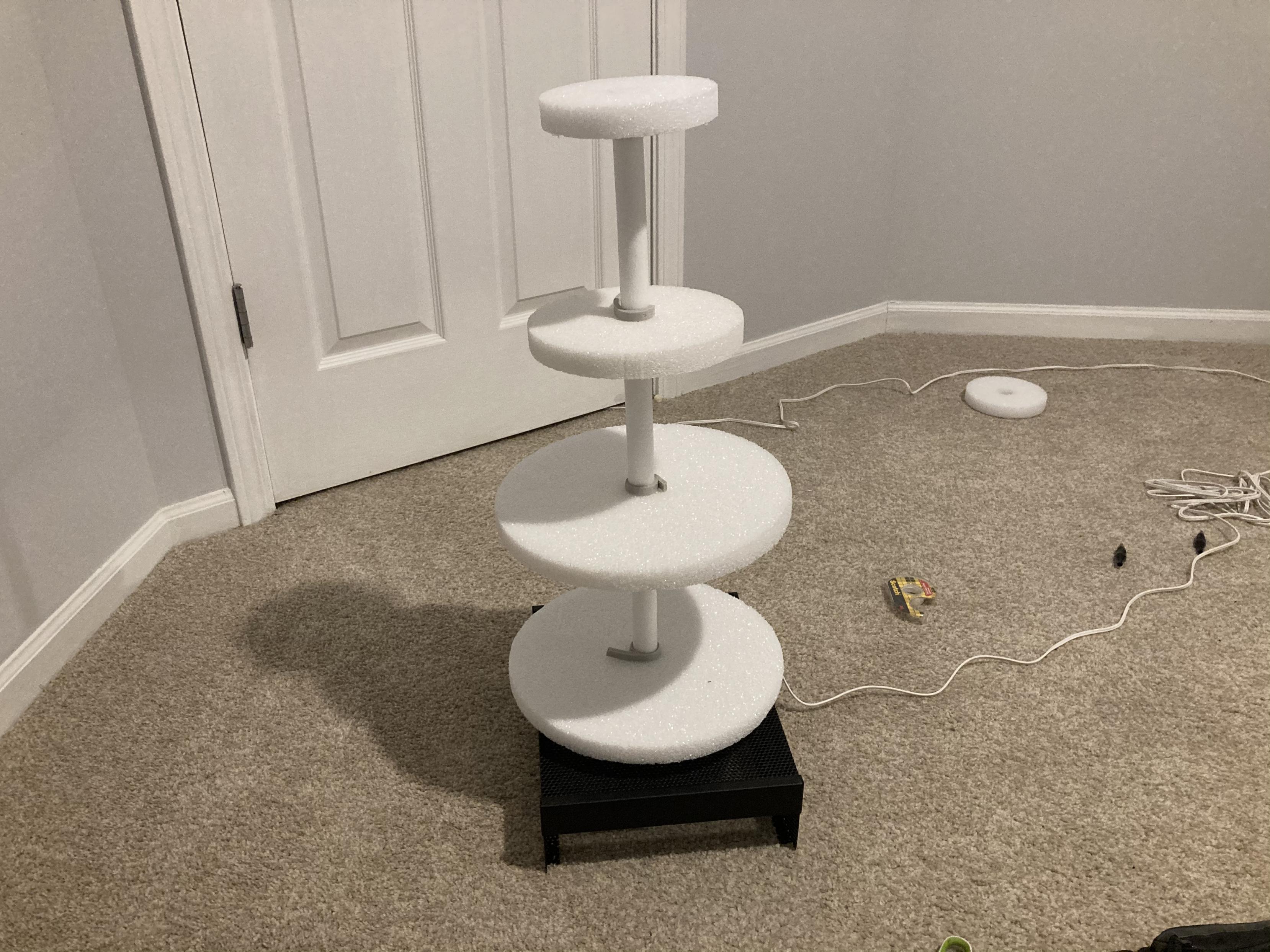

What can a pagoda bring in to distributed mode? The distributed mode happens in one plane, or both sides of the material used, so what would the different planes placed at different levels give? Does the pvc tube transfer the vibrations to the next plane/material? Or, is it what you expected?
What happens, if you put all the circles on top of each other?

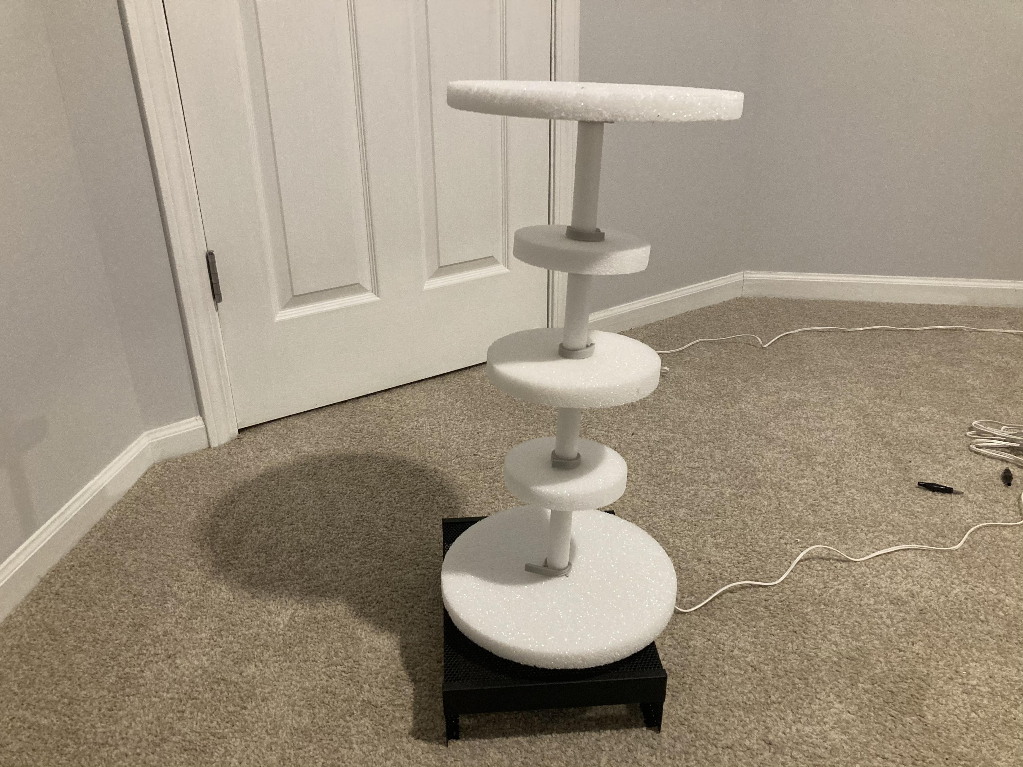

It’s pretty much what I expected. It does a capable job of producing music sans bass. For $60ish, can you buy or build a better speaker... I don’t know. Magnepan will not be going out of business as a result of these.
Multiple large discs seemed to have more peaks and dips. Some configurations had more separation, etc.. But nothing was horrendous or tremendous. So the configurations are having an effect, not giant though.
I named them PGodas. Working with these was a pain and I don’t feel like continuing. The rod is extruded styrofoam. Styrofoam from discs literally goes everywhere. I had to magnetically mount driver to a metal cage to keep driver flat and prevent disc from touching ground. It would be better to use semi-permanent methods to affix everything for testing.
That is not the idea of distributed mode. The vibrations are supposed to move along the surface of a plane, not through a polystyrene rod to give sound. As the rod is round, the vibrations won't go along it's surface, for the cross section of a round rod is quite stiff.
Instead of a pagoda looking structure, if you put all those disks on top of each other, glue them to each other, you'd get a better sound. But, not bass as you get from a 8" woofer.

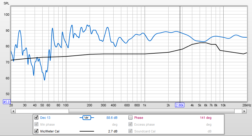

Frequency response:
Impulse response:

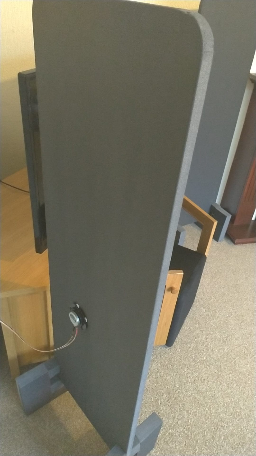

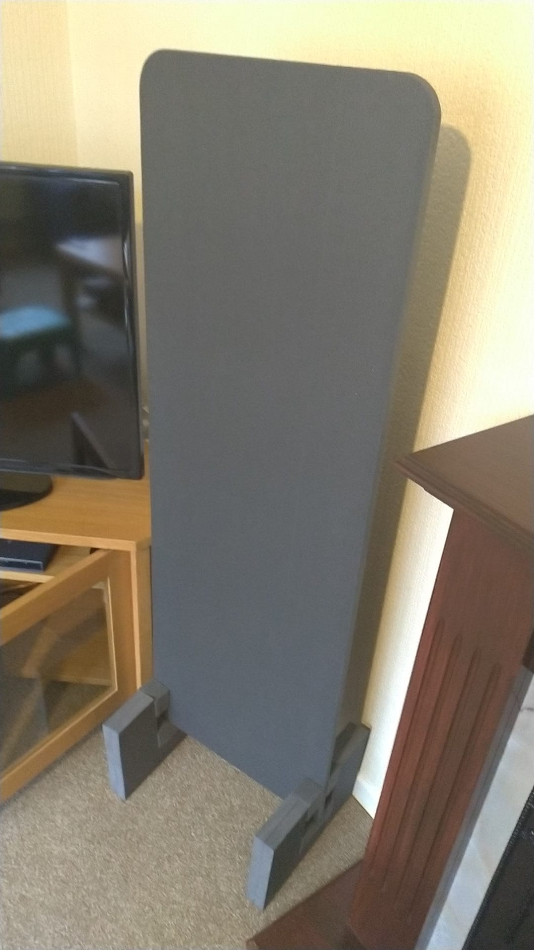

Hey everyone,
I've been slightly out of the loop as work has been keeping me occupied. I wanted to share with you my experiments. During the pandemic I tried working with all sorts of canvases as art shops were the only shops open in Warsaw.
I tried all sorts of canvases: Linen, Cotton and Polyester. What I found out was, that the thinner the material, the fuller sound it produced, but the key to getting a deep sound was not only sticking a wooden “plate” onto the canvas, but also drilling a hole in the piece of wood. It didn’t make a difference whether you drilled 1 or 10 holes. The size of the hole mattered the most. Since I couldn’t get any double sided tape during this time, I only pressed the excited to the wooden plate. My further observations were:
1) Linnen was too thick and the sound was simply muffled.
2) Cotton was decent, but I couldn’t get a universal speaker out of it.
3) Ikea painting was GREAT! Unfortunately I salvaged only 1 painting from my office and it was the largest size that Ikea had. I must say that it was fantastic, but I kept getting some buzzing sound with a lot of base. I can bet that with a smaller sized painting things would have been a lot better
I planned on priming all of them with 50/50 wood glue & water, but never got around to it as I had to commit all my free time to my business and also because I hooked up my Kenwood ls-880 ‘s and they just sound so good that I never had the motivation afterwards
Just my $0.02 that I wanted to add to the conversation.
