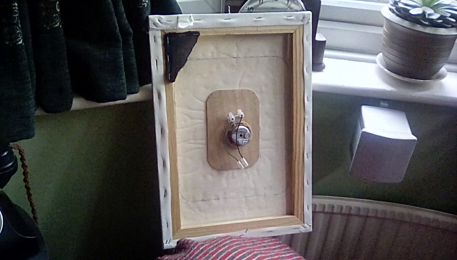

In the first picture is a painters canvas,in the centre is a 6x4 balsa ply panel with a 10watt exciter with a 25mm coil.
The ply panel on it's own will go down to 500hz with no problem,the canvas just takes the response down to 40hz.
The second picture is a 9.5cmx1.5I'm card panel coated with pva ,I also applied some paint.
This panel went down to about 2k if I remember correctly?
They also go up to 20k and beyond ,but I can only measure up to 20k.
I found that for small panels ,thin card works very well and sounds very good and has a remarkable frequency response.
