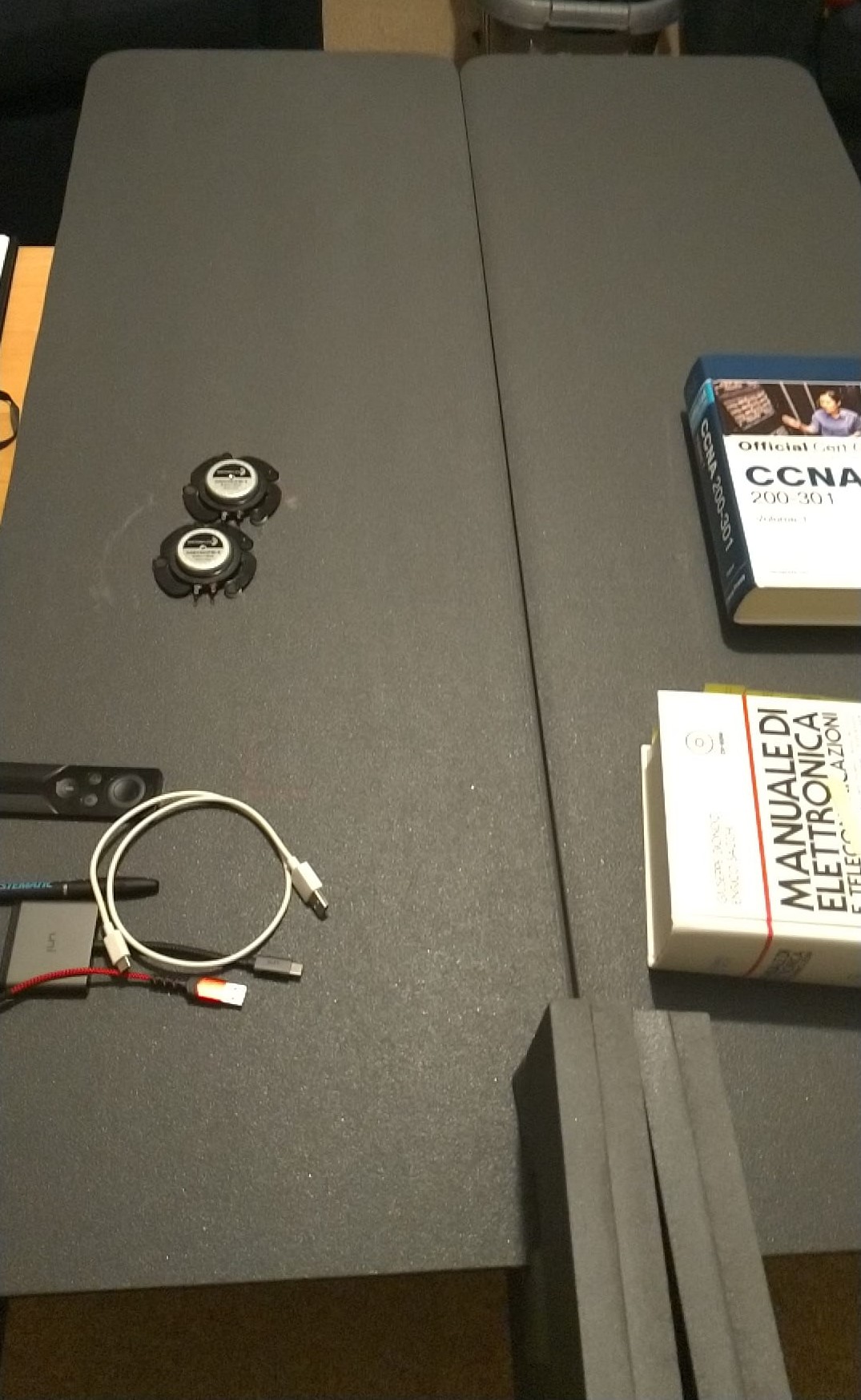

Many thanks to all of you for your contributions, they helped me a lot to shed a bit of light over this controversial topic.
When I read the monacor's guide I had already placed the first out of two exciters on the panel. I did take for granted that the position for the first one would have not at any rate to be changed. Anyway, before placing the second exciter I read your replies. I ended up placing the second exciter close to the other exciter but closer to the center, differently from what dayton's guide pictures suggest.
They are placed almost on the diagonal of the panel.
Before the incident happened I was very happy with the sound of my single-exciter panels but now with two exciters per panel I've got no doubts the sound got even better.
There were some sounds, like the electric guitar distortion for which I wasn't very satisfied but now they sound very well. Panels now are able to play a more bodied sound, also basses are richer. I'm trying to figure out whether this improvement is related to the only placement of a second exciter or it is also because of the increasing of impedance to 8ohms. Anyway really really happy with this new setup.

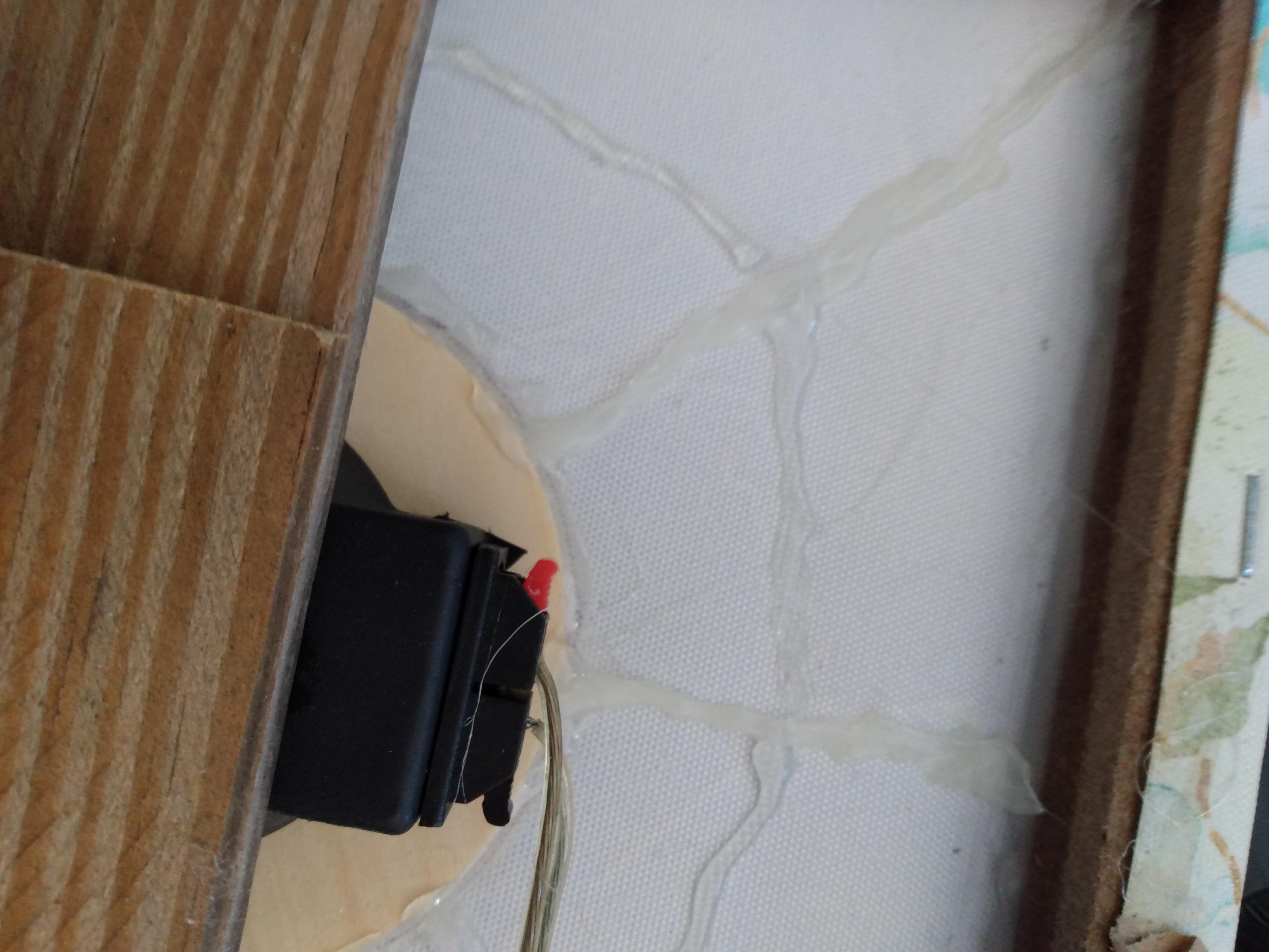

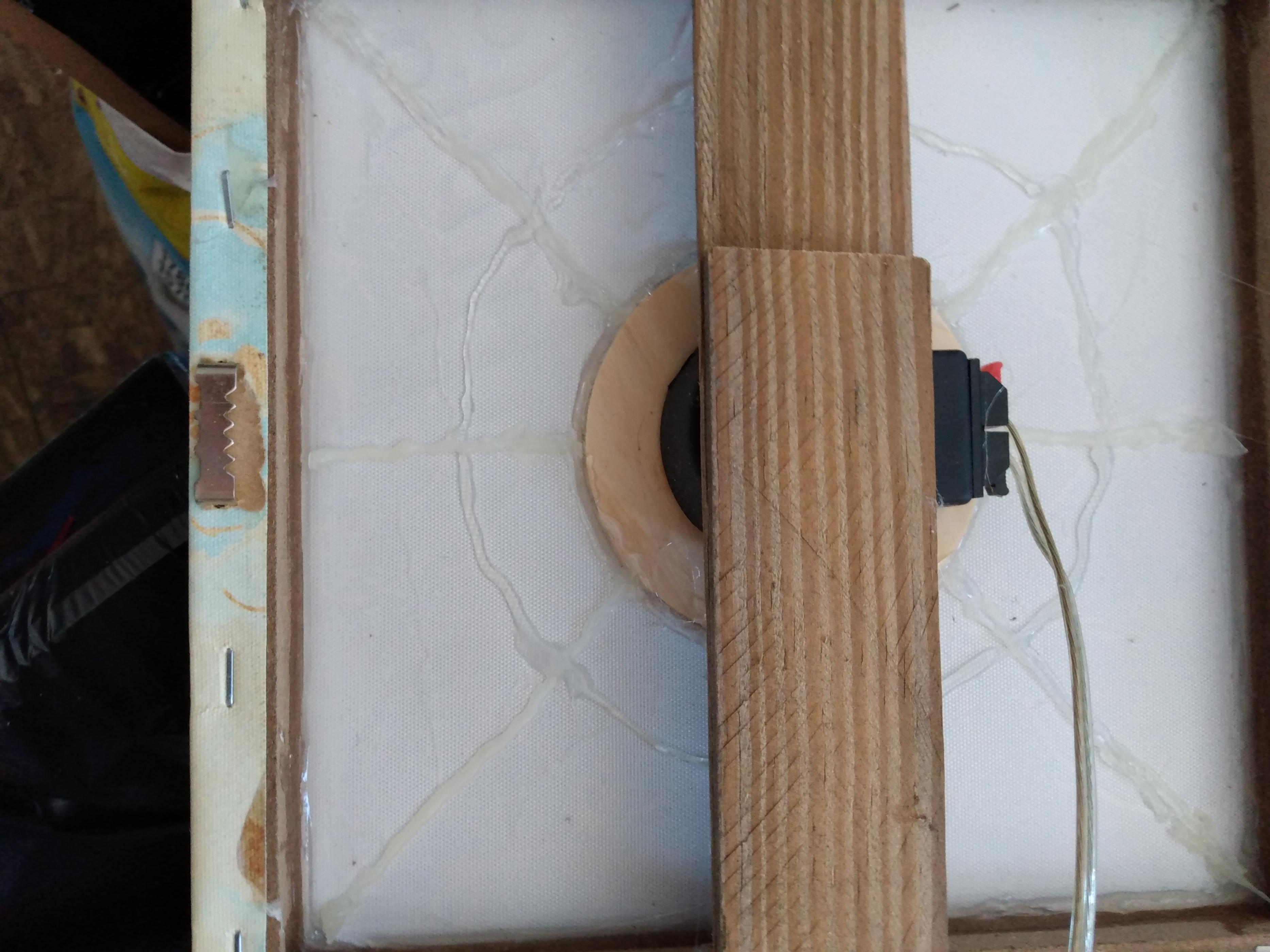

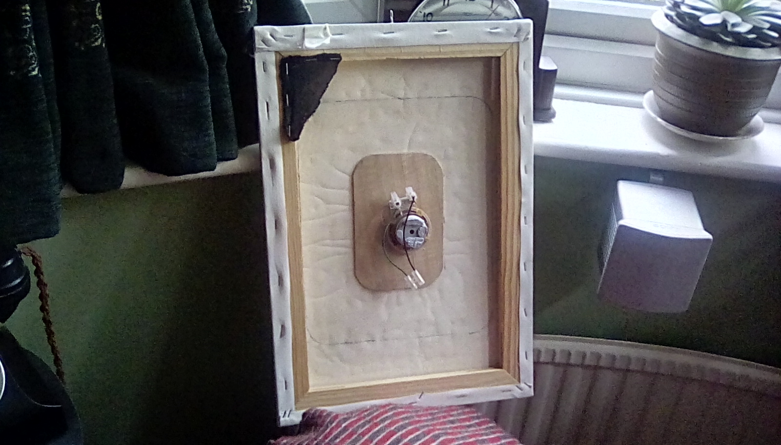

Well, this is another project that I've finally been able to get around to!
v5SVbroc2XexVhXgviM1BVFKAGLfvTszDmDJQ0qhHcBOcnlwIMRs1N5xF9XtGD7u-7jQUu0In3cANsOUF2ajX0t9W-boq2AJy-SaafZg5c32BJBqxuKxFaHVSnR2HFDE646mN4Eu4WI=w800
So this became a fun family project, where my daughter offered to paint the canvases with acrylic paint. We sealed it with Gesso, and then she went to work with her designs.
I noted in the thread that 'drum tight' was ideal, so I jammed sticks in between the frame and the canvas, and made sure that both were 'tuned' the same.
I also noted that they sounded best, I think, 6-7 inches from the wall. Initially, I had them mounting on picture hooks, and as one can imagine they sounded a bit strange, so fortunately for me my wife let me get a pair of 6"x8" shelf brackets that I could hang them from. In this case, 6" still wasn't right, but flipping the bracket to allow the speaker to hang 8" from the wall gave the best response.
They're perfect for a living room. Great voice intelligibility, and Bass that makes you think there's a sub tucked away somewhere. I'm using one of the Lepai LP2020A (if I remember correctly) amplifiers, so there's nothing special driving them. I'd highly recommend these for a listening room, and the WAF is very high...to the point that, dare I say, my wife was excited!
The only place in the build I used silicone was for mounting the wooden disc to the centre of the canvas. I'd been working on another speaker project, and so had a hot glue gun to hand. I used two layers of craft sticks on the back to brace the exciter, and added a little semi-triangular brace between them and the frame.

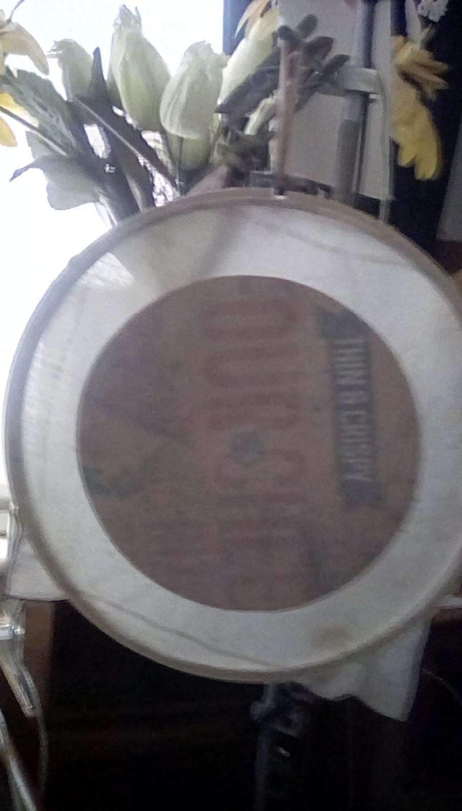

I've always thought that a circle would be perhaps the best, being there would be no corners to create reflections. The area and the material of the circle would then be the highest concern. I have an ambition to focus on that same thought myself..
I have build circle units in the past with foam board and aluminum flashing glued to the rear surface. I understand the theory a little more now and do plan to dive into it in the future..
Might I suggest trying the canvas idea on perhaps an embroidery frame ~10" or more in diameter and keeping with the wooden circle dead center and trussed frame as seen/explained above to hold the exciter. About every 2" from the wooden circle, run a small bead of hot glue to create circles around the back surface of the canvas towards the outside frame. I invision maybe 3? Run a small bead of silicone around the outer frame on the back side where the canvas meets the ring to dampen and to avoid any vibrations to the ring..
I remember a quote from an old Alka Seltzer commercial.. "Try It.. You'll Like It.." 🙂

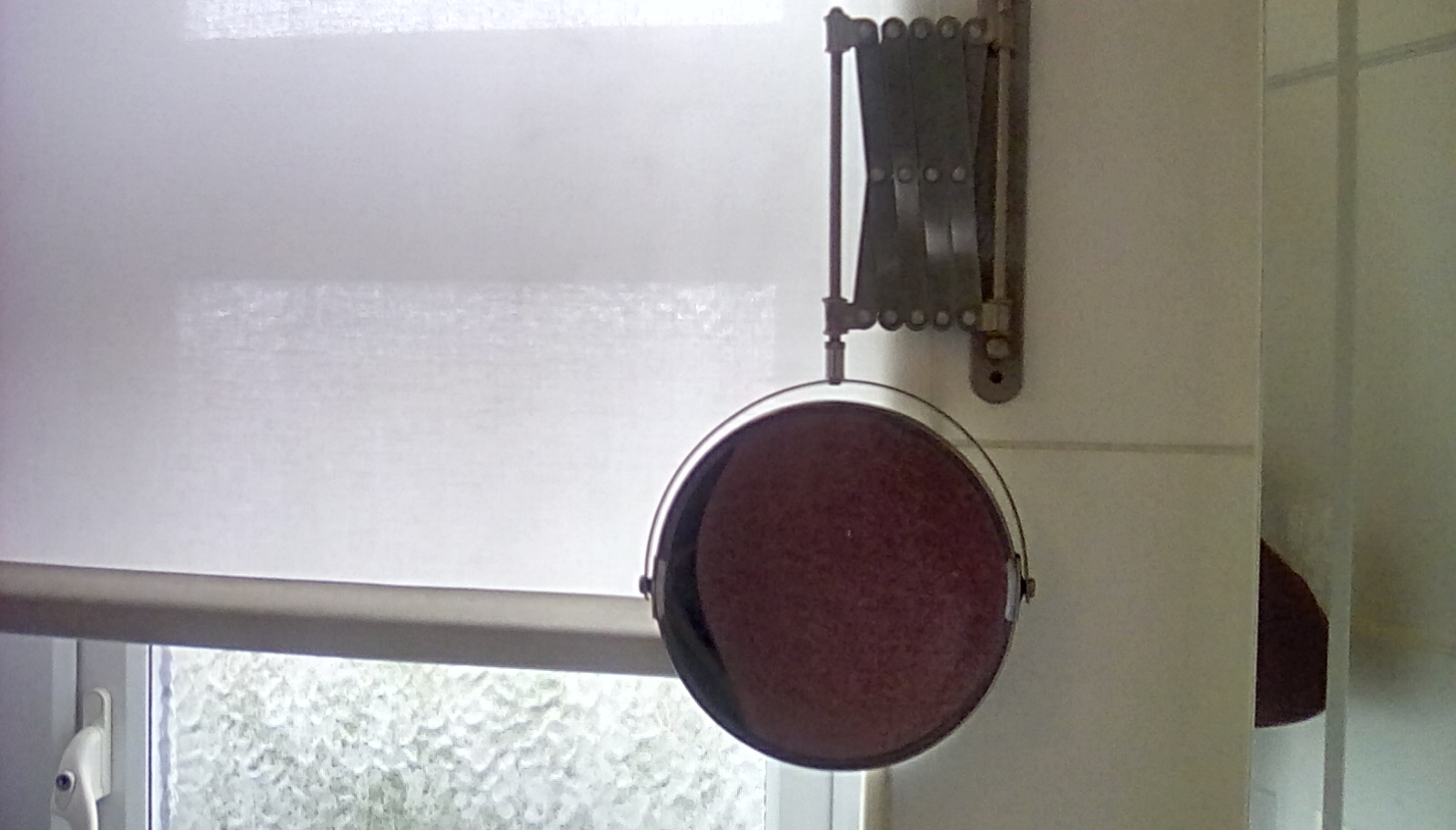

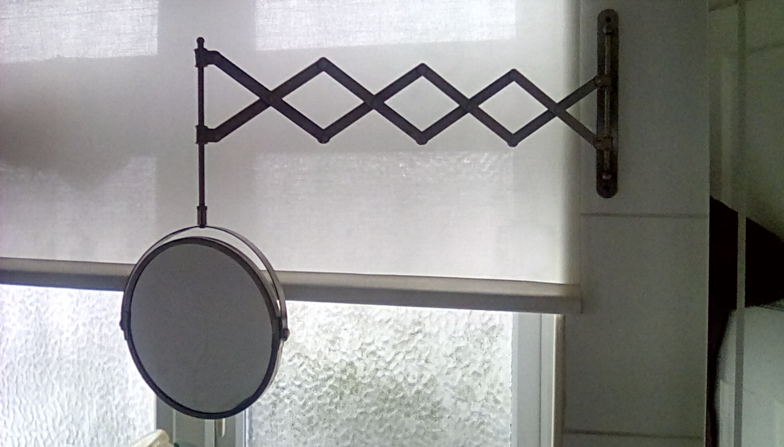

Hi offgrid.
I too ,have been very busy,renovating 5 old turntables I've had lying around for some years now,so that I can record to computer,great fun!
The painters frame was a genius idea and works very well,using a thinner cloth might improve things ,maybe?
I tried the embroidery ring a little bit before moving on (12inch)but it didn't have the huge amount of low end as the painters frames did,maybe if I had persisted I could have done better?
For the painters frames I used 6x2inchx2mm balsa ply ,basically you get the performance of the ply panel itself(600hz to over 20k if I remember rightly) plus the canvas extensions down to 40hz.
I never did get around to trying a dome in the centre to see if this improved things?
If WAF is a problem I thought that the last two pics could be a good idea for listening to music when the other half isn't around.
Just pull them out and away from the wall to the left or right to reduce wall problems (she'll never know).
Hope this helps.
Steve.

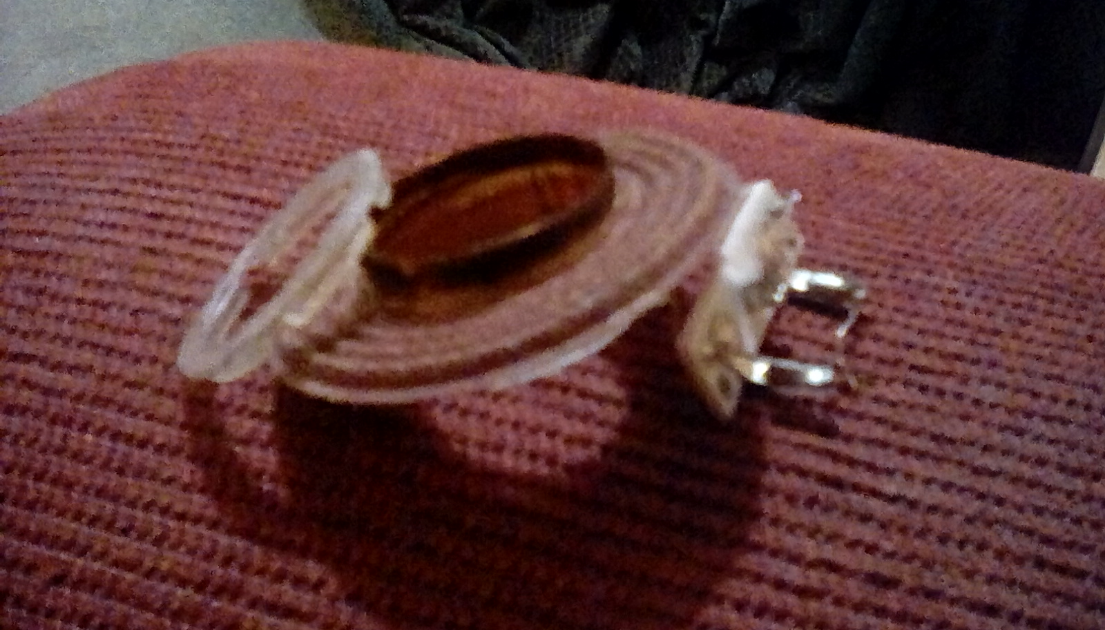

Exciter failure
I was using an 25mm coin type exciter and the coupling plate came unglued to the aluminum former. I was driving them near their limit. I was playing music. I had four of these attached to the panel. The voice coil was not burnt or discolored so that did not fail. The only theory I have is the glue may have softened from the heat transfer of the aluminum former. Any thoughts or suggestions? I really like the size and efficiency of this size exciter.
Kglane.
Is what you are describing similar to this picture of the plastic ring foot, which has detached itself from the coil former.
This has happened to me now and then,I'm wondering if it's down to quality control?
Usually it starts with a slight buzzing now and again on certain pieces of music which is difficult to pin down,this is long before it detaches itself.
I normally use pva to glue the exciter to my panels ,so glued the foot to the coil in the same way using pva with no problems.
As long as you give plenty of time to dry in a warm place( a few days)with a little help from a hair dryer.
I have also on occasion just glued the coil to the panel without the foot,as long as large excursions are not needed!
I usually scuff the foot in the area to be glued just to give a little more grip.
Steve.
Ps.
If the exciters are getting very hot this will obviously fail again, as will the others eventually.

Chdsl.
Use my old vinyl records to make a panel:yikes::yikes:

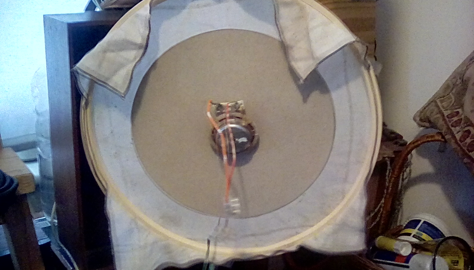

Didn't really Finnish experimenting with the 12inch hoop ,LF not that great ,the plain card is hard to beat.
Circular panels with the exciter in the middle are not a good idea,although the fabric is quite lossy .
Steve.
Kglang.
So you saying that your flat metal plate has come away from the coil former, and that you do not have a plastic foot between the two?
You could also use super glue ,but you have to get it right first time or it can get a bit messy.
After glueing it should be A1 again.
Steve.

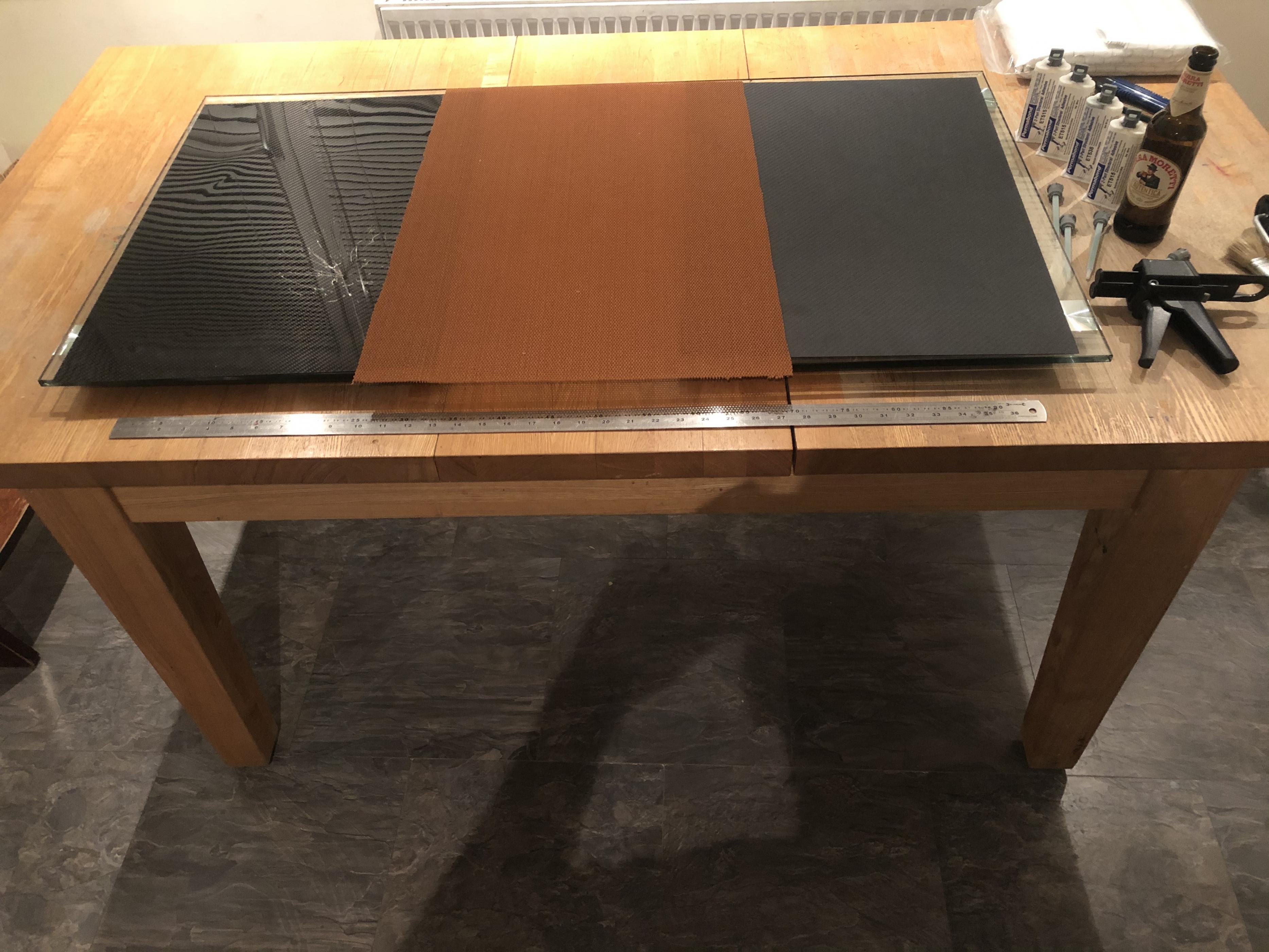

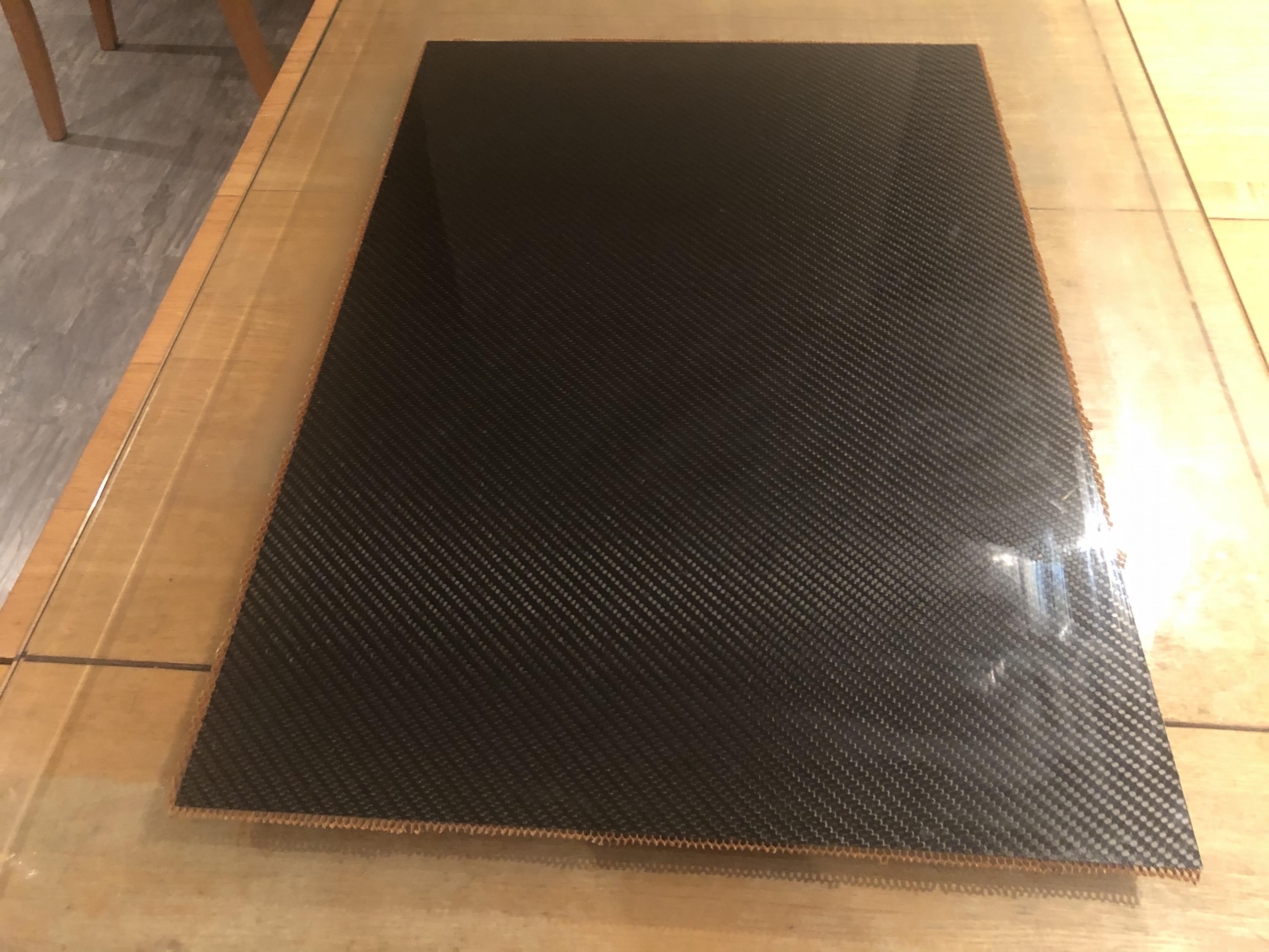

Hi, does anyone know what the Amina speakers are made from? I know they have a aluminium honeycomb core, and it appears that they have paper type skin, but I'm unsure what this is.
I have made up a carbon fibre skin, no med honeycomb panel based on the size of the dml-10 tectonics speakers (577 x 400mm), annoyingly I didn’t get the rectangle square, so I will need to trim a little more off the length, as found out when making up a test frame. ☺️
I did a quick test with the panel free and was surprised that it went down to around 45hz, although the high frequency drops off too early. I need to clean excess glue from the faces leftover from making the sandwich panel up and put in a frame, so will take some measurements and post results. I wonder if an aluminium core would give better high frequency. I have some carbonfibresheet leftover, so plan on getting some 4mm thick aluminium honeycomb I test and see what the difference will be, but will have a fair bit left over so will be able to test other skins too.
Hopefully will be able to test the CF/nomex honeycomb this weekend and ill post full details of exciter used, positioning, etc along with Rew readings.
