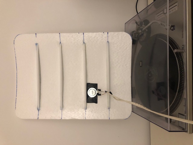

I've done a Teragaki style speaker using foam. Quite simple to build, but poor sound... at least my prototype...
Any pictures?

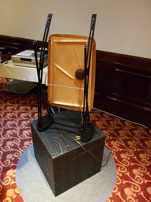

...and looking at Opere Sonore's stuff
In that image, I notice that there are two panels fixed together, the back one appears to be plywood, and the splines look more like Teragaki's. The front is the eye-candy panel, piano wood.

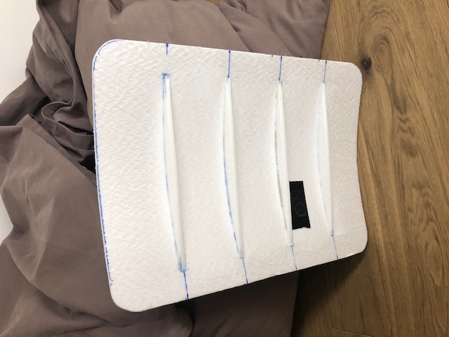

Teragaki style prototype
