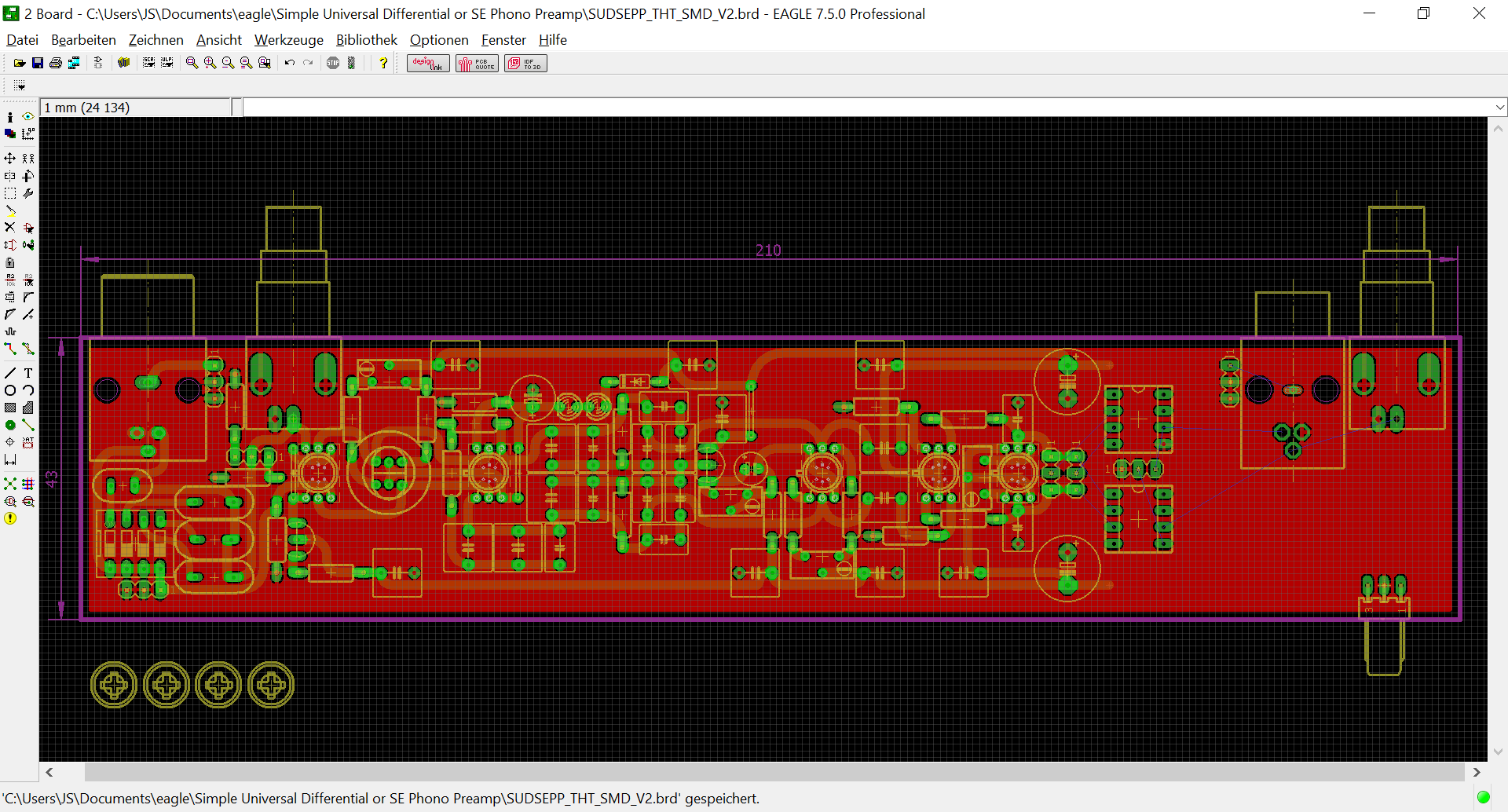

RCA connector at the input for SE. 2.54mm shunt (not really happy with this! braining...). I don´t like wires!

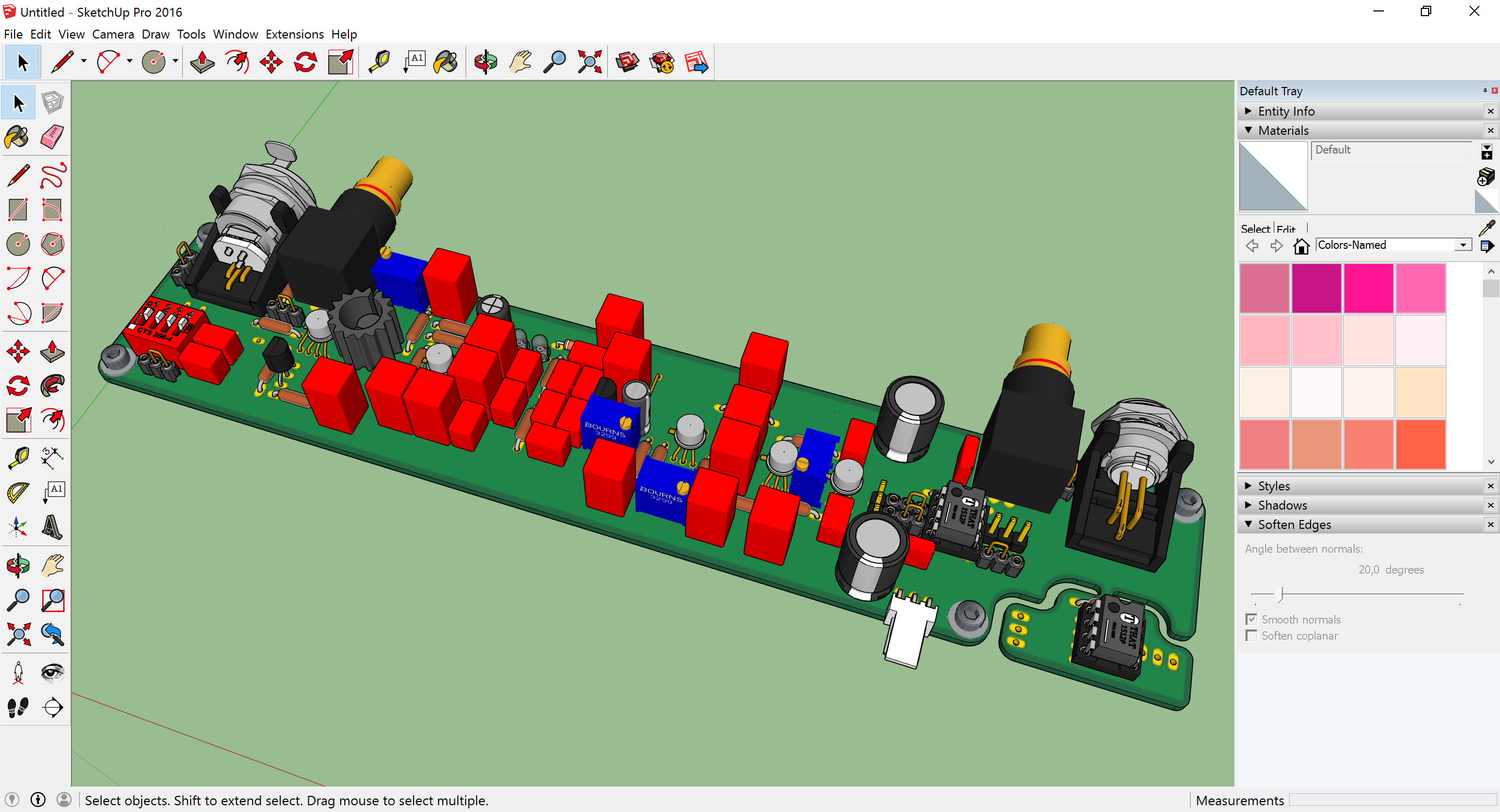

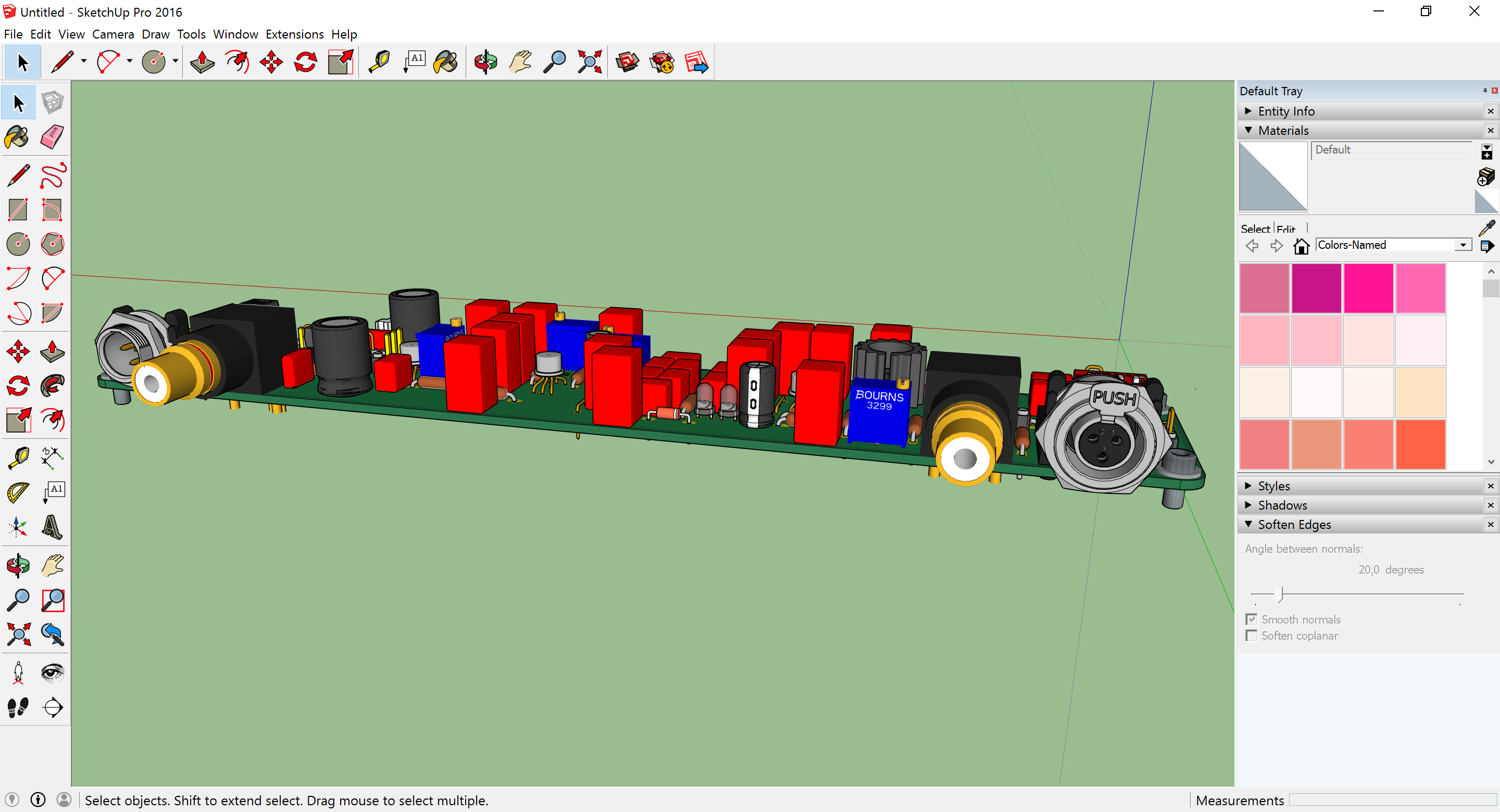

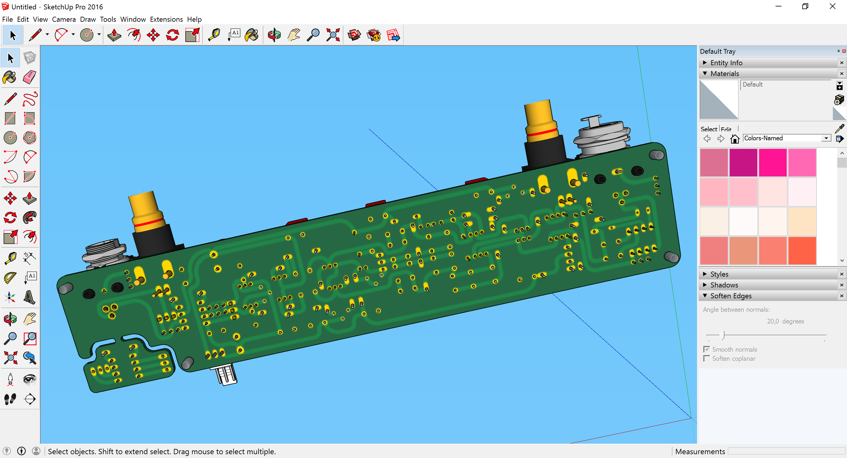

Caps (film pitch 5mm and width 7.2mm) are placed; PBA is for the moment 210x43mm, to stack for stereo and overall height <40mm (1U).
No 3D view today, sorry, missing license keys after W10 major update!
Good start in the coming week.

... ongoing, missing mica capacitors CD10 and CD15 3D models.

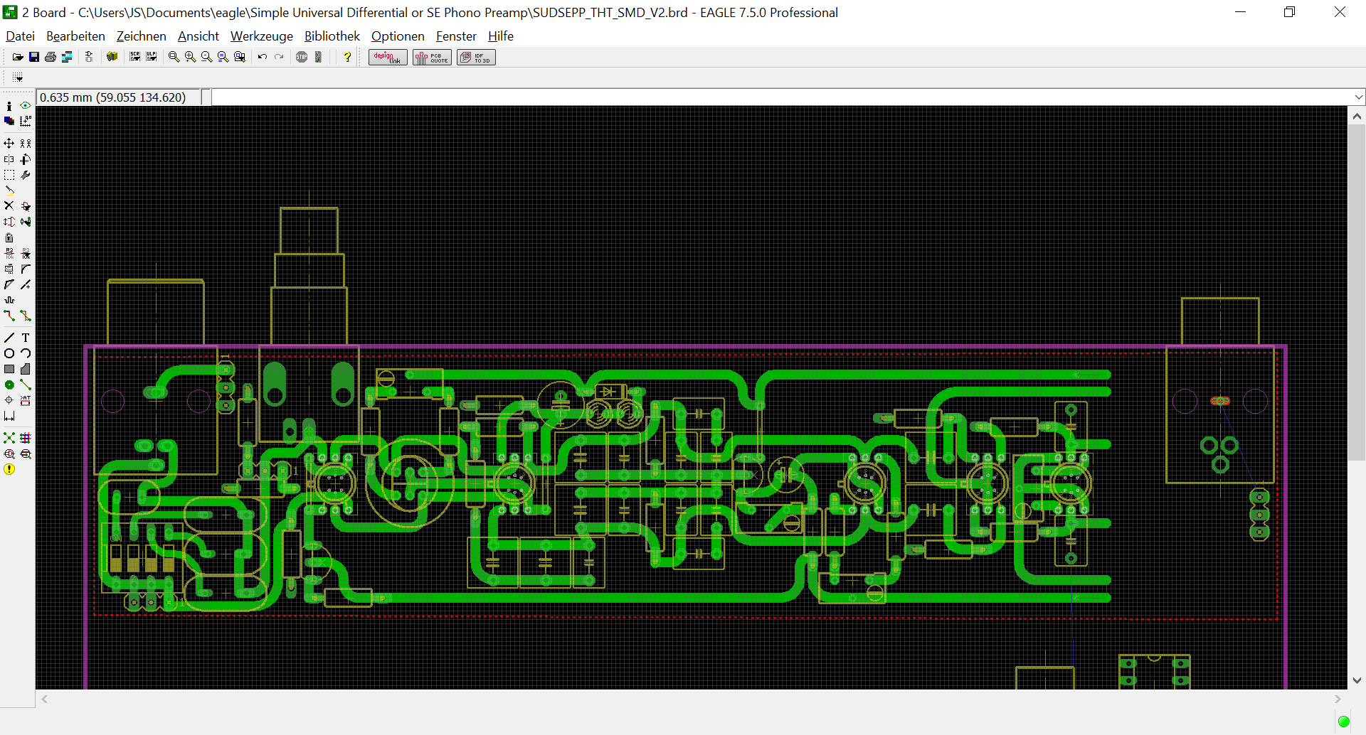

Layout optimisation today then PDF posting for control (before going SMD).
