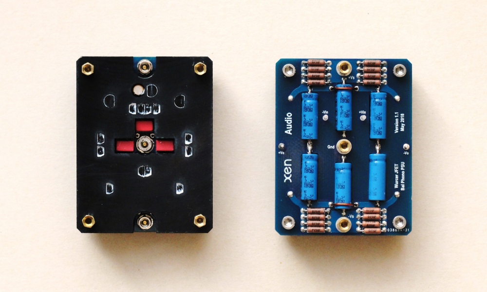

A simplified universal differential or single ended phono preamp
DIY is hobby that takes time (to enjoy). ;)
I decided to discard the heatsink and dump the heat to the case instead.
So on the "back" side, I added a board for PS caps and R-C for the output followers.
The side facing the preamp is of course a flooding Gnd plane.
Patrick

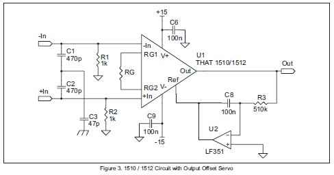

Hello,
I hope my question is not way off topic... I'm trying to build a high gain stage with the THAT INAs as shown in the above post. I've already built a quick prototype and I need to address the dc offset. It is very likely to end up with coupling capacitors and there is no problem with that but since I'm in the designing phase :eek: I thought to try a DC servo as well. I found a schematic supposed from an older datasheet - attached - but my knowledge only allows copy and paste so, I would like to ask if this is the right circuit to use. Also, it would be more practical to use a double opamp in DIP8. I would appreciate any recommendations.
Thanks in advance.
