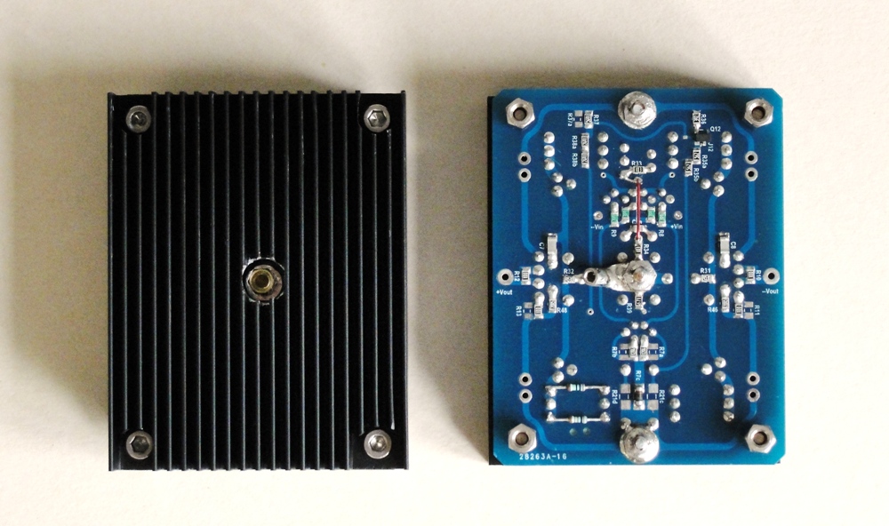

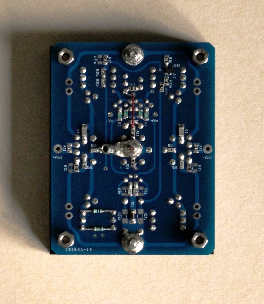

The good news is that it works first time.
All DC values as expected.
One channel does not even need any differential trimming.
The other one has a 25µA offset which was trimmed at the bottom current source at the 2nd stage.
So now both channels have common mode DC ~ 20mV (with servo).
Differential DC is within +/-200mV over time with no servo.
Bear in mind I have very large gain at DC, this is not too bad.
Of course it only eats up a bit of voltage, and has no consequence at the output.
This is because I have a 16Hz rumble filter just before the output dource followers.
So any small DC has no consequence.
Need to do some work first to get a low enough balanced signal source for frequency response measurements.
Patrick

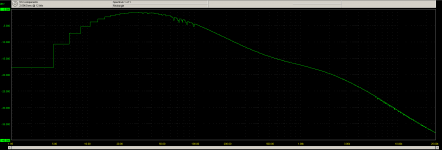

Completed all measurements today for both channels.
Essentially identical. Gain at 1kHz 1100 & 1090 respectively (~0.1dB).
So pretty much as intended.
DC offset at the outut followers < 2mV over an hour.
Frequency response also agrees to simulation to < +/-0.2dB from 30Hz to 2.5kHz.
(limited by resolution of the frequency plot)
Quite pleasured with the results actually. 🙂
All thanks go to Scott, without saying.
Next is to design a regulator board to stack directly under the phono PCB.
Patrick
