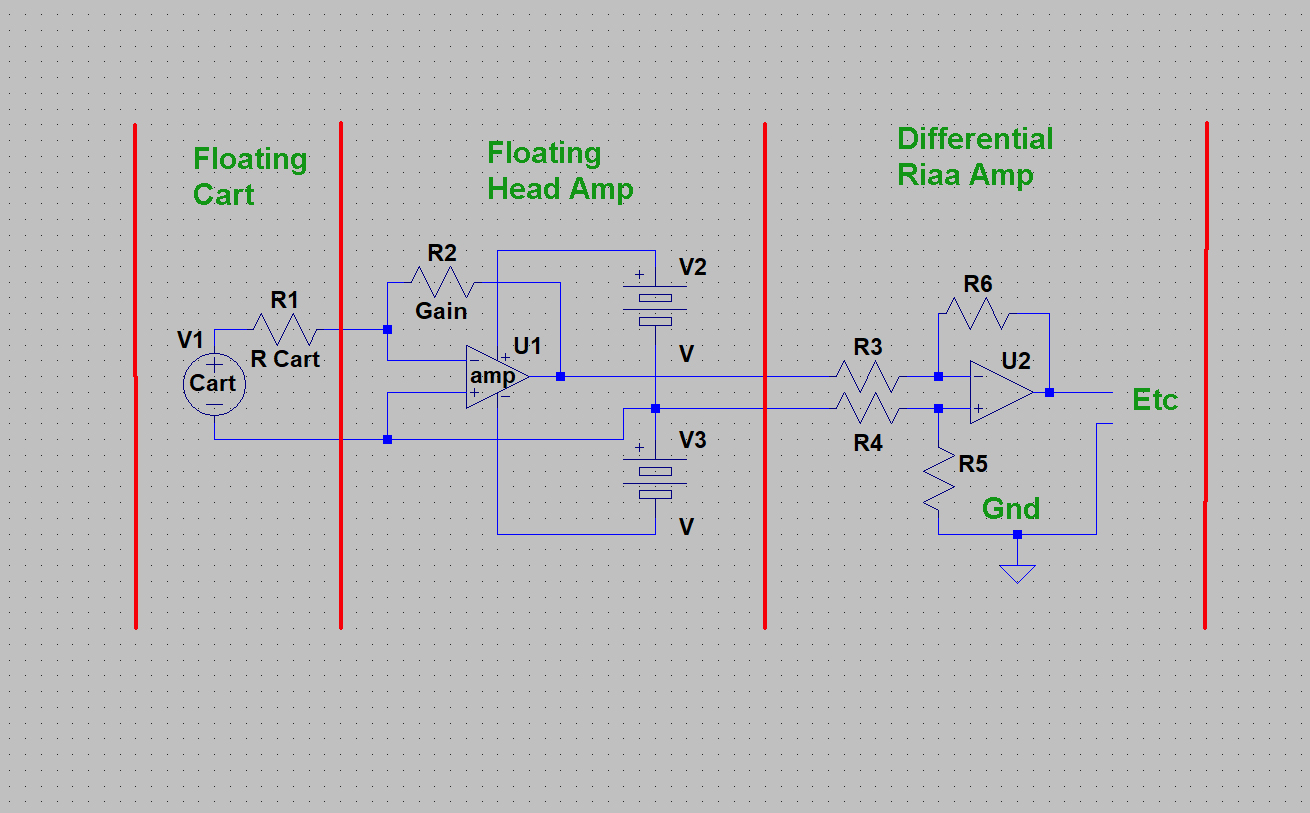

And since it is battery fed it is completely floating and can because of that be regarded as differential-in / differential-out IMO.
Well no that's not true, apply a common mode signal and see, as Mark said it all collapses into a self biasing CE amplifier. Secondly the open loop gain is low with a 2 ohm source the gain is actually 30dB and not 40, it's OK this is audio in the end you just adjust the gain pot. But most importantly even John does not like virtual ground input setup circuits, he has stated here several times they sound like they are "underwater".

Question: How do you apply a common mode signal to something that is completely floating ? I think it cannot do anything else but to float up and down with the common mode signal. Output voltage won't change between the two pins, because input signal is not changing, so in fact CMRR is very high, given there is nowhere a connection to Gnd and output is fed into a differential input.Well no that's not true, apply a common mode signal and see, as Mark said it all collapses into a self biasing CE amplifier

I know, sigh. John has stated this a few times here he (and I assume his posse) do not like the sound of virtual ground MC stages. So I will pursue the alternative avenue, if you want a bi-polar transistor with minimum possible rbb a couple of guys from Philips derived the geometry (I lost the paper) but it is not rocket science. In fact I probably have the only samples left in existence. If NASA wanted a super-beta transistor with .1 ohm rbb that took up a full cm on a side of wafer we could just make it, and it would just cost $$.
Hans, I assume the ground connection is propagated throughout the system all the way to the safety ground wire.
Here are some examples
B.M.C. Phono MCCI phono preamplifier | Stereophile.com
I'll pass, the technical content here is on shall we say a basic level. If you think the .27nV and common base input is the bee's knee's just ignore me I'm used to it. BTW please note the thread through this review to never actually connect either end of the cart to ground lest the performance be void.
The main caution is that you must maintain "ground free" connections from your turntable. The shield must not be connected to any of the four cartridge wires. That means that Rega Research turntables (and Rega's separate tonearms) will need the ground connection broken between the arm and the cartridge's blue "earth" pin.

I might have an idea what caused the "underwater effect" at least for John Curl's Patent circuit.
Current flowing through the Cart is heavily dependant on equal voltages of both batteries.
The slightest mismatch already results in a relative large DC current, hundreds of microamps, flowing through the Cart.
It would amaze me if this had no effect on the sound, even so more because Batteries are not even stable in their voltages when in use.
So I will come with a "modernised" version of this patent, now taking care of this problem.
And of course what Scott also mentions, is that Carts (and this Amp) should be fully floating when using a virtual Gnd input.
An ideal scenario for a connection to a differential input, see below.
Hans

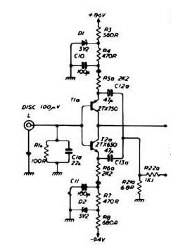

It is probably a LOT easier to build a ripple-and-noise-free, low output impedance, extremely precise pair of voltage regulator circuits (plus and minus 1.500 volts), than to build a world class MC stepup amplifier. Especially when the design is DIY and not constrained to meet a cost target or a max-footprint size requirement.
what can be simpler? from 1982
http://www.4tubes.com/SCHEMATICS/BY-BRAND/Italien/pre_Quad34.jpg
How close are the N and P beta running, at large currents there will be some DC current in the cartridge (probably not a problem). OTOH supply sequencing could be.
I see the ZTE devices were known a while back even while the RHOM devices were in vogue. Do they really need no selection for popcorn or other 1/f noise?
Hans
