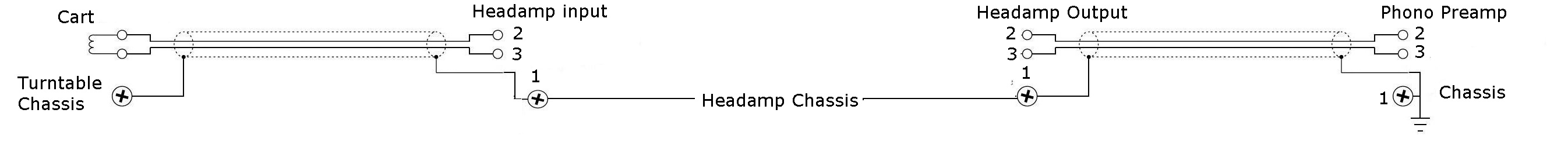

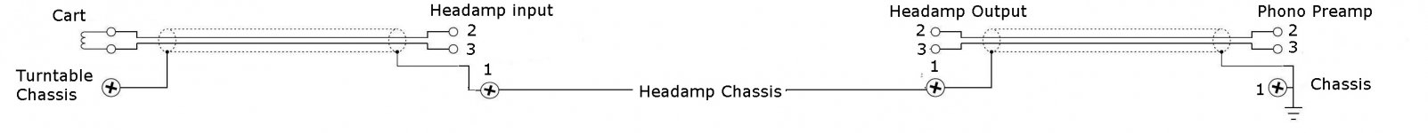

Where's pin 1? You need to complete the system with shielding, etc. in a way that won't pick up RF or violate code.
I thought that would speak for itself, however here it is in the image below.
Neither the Cart nor the headamp should have any connection to chassis or shielding.

By balanced I mean for 2V out pins 2 and 3 are each 1V and out of phase without a common mode reference what achieves the division? Battery operated mics work fine but without a transformer or two explicit outputs they end up psuedo-balanced. In your first picture the head amp is connected to ground through the resistive differential receiver. I assume your second picture shows the entire chassis/shield system grounded only at the pre-amp.
Sorry Scott, we are thinking along different lines.
A balanced output does not need to have two out of phase outputs plus a common mode reference. Look for instance at the Bruno Putzeys Balanced Preamp.
When feeding into a differential input all you need is a voltage difference but absolutely no common mode reference.
If this is what you call pseudo balanced, that's O.k. for me.

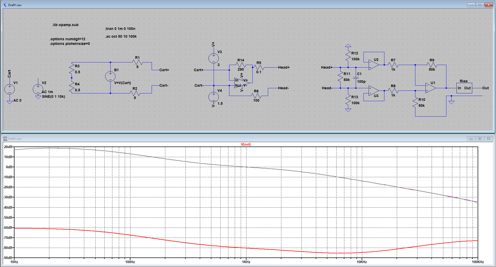

Below the simulation results of the Curl Amp feeding a differential Riaa preamp.
Gain of the preamp is set at 20 and for the Riaa amp an arbitrary gain value of 50 at 1Khz,
V3 and V4 are two batteries feeding the Curl amp.
Inside a servo takes care of the voltage supplies, preventing the Cart current ever to exceed 1uA.
At the same time another circuit connects and disconnects the Cart when the voltage supply is not yet or no more settled, preventing current spikes flowing into the Cart.
Rout of Head+ is 100Ohm, so in order to make the output balanced, a second 100Ohm resistor is added in the Head- line.
Transfer is measured with the floating source B1. CMMR is measured by connecting V2 between R3 and R4.
CMMR, being the difference between the gray and the red line, starts at 80dB up to 1Khz and goes from there to 60dB at 20Khz.
The details of the improved Curl Amp to follow in detail.

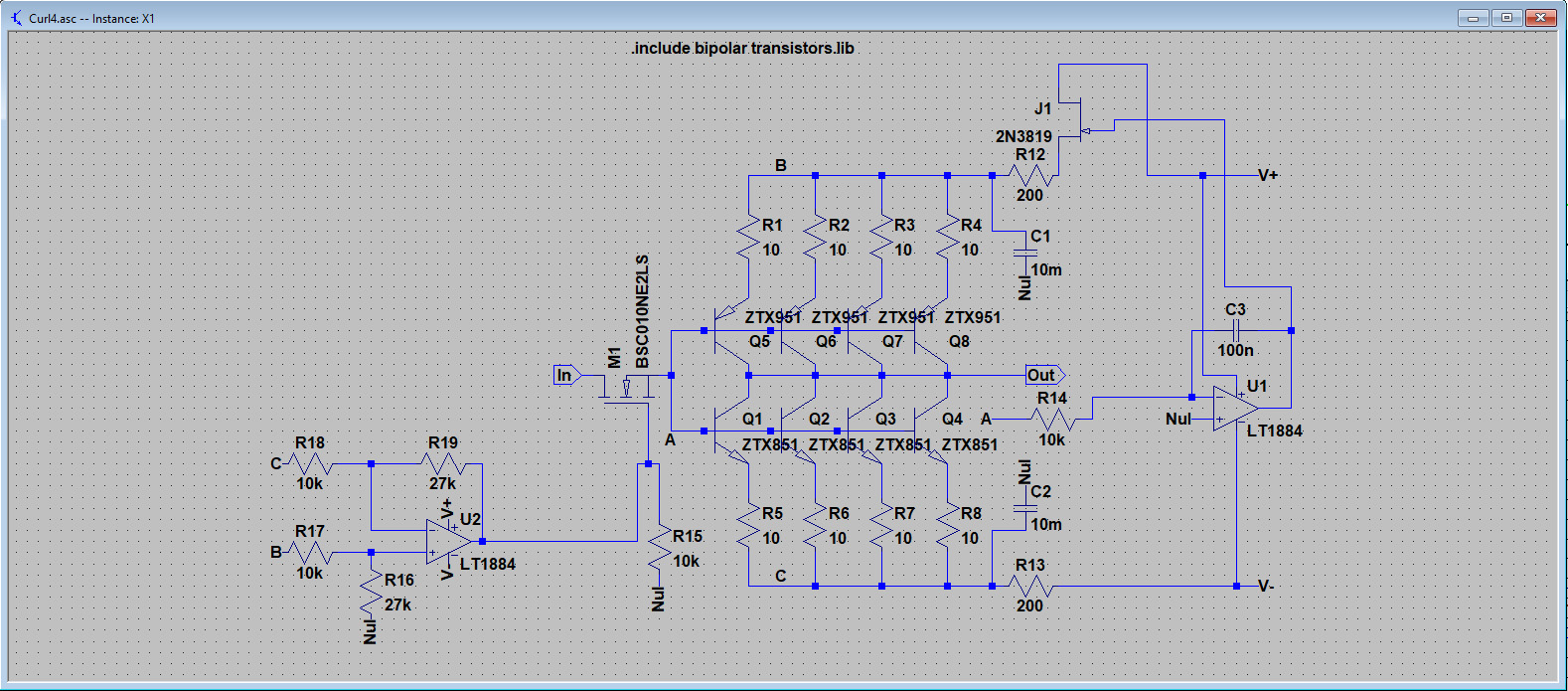

And here John Curl's Extended version of the Head Amp.
Since the ZTX transistors are almost for free at 0.6 Euro/each, I have not reduced the amount of the original design, although this can be done.
Further, I have chosen for a gain of 20 to get some noise margin over the noise from MM stage coming behind this head amp.
In this setup, equivalent input noise is an unbelievable 0,24nV/rtHz.
You will probably never need this, but it comes almost for free and it doesn't hurt either, with no HF issues as paralleled high frequency Fet's can cause.
Three 1.5 Volt batteries are used. One for the unregulated negative supply, and two for the regulated positive supply.
Positive supply for the circuit is made with a LT1884 and a Fet.
The LT1884 having an ultra low offset voltage, takes care that the Cart voltage is always close to zero.
As a result Cart current will always stay below 1uA, independent of battery voltage, solving the biggest problem with the original circuit design, that may have caused the "underwater" sound.
A second LT1884 connects the Cart to the head-amp, once the supplies have settled at about +/- 0.5 Volt at points B and C in the diagram.
Connection is realised with a Mosfet, having a channel resistance of only several milliohms when switched on.
Since the Mosfet operates at a virtual gnd node, it's capacitances are playing no role.
In the THD simulations, no effects whatsoever of this additional Mosfet could be seen at all.
When power supply is switched on or off, this Mosfet immediately disconnects the Cart, preventing any current spikes through the Cart.
As can be seen in #270, Batteries are connected to V+, Null and V-.
Feedback resistor, depending on the Cart resistance is placed between In and Out.
For a gain of 20, this resistor has to be 137.5, 190 and 290 Ohm for a Rcart of resp. 2.5, 5 and 10 Ohm.
Total current drawn is slightly more than 6mA.
When using three 1500mAh penlites, it can be used for 250 hours.
