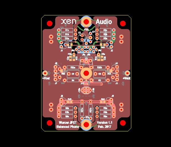

A simplified universal differential or single ended phono preamp
I already had one made.
But as usual I will not publish before finishing test build.
I made quite some changes to Scott's schematics, which he knew about.
The test build will take quite some more time as the JFETs need matching first.
So feel free to do an alternative.
Patrick

I'll put together a complete all on one sheet schematic, it will take a few days. I would not use my prototype board since it had a couple of errors where the lead spacings didn't match the components I got, and I used a less than optimal in-amp since I had them. Patrick is going for more gain up front (MC?) in either case a new board would be needed. I would lay a board out with provisions for both in-amps though they need not be both populated.

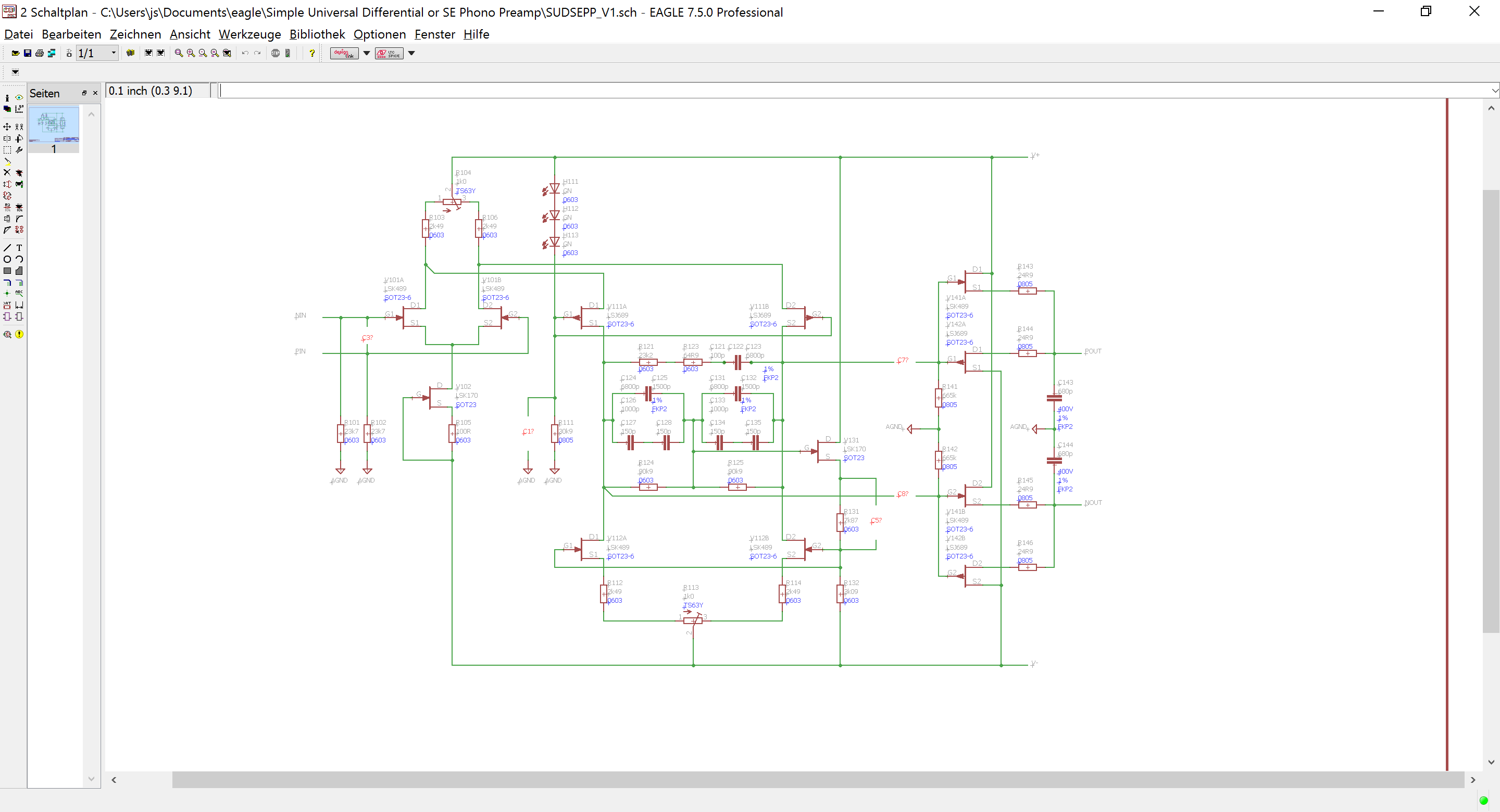

I'm starting today with schematics according Mr. Wurcer posted schematics.
Saving time, Mr. Wurcer could then sketch modifications directly in schematics PDF.
I need to know JFET pairs LSK and LSJ.
SMD or THT design? I know, capacitors mostly THT.
I'm using EAGLE, Library Expert Pro fot packages, Ciiva for BOM and FreeCAD for 3D Cad and 3D PDF for PBA.
JP

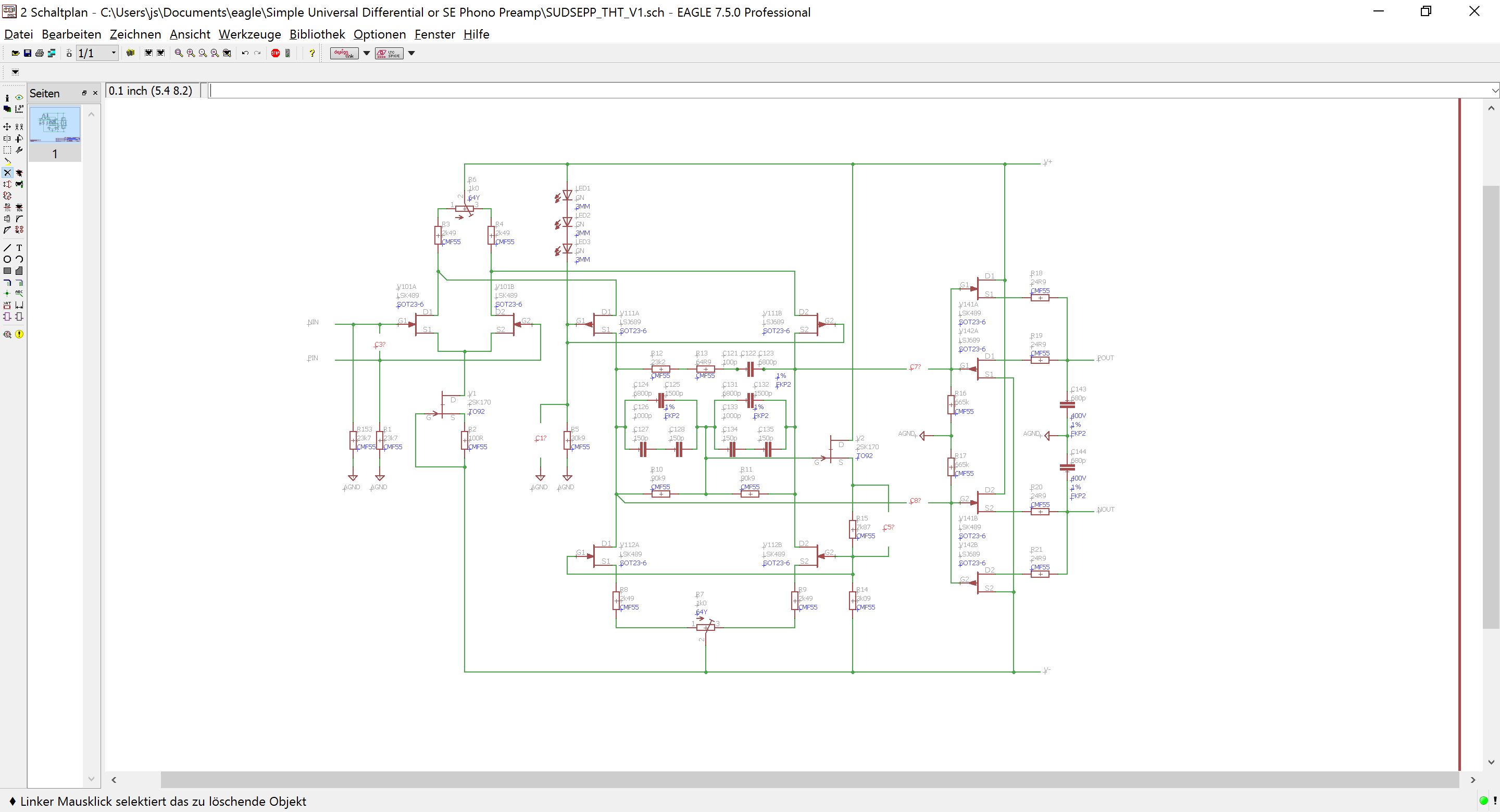

FYI the RIAA caps are 2 - 9.375nF and a 12nF || 1.7nF the output coupling cap is non critical in value I used 75nF. the 23265 Ohm resistor is two resistors in series, I just used one of the javascript calculators that generates all possible choices and picked one I had. Everything else is standard 1%. The RIAA plots I posted were done with no adjustments or trims.
If you don't use differential in you will want the option to put the termination on one side and ground the other. I never determined absolute polarity you may want to make sure it is preserved through the signal path and label accordingly
You may want to consider simple current source biased source followers on the output. I designed this to drive up to 2K load, the in-amps are no load at all. This would simplify the build considerably. I think Patrick would agree there should be no sonic consequences. I'd try the classic 2 FET zero offset follower trick. Just to mention, one might think you could go right into the in-amps but their current noise is a problem at this impedance level.
The circuit should work fine with some of the new LSK P and N FET's in place of the Toshiba's but I would hope someone would verify a prototype or at least a sim. I would trust Bob Cordell's models since he is working with Linear Systems on applications.
The output source followers can be anything if you only want to drive 10k load or so.

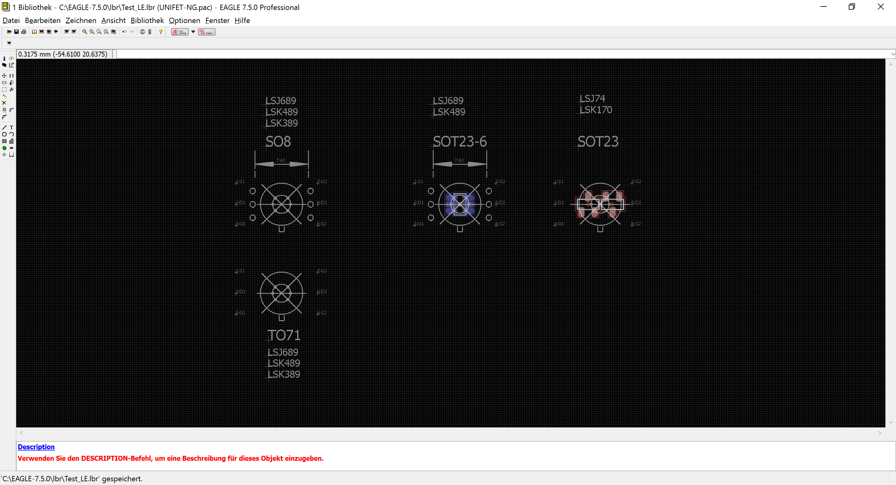

SMD and THT Version.
Need help for choosing C3, C1, C5. C7 and C8 aren´t anymore critical (other value possible?).
The RIAA capacitors coming from WIMA, FKP2 1% Series.
I´m working on an universal JFET Adapter (TO92, SOT23, SOT23-6, SO8 TO71, black foto), as I´ve done for Ale´s CCS.
Schematics PDF available after coming commented corrections (THAT part missing).
JP
