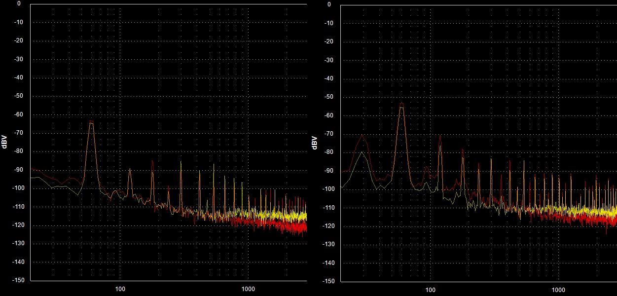

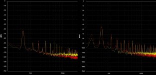

Comparison of differential (left) vs. single ended (right) input. This is my low cost TT with a plastic unshielded Grado cart, the headshell wires are also exposed more than one might want. Still there is noticeable improvement by 10 dB (sometimes more). The 30Hz stuff on the right is a cycling air handler caught in the act.
Not as dramatic as hoped but it gets the line noise another 10dB below the floor of the LP. I suspect an all out effort could get much better.

Yes, for a short run from such a low impedance I don't think there will be much additional benefit. A differential amp is low on the to build list for now.Assume your TT to amp wiring is std coax?
Thanks for the graphs! Good to see that. Is the air handler noise coming thru the stylus, or is it electrical?he 30Hz stuff on the right is a cycling air handler caught in the act.
Clever idea....simply using a mono 3.5mm/RCA adaptor shorts the ring to ground at the TT to return to single ended RCA.
AFAIK it's mechanical vibration, I might have missed dressing a wire in the box when I assembled it all.

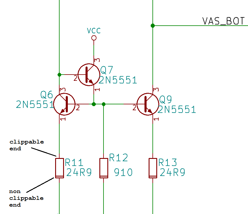

BTW my PCB CAD package strictly enforces pin number connectivity on all components, even bidirectional/symmetric components like Rs and Cs. So I use a schematic symbol that reminds me which end is the probeable/alligator_clippable one (from topside) and which is not. Example below.

Axial components mounted vertically! My brother! Good on ya.
_
I always do it to save space and/or have an efficient SMT/leaded option. In our old modular op-amps I don't think a single resistor was mounted any other way.
