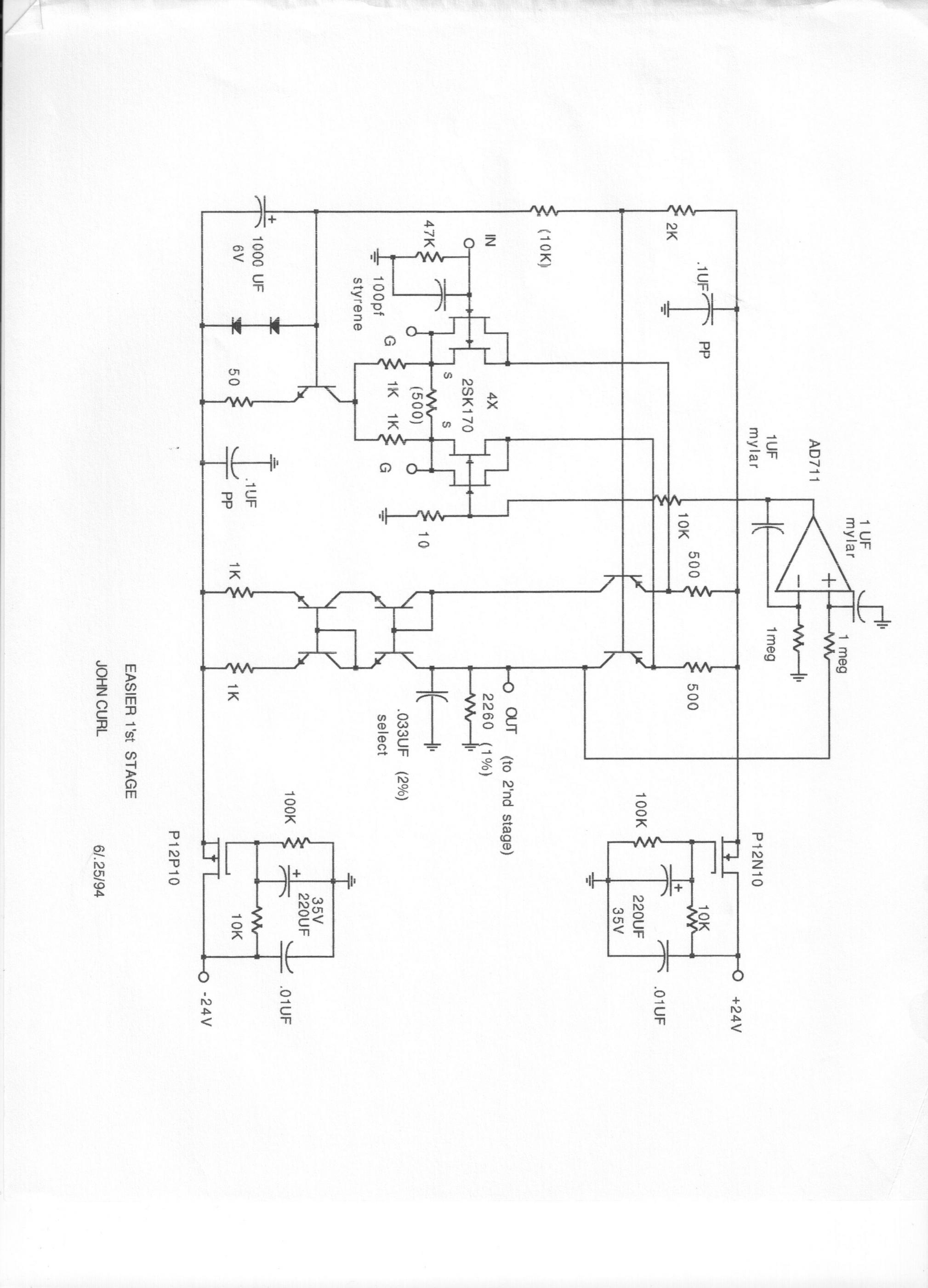

Here is one example of one of my similar designs, taken as Scott did, from the AD797 topology and its predecessors (Harris), that I made for Parasound, but they decided not to build but a few prototypes.
There are a few differences, please note the use of bipolar parts for the second stage. (Parasound did not want to use any more pch jfets than necessary), servo (IC designed by Scott), and a number of other features. Parasound got the right to first refusal, so I can publish it now. Scott's design has other advantages, and perhaps we might discuss the general design together, with any one else invited to contribute.
My headphone amp uses that topology as its first two stages: NJFET diff pair -> PNP folded cascode -> enhanced NPN current mirror. But I've added a double EF output stage to drive 15 ohm loads; John has no 3rd stage so he's got a transconductance amp driving a 2.62K load resistor. I felt it was important to heavily bypass the PNP folded cascode transistors' bases, to the top rail, so I used 100uF + 0.1uF. John's schematic doesn't include these.
And we can wonder aloud whether the 220uV 35V capacitors on the gate nodes of the capacitance multipliers, are "less harmful" than an electrolytic bypass capacitor would be on the supply rail itself. Since the MOSFET is a unity-gain source follower, any electrolytic-caused badness on the gate, gets copied onto the source, n'cest pas?

In simulation at least, I found that a 4-FET current mirror has lower distortion than a 4-BJT transistor, with the same degeneration resistors.
I wonder why FET mirrors are not used more widely ?

Can't speak for others but I avoid them myself because they gobble too much voltage headroom, and because the unit to unit variability of output conductance seems to be greater in discrete MOSFETs than in discrete BJTs.I wonder why FET mirrors are not used more widely ?
Have you considered a full 4T Wilson mirror using BJTs next to the rail and FETs next to the signal nodes? Perhaps you'll like it better than four identical devices, either BJT or FET? The BJTs only see a volt of VCE so you can use superbetas if you want.
For my particular application, voltage headroom is no issue, just raise rail voltage.
The Zetex MOSFETs I tried offered very good match even in a small batch of 25.
With matched Vgs, variation in Yfs is very low.
It is true that BJTs can do away with matching.
But then we match FETs all the time, so no big issue.
