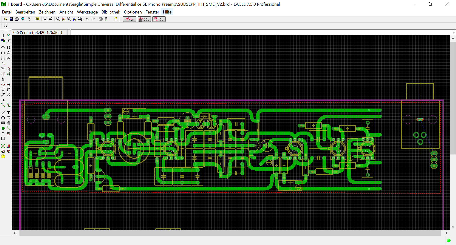

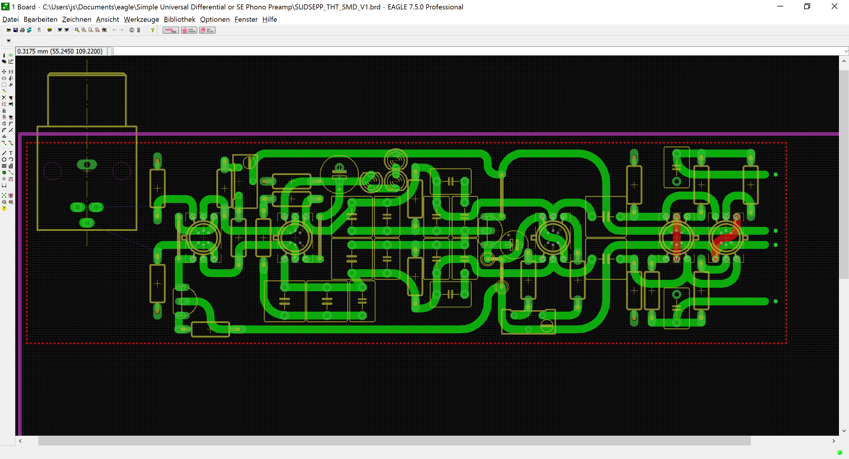

... progress, THT board.
75nF is MKP416 2% PP. What´s the value and type for C3?

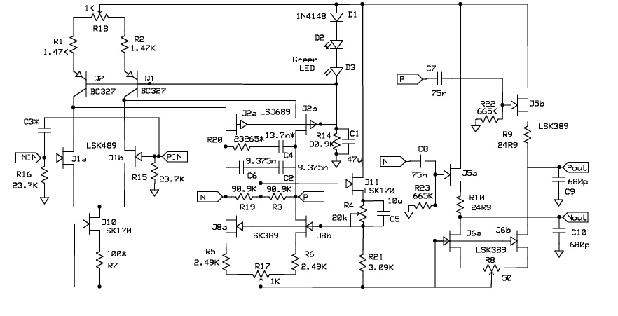

Before folks run with something, I did some simulation and unfortunately the low transconductance JFET's do not work in the cascode stage. There is simply not enough degeneration offered by the 3k resistors. The RIAA conformance is degraded at low frequencies, it might not actually matter to some (~2.5dB @20Hz) and the simulator might be pessimistic. Patrick - I would check your versions for RIAA conformance I have not had a chance yet. This was actually my missing 0.2db in the plots I posted, since most applications will require some attenuation of low frequency artifacts I don't think this matters.
There are two options. The first is to go with the original circuit and use LSK389's or equivalent for the lower devices in the cascode stage and LS94 (apparently ungraded LSK74's which now seem to no longer be available) for the upper devices. This is OK any grade will do here, they need some matching but I think even 5% would be fine with the trim. I would go with the current source loaded follower output, where as stated there are several choices.
The second is to change the upper 3k load resistors to PNP current sources. I don't think this changes the spirit of the circuit. Then the LSJ689's are fine and currently available duals exist for all the sockets. Again I'd stick with the source followers, my original idea was to use the differential output with an external mic preamp such as exist on many external USB sound cards. They frequently have as low as 1K input impedance in differential mode.
There are other options involving higher supplies, etc. but I wanted to stay comfortably in the range of the Silent Switcher to stay on battery power.
I will try to illustrate some examples.
I have done simulations using high hfe PNPs (BC327) instead of the 2SJ74, and they are OK on distortion.
Patrick
But then they're in the signal path, we do need to keep some ritual/religion after all. 😉 When I also made the common mode current sources simply NPN's and used the FET's as cascode I got an enormous effective impedance. Now the very low Cjs FET's work fine on both ends which is good for taking lots of gain out of the one stage with a high Z equalization network.
Thanks you Mr. Wurcer for the info about C3: are there some standard values, I´m thinking about 4p. DIL switch (good quality = TE) for paralleling of 4 different capacitors.
... and I like to modify design.

Here's a rev of the circuit that I think makes sense in terms of utilizing avilable components without multiple ordering for matching. The input load is now a pair of pnp current sources with one of the LED's now an ordinary diode. It should be clear that a board could be laid out to trivially switch between the two versions with a couple of jumpers and part substitutions. I made R4 a pot which sets the common mode output voltage at the N and P nodes (this should have been there in the first place) this wants to be set close to 0 to maximize output swing. R8 trims output offset.

last for today, includes some corrections according last post.
I will post tomorrow new PDF schematics.
