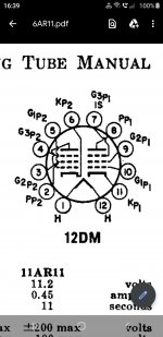

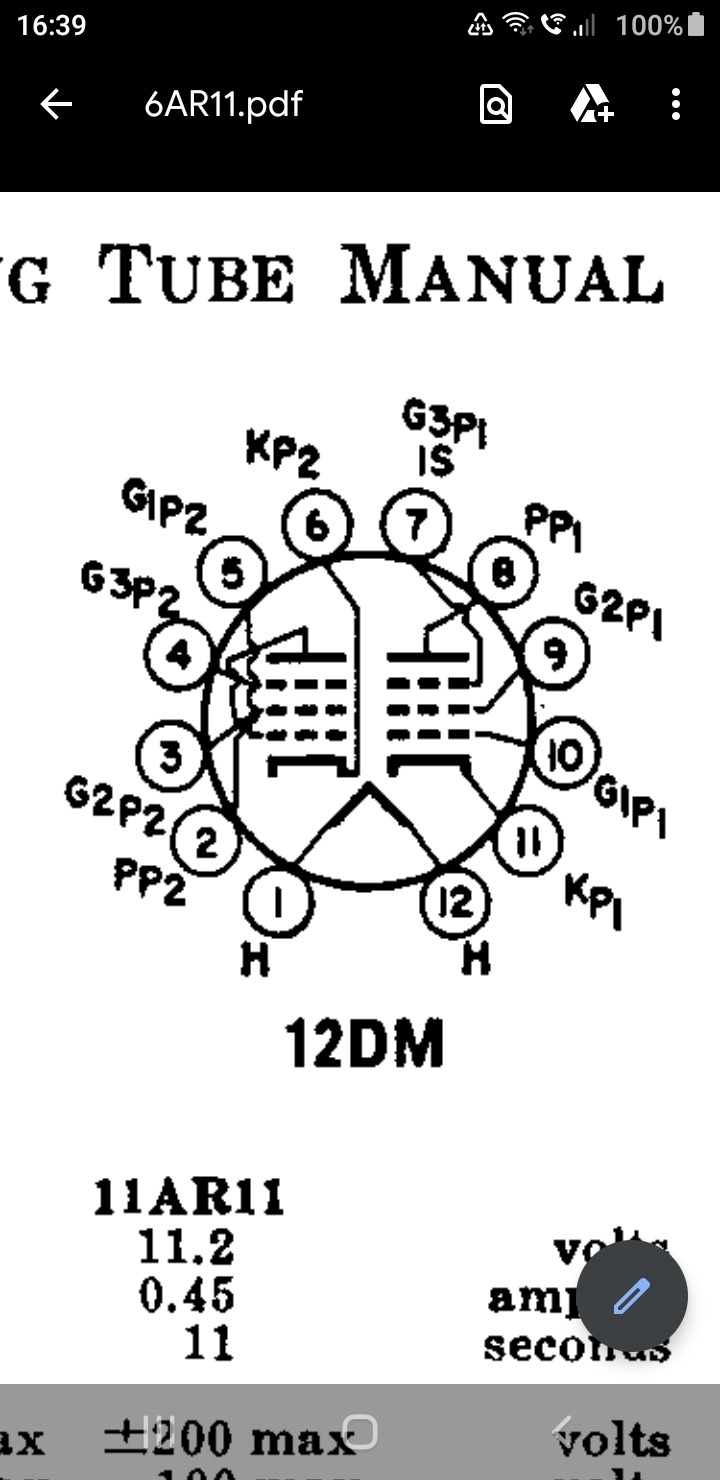

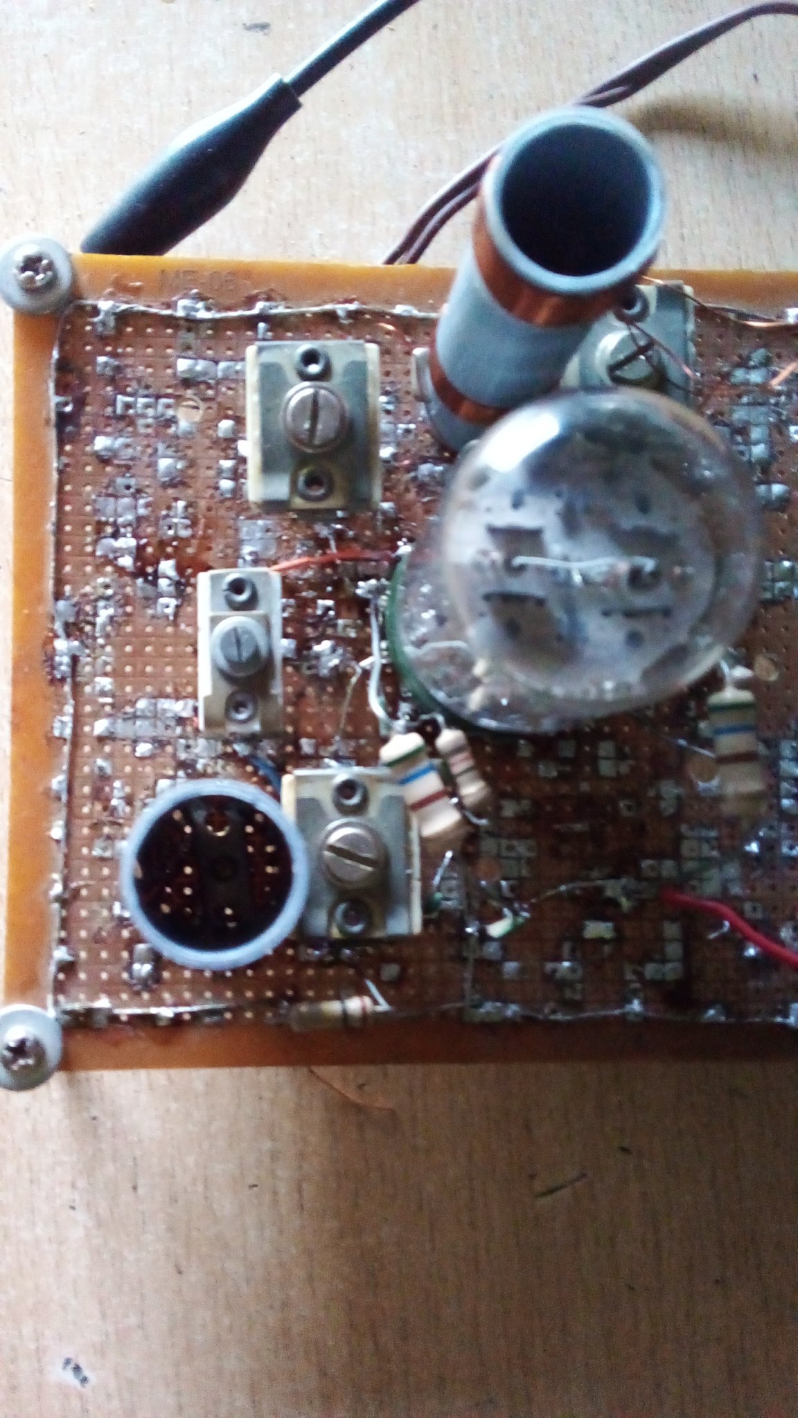

This is the first attempt to make the IF strip. The tube is a dual pentode 6AR11 remote cutoff biased with 82ohm ad 10nf in cathode and about 140VDC at plate and screen. Independent pin for suppressor is grounded. The coil is about 6ųH tuned with about 30pF. 20T copper wire 0.3mm. Former is 15mm diameter. Anode load temporarily is a choke.
Here more pics showing the oscillator beating with the sweep generator signal to check tje cleaness of the signal generated, and a more expanded pic of the layout. The coil still unused will be the RF amplifier anode load.

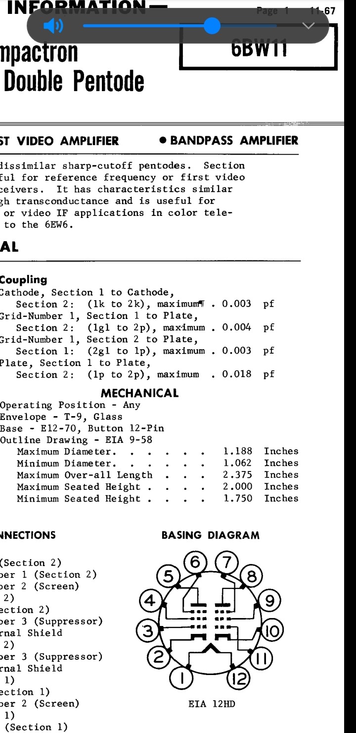

A question for those with experience. My actual idea is to use those dual pentodes cascaded (not cascoded) with AVC. Now I may add a third stage with the high gain pentode inside 6BW11 (there are available a couple sharp cutoff pentodes, one with gm~8mS and another with gm~11mS.) without AVC. It is suggested in the patent from Seeley that there is no need for limiter previous to the detector but a good AVC in order to keep the voltage in the storage cap stable. Now, which may be the advantage of a third stage?.

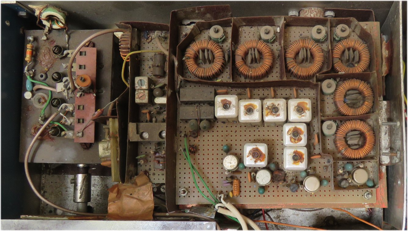

My experience with tubes and 10.7 MHz IF led to abandoning that topology. Using 3 stages with EF184, Philips IF transformers (bandpass), oscillation was difficult to eliminate: even filaments had to be decoupled and fed via chokes. So gain had to be reduced to the extent that the last stage only worked as limiter. That had its own set of problems, one of them the issue that asymmetric limiters transform AM to PM. Hence my 1976 receiver used 2nd conversion to 1.7 MHz with cheap 27 MHz quartz at fundamental frequency. The 2nd mixer, high level single balanced with 2 X 3N211 hence the piece of copper for cooling, with holes containing them. PLL below the IF section to shield VCO from IF input. Limiters with the well known uA703, after the (not so simple) filter (which had to be calculated manually, back then). This concept worked and works very well, and could deal with 300mV signal from the local transmitter in the Netherlands. With tubes I would use something similar, no matter the amount and or space required.

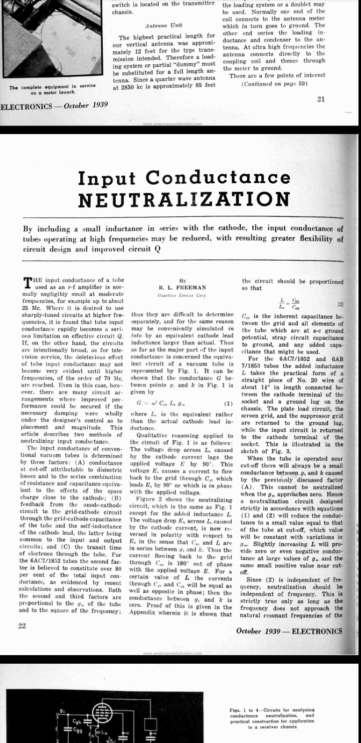

Don't forget the issue of Vg dependent Cgk: TV IF often used pentodes with non-decoupled cathode resistor to decrease the effect of detuning filters due to AGC. For 10.7 MHz FM IF the easier solution is to design IF filters with low L/C quotient and tubes with low Cgk, requiring more (but less critical) stages.

I found in an old WW magazine a recipe that using a small inductor in the cathode may cancel out input conductance with lower gain loss than using unbypassed cathode resistor. Also it seems that H. A. Wheeler has published a paper where he suggest to use a small inductance in the screen supply, a solution widely used in the 6CG8 and derived tuners. But could't find such a paper to learn the appropiate value of such inductor.

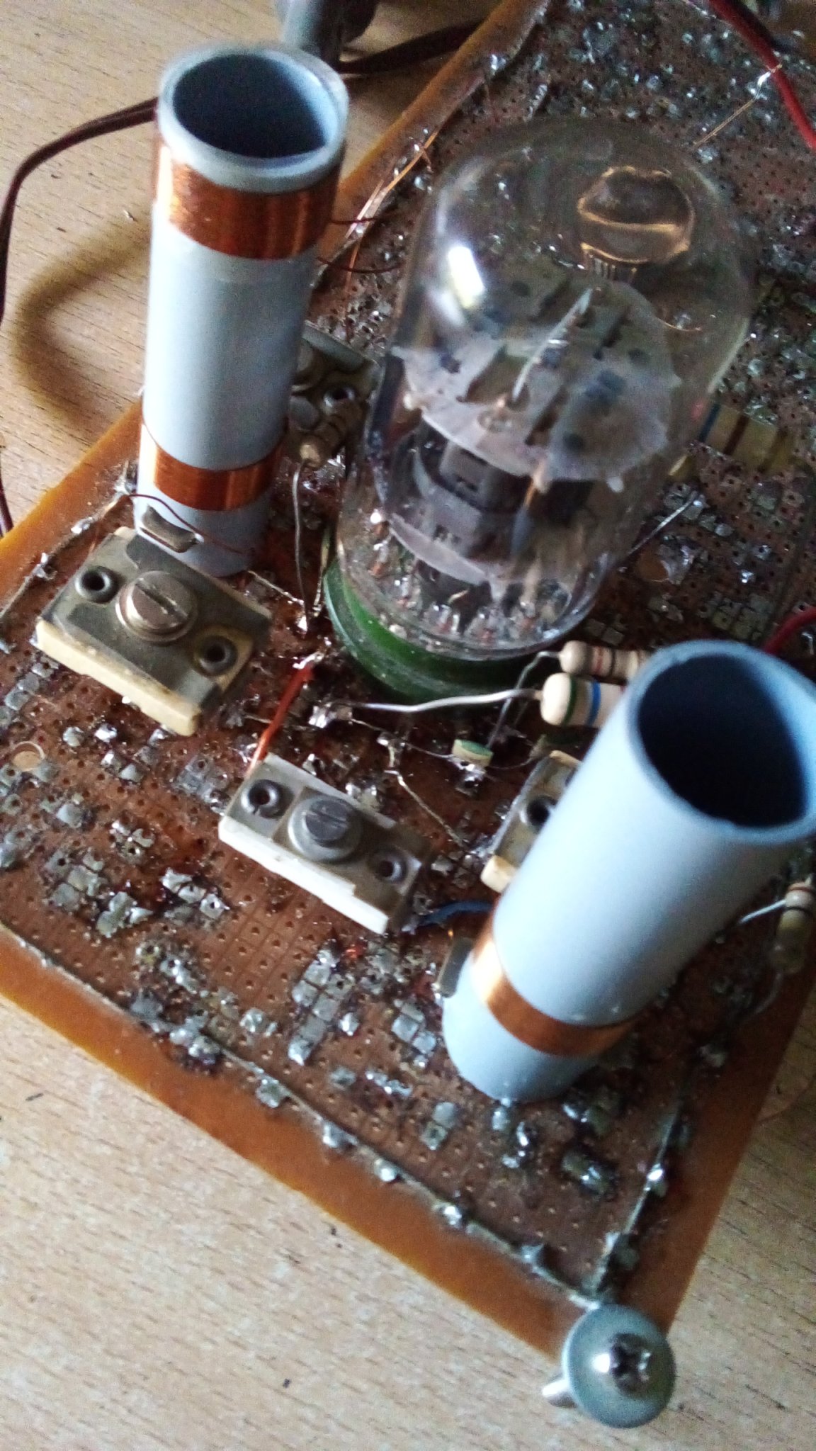

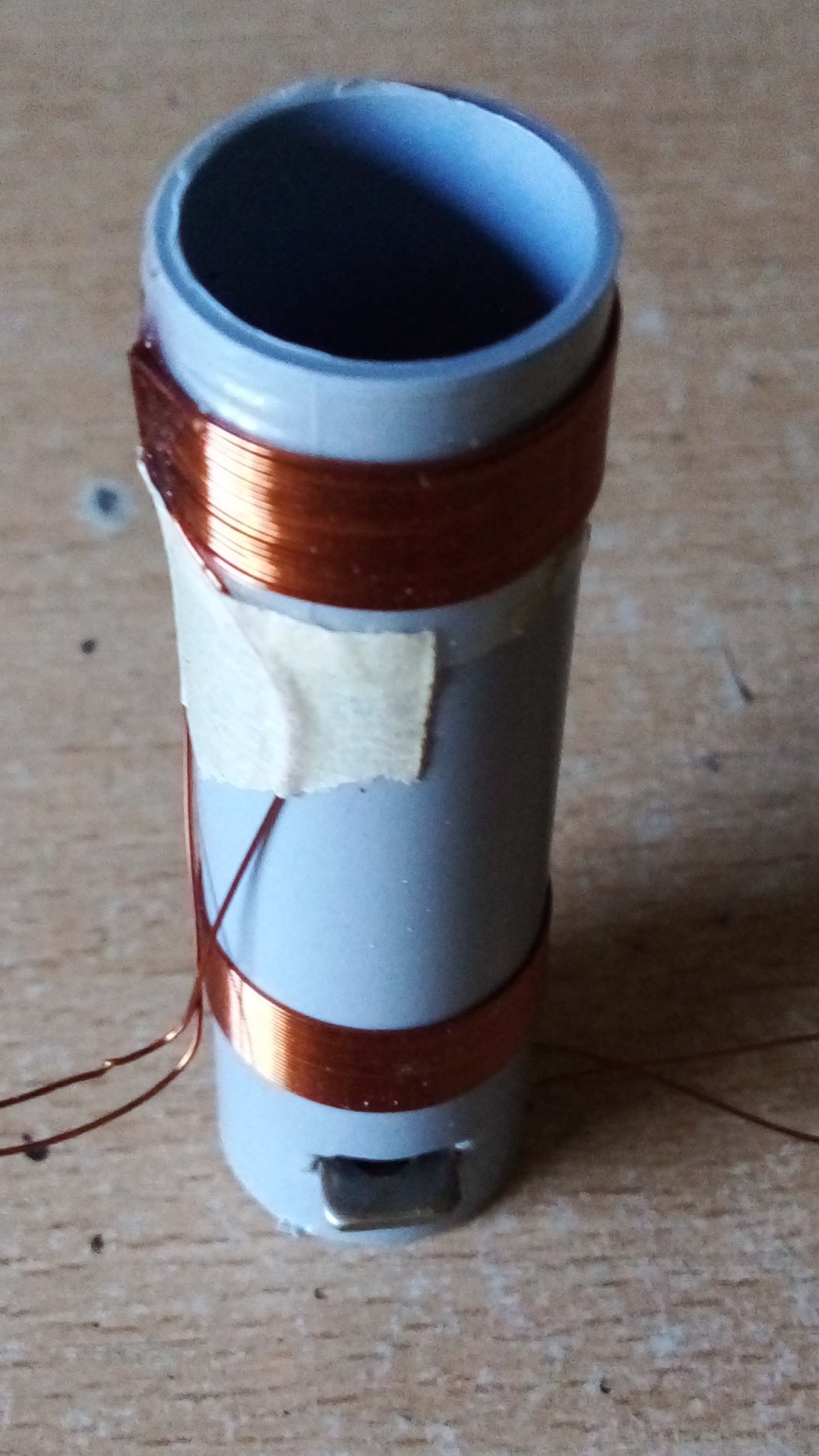

In the other hand I made the first IF transformer air cored. Below is the pic. The upper winding is movable sliding in the bobbin as the wire is wound on a short piece of unglued mylar tape. This is the grid secondary. The lower one is the plate coil and is fixed. The piece of light brown tape is temporarily there to fix the coil while the cyanoacrylate adhesive fix the coil to the mylar tape, so it doesn't unwind while adjusting coupling. Tomorrow I will wire it to the protoboard and shall see what happens and if it behavior is proper one.

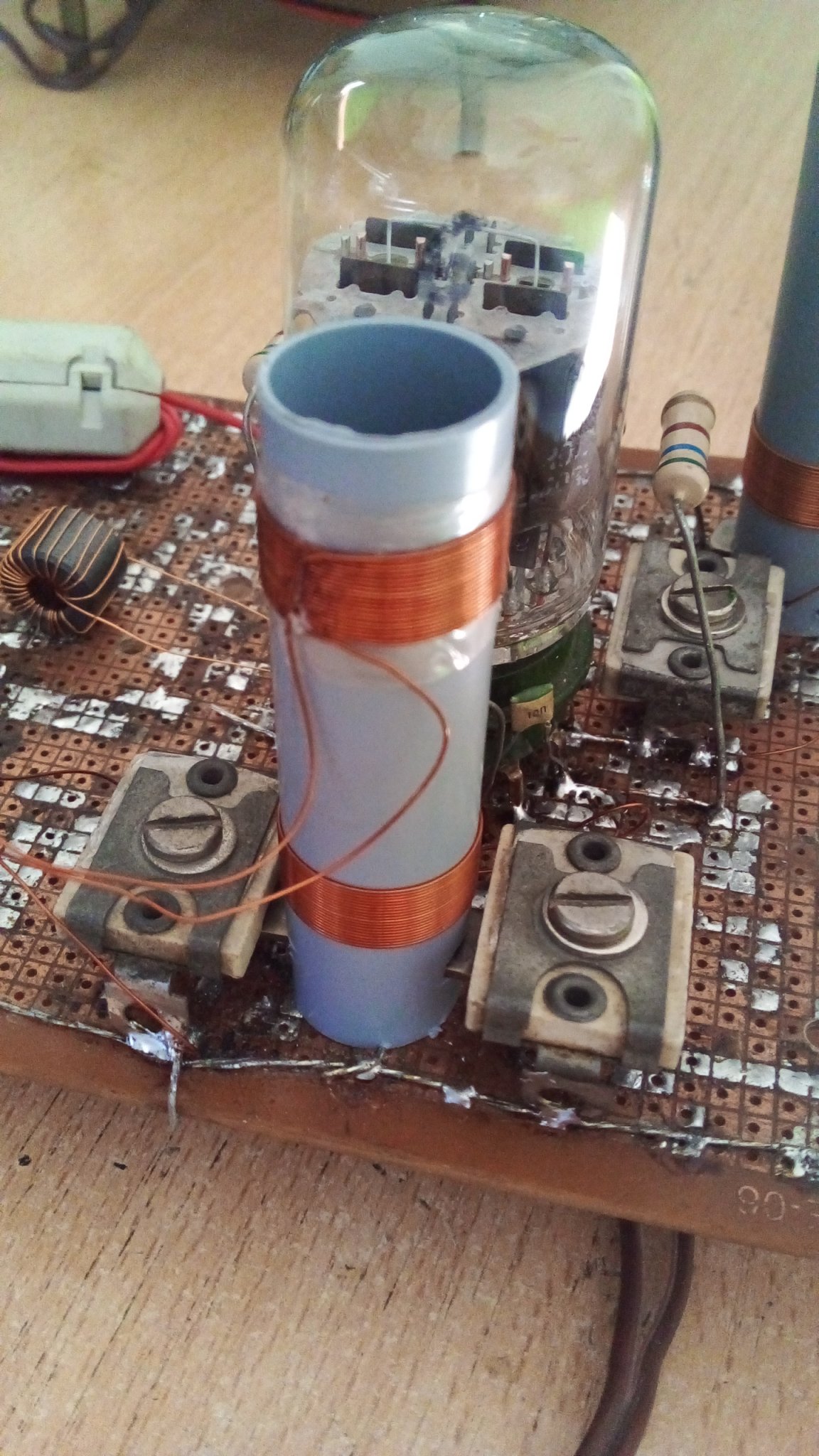

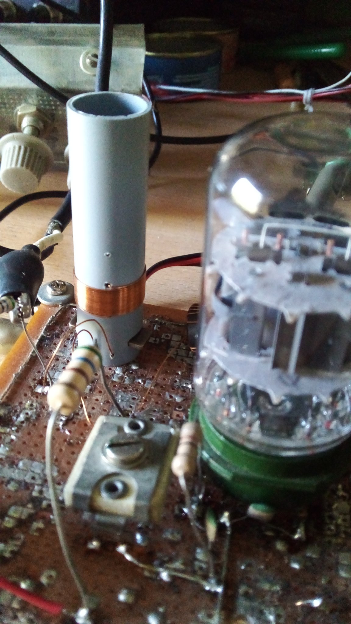

I had to reorder and neutralize adding a smaller mica trimmer the first stage of the IF amp as it was very unstable. 6AR11 has a gm~11mS and lots of gain. Now I shall make the second stage.
