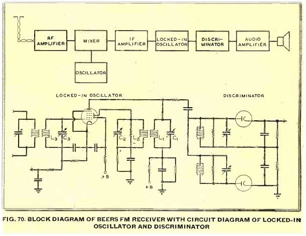

I understand they need to use a fairly high subharmonic to keep the interference at IF low (the nth harmonic distortion of an oscillator running at the nth subharmonic of the IF lies at the IF, and distortion usually decreases with the harmonic number).
The "Syntektor" diagram suggests that (maybe issue of avoiding patent payments). In the meanwhile I found a source with better explanation of the FM1000 (no subharmonics involved):Where did you find that they use the fifth subharmonic?
https://worldradiohistory.com/Archive-Rider/INDEX/Index-16-18.pdf
This diagram suggest that synchronized oscillators for FM demodulators were popular but no conventional tube could match the performance of the FM1000.
From https://worldradiohistory.com/Archive-FM-Magazine/Standard-FM-Handbook-Milton Sleeper.pdf
This schematic lacks the grid return to ground. It is ok the grid series fedd, I like it very much but the coil hasn't return to earth, possibly at the bottom of the oscillator tank.Below the circuit diagram of the synchronized oscillator used as FM demodulator. Probably won't work with other heptodes but you never know. Found it in a German article.

My look always is indirect: trying to understand the fundamentals, details come later. So after contemplation I immediately started to simulate a circuit with a PLL with VCO tuned to 1/5 of the input frequency and a quadrupler for the mixer (input sig - (4/5)X F(vco)), closing the loop of that frequency feedback PLL. Sim shows that would be great and could easily be adapted for tubes.This schematic lacks the grid return to ground. It is ok the grid series fedd, I like it very much but the coil hasn't return to earth, possibly at the bottom of the oscillator tank.
