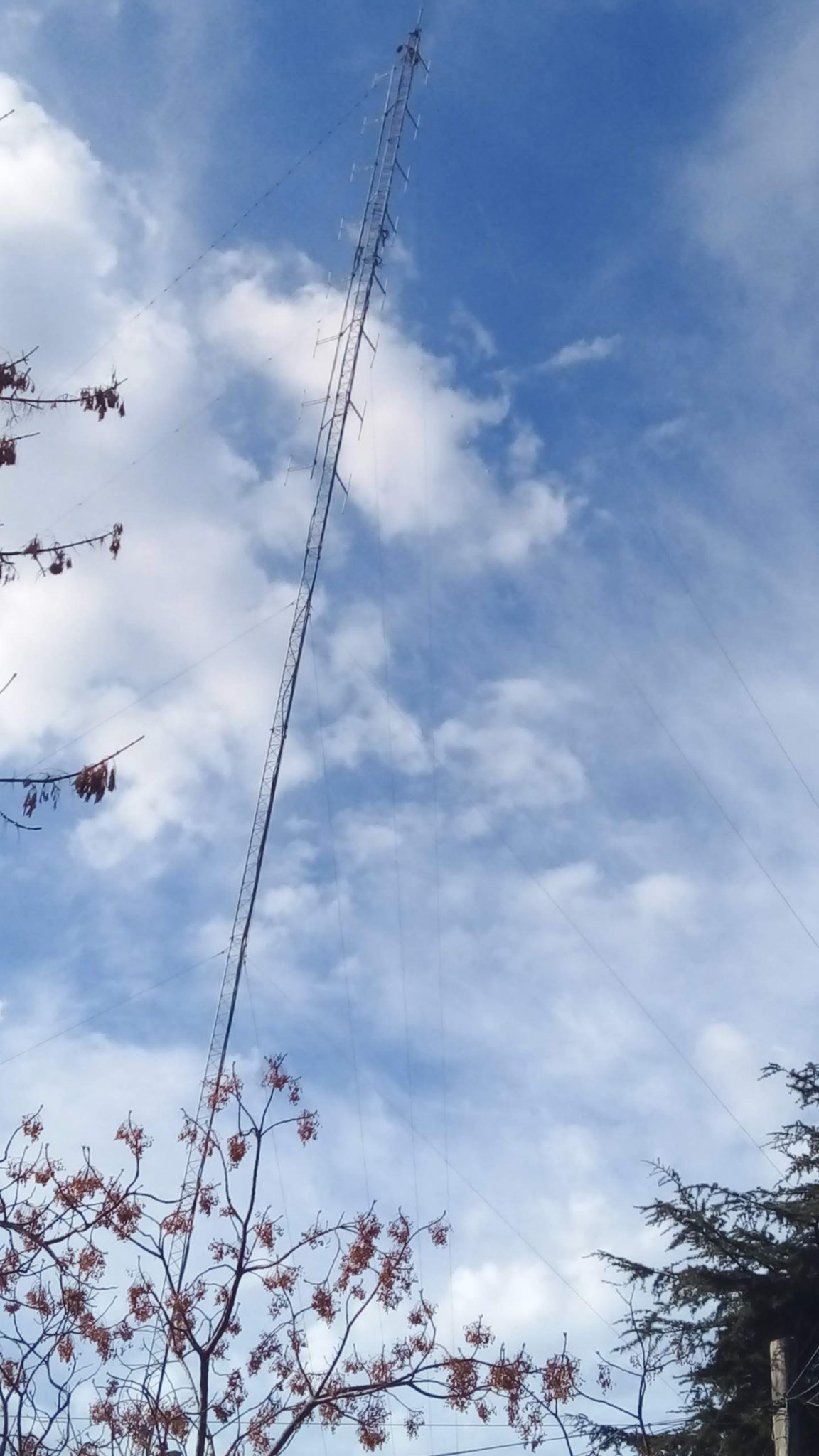

OK. Things are clearer now. Thus for a first try, I shall go for 200KHz at the IF. Having into account the large quantity of stations close to me (say 1Km or 2), with more BW I have suspicion of large splatters (as we call in ham radio) will be present. I was searching in the internet the datasheets for the MuRata IF filters widely used in ss receivers, and they go from about 180 to 280KHz. In any case, when building the decoder, if I find it is too narrow, and as the trafos's secondary will not be glued to the coil former, I can re-adjust them further.
The tower below depicted is only 800m far from me 😡.
The discriminator filter usually is wider than that for the IF. Compromise with wider discriminator is linearity vs lower audio output, only an issue for commercial sets.
I counted 8 vertical dipoles on that tower so it's unlikely to be "just local coverage". It reminds of the AFN Europe station at a few Km distance from my house in the Netherlands. 100mV at the receiver input, on commercial sets AFN was "all over the dial" and at the time there were no cheap solutions. I managed a front end with a BFT66 at 10 mA followed by a single ended chopper mixer (A few V of LO on g1 of a 3N211, signal at g2) which was surprisingly linear also according to (no longer available) datasheet so I could receive even Eastern German on a daily basis.

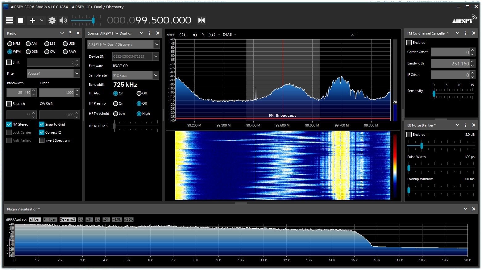

Correct, I'm using m for modulation index. For m=5 and max audio frequency 15 KHz (no stereo) 180 KHz IF would be sufficient. Most available mass-produced FM sets here are fitted with a few IF coils (no BPF) and can cope with a much larger modulation index, motto "louder is better". From the observed spectrums of mono stations I could verify that larger m.What do you mean by m?

So you mean the frequency deviation divided by 15 kHz, m = 7 then means that the frequency deviation is 105 kHz.Correct, I'm using m for modulation index. For m=5 and max audio frequency 15 KHz (no stereo) 180 KHz IF would be sufficient. Most available mass-produced FM sets here are fitted with a few IF coils (no BPF) and can cope with a much larger modulation index, motto "louder is better". From the observed spectrums of mono stations I could verify that larger m.
Indeed, it's what many of the spectrums are suggesting, confirmed by comparison with output of signal generator (Marconi Instruments 2022A).So you mean the frequency deviation divided by 15 kHz, m = 7 then means that the frequency deviation is 105 kHz.
