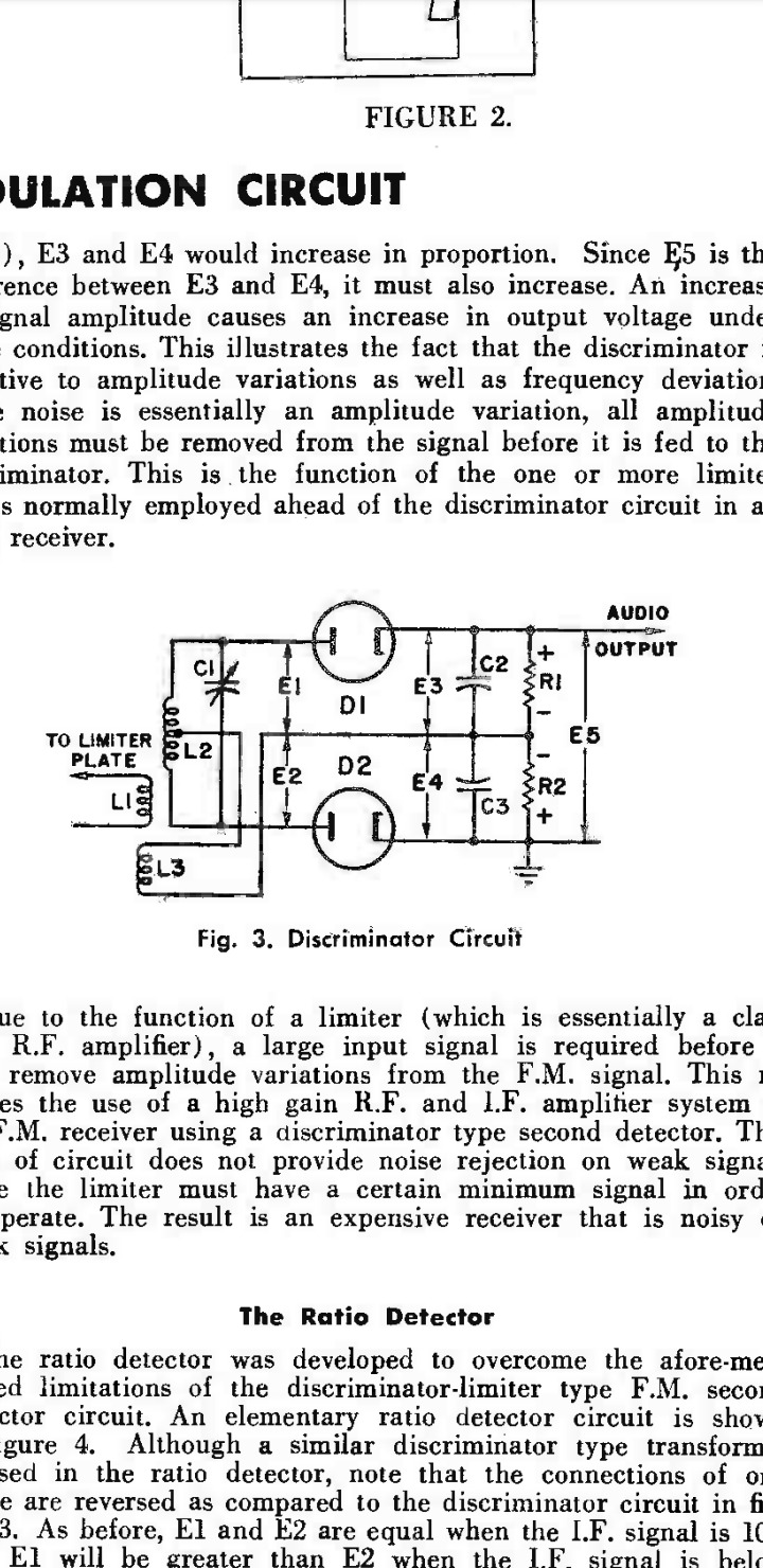

Other comment: what method can you suggest me to get from the FS detector the best perormance, including the coupling coefficient or mutual inductance. One is fixed; the tertiary. But the tuned secondary in the trafo is moovable to and from the primary along the bobbin. But unsure if it is better to adjust this stage only or after being adjust the previous stages, all of them with its grid secondaries moovable the same way. I say it having in mind future stereo decoding and the lack of a calibrated signal generator, only a couple of digital VOM's, a 40MHz oscillograph and the sweep genetator EICO 368 restaured.
Seeley in his patent said "coupling less than critical" (sic). But how less? And he uses it for estabilizing receivers, not necessary the same adjusting for FM detection.

I learned to align receivers without any measurement, just using the ears. The IF transformers were aligned on maximum noise (no antenna connected). Connecting the antenna then resulted in reception, and the discriminator was aligned for best sound. The exact value of the IF isn't a problem, doing it right means that none of the alignment cores / trimmers is at an extreme: all about center value.
With a 40 MHz scope it's easier. In that case you can align enough to see the IF signal. Coupling of primary - secondary shows up as AM - you have to adjust coupling so no AM is visible (overcritical coupling shows as double "humps" with AM). Doing that for the entire chain results in an IF signal where any discriminator can be aligned optimally by ears alone, plus the "tuning feel": that has to be 100% symmetrical, irrespective signal strength.

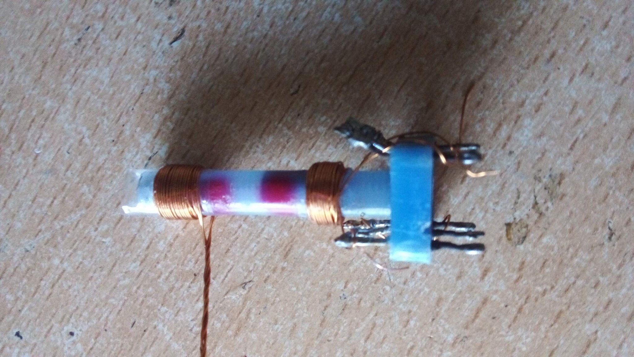

Ok to all. I reduced the load resistors of the detector from 470 to 100Kohm. Although the coupling of the transformers remain unadjusted, in a strong local FM station it sounds better. I am now making another detector transformer becase reading an articule from Sturley and re-reading the original Seeley patent, it Is apparent that best sensibility of the detector Is found when the ratio of the tertiary voltage to secondary is sqrt(2). I made this traffo using equal coils. The new one will be made following this statement to see what happens.

The new transformer for the Foster Seeley detector following Seeley directives, still unfinished. Observe taller secondary winding (bifilar 16+16T). Adhesive is still fresh and remains interconnection of windings between them and to the base pins; and the tuning caps.
