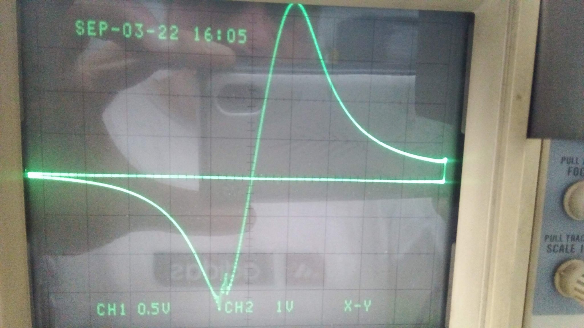

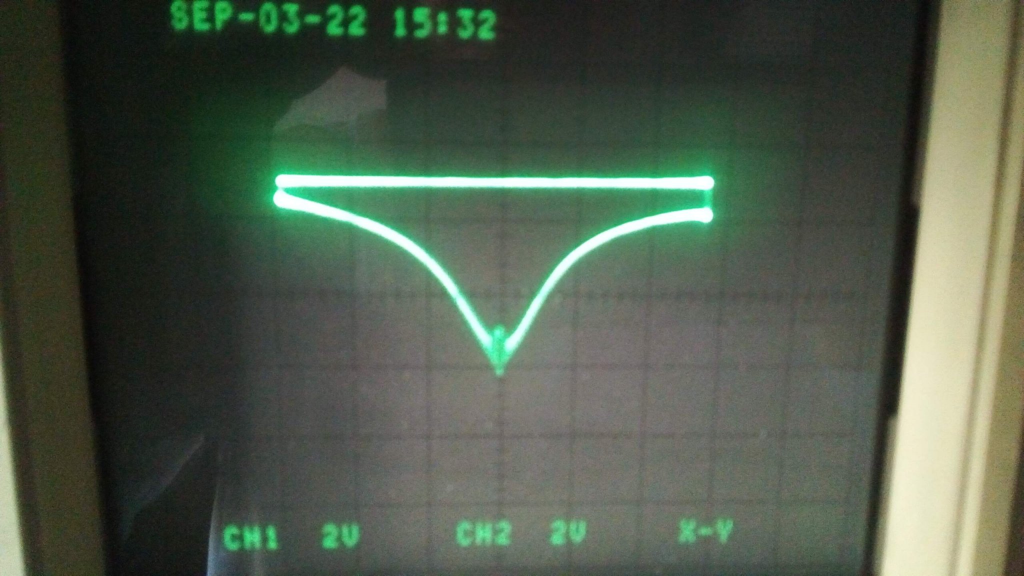

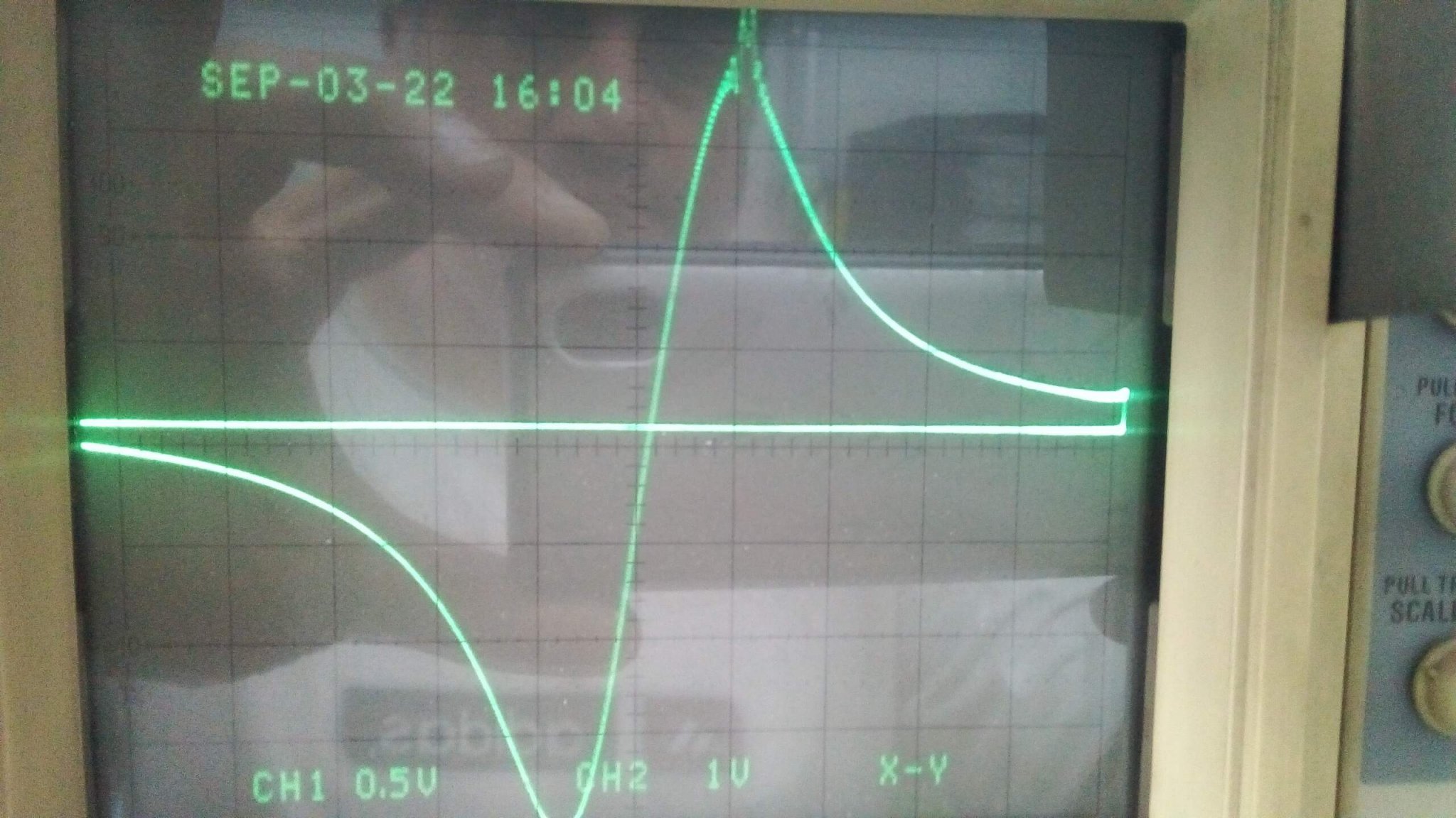

Some minutes ago l adjusted the coupling between coils at the phase discriminator transformer. Here is the result. First, the primary resonance using the 12MHz crystal as marker. The oscillo tip is at the junction of load resistors R17 and R18 where most of the AM signal is developed. In the following order, reading the FM signal at the top of loading resistors (R17) with a 100K and 430pF low pass filter to reject residual RF that makes the trace unfocused and in some instances let the IF start oscillating because of radiation of IF from cables and oscillo. The peaks are aproximatelly +/- 120KHz above and below 12MHz center frequecy for a BW of 240KHz (I listen opinions regarding if it is OK or insufficient for stereo signal). A DC shift whose cause isn't clearly determined when peaking the lesser one but my suspicion is that it corresponds to maximum conduction of upper diode in the detector. The gen signal is applied to last IF grid loading the secondary of the transformer T3 with 47R which also terminates gen cable impedance.
Now the audio output is strong compared to previous listening although some stations sound distorted; mainly those who don't came the limiter into action.
Opinions and suggestions welcome.

You need 312KHz for stereo. I'm not clear what the second and third picture mean exactly, or at least why there are two, but the third picture shows an off-centre alignment. You should have 0VDC at the sound take-off point, and the top and bottom of the curve should be equal height, and the curve should cross zero at the marker. The centre part of the S curve is better now but it still isn't straight. Linearity here corresponds to linearity of the audio.
We need a current schematic to discuss further.

Second pic shows the 12.12MHz marker at top of waveform and third the same at 11.88MHz. Remark that it is the detector tranfer only, all 3 previous stages were deactivated and inoperative during the adjustement. Tomorrow perhaps l shall make the adjustements at those 3 steps.
A full version of the squematic can be found at post #305 already posted.

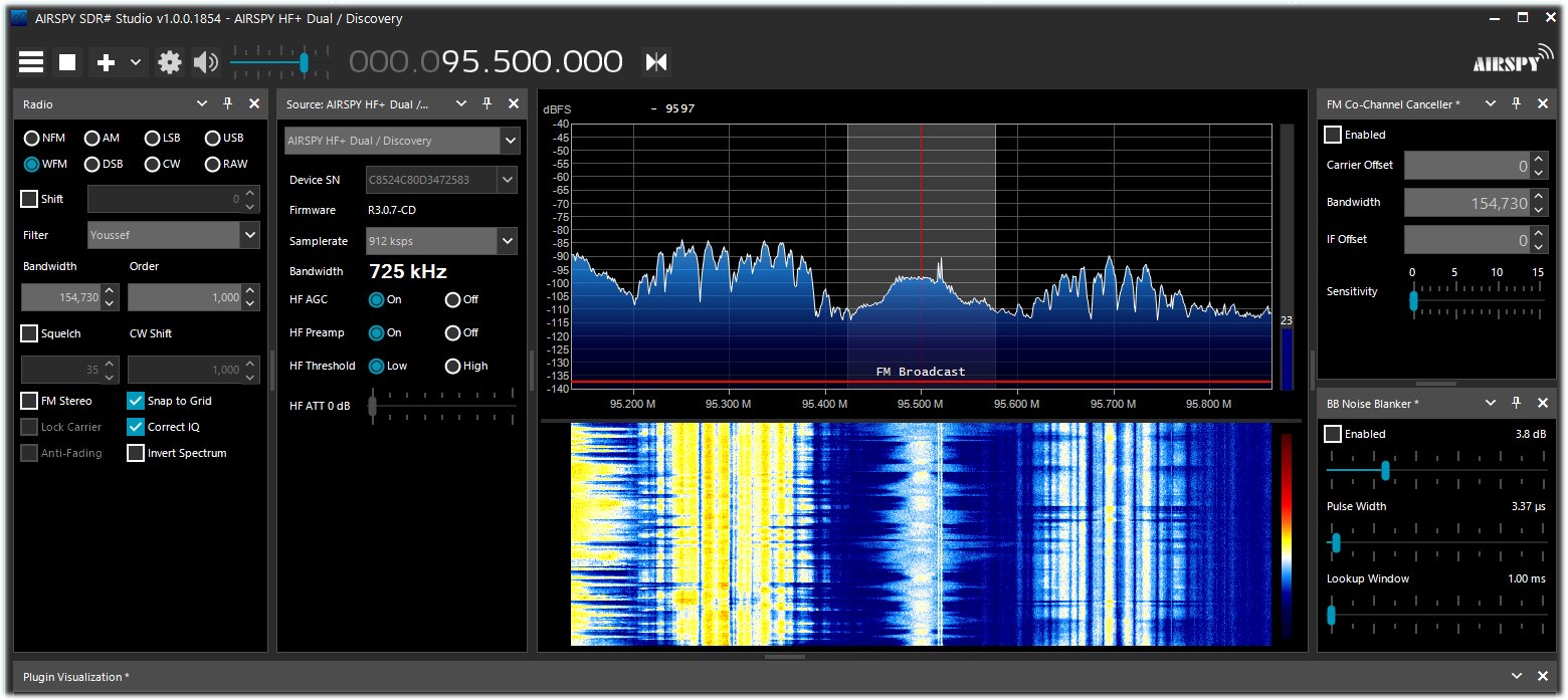

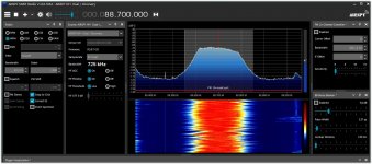

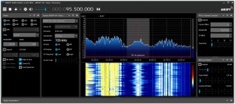

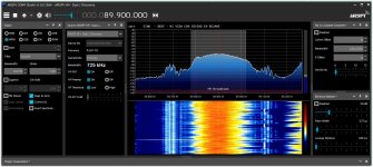

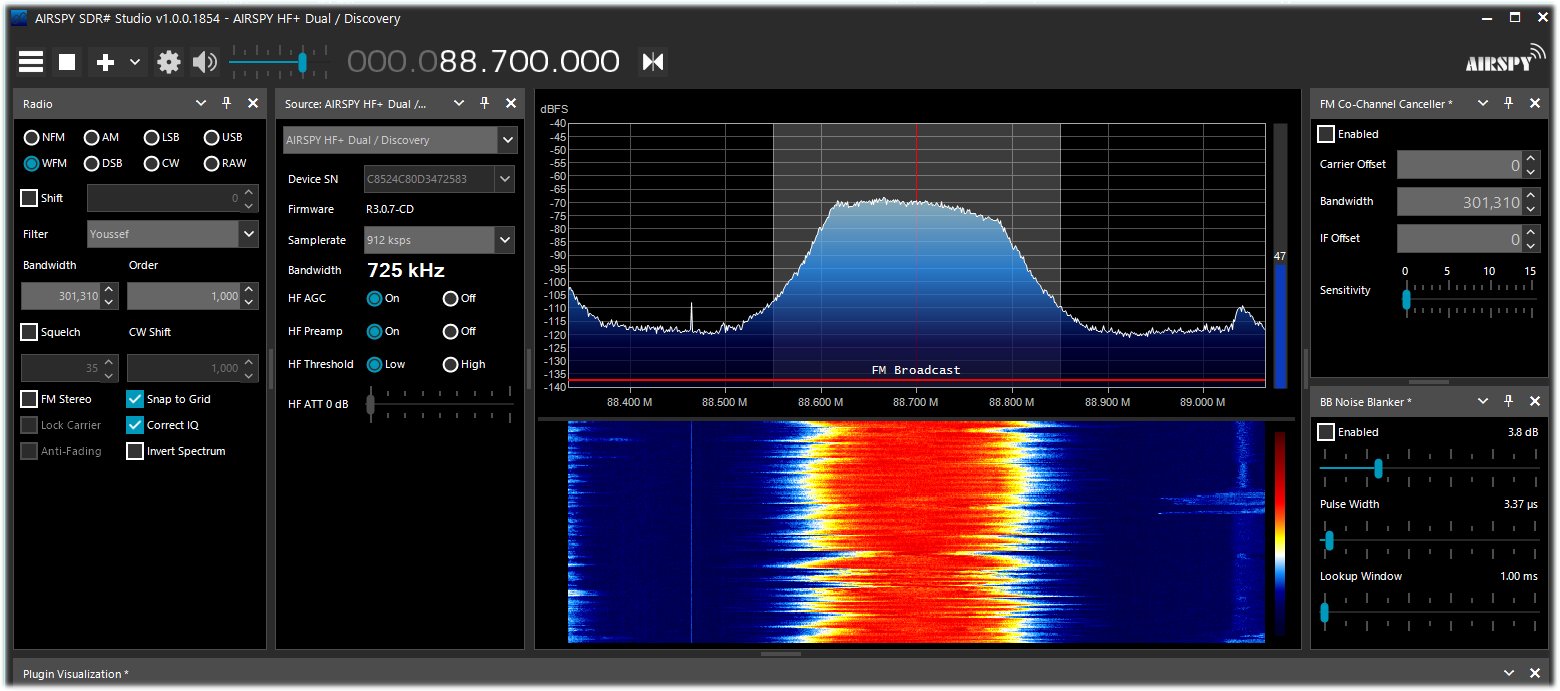

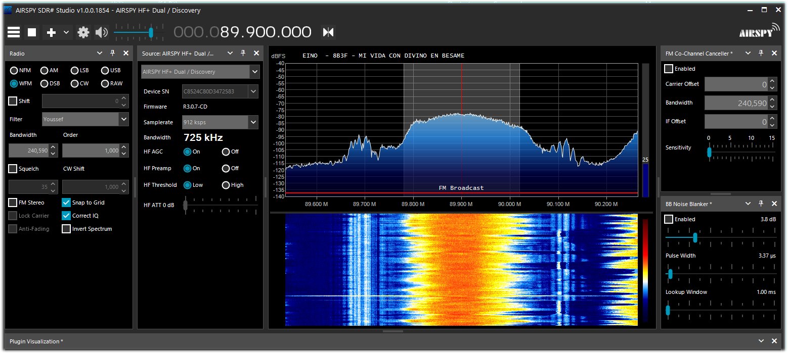

In a situation where every broadcaster would behave conform regulations (bandwidth, stability, power), 240 KHz for the discriminator would be enough. But AFAIK that situation nowadays could be called "ideal" because there are too many violations. So for a receiver with 1 bandwidth, a compromise has to be made. 350 KHz will sound great but it limits the amount of stations that can be received. Conforming to 200 KHz channel spacing only works when a majority of the most interesting stations follows the regulations.
The pics show some examples for the border region Costa Rica - Panama: S1) commercial (blaring, using compressor), S2) cultural (so weak, no compressor, needs only 150 KHz). S3) religious (using compressor too), BTW the pics also show good examples of multipath.

You are confusing maximum deviation with required IF bandwidth, or in other words what goes into the transmitter as opposed to what comes out of it in the form of sidebands. A look at the Bessel functions and the 53KHz audio bandwidth show that you need 312KHz for maximum stereo. This is often given as 240KHz but that is based on a mistake, ignoring the interleavng effect. Most modern tuners are using 400KHz at the discriminator. HH Scott used 1MHz. You will certainly want to have optional higher selectivity in the IF strip, but not at the discriminator.
Your first picture shows transmission beyond 300KHz. Second one looks like mono.

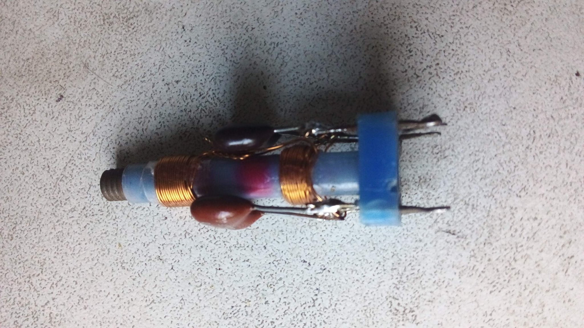

There was some time during 80's or 90's that LRA Radio Nacional transmited a SCA called Muzac. Rapidly dissapeared. I remeber had built a receiver using horizontal coils and a 3N128 FET circuit from a local magazine Radio Práctica or the like, disappeared too. It used the two coils from Synchroguide system, one as input tuned circuit (the taped one) and the single wound as detector. The original circuit used positive grounding and a 9V battery, I reversed the circuit to negative ground and put into my father's build AM/FM tuner. But, again, unpleasant listening.
