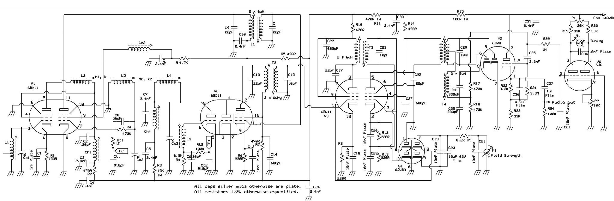

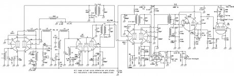

This's an extension of the previous schematic when I unvoluntary omited the zero center meter for proper tuning with the aid of an 6J6 and some passive components, and a S-meter or Field Strenght Meter hooked as load of the first limiter, and it its indication is directly proportional to signal as there isn't a DC loop gain or AGC at the present. The Zero center meter was from a vintage discarded industrial thermometers (The instrument gave the difference between setpoint and actual temp only) and the S-meter is a microammeter from old double cassette player. No idea of the characteristics of both of them by the moment.
Interesting to see that in case the diode discriminator wouldn't perform well enough, it would be fairly easy to rewire for the enneode 6BE7 or (miniature 7 pin socket) gated beam 6BN6 which presently is rather cheap, and both (better) alternatives would provide sufficient output to omit the AF amp.
No, even with semiconductors it isn't a good idea. Although an oscillator can be made to synchronize in a required frequency span, the current through the device in that span is far from linear (according to what I measured, long ago). With tubes the best guess would be a 2 anode beam deflection device like 7360 functioning as VCO plus multiplier, signal to the deflection plates (simple but effective PLL). But in theory any penta (and+) grid tube could be used in a synchronized oscillator, and then measure the response.
That linearity (of output of synchronized oscillators) hasn't been solved indirectly could be concluded from https://patents.google.com/patent/US2440073A/en

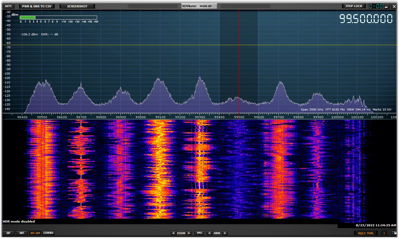

But with the return of democracy in 1983, the number of local FM and AM stations (mostly improperly adusted) grow up like fungi after rain. Time and the chaotic situation in my hated country did that some of them dissapeared and other joined. During those years of frank decadency, some local low/medium power (I estimate 1KW without stereo signal) appeared too. Some christian mainly from brazilian predicators and community services like jewish, bolivian paraguayan and the like. I frankly don't have any particular trouble with them, anyone can broadcast all he want. But this chaos above mentioned make that, for example, in a particular frquency coexist 3 stations along those 20km. So you travel to CABA (acronim for Ciudad Autónoma de Buenos Aires, like a DC town) your receiver changes the type of content without touching the tuning of it 3 times.
If I walk 7 blocks (say 800 linear meters) of my neighbourhood from Garay to Pasco, l am able to see 2 tower with its radiators, one is 98.3 and the other is a christian whose freq is unknown. Imagine you my situation. Sincerely unknow if they are legal or not. Add to it: radiation from cable TV with corroded conectors and broken coaxials, led lighting whose interferences goes up to our 2m band (144/148 MHz, l look the quasi-smeter of my Yaesu FT7800 with up to 5/6 segments on) and myriads af celular phone, their chargers, smps from TV's and PC's and microwave oven... puffff.....
Observe my QAP frequency with no squelch opening !!! All thrash in the air and only 5KHz BW.

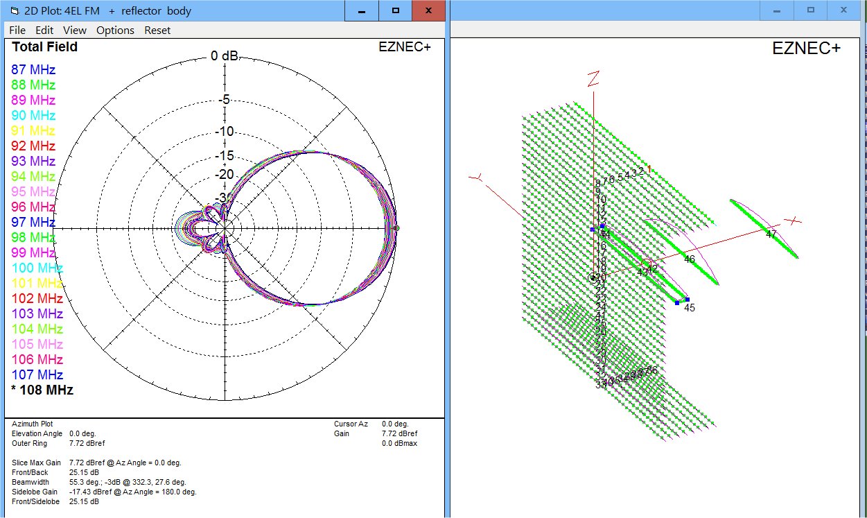

VHF here is without QRM but the distant signals are weak so require antenna with gain plus preamp directly connected to radiator. There still is a producer of FM antennas but rather expensive: https://www.innovantennas.com/en/shop-page/26/88mhz-108mhz-broadcast.html
However with now free simulation software it's child's play to design antennas like the 4 el with grid reflector.

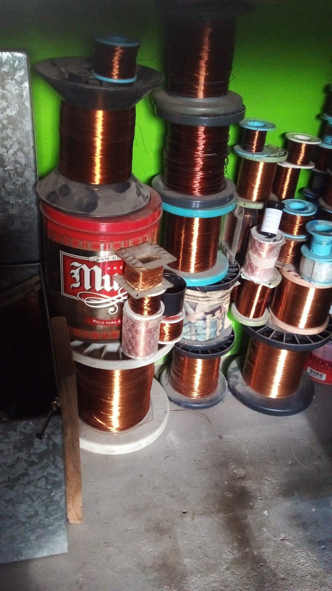

Completing the answer to the why of using a tertiary coil in place of capacitive coupling from pri to sec (posts #289 & #296), here is it. Observe the IF can size I got and the silver (?) mica caps I have. Clearly 2 of them can be placed inside the shield but no place for a third. In the other hand, a large (?) stock of copper wires for coils. The red can has lots of Nichicon caps saved for future use, perhaps.
