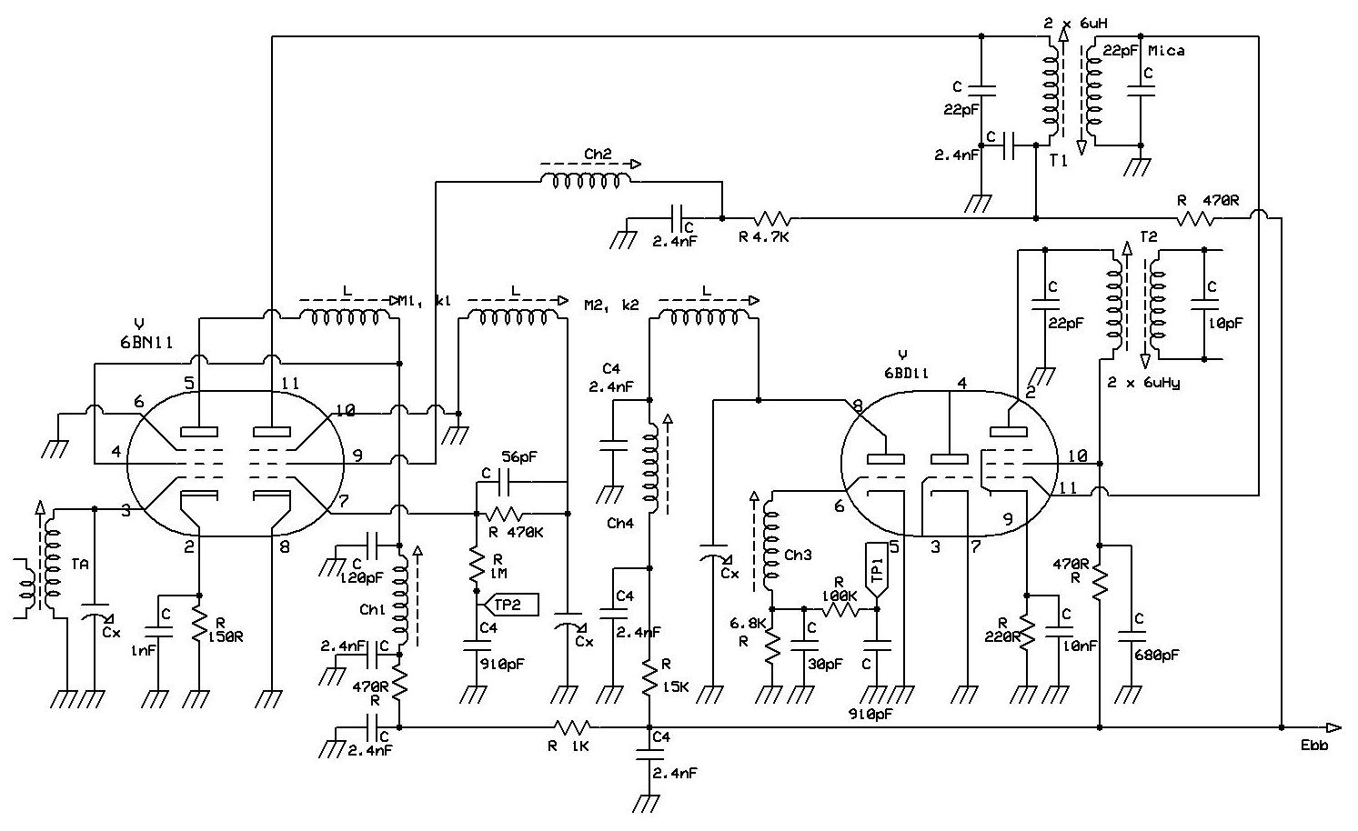

Here is a partial schematic of the front end with both compactron tubes, 6BN11 RF amp and mixer and 6BD11 oscillator and 1º IF. There still unused a triode section, it will be used further for AFC.
There are two test points, one at the mixer's grid, another in the oscillator grid. Both must be highly unlinear, the first to generate a severe over driven in order to obtain high conversion efficiency, and the other to attain high efficiency of the oscillator. As a consequence, measuring grid rectification is an estimable parameter to see how are they doing its job. This sounds rare for audiophiles, but in RF things are different. As always, some values and the general circuit may change.
Another variable (useful for experimentation) is the mixer's screen grid voltage: the mixer might perform better with a lower Vg2 than is used as RF (IF) amp. Grid- current driven audio amps require an extra tube as DC coupled driver so unpopular while tubes were expensive. It once was an interesting topic in Linear Audio Vol. 6 & 8. Using a modern opamp to drive the grid could further improve performance, especially when using high gm tubes like 6P15 / SV83 / E130L.

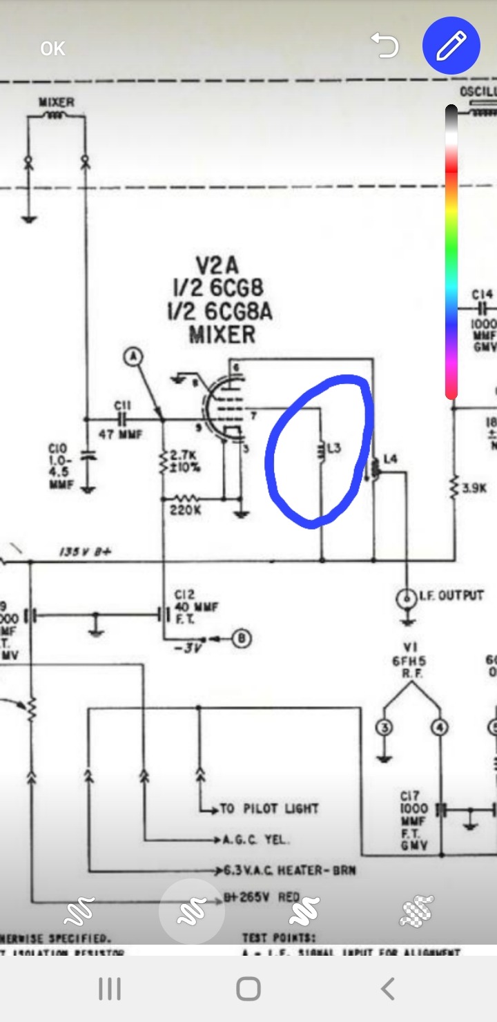

Agree 100%. Observe in the schematic a 4.7K (provisory) screen grid droping resistor and no cathode bias. Also, l saw in TV tuner patricularly later ones, that the screen grid is live for RF thanks to small choke, sometimes some turns of wire or a ferrite bead. I learned that it causes regeneration in the control grid thanks to the presence a transfer negative conductance. It helps improving the mixer behavior.

Interesting detail, pentode mixer improvement with screen inductor. Is there an article describing the effect in a verifiable way?

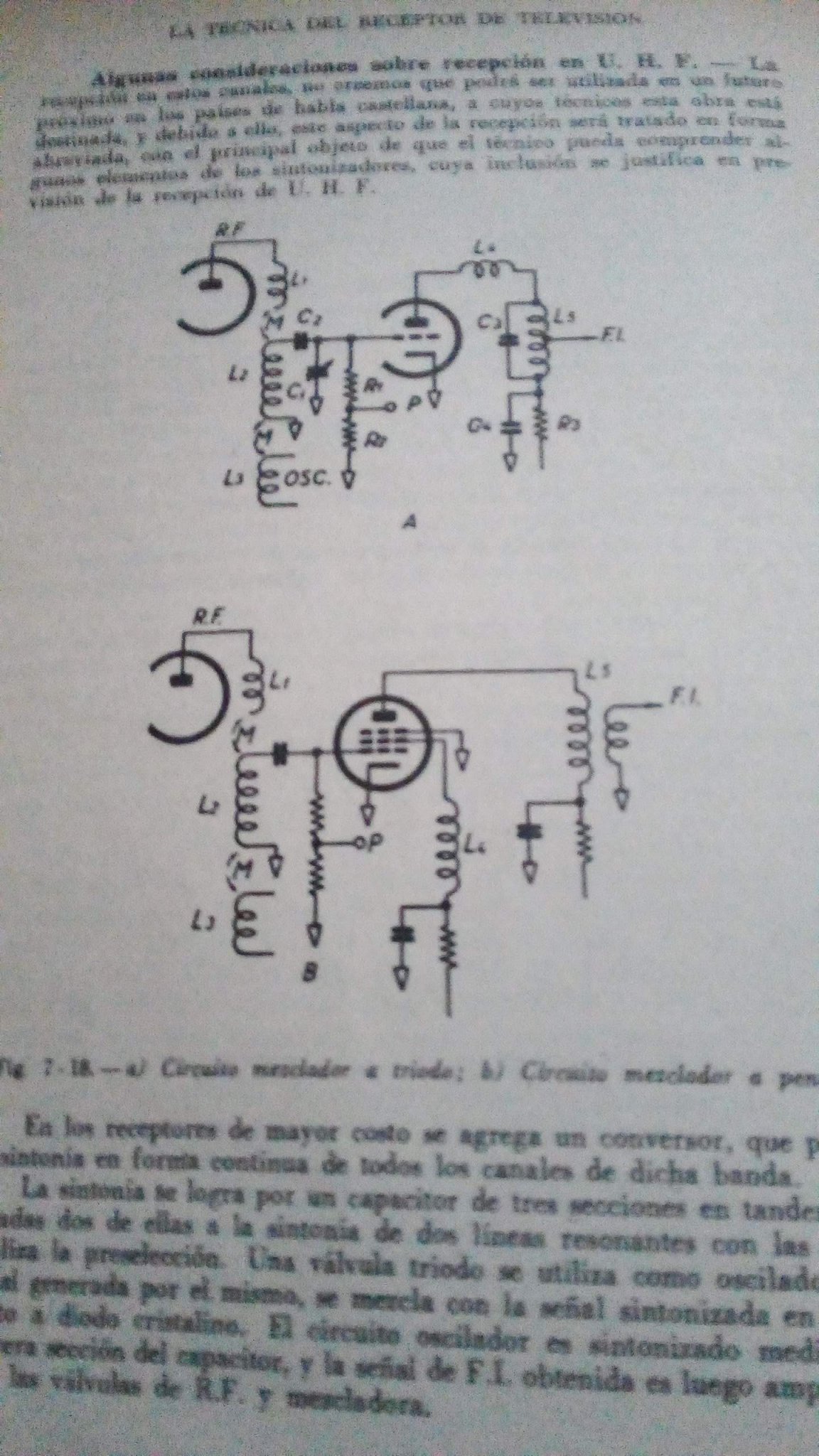

The first time I read about screen regeneration was in an argentine book from Algarra & Rodríguez specifically about TV's of the tube B&W era several years ago. But recently I found that this was known in the Terman's books and an magazine article I downloaded and printed. Let me some time to found it.Interesting detail, pentode mixer improvement with screen inductor. Is there an article describing the effect in a verifiable way?
See for example US2750450 assigned to J. C. Achenbach particularly the paragraph at column 4th from line 7 to 23; and US2881265 by P. C. Swierczac pages 5-6 and 7-8. But the first of both is more juicy for my taste.

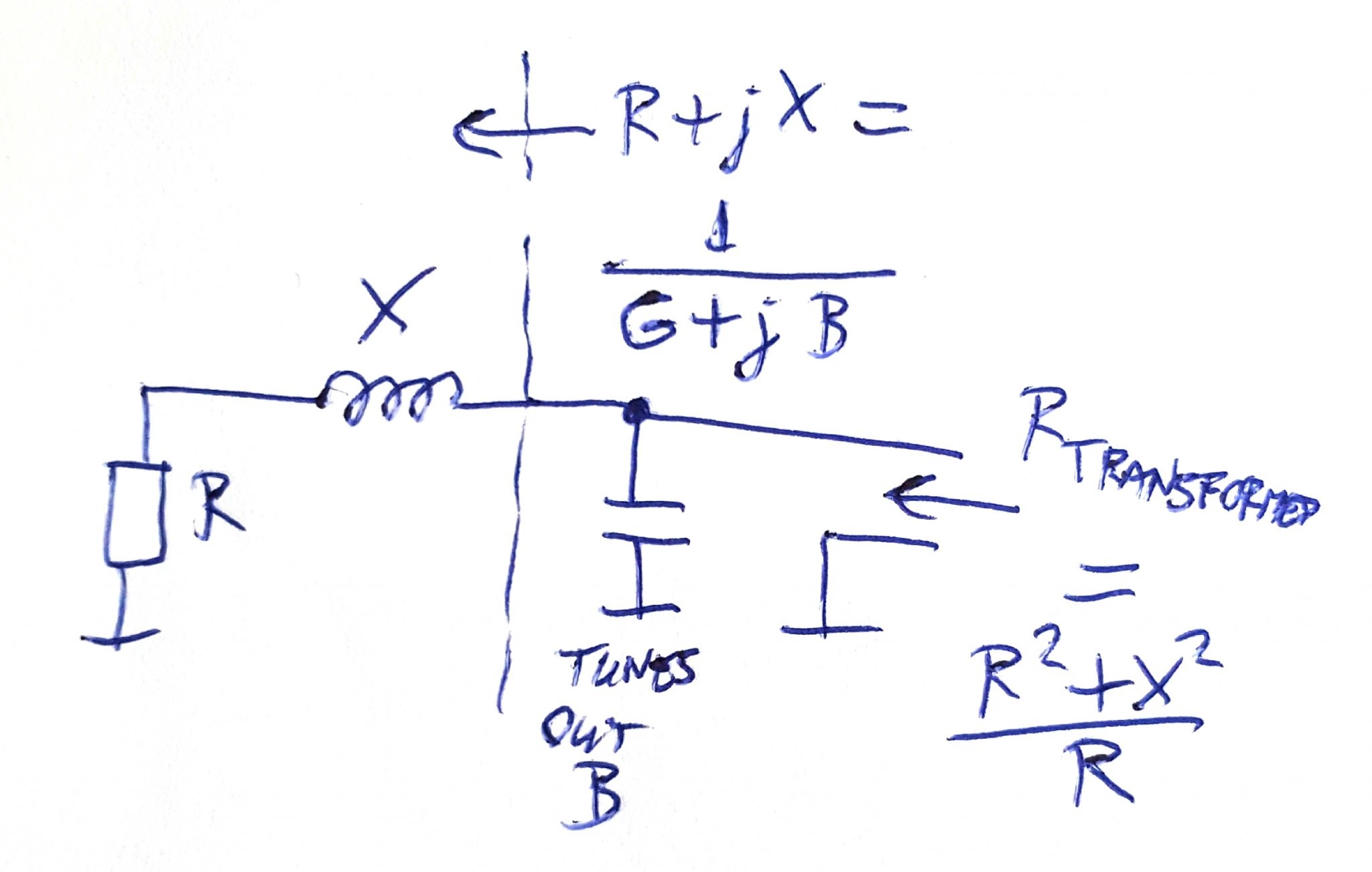

When you have a resistance R and you put a reactance X in series with it, you get an impedance R + j X. The reciprocal is an admittance G + j B with G = R/(R2 + X2) and B = -X/(R2 + X2). Tune out the susceptance B and you have transformed R into a resistance 1/G = (R2 + X2)/R.
This is a useful calculation when you want relatively wideband matching (single series inductor for the series reactance, capacitor shunting the high-impedance side for tuning out the susceptance) and it may also be useful for narrowband matching when you don't mind having to tune two tanks. I never looked at the narrowband case with a single tank.
