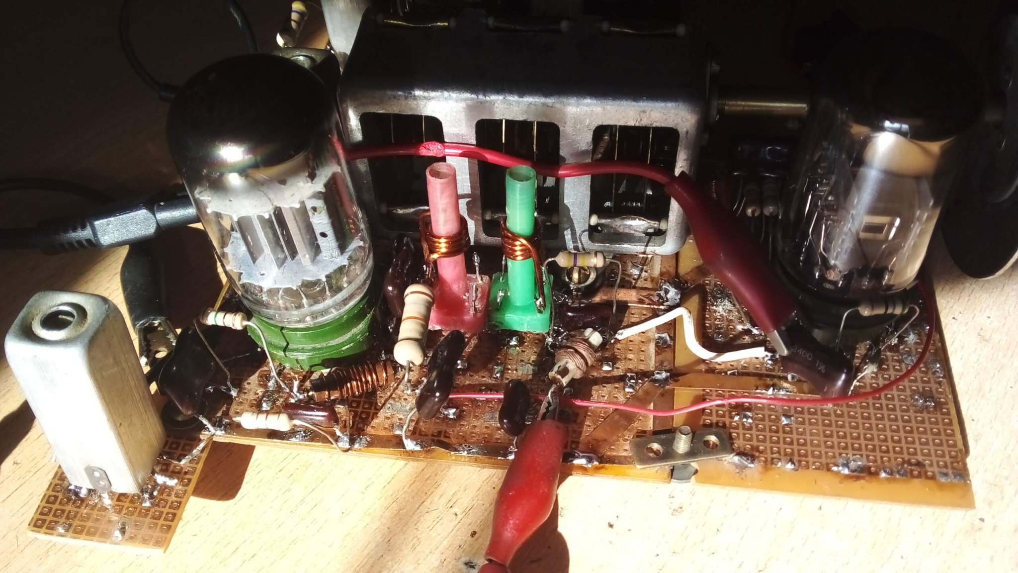

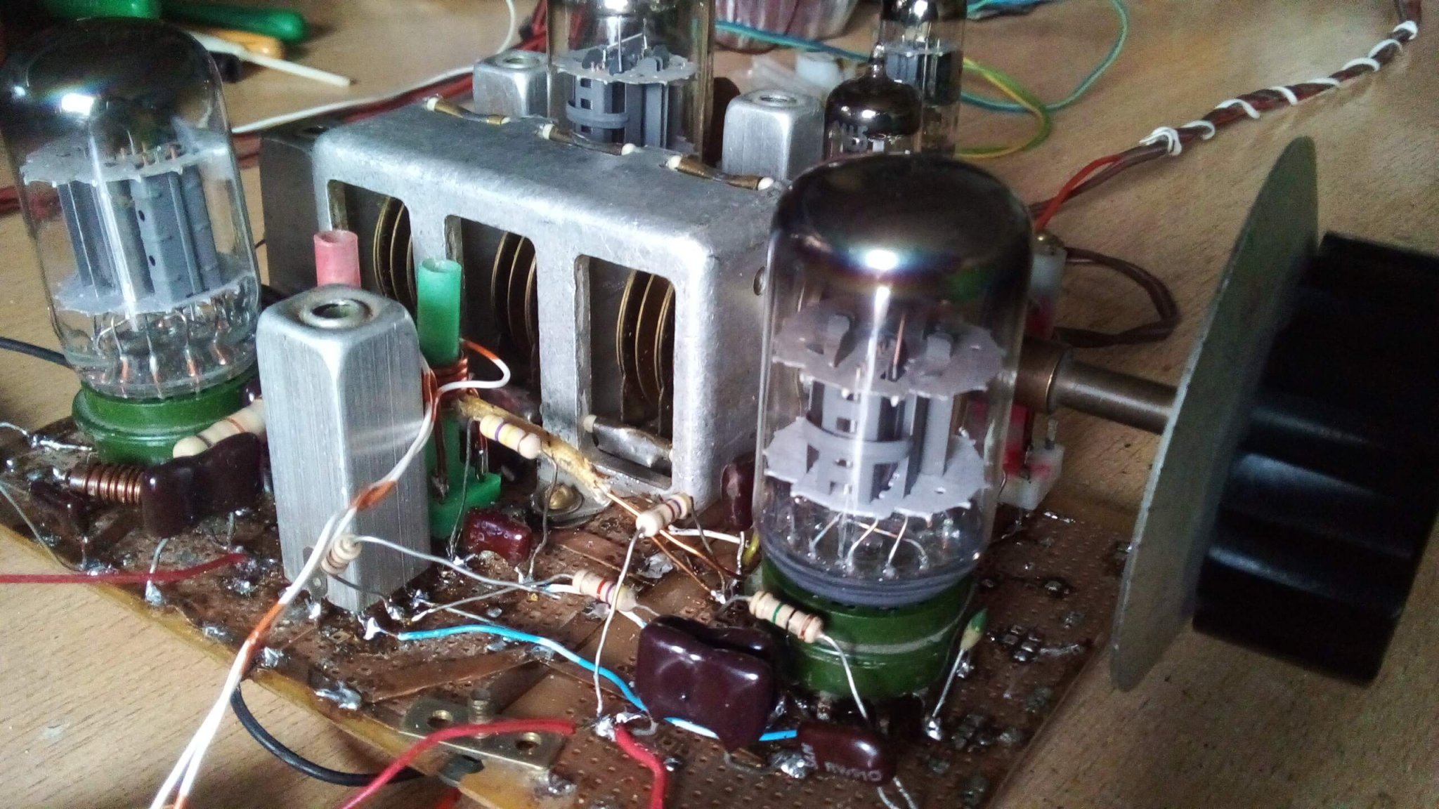

Now the oscillator has been reordered and is ready the coupling to the mixer grid (Section triode #2 of 6BD11). No yet made the RF amp and its coupling. The distance from coil to coil suffices to get about -2V at the mix grid without the plate loading wired (First IF primary).

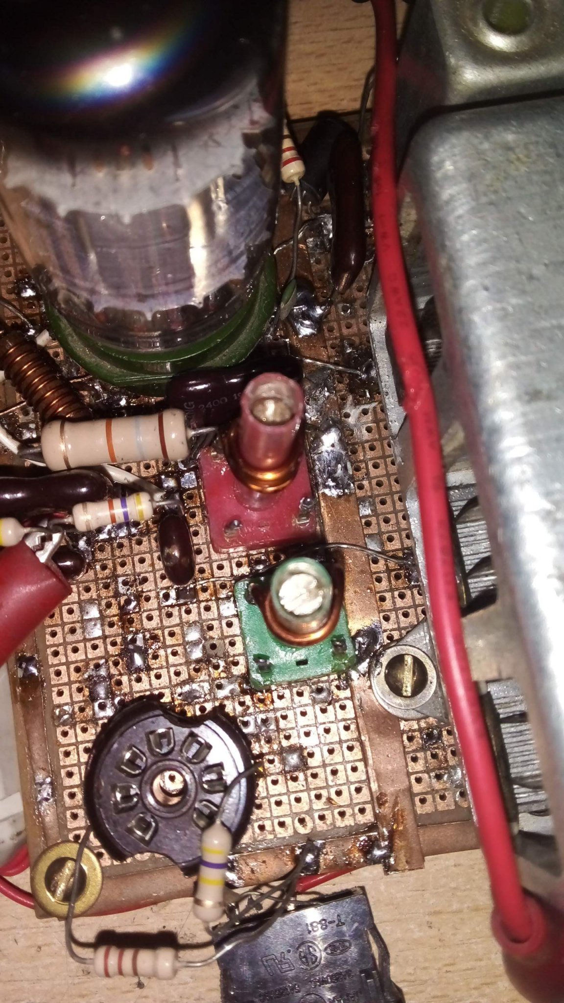

The green bobbin is the mixer and red the oscillator. There isn't need to follow color conventions as it will be the only I build, it is for my own use and finally is what l have at hand

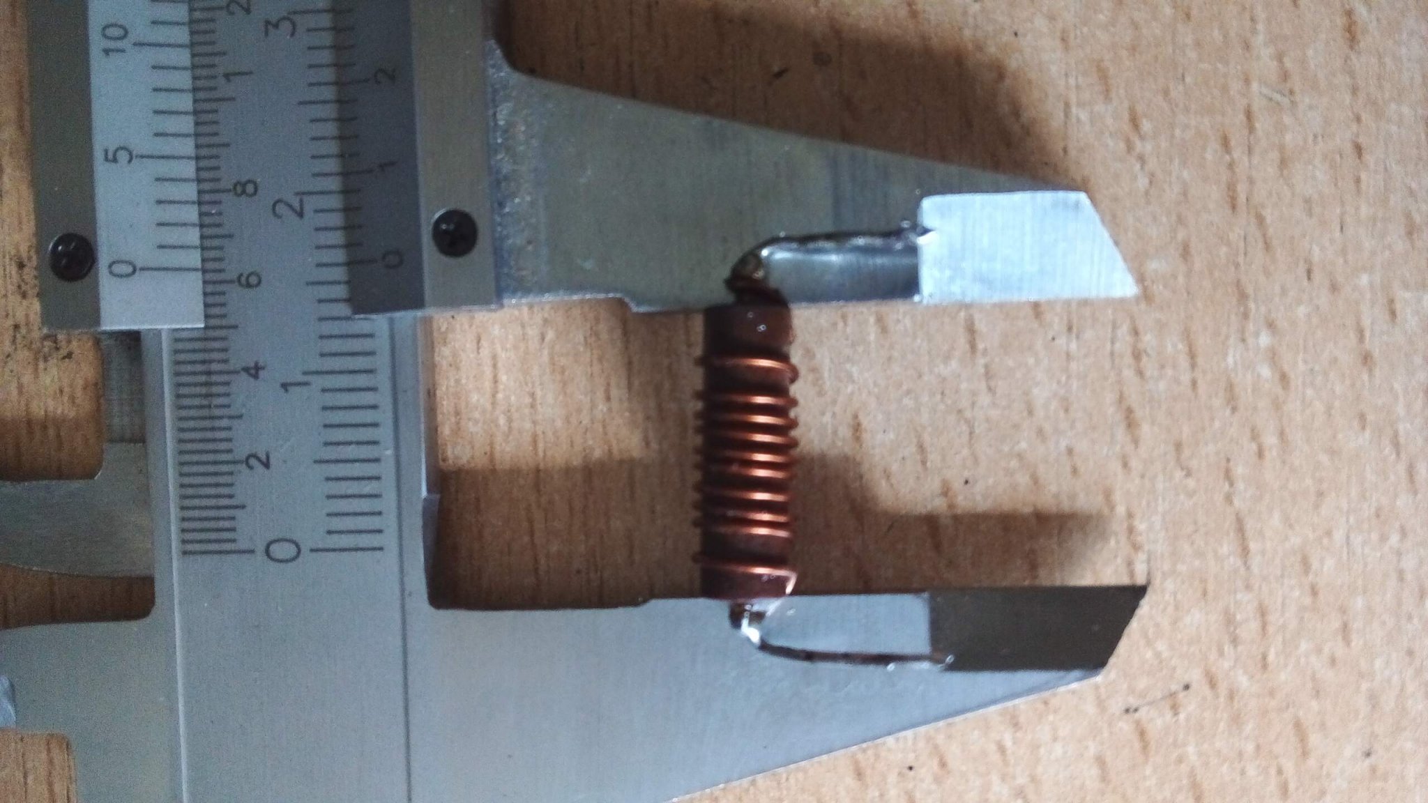

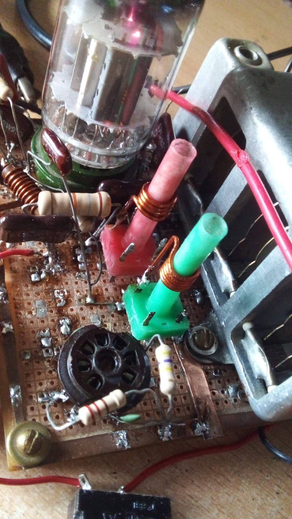

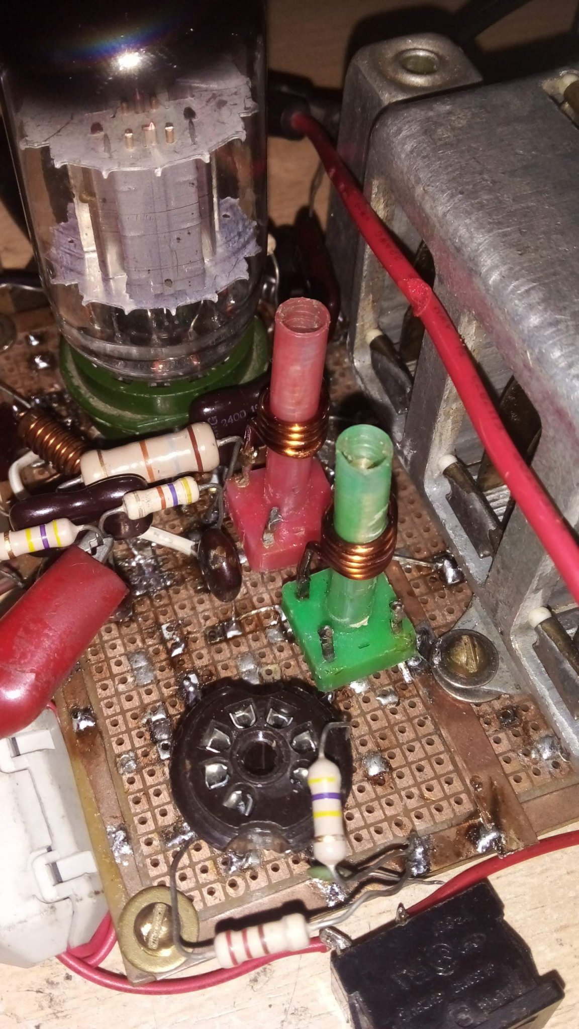

As things appears to be in the good way, I re-did the green coil using a large wire size, the same as the osc coil of about 1.2mm enameled. Then I re-place it a bit closer to the osc, in order to obtain a greater coupling. Also some space has breen freed for the RF amplifier stage, the 7 pin black socket mounted but unused.
In the pics can be viewed those changes, and the brass slugs inside the coil formers.
The red wire close to the gang is the pick up of the digital frequency meter.

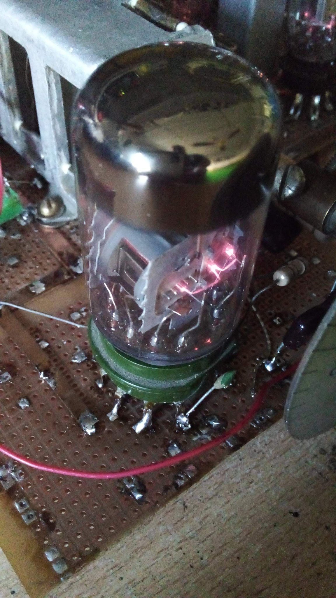

I must admit l am obstinate and capricious. Suspecting that when l made the cascode around triode sections of 6BH11 something was wrong because of persistent oscillations, l tryed it again with it, using the same (individual) tube, and this time it is performing as desired. Possible causes of the previuos failure may be some miswiring or faulty component. This is how actually I did it again.

4.- Mixer grid:
Same coil former, no shield. 4.5T 1.2mm coper wire. Primary windind may be 4T 0.5mm slideable along former for proper coupling to mixer's grid coil. Not tested yet.
5.- RF grid:
Same as above, aerial winding not defined still. May be an untuned primary or a tap in the main winding. Not tested yet. See attached pic.

A panoramic view of how the RF front end is evoluting (or not?)
Anode load for cascoded RF amplifier is still un-done. The oscillator tank and mixer grid tuned circuit are more closer yet.
At the left is the 6BD11 oscillator and first IF, at right the 6BH11 RF amplifier (two triodes cascoded) and mixer (pentode).
There is still an unused triode unit in the former, possibly for the reactance tube for AFC.

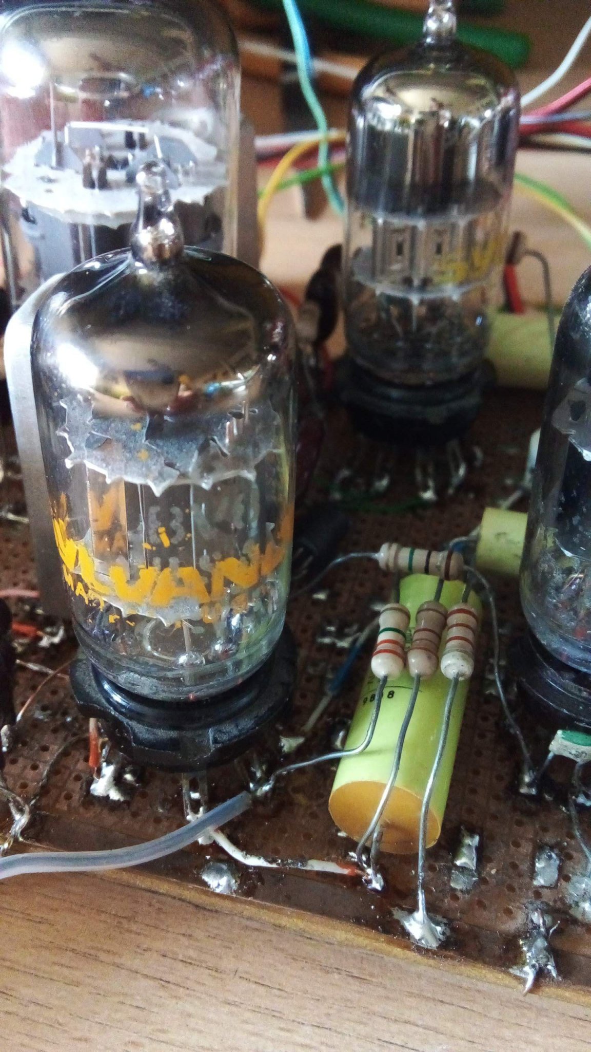

Once again the dual triode inside 6BH11 cascoded, turned unstable once more. Thus I discarded him to be part of the FM tuner and replaced by a high gm dual pentode 6BN11 that properly neutralized looks sufficiently stable. One section will be the mixer and the other, the RF amplifier. The origin of the failure remains unknown, but another cause may be long cathode and grid wires inside the bulb plus the other written some paragraphs above.
While the circuit is made but unadjusted, the beat with the oscillator signal could be saw with a powerful very near station although the IF is temporarily unsuplied with Ebb in order to prevent a short circuit or damage while doing the tests to RF front end.

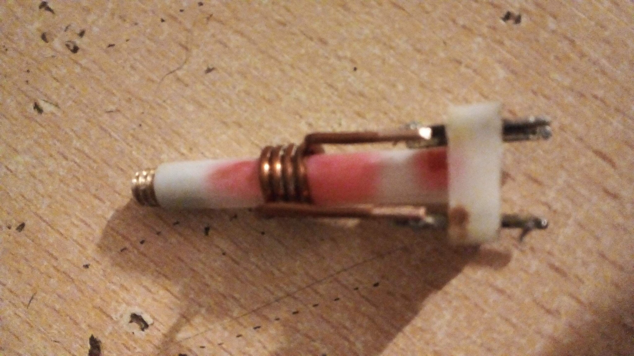

Still anorher oscillator coil. This time with copper wire (silver?) plated, one more turn and more spaced turns for better RF performance. It is also larger wire size: 1.5mm diameter. I have some more cm's of it so the RF and antenna coil will be re-done the same wire.

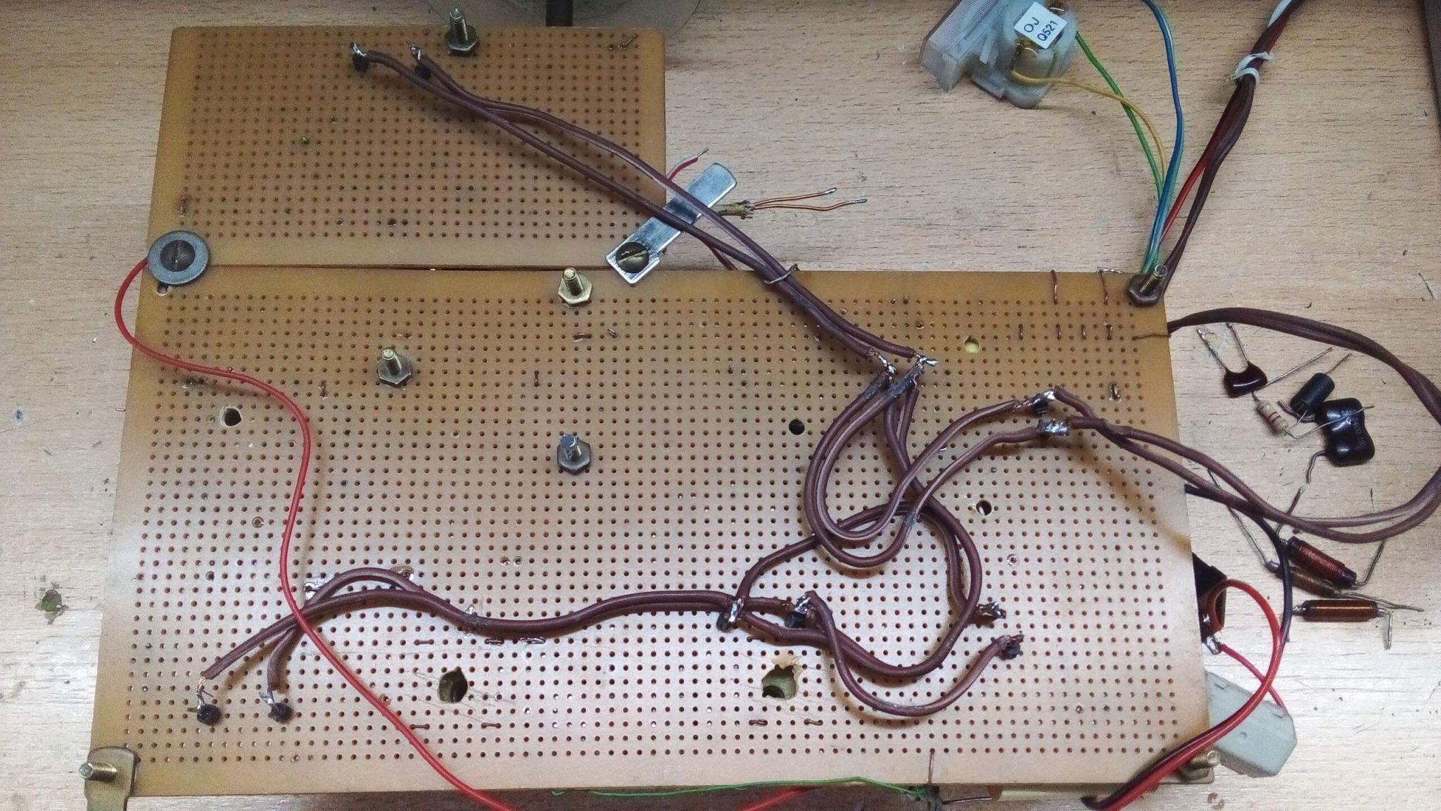

Here are two pics of a general perspective of the Frakestein. One is the top, and the other, the bottom where run heater wiring in order to not obstruct the main side. There are several undocumented 10nF plate caps across each socket in order to bypass them for RF currents.
