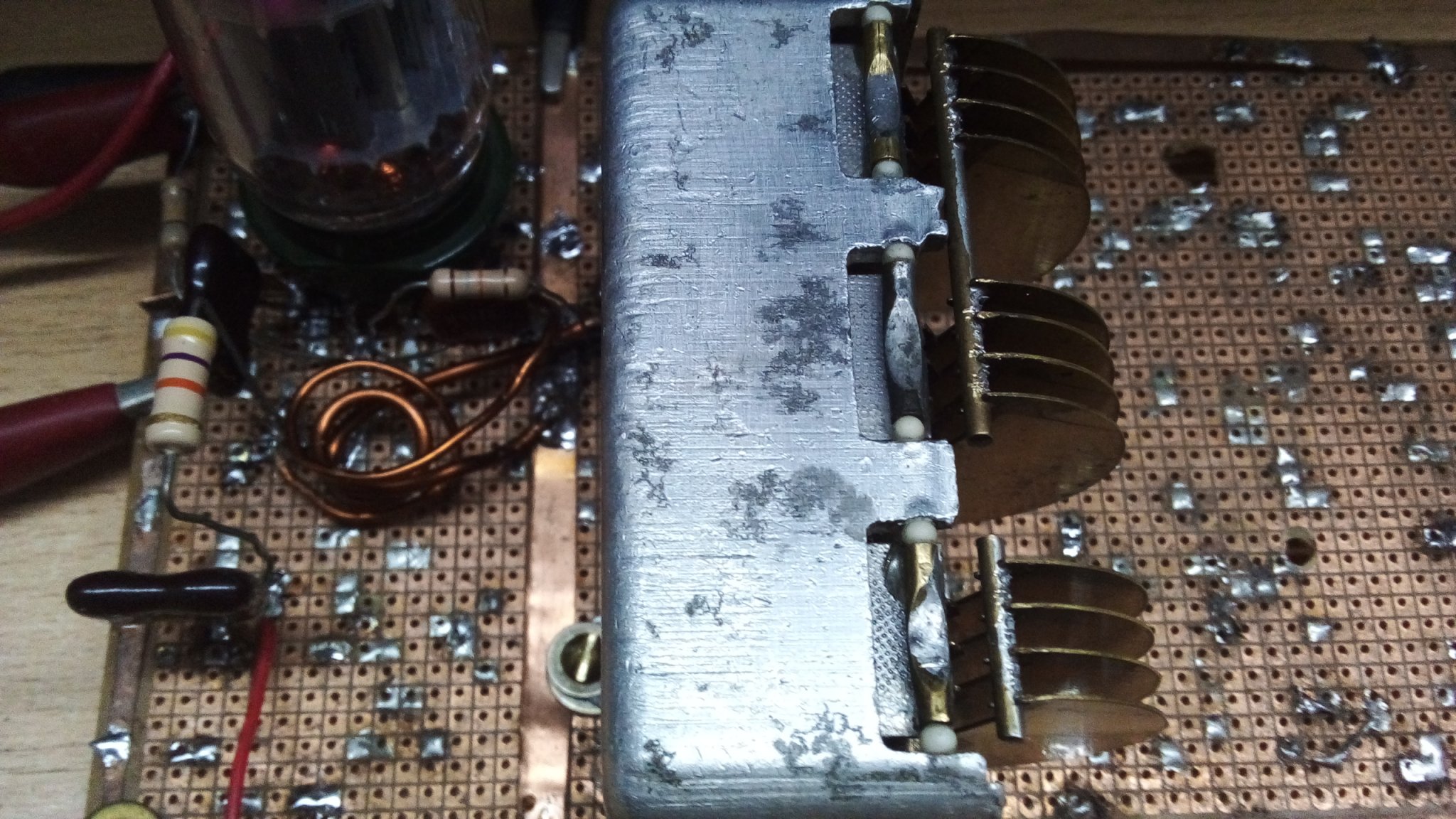

Btw, clever idea what you did with that tuning capacitor! How exactly did you remove the superflouos plates? Did you use a slim router bit in the Dremel?

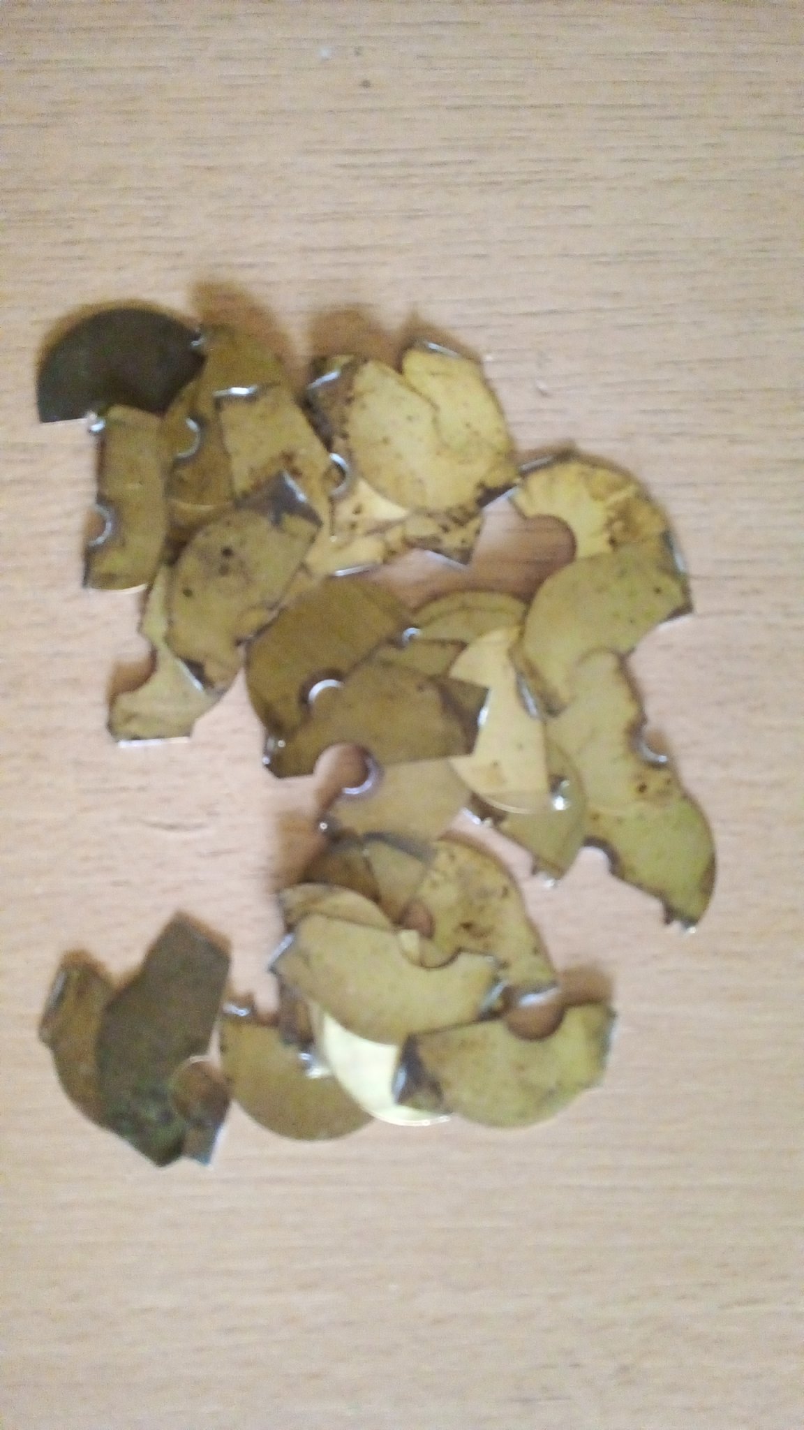

Not necessary. The sheets was soldered with tin, so easy to remove. In the pic above it is clearly visible. Only hand tools like a small electronics pliers.
I counted the original qty of them. So I leave the first, removed the 2° and 3°, leave the 4°and so on. So my new cap has triple separation. The same in the rotor and stator sets.

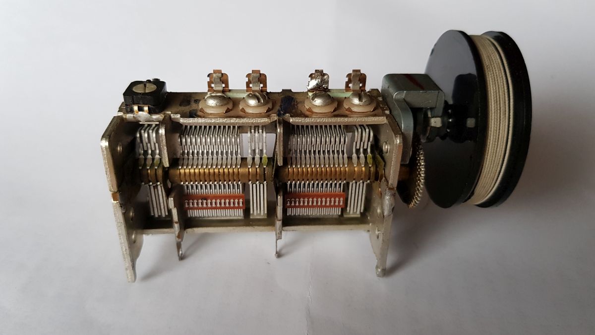

Btw, here's the unit that I had described above:

Why not? Put your hands to work soonly.Btw, here's the unit that I had described above:

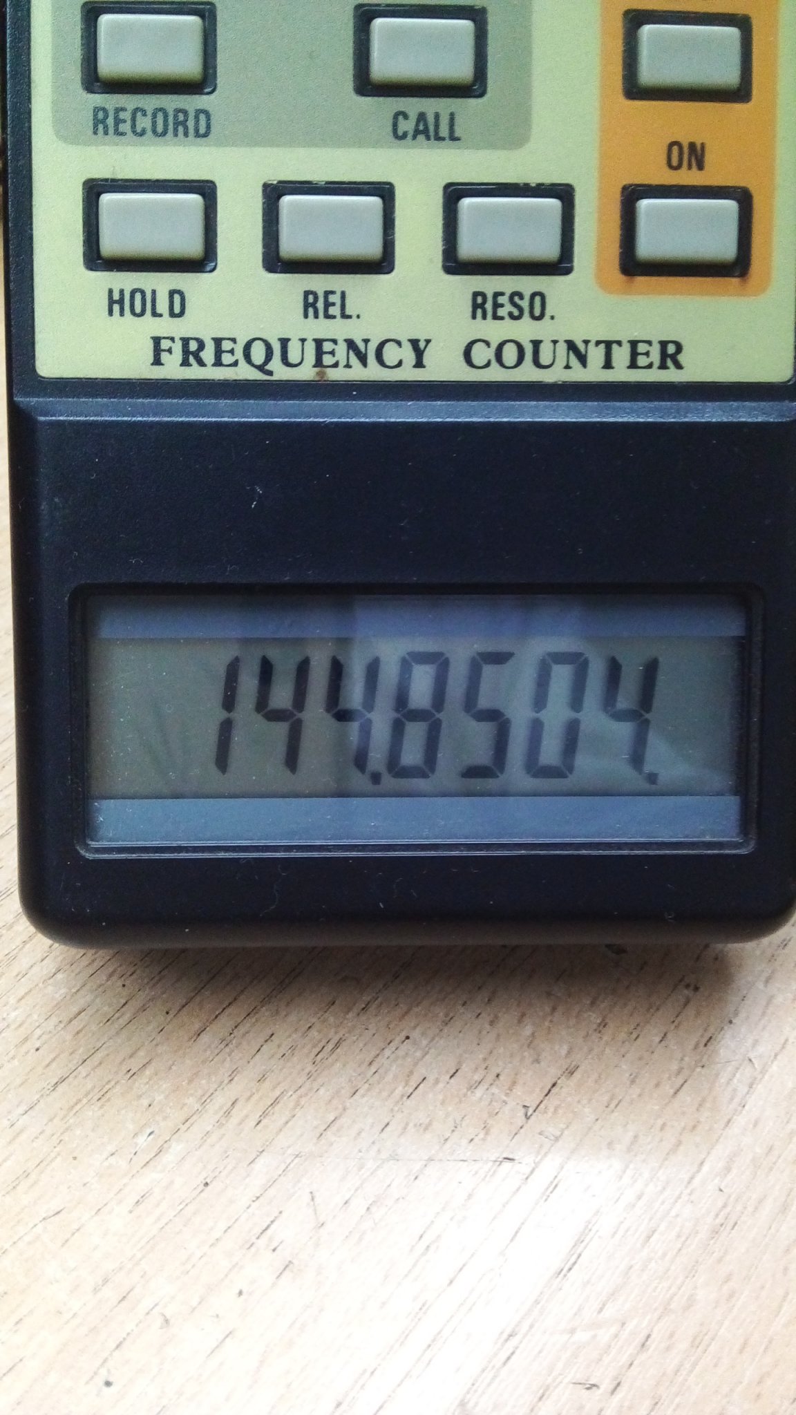

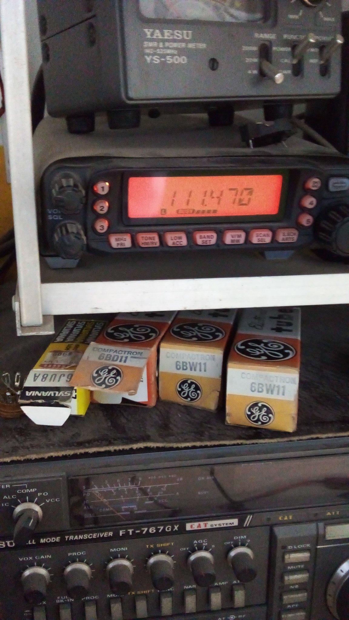

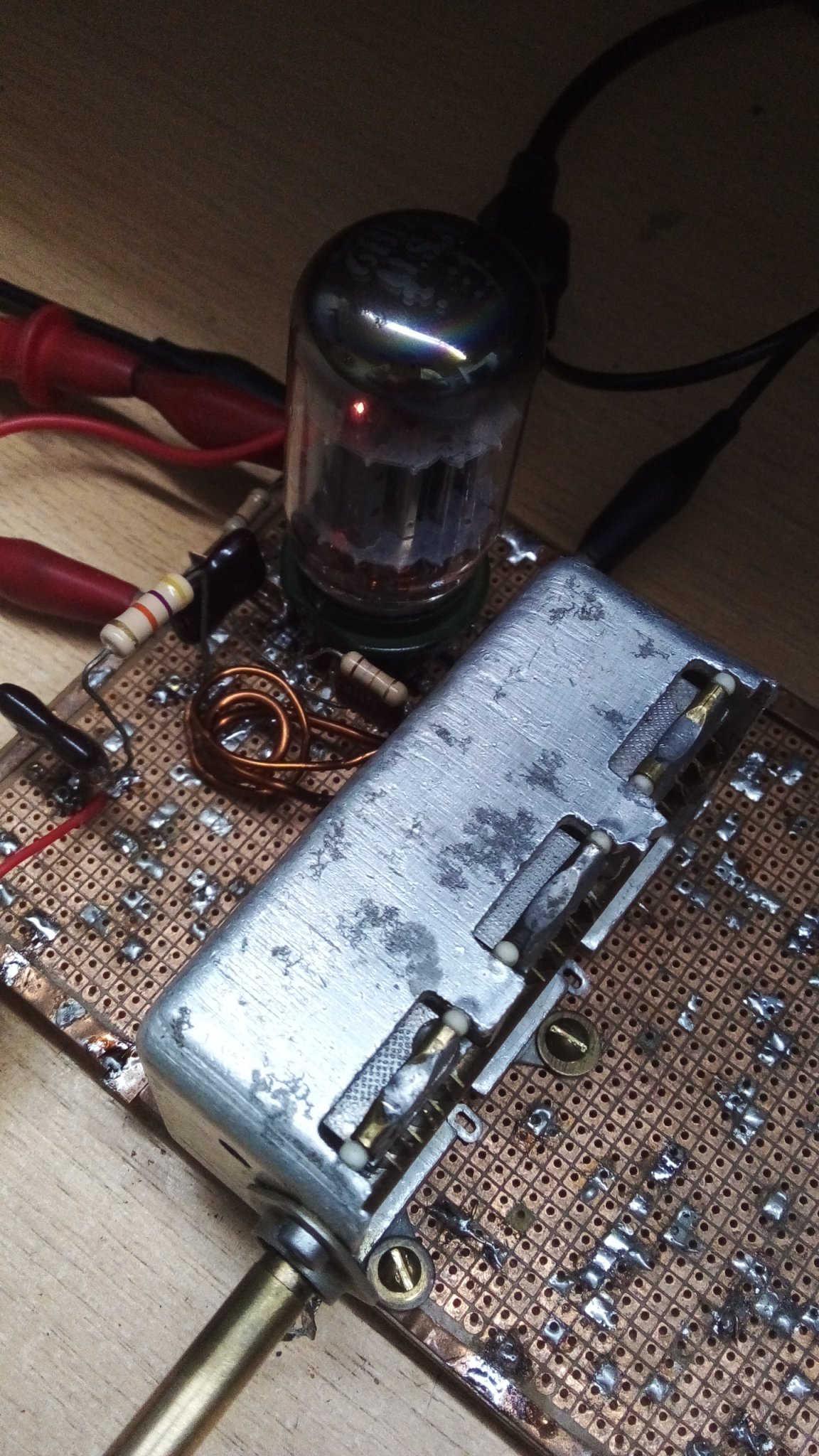

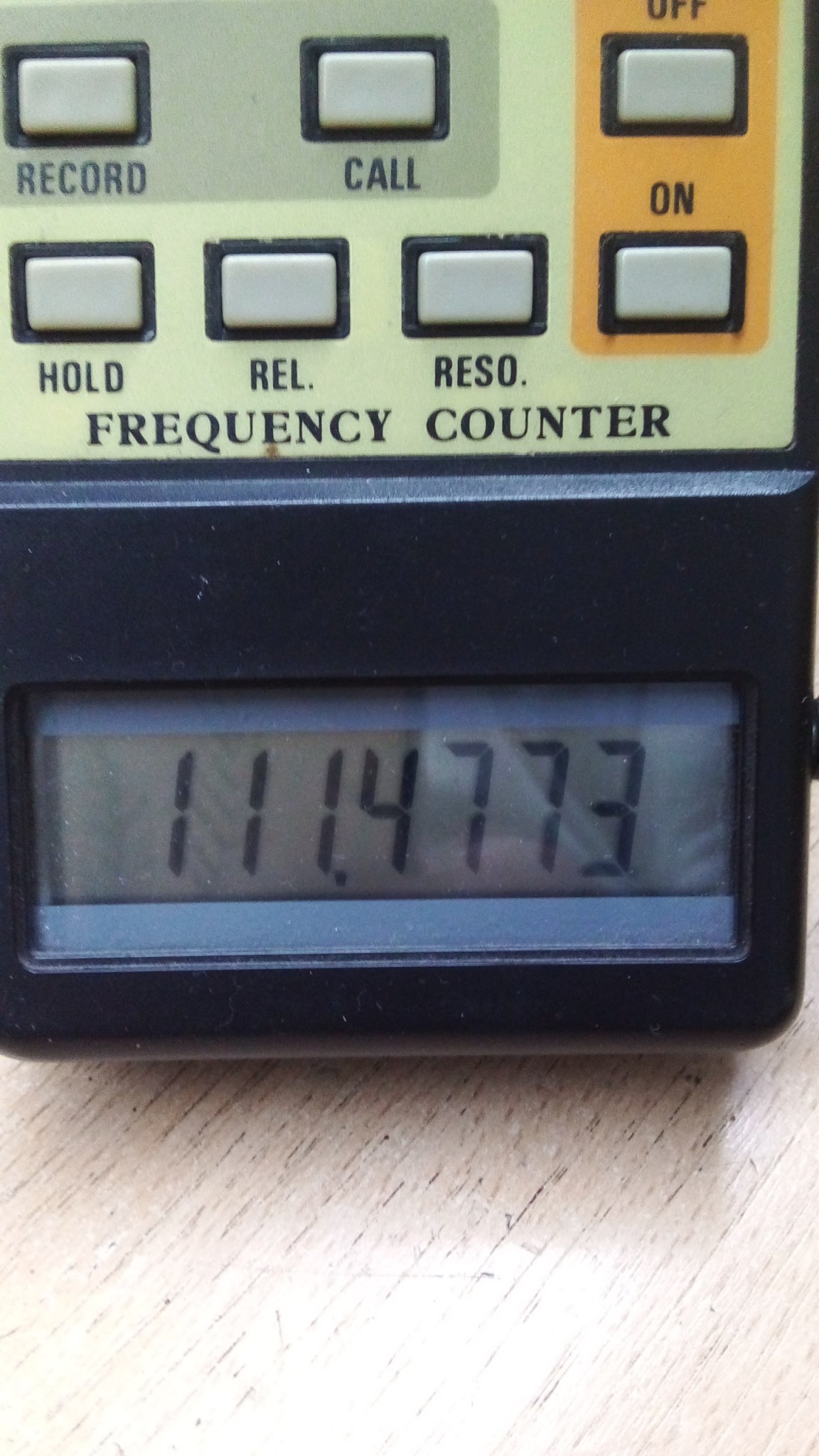

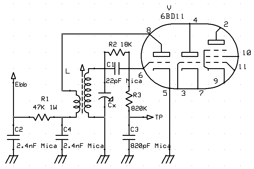

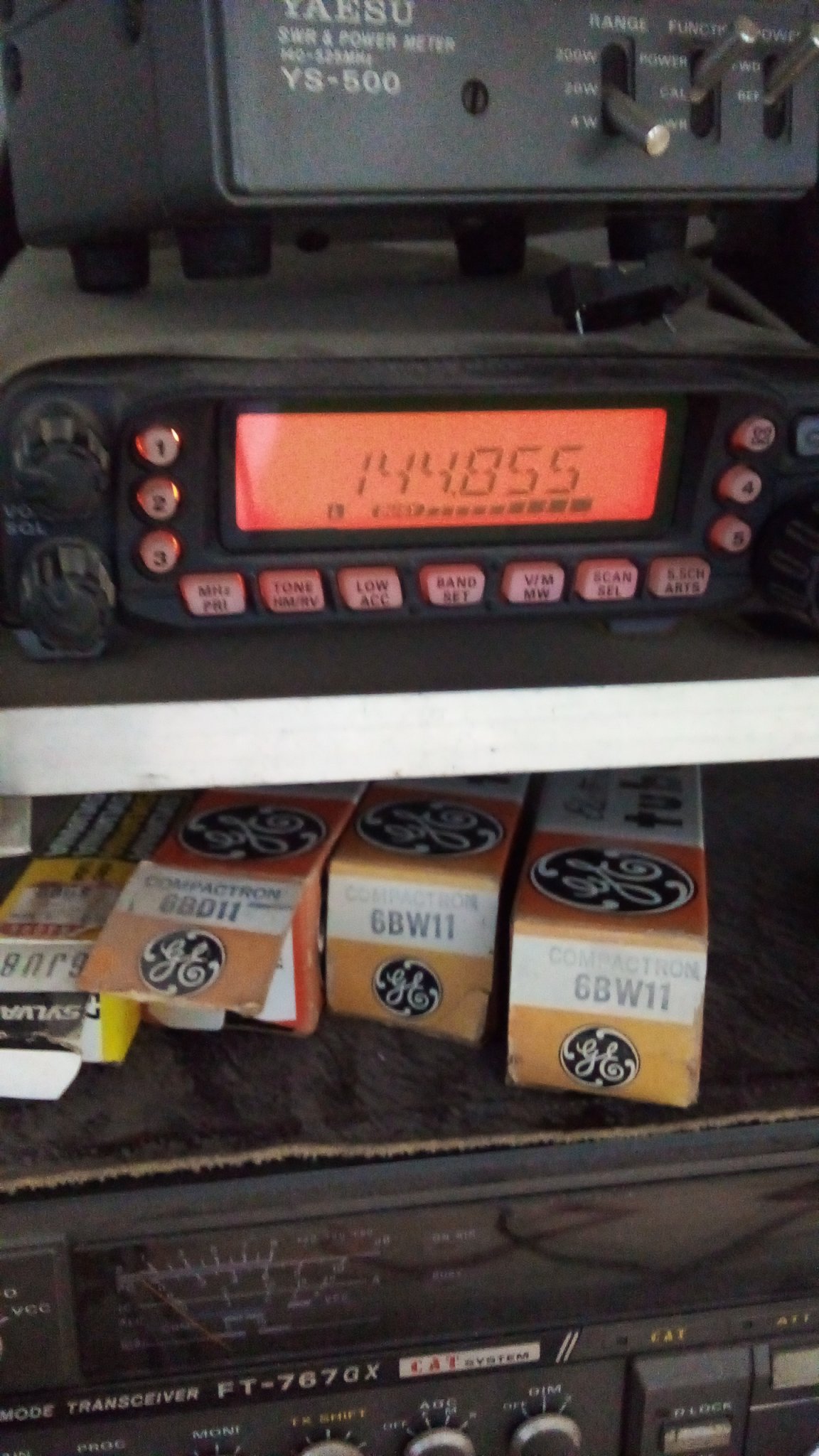

This is the really working version of the oscilator. Tube is the 6BD11 triode section 1 as manual sais. It has the higher gm of both and the lower Cpg. Observe double checking of osc. frequency on the counter and in VHF ham tranceiver. Its appearance is really ugly and no padder nor triming means. The object was to test tube VHF capability as it is not designed for the purpose.
The thing is of the tuned grid kind of oscillator with tickler coil in the anode. There is an added resistor and capacitor from the grid to ground; low pass filter with 820pF and 820K to measure grid rectification bias, a means for check oscillator health, and varies from -3.1V at the higher limit (lower C) to -2.5V at the lower freq. end. Grid leak is 18K and 22pF. Coil is 1.5T 2mm copper wire air cored; 5mm inner diameter. The grid leak resistor and capacitor are paralleled and returns to the top of osc coil and condenser. Tickler is 1.5T about 10mm dia surrounding grid tank. Plate voltage is about only 60V and is obtained from regulated 140V through a 47K 1W resistor in order to protect the tube when oscillation deads out during the experiment. Perhaps the resistor can be reduced to 18K at final artwork.
Next step will be to fix the limits to the desired 100 to 120MHz and temperature and time stability and a more mechanically stable coil. As it is actually, past about half an hour, it stays stable within 5KHz of the tranceiver IF width.
This's the schematic of the oscillator. Remaining elements in the 6BD11 boy are still unused. Almost surely the triode will be the mixer and the pentode, the first IF. Observe again, no frequency adjustment means. The TP is the already said grid voltage monitoring point. It will be erased in the final artwork.

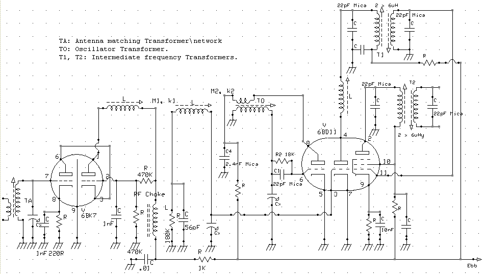

My idea is the following:
A ECC88 or ECC189 or similar (both in my stock) as cascode RF amplifier.
The 6BD11: section #1 triode as oscillator. Section triode #2 as mixer. Pentode as first IF. But as you can see, the project may change unexpectedly in any moment.

This is a crude idea of the front end of my project. Some components, RF amp and LO are more or less defined, but the mixer is still uncertain. Particularly, a small inductor placed in the plate of the mixer anode that it is said to be useful for neutralizing it. Some tuners of the tube era used it at this place or at the screen of the pentode mixer if this kind is used, particularly with 6CG8 and similar devices.
Langford-Smith in his Radiotron suggests that the first IF tuning capacitor return to ground or cathode in place of being paralleled to the IF transformer primary. This is so to ground properly undesired signals as a result from the mixing process. Who knows...
