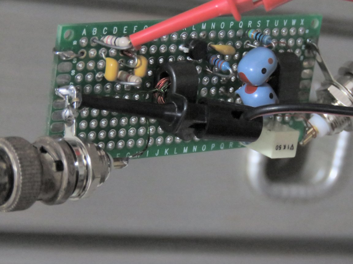

Yesterday I tryed a 6BN11 which contains two 13mS pentodes (in fact beam tetrodes) in the same envelope but become extremelly unstable, being impossible to neutralize it and stop oscillating. I don't understand why, because geometry inside the tubeis very similar. Thus I returned to the 6AR11 again.
These actions requiered complete dissasemble of the protoboard as base pining of both are incompatible. Also I rewired it in a more tidy way.
With 2 pentodes so physically close, Cg1-a2 or depending on configuration, Cg2-a1 (increased by tube socket) could cause instability because "between" those caps are 2 stages of maximum amplification. Before building, measuring components (expected Q, value of socket + wiring caps) and simulating that could give a clue about stability.
But in the attempt to replace the pretty bottle, the second unit was unwired. Some time after, I wondered if I over-neutralized the 6BN11. Over neutralization may also configure an oscillator if too much signal passes through neutralizing mechanism.
In my case, and referring to the Hultberg's system, I found that I need a larger cuasi-decoupling cap than the value obtained from the formula published by the boy. Perhaps 6BN11 needed still a larger sized condenser. By this moment I shall continue with 6AR11.

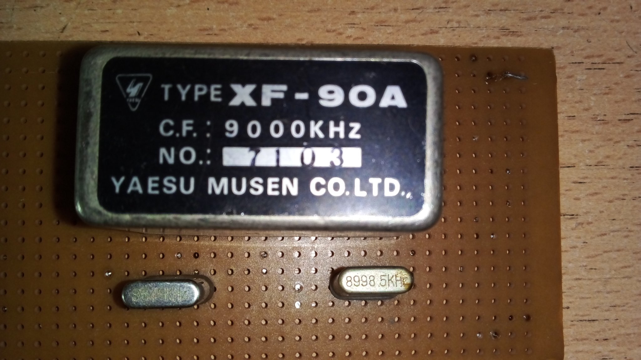

So the ECC88 front end might be too good unless the noise level is low. It's funny I have those 9 MHz filters and Xtals as well but no longer have a valid ham license. Dual triodes with less gain (ECC81, 85 etc.) can be used in your 12 MHz IF, when 2 amplification stages isn't enough, use 3.

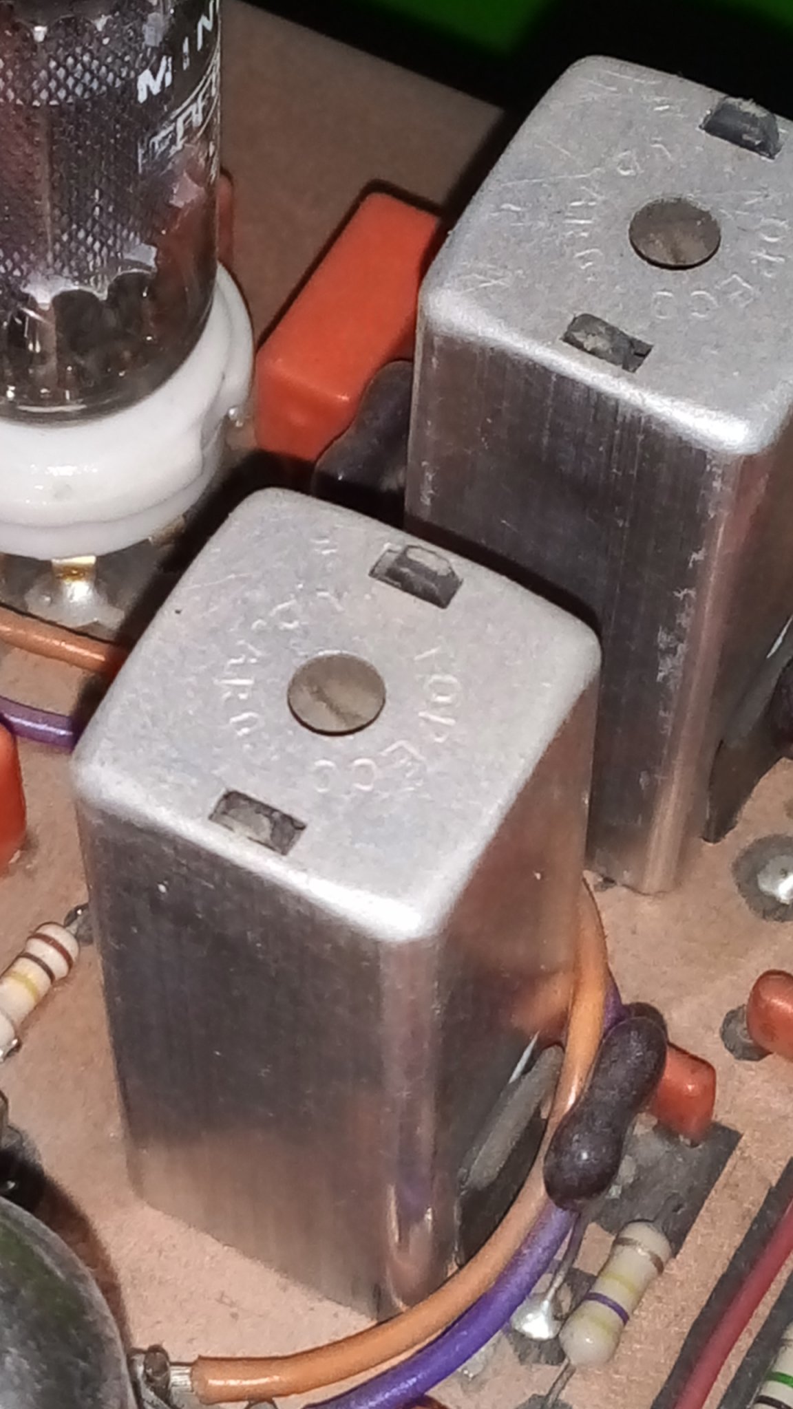

But for mixing, I like very much the ECH81 tube and had saved several of them. Also I have several K-Trans IF trafos very small and permeability tuned.

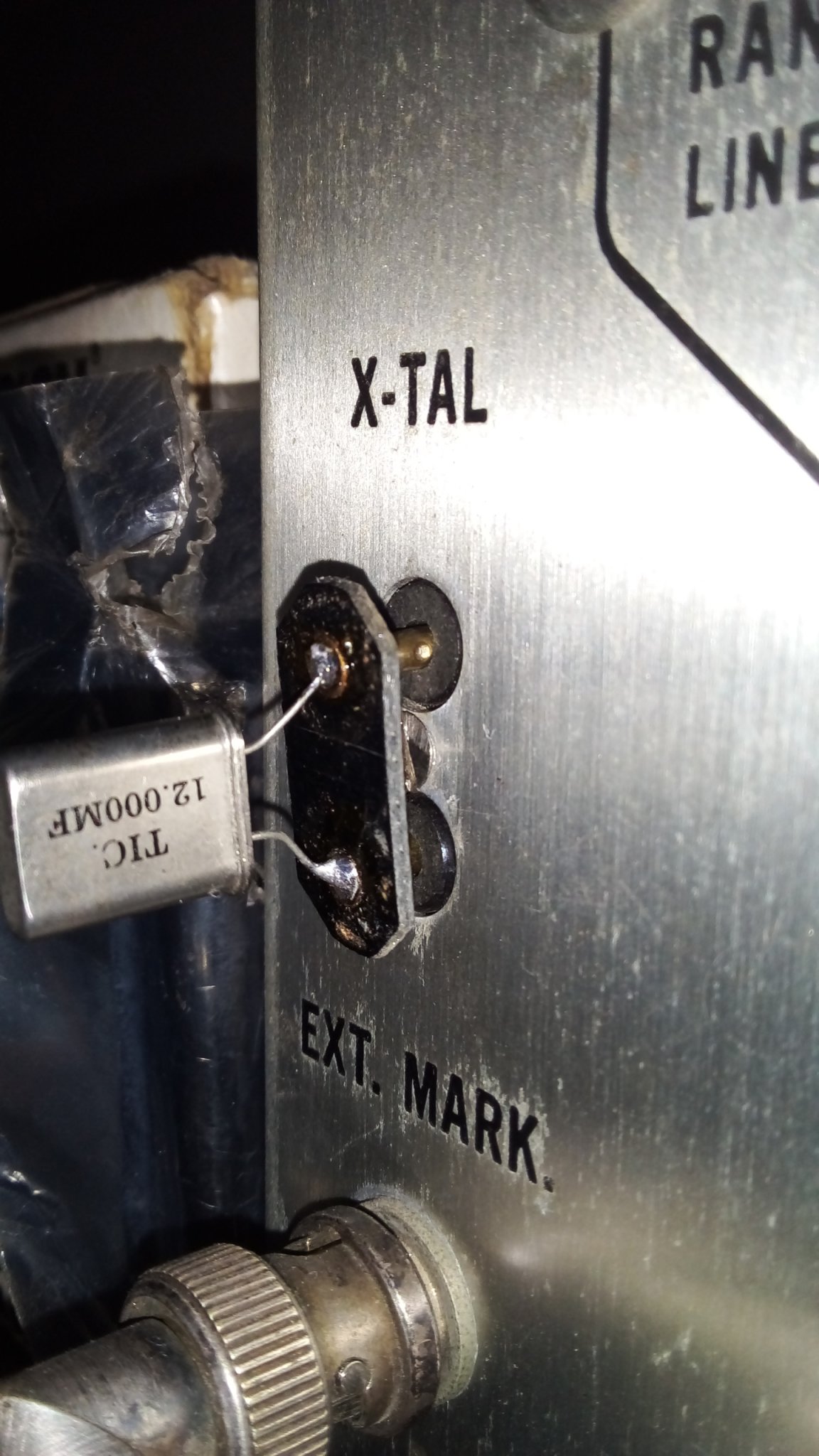

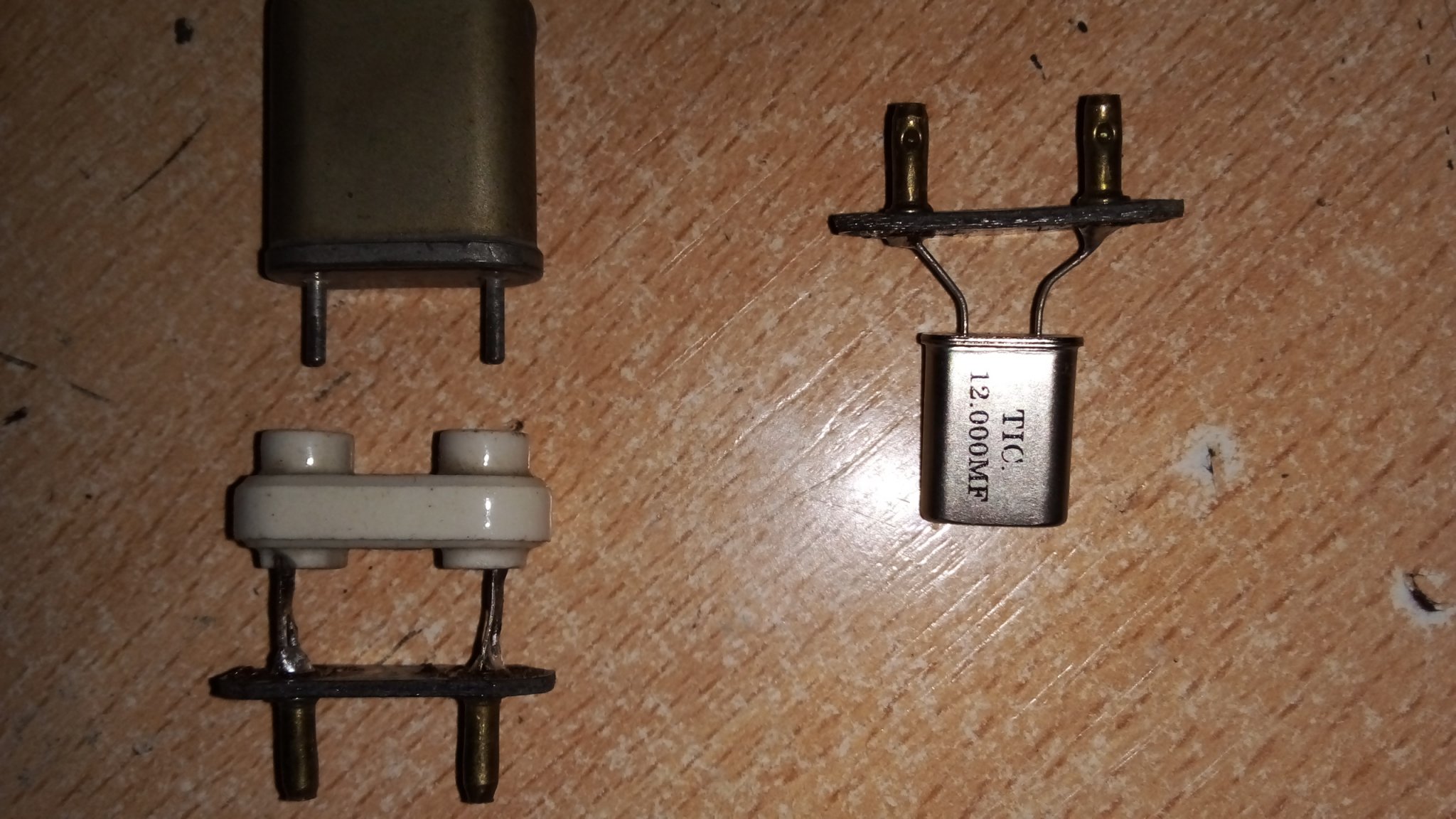

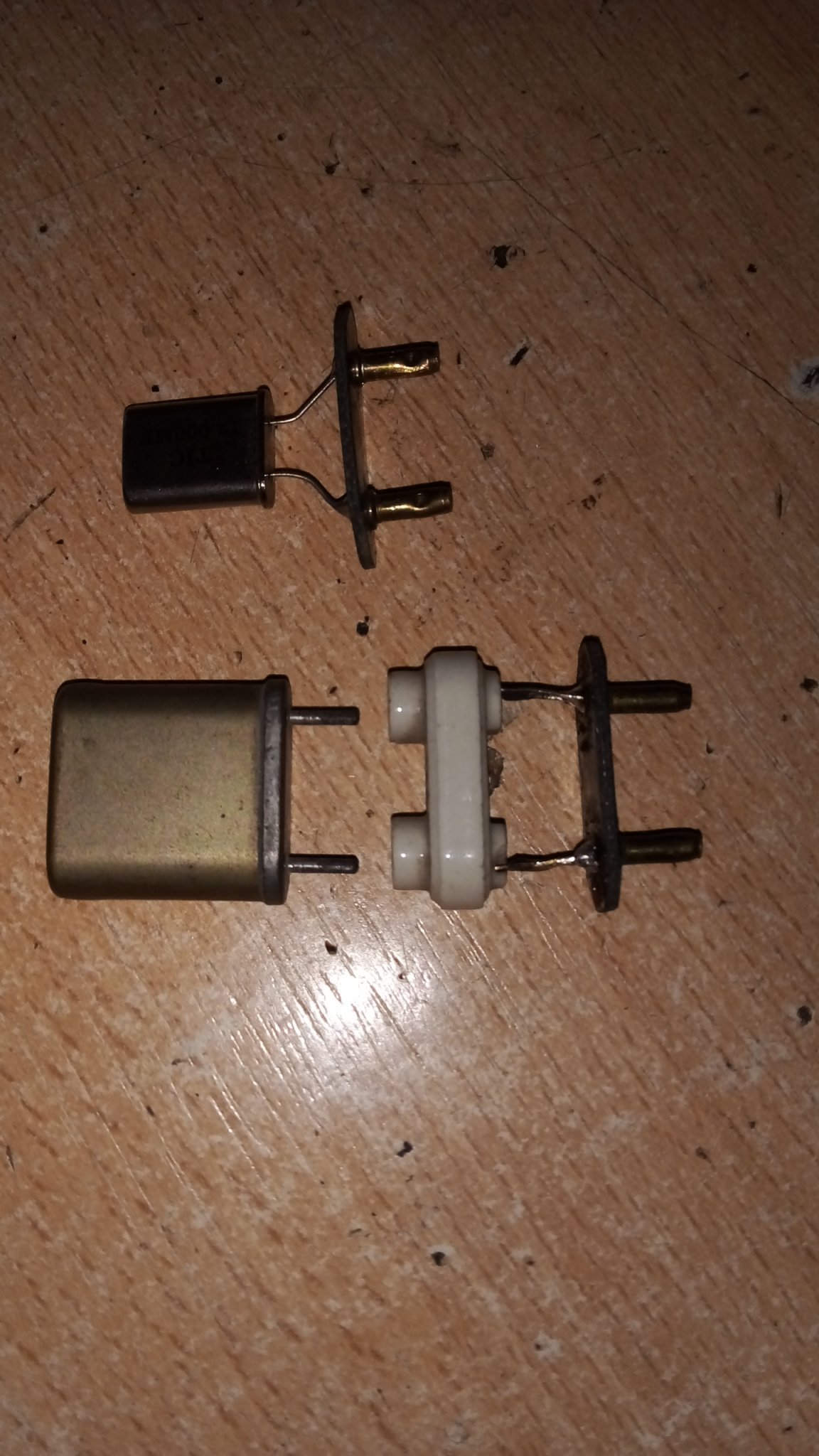

Accidentally I found that the socket for marker cristals is exactly the same as fluorescent tubes. So I reused some plugs from them for creating my own marker crystals.

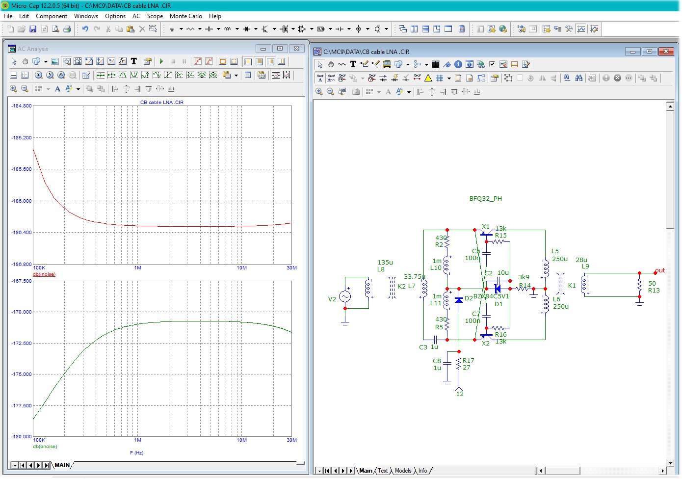

Hobbyists can achieve excellent results as well. For instance, by using the ratio of Q(loaded)/Q(unloaded) to estimate how much NF will be higher than stated in the datasheet of the device. The lower the ratio, the better. Hence the effort by hams (who need lowest possible NF) to simplify the procedure / calculations:
https://www.g3ynh.info/zdocs/magnetics/appendix/optQ_hb9dfz.html
