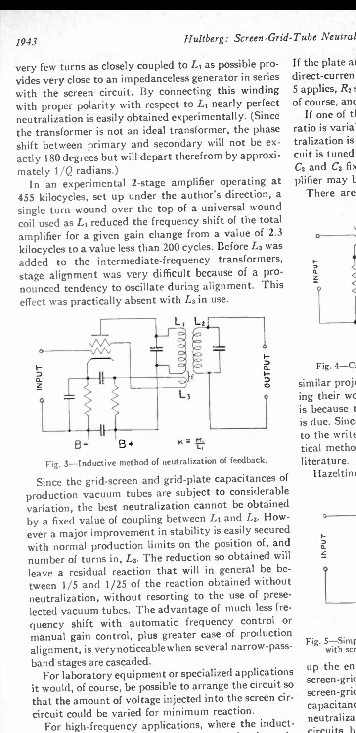

I found those intetesting means for neutralizing the IF amplifier without several components added. The sources are self explanatory: an US patent and an article from IRE Proceedings from 1943 free available in the web.

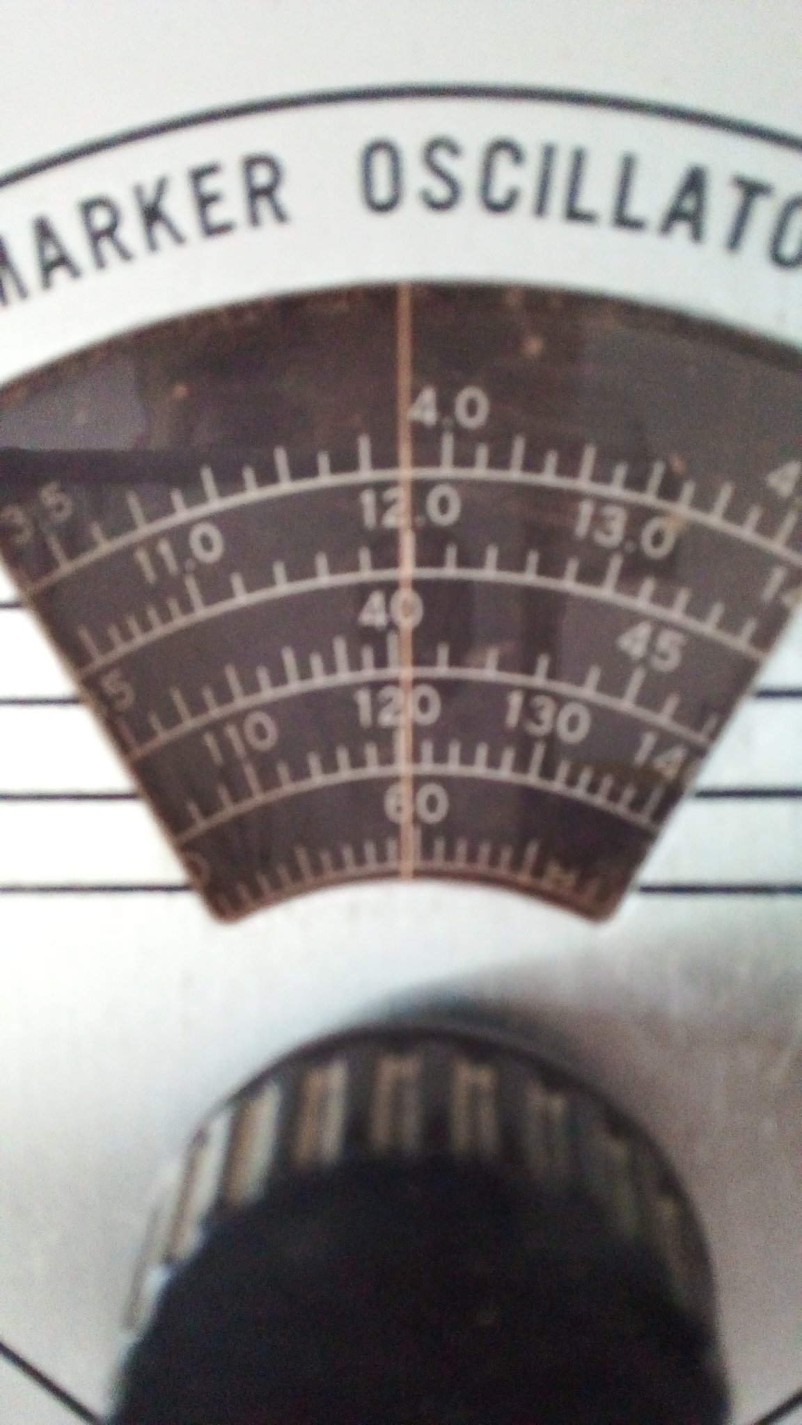

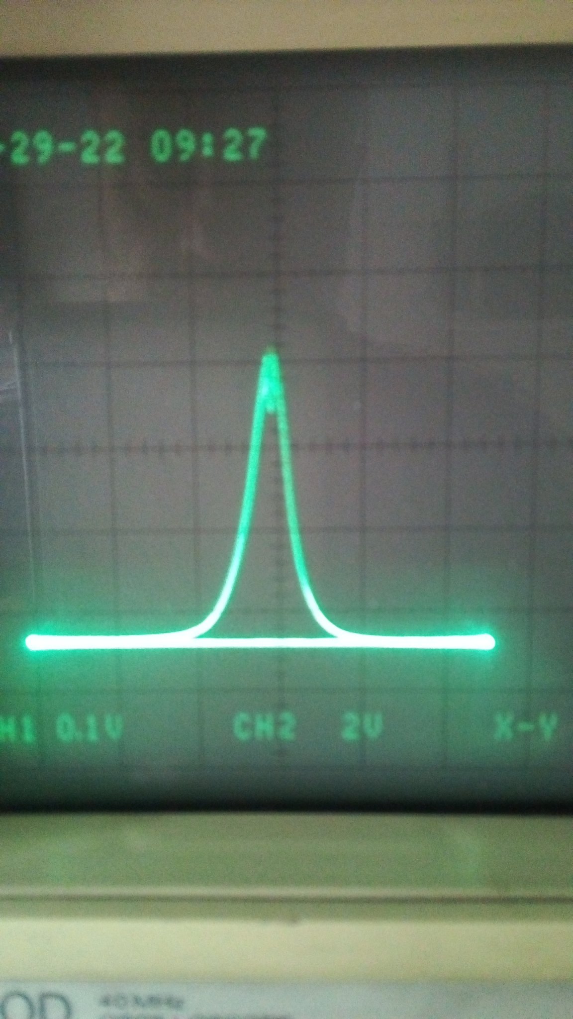

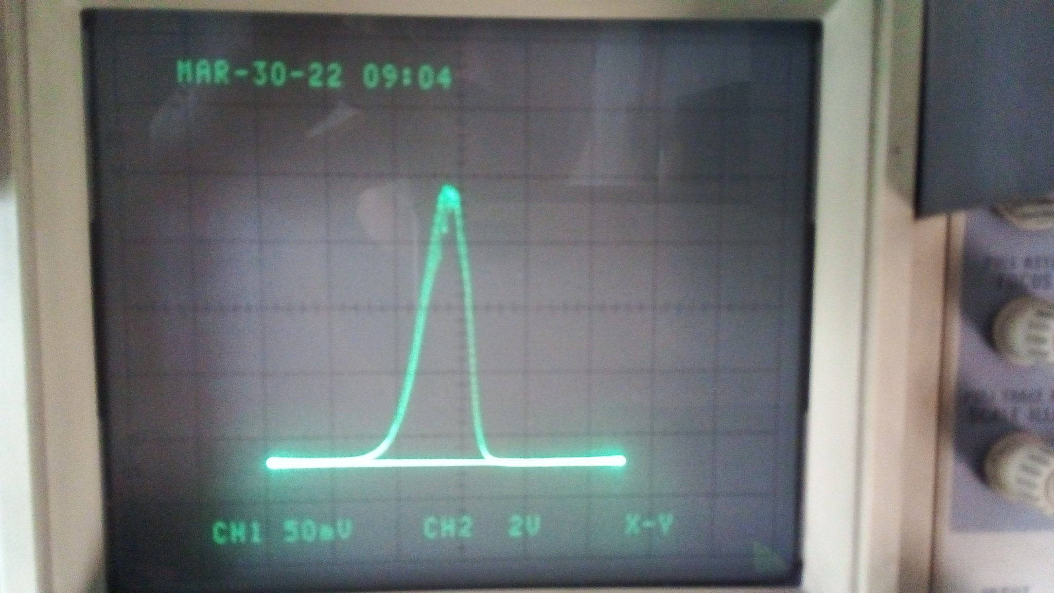

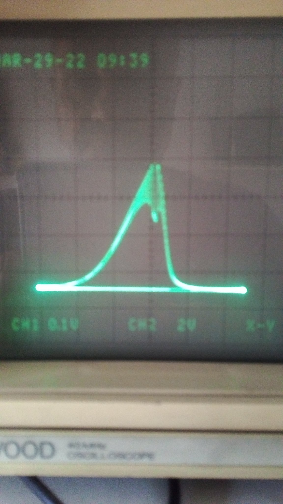

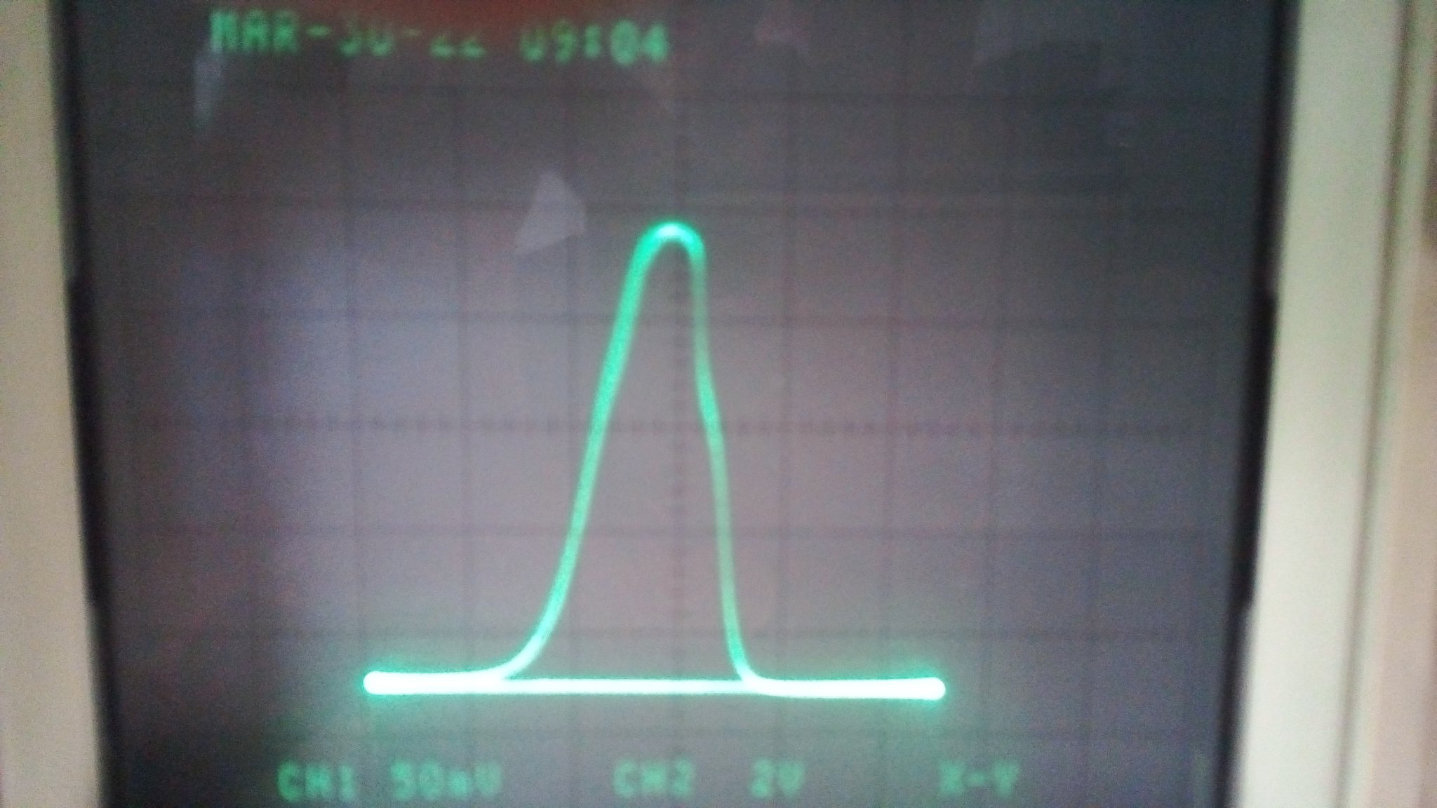

I made a mistake when calculation of the number of turns of the coils for IFT's, by subestimating stray capacitances, and then it was impossible to tune the stage, the resonance peak was about 9MHz in place of 12. So I rewound all coils and now it is very clear the peak. I now am using 16 turns 0.4mm copper wire over 15mm cylinder occuping 7mm long (close turns).

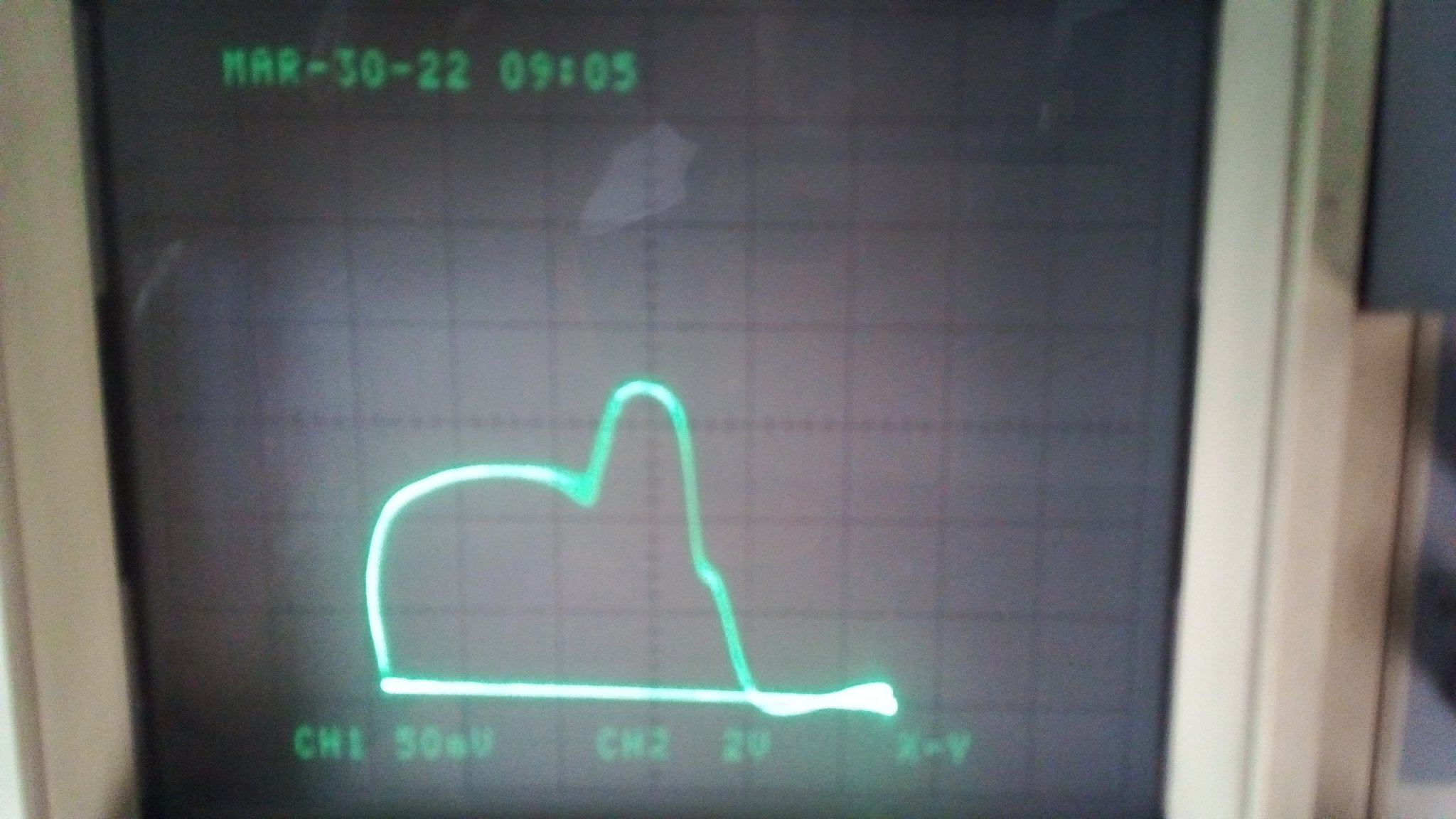

There are two sweep of the stage, one with large deviation and the other with narrow sweep, also showing the 12MHz marker at both

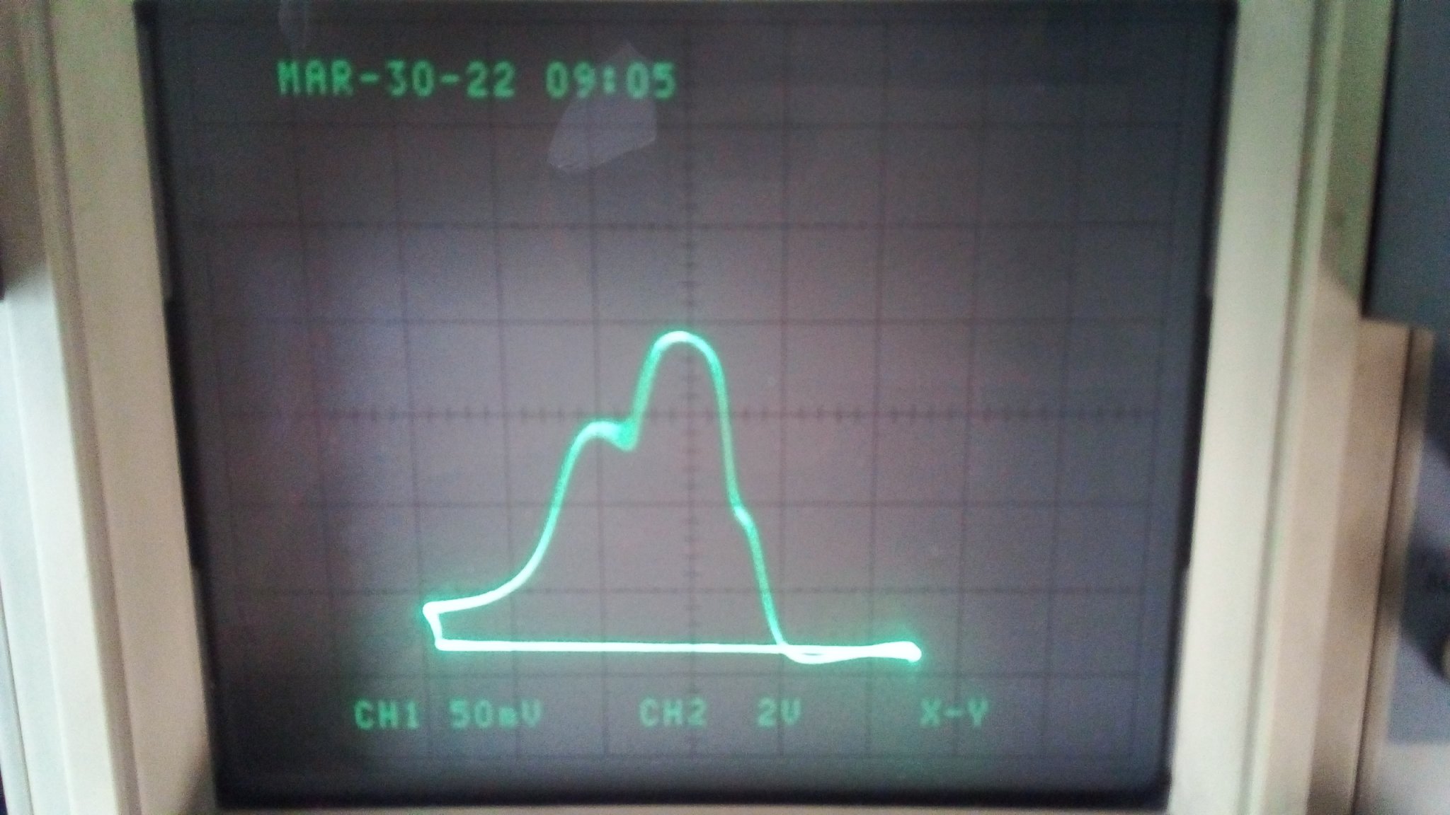

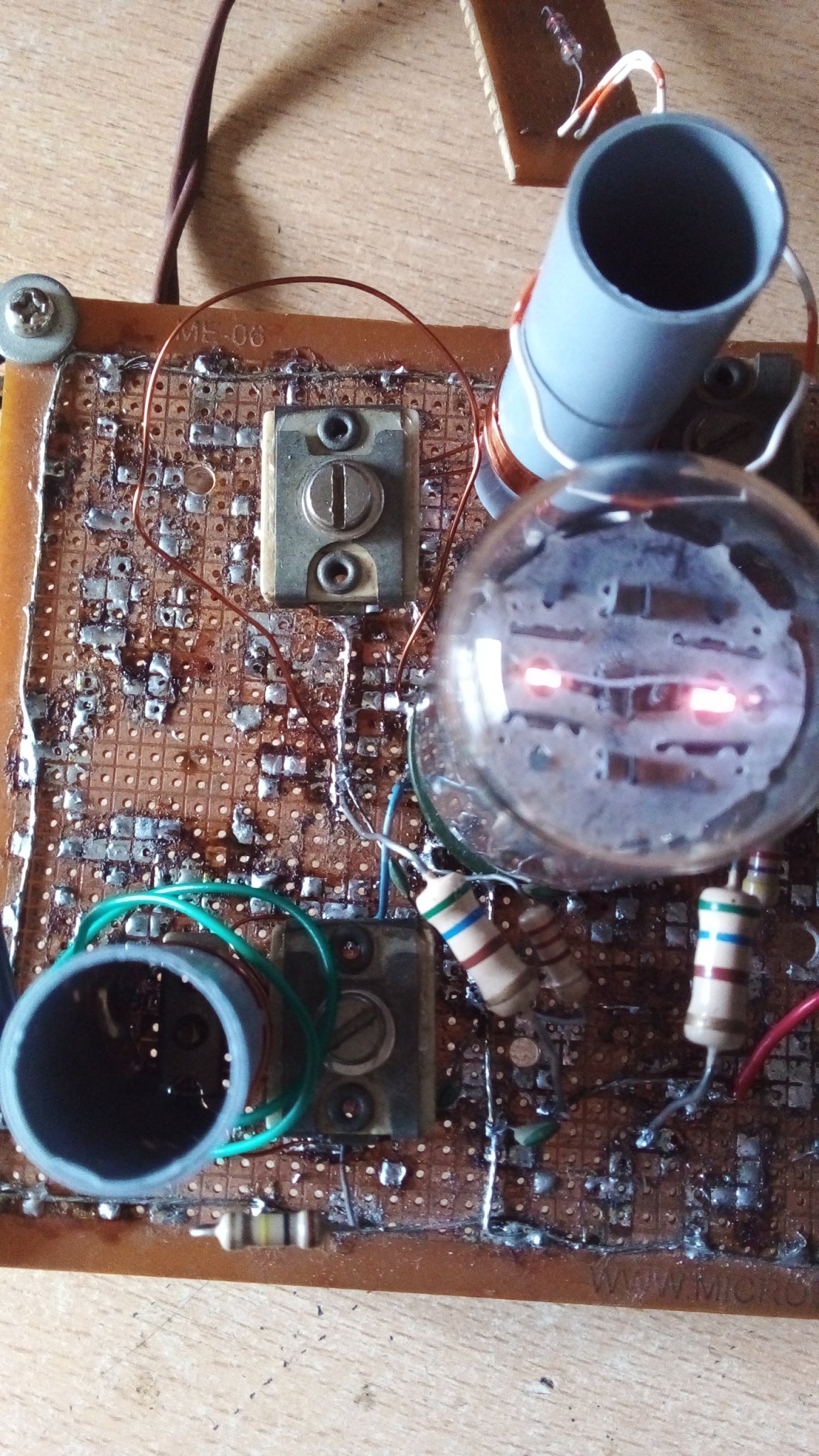

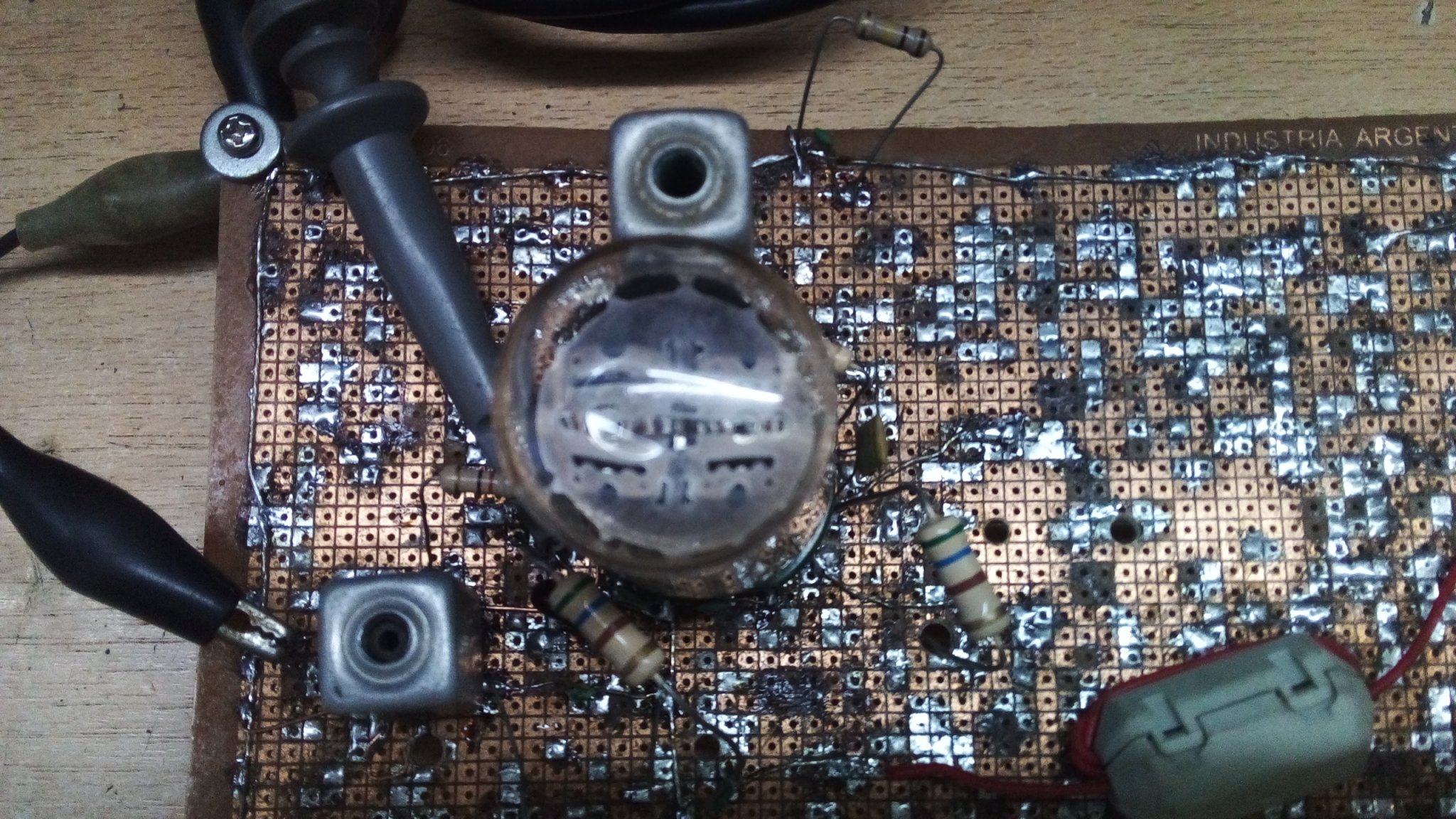

Today I completed the second stage using the second unit at 6AR11 compactron. The amplifier is still unadjusted in which coupling coefficient k regards, but it is at resonance, and the effects of limiting at the second grid is vissible, although it is cathode biased and remote cutoff units are used. Thus, a hard clamping limiter will be used of the kind already illustrated.

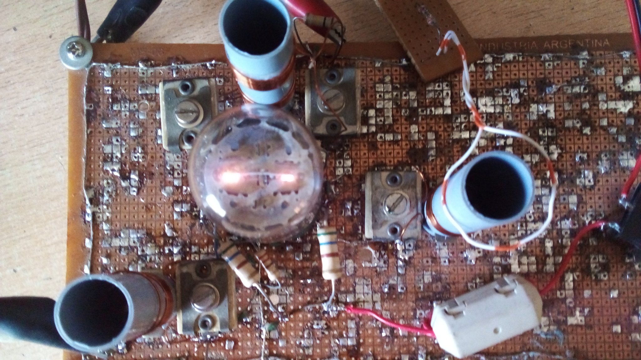

Following, it is depicted the actual physical arragement and 4 oscillograms using the sweep oscillator Eico 368 and analog CRT oscillo. In the first the signal is well below the clipping level, and the remaining with increasing levels up to 0.5V rectified at the grid leak plus 1.8V cathode bias. The marker 12MHz as is amplitude modulated over the signal, clearly dissapears as limiting action take action, although its level remains unchanged through the test.
The ring about the third coil white and orange is a capture single turn coupled to a germanium diode and crc low pass filter with two 100pF and 10Kohm to detect the signal.

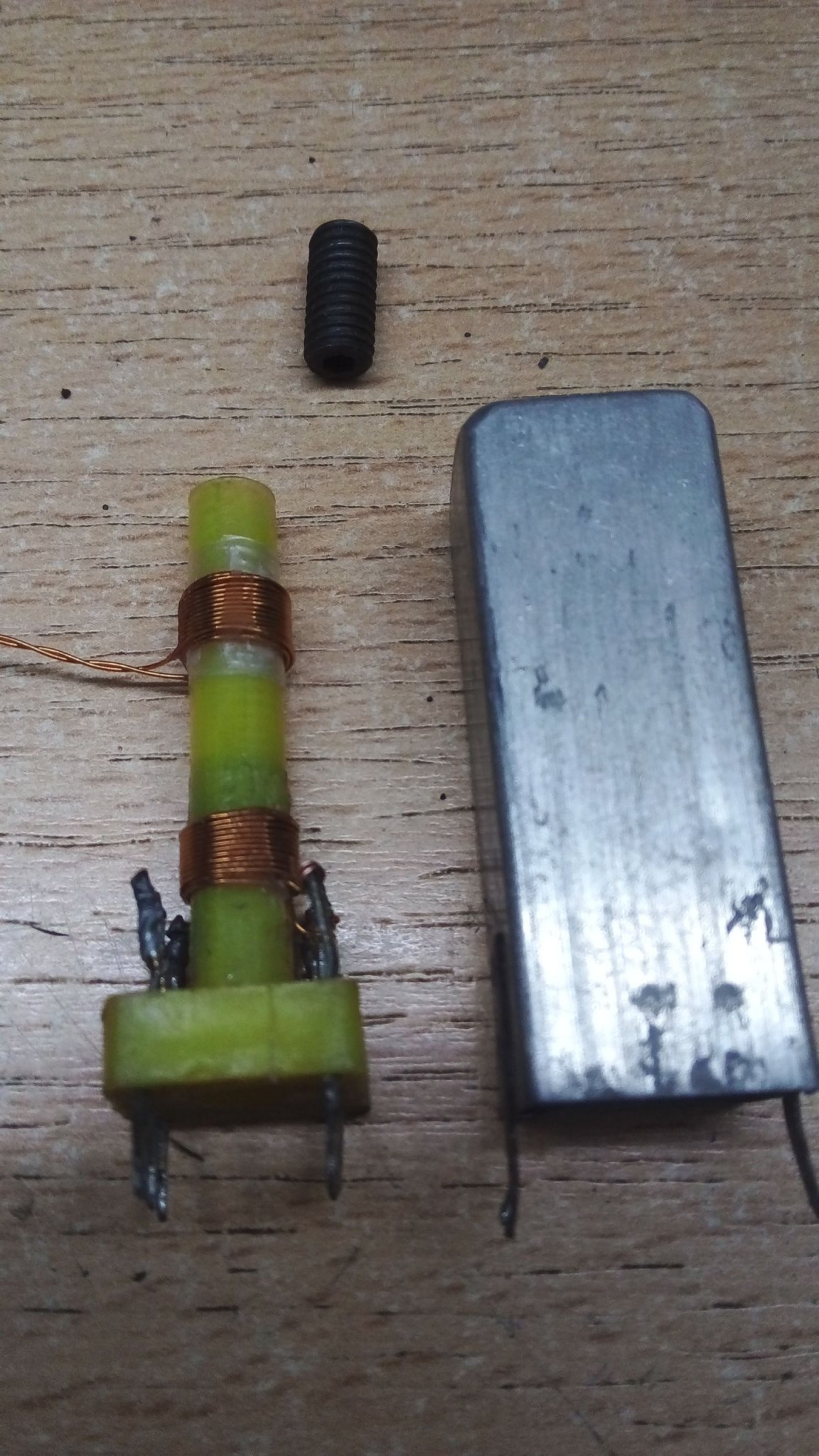

New permeability tuned IF transformers. The bottom coil is the primary and is fixed in place. Top one is the secondary and is moovable in order to adjust M and k for proper BW. Tunning capacitor is 22pF @ 500V silver mica. The plate cap isn't directly in parallel to the coil, it returns to ground using a dedicated pin.
The screen decoupling cap is only 910pF mica plata. This make the screen alive for RF of about 2.7VAC and is out of phase respect to the plate signal, neutralizing the coupling trough anode-grid capacitance. It is fully stable irrespective the high gm of the tube. Anode and screen voltages are about 140VDC.

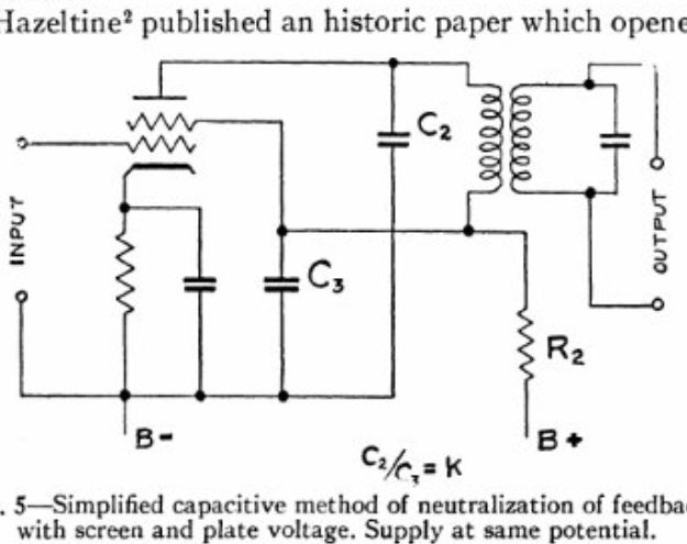

This idea isn't mine and I learned it reading the article "Neutralization of Screen-Grid Tubes to Improve Stability of Intermediate-Frequency Amplifiers" by C. A. Hultberg in the Proceedings of the IRE December 1943 available free in the web (worldradiohistory.com).
Quite an improvement on the previous IFT's, and the real art of DIY!
I would wanna bigger cans. They are 18mm side, but is what I could find. The slugs are old and crack easily.
This is my schematic extracted from the source already mentioned.
As can be seen, the tuning capacitor returns to ground in place of doing it to screen. Thus RF resonant current flows trough bypass capacitor appearing an out of phase signal at screen grid whose voltage is proportional to both capacitors in series and counteracts plate-grid feedback. This is the core of the neutralization means and really does it job pretty fine, much better I thought.
