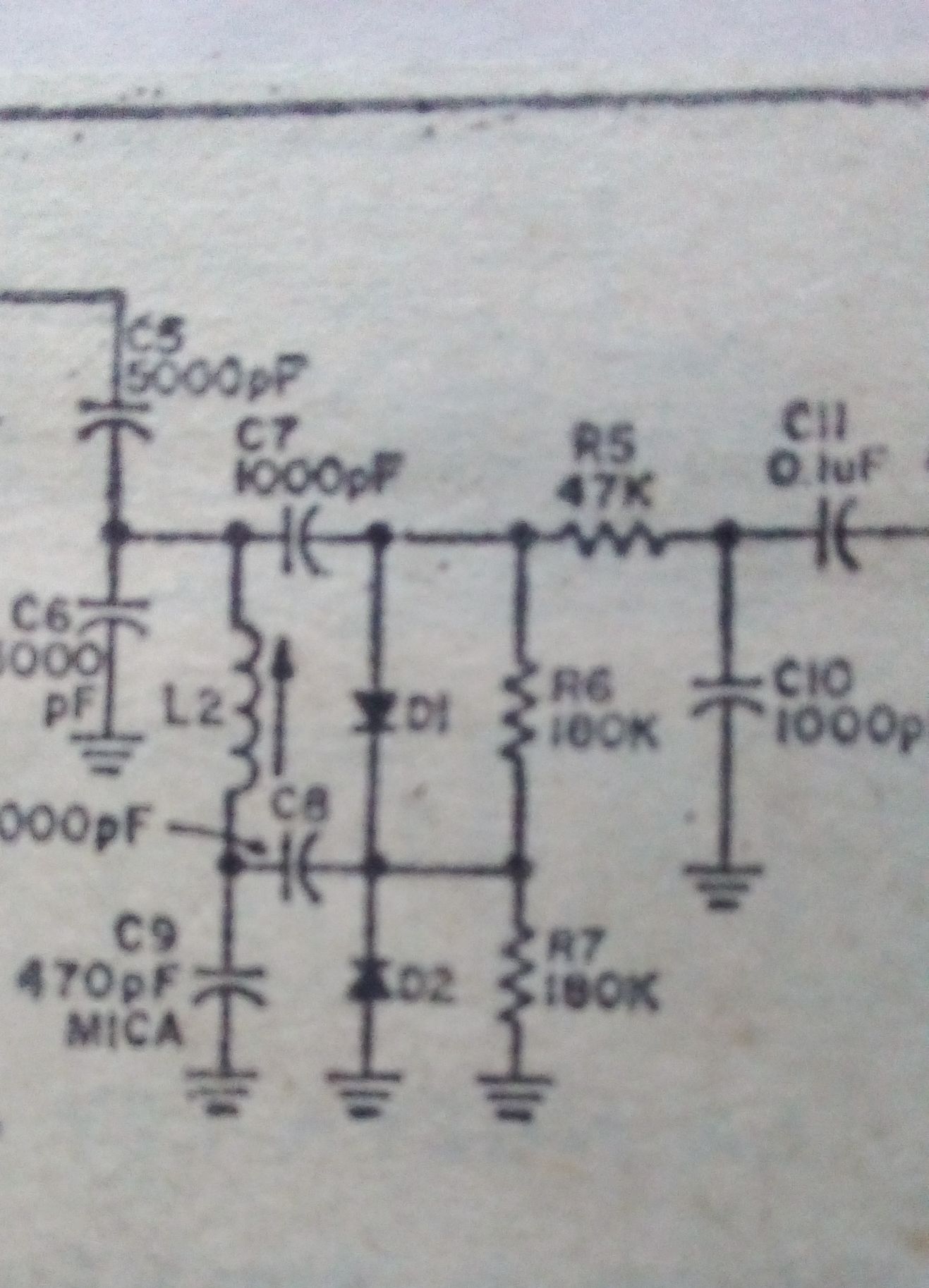

Supposedly this detector doesn't work at the resonant peak, but is rather an edge detector.

I don't know the answer, but if I had to guess I'd say it is some transformerless variant of a Foster-Seeley detector. At least there are two rectifying diodes the rectified signals of which get subtracted and that apparently get IF signals with a frequency-dependent phase difference. There is no large capacitor that suppresses AM, as in a ratio detector.

Long ago at Elektor I designed a simple 3 transistor FM receiver with such a discriminator. As that was before the internet era I didn't bother to look for names. In the circuit diagram L7 & C14 is a series resonance and at resonance, carry equal voltages. At higher frequencies the voltage over L7 is higher than that over C14 and below resonance it's the reverse. AFC can be derived from it, frequency-feedback as well so despite the low IF it could even be used for stereo.
Very intetesting. My pic is from a mazine of my father's era, say, 70's. But, has it a name from his creator? and how to calculate (or estimate) the limits of linearity or BW?, I suppose relationed to LC values and load resistors IMHO.
The principle is clear for me from the very start because it is explained in such an artcle from I took the pic, but my suspicion is that diodes in parallel to tank components, load them severely.

I don't know who created the discriminator based on series-resonance but at 1st sight it looks like a logical choice, also because no transformer is needed. But linearity can be a problem, because for proper functioning the series LC needs a constant voltage. In the circuit this was more or less fixed by the limiter diodes D2 and D3 plus the IF mosfet running at ~20 mA. As the IF is ~200 KHz it's obvious that for 75 KHz deviation heavy loading even is required. Hence also the linearity improvement from frequency feedback. When running the discriminator on a high frequency (your choice remains 12 MHz?) diode loading might need to be minimized. The easy way would be to use a lower value of the coil and a higher value of the cap. The source impedance then has to be lowered as well.Very intetesting. My pic is from a mazine of my father's era, say, 70's. But, has it a name from his creator? and how to calculate (or estimate) the limits of linearity or BW?, I suppose relationed to LC values and load resistors IMHO.

It looks very like the detector described in E.H. Armstrong, Frequency Modulation - Noise Reduction, Proc. IRE vol. 24 no 5, May 1936, Figure 7.Wow, you have it very clear.
Now, do anyone knows the name of thos simplest FM detector?

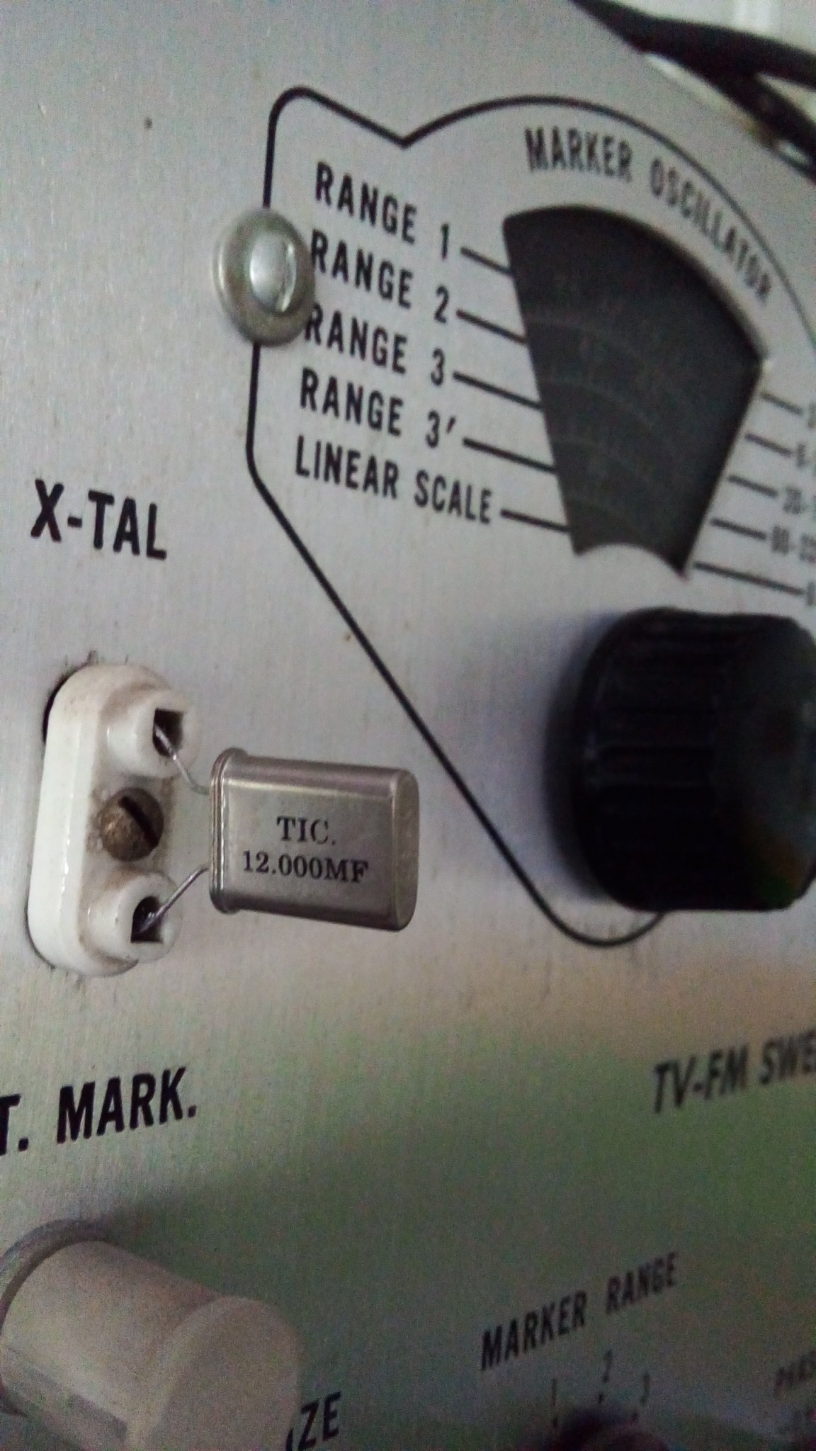

Yes, my idea is to take the IF value of 12MHz. But I am able to change it if some good rasons to change it are explained to me. Definitively, the difference with the usual 10.7MHz is about 10% and I don't suspect that something is easy to build at 10.7 than can't be done at 12MHz.
Again, I haven't modern instruments than my restored EICO 368, a RLC digital meter and a 40MHz oscillloscope. No Q meter.

The main reason to change it is that you will never find an FM generator with a 12MHz marker to align it with. Use 10.7MHz like nearly everyone else.
A higher than 10.7 MHz IF could be the better choice because when high enough, a fixed filter handles the input selectivity for image rejection so only oscillator tuning is needed. The disadvantage is the possibility of IF harmonics leaking to the input but can be prevented easily with a 2nd conversion. Thus, the front end of a high end FM tuner with tubes could consist of RF amp 7784, 87-108 BPF, SBM with ECC88 and ECC88 LO plus buffer.
My EICO generator had a 12MHz xtal to adjust the center of the IF strip. So it will not be a problem. With regard to harmonics, eventually I shall take the corrective measures to reduce them to a minimum. I had the idea of using a low Q trap in the lower triode of the cascode cathode. But let's see if it is really needed.
