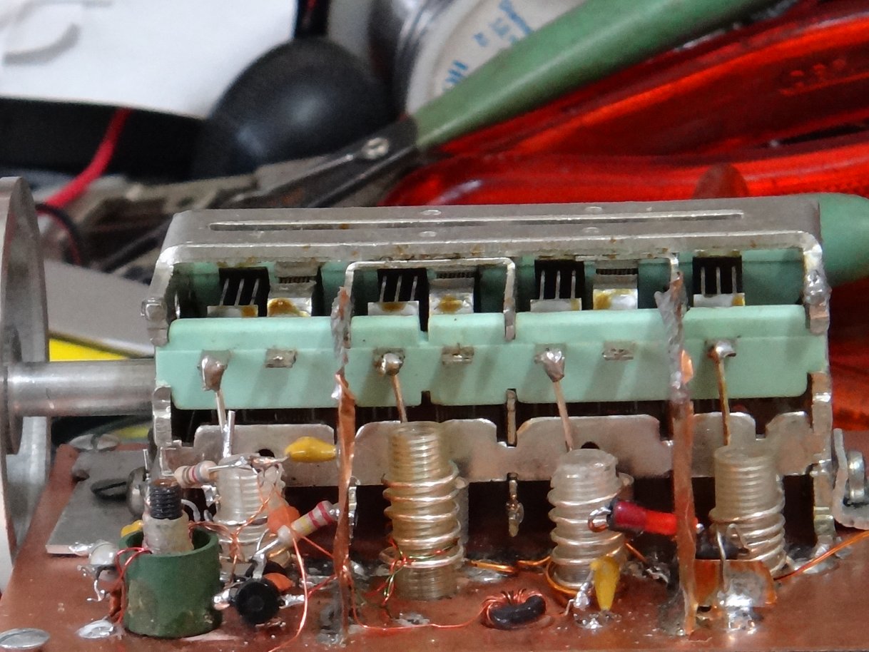

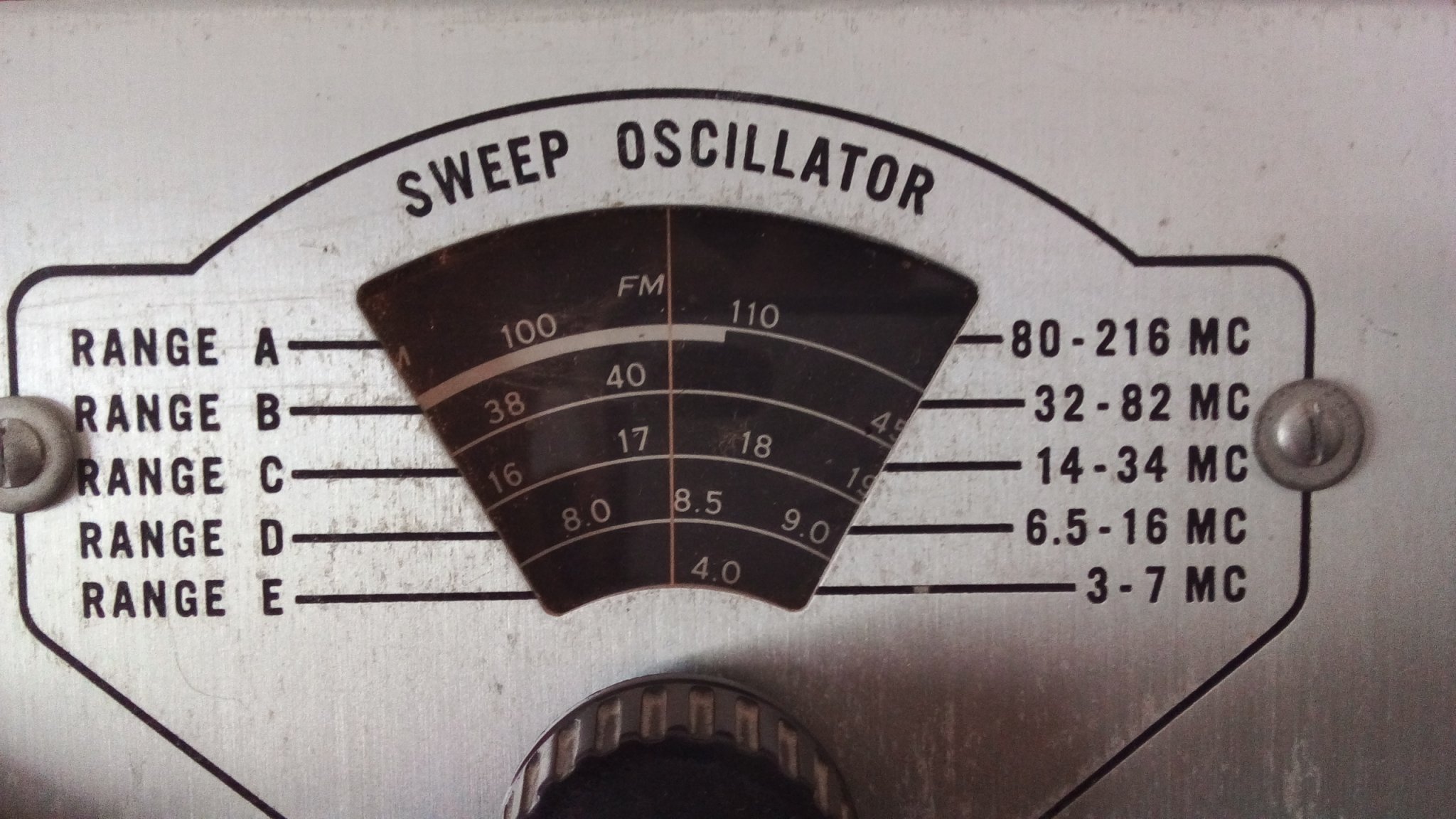

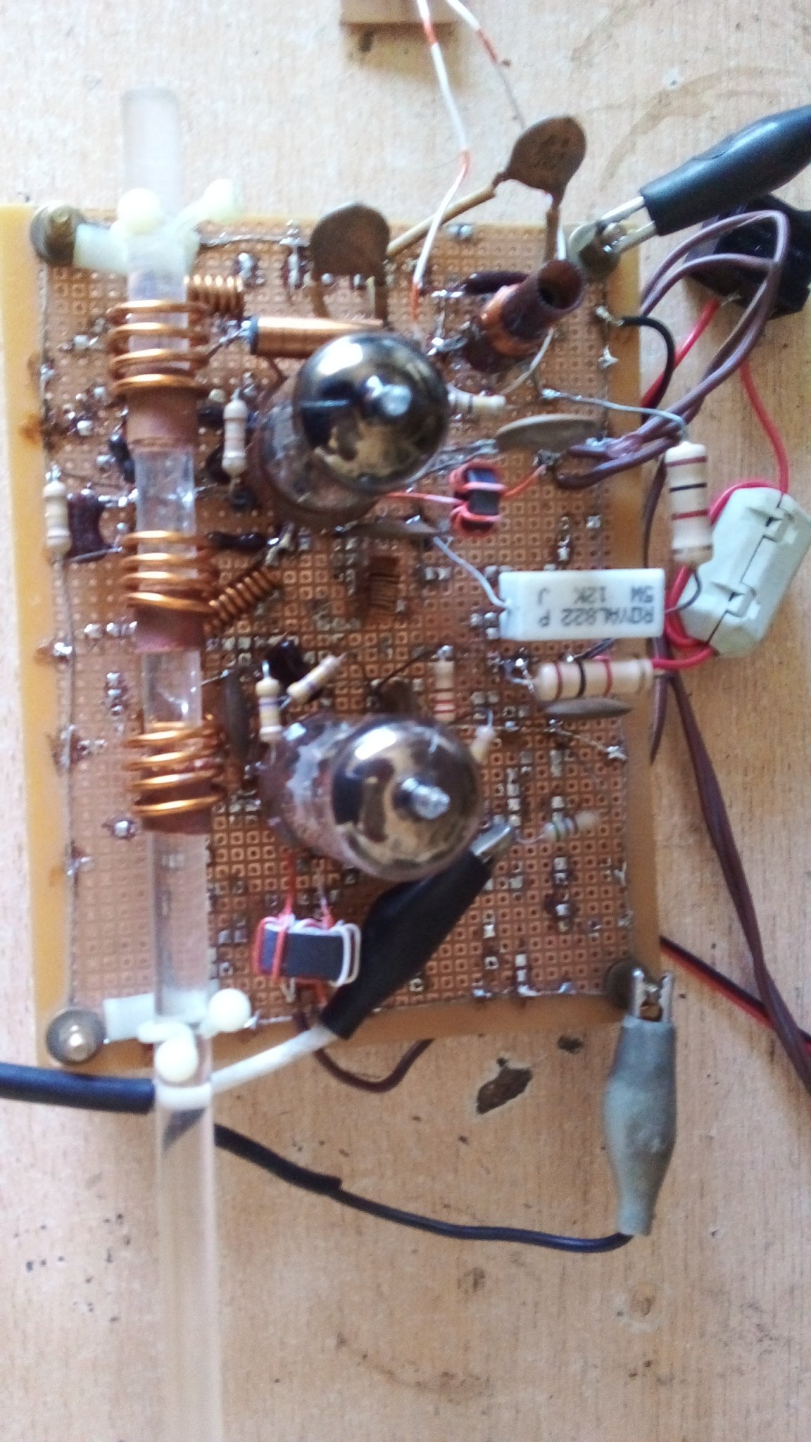

Small progress. The ECC189 RF cascode amplifier. Final tube will be ECC88 with higher gm, but as it is expensive, during test the former will be used. Base connections are the same.

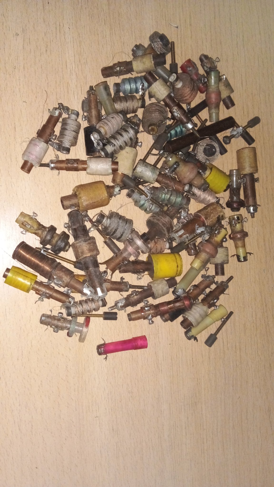

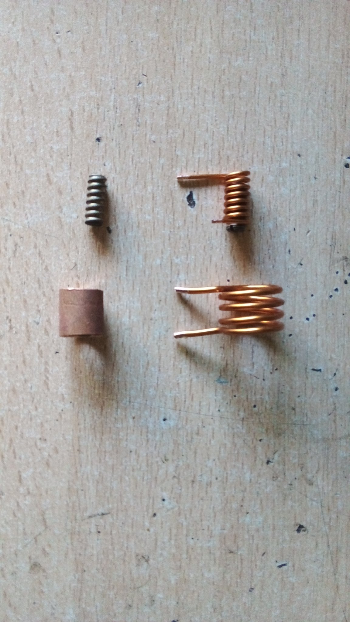

Below, at first intance, the coils, the screwed core for padder inductance, the copper core re-coppered and the main tuning inductor.

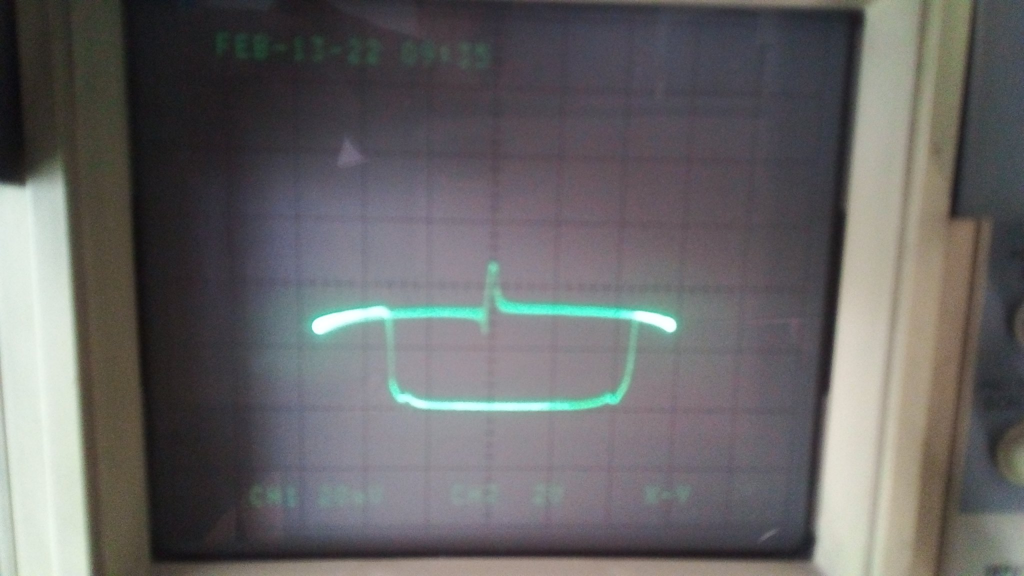

Next, the amplifier mounted in the protoboard, the sweeped waveform showing the carrier beating with the oscillator and the sweep generator dial showing the frequency. Consider that the dial doesn't coincide with actual frequency when measured the output with a digital frequency meter. Note also an undesired 50Hz signal that makes the sweep baseline non straight. I couldn't find where it enters in the signal path but momentarily it doesn't care too much.

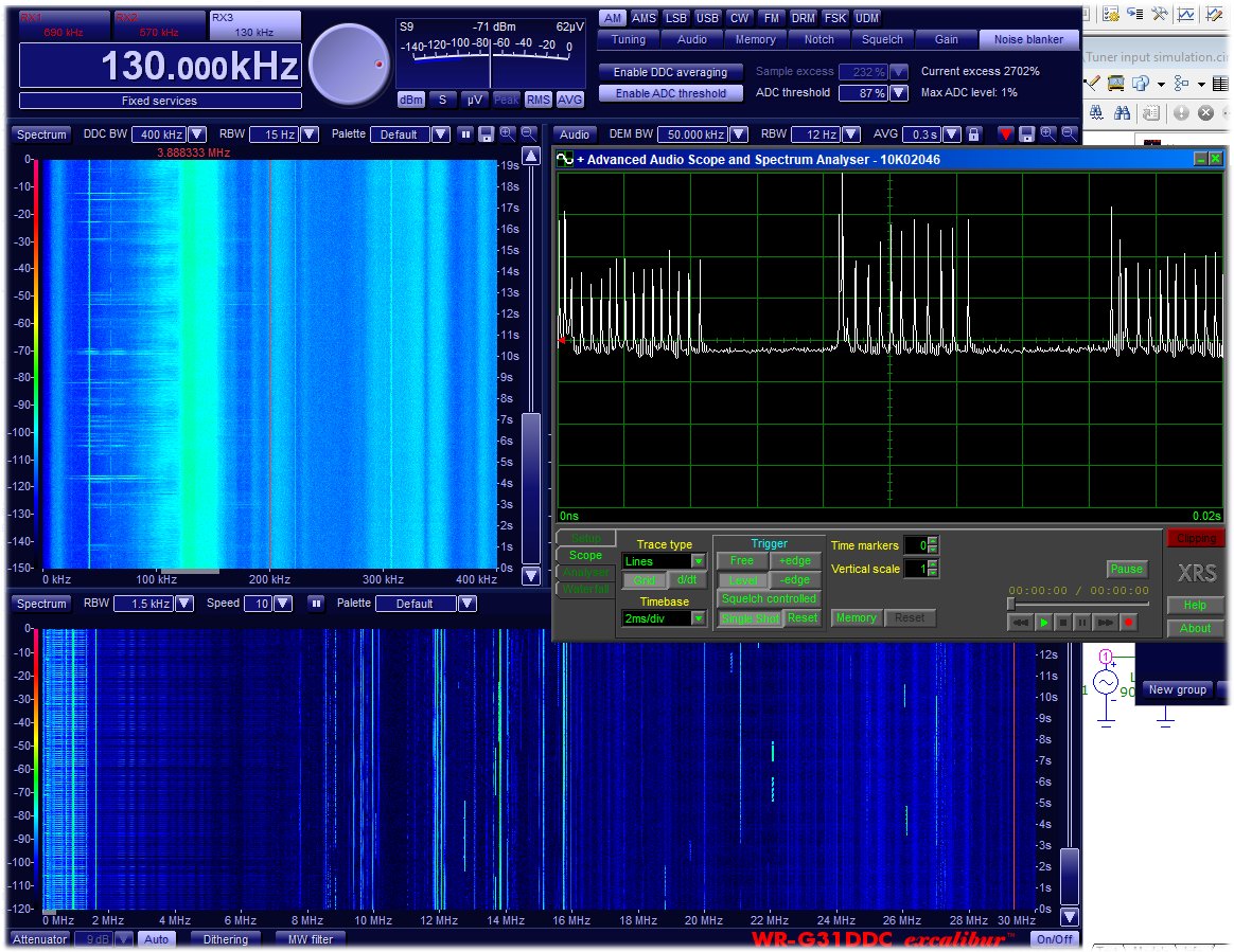

Here, the difference between "pirate" and "legal" radio is hard to tell as everyone can rent bandwidth plus coverage. But on the SDR the spectrum of most signals look bad, with 38k plus harmonics present and overmodulation, sometimes to the extent that the AFC of the station is exceeded.

Update: I found a break connection between one anode of the EZ81 and the trafo causing too high ripple and oscillation of the ECL82 voltage regulator. Tomorrow let's see if the reference line in the sweep is straight as it must be.

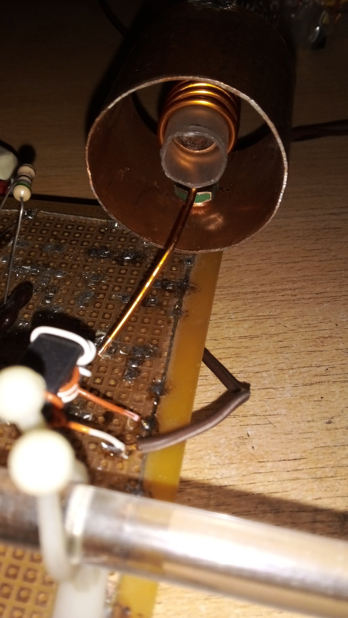

Adding the antenna-cascode's grid matching element. A resonator similar to the above but shielded inside a 25mm copper shield from plumbing tubing and axis rotated 90deg to reduce couplig as mutch as possible. Still unconnected but phisically mounted. Temporarily, the core command will be independent for mechanic complexity.

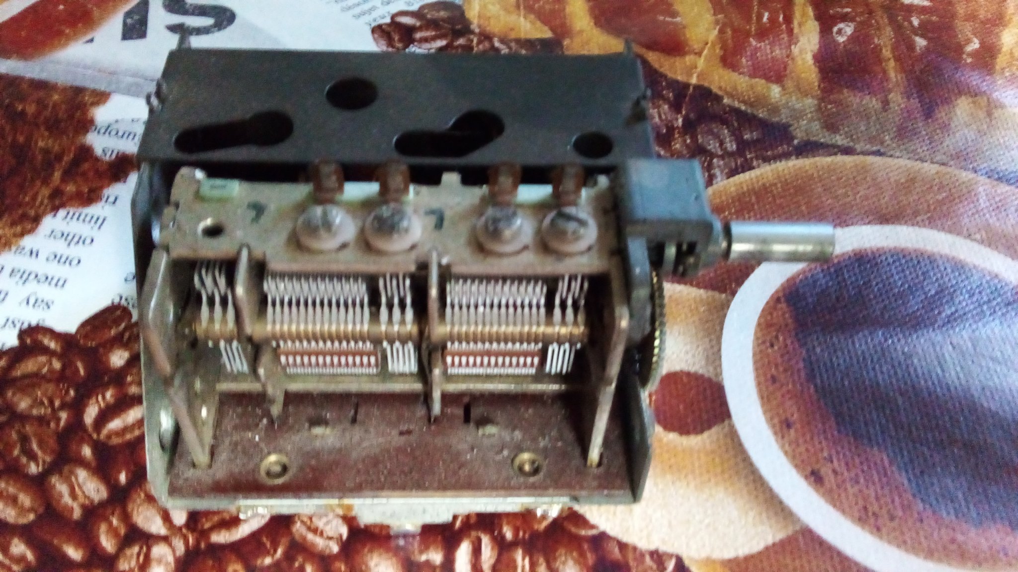

I had such a tuning cap from an old DX-160, it has 4 VHF sections but 3 AM sections. As it's rather small I used it for an "all MOS" FM tuner: BF987 RF amp and single balanced mixer with 2X BF981, LO BF987. From switching on the LO is so stable that I omitted AFC. Measurement setup over a 24 hour period showed the LO stayed within 1k...
Nice project! Did a similar tube tuner with four gang tuning cap. It has a cascode RF stage and a Revox-style IF filter and wideband IF limiter. Performance was a bit underwhelming and I aborted the project.
