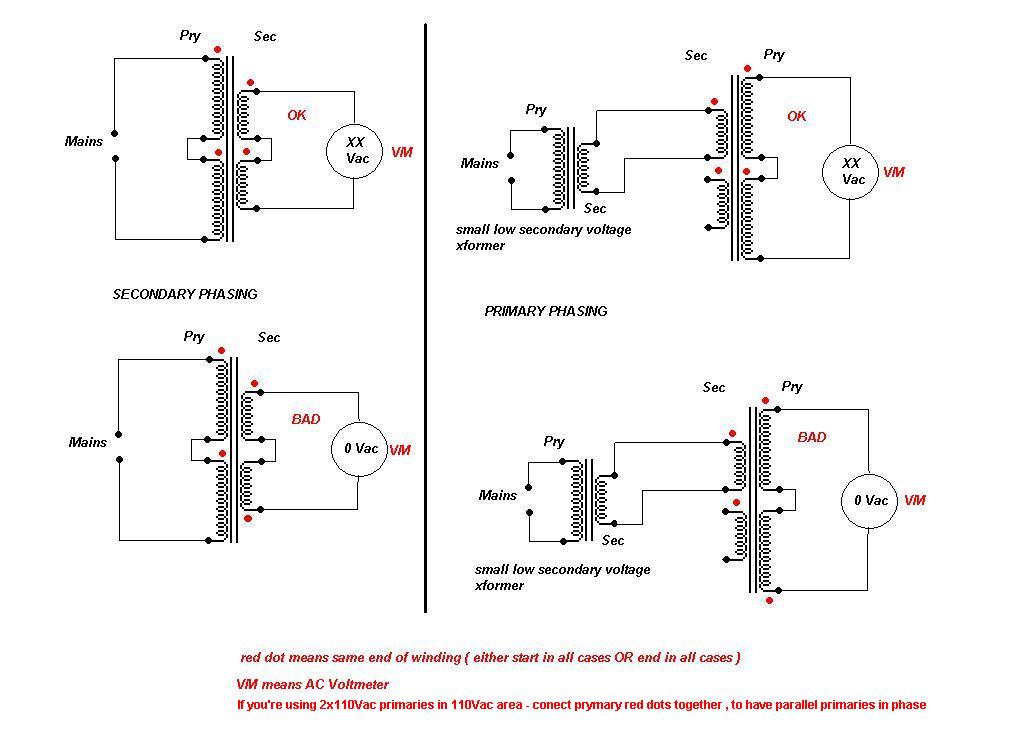

on the other hand ....... I presume that's dual primary Donut , so check with continuity test am I on right track :
Yellow One and Red One are one Primary
Yellow Two and Red Two are next Primary
if yes , for UK mains ( aroundish 230Vac?) , connect Yellow one to Phase , then together Red One and Yelow Two ( insulate that connection) ,then Red Two to Neutral
if you're using regular fuse (750VA/230Vac = approx 3A15T) , nothing catastrophic can't happen , except maybe some heart palpitation 🙂
well , all this counting that your're speaking about primary colors , while secondaries are ignored this time
just in case - secondaries are always having much fatter wire , while primaries and shield are having skinnier

First, disconnect the amplifier boards from the PSU. You don't need to have them attached until the PSU is sorted and working. 🙂
Which secondary leads are mates? Each secondary is a single piece of wire looped around the core, that wire has a beginning lead and an end lead. Continuity test will show which is one end and which is the other.

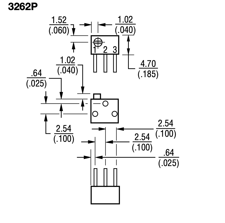

I’m now at the last hurdle with my BOM. Trim-pots. Bourns has different pin configuration - straight and offset - all have 3 pins but there are 4 holes on the pcb for the trim pots. Little things like this completely throw a beginner!
Are there 4 holes so I can use trim pots with either the 3 pins in-line or those with the pins off-set? I don’t want to buy the wrong ones as they are relatively expensive and then there’s the carriage cost on top for a re-order if I'm wrong! I’m looking to buy this: 3296W-1-502LF Bourns | Mouser Российская Федерация
and the 500 ohm version. Thanks again for your help. I’d be lost and pulling out what’s left of my hair without it!
@belmondo - if you're so inclined. If I had it to do over again, I'd have put in the pots with the adjustment on the side. I can't remember if the F4 boards have both in-line and Y configuration, but something like this makes it so much easier to adjust the bias and offset. I couldn't find the exact part I was looking for, but someone with better Mouser-Fu skills may be able to jump in with the exact part number for both pots.
