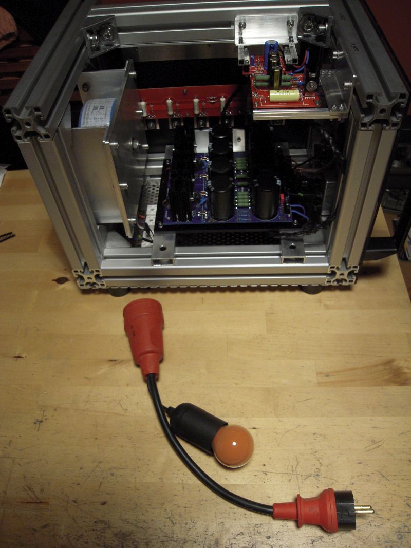

A light bulb tester is like an extension cable where the hot cable from your
wallwart is interrupted / cut and a light bulb is made inbetween.
Very good tool (easy selfmade) to test your amp at first startup for shorts
without destroying it. Works like a current limiter and can be a `life-insurance'
for your new amp!
Check pics.😉

You put the light bulb tester between your amp and the walloutlet.
If you switch your newly built amp on the bulb will shine pretty bright and then will dim down or go off - then your amp is o.K... - No shorts.
Doesn't work with LED-bulb! You need a classic filament lamp.

Excellent advice!
I NEVER fire up an amp for the first time without using a dim bulb tester (well, at least since my very first project that blew up when I flipped the power switch for the first time...). Sometimes, I'll use both a dim bulb and a variac to see how things behave as you ramp the voltage up.
Using a dim bulb tester will deliver far less working voltage to your amp, but should allow you to verify that offset figures are ballpark, that voltage is making it to your output fets, and that you can adjust the bias level as expected. An amp with a dim bulb in the AC loop may have some hiss/noise/static/whatever (because voltages are low), but it should actually allow you to verify that the amp does indeed operate. You amp, with the dim bulb in place, should still produce music output with a test speaker.
