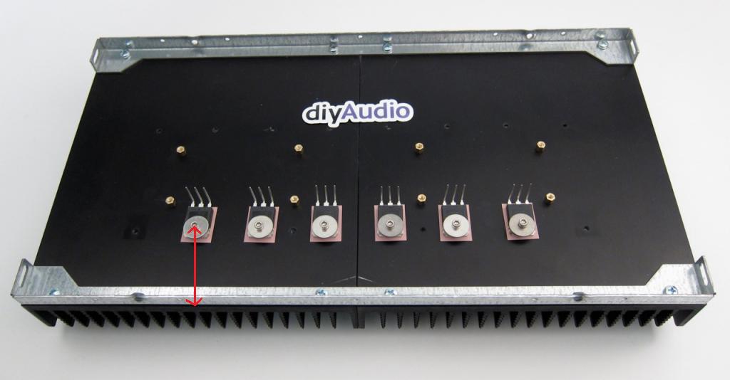

This is the heatsink(s) from the 5U 'BIG Amp Chassis' It has a mirror-imaged set of pre-drilled heatsinks and brackets to hole them together and make a mounting point for the rest of the enclosure. The 4U is similar, but the heatsink is a single piece.
This build will also utilize the 'DIY friendly' baseplate, here shown with the feet and hardware, and also the heatsink's brackets.
There is a hardware package available for the pre-drilled back and heatsinks, including input and output jacks, IEC module, and hardware for the PCB and heatsinks.
The contents of the hardware bag.
Using the brass PCB standoffs, install them into the PCB mount holes as shown, to get the following pattern;
Now there is a place to mount the amplifier PCB

There is a top and bottom to the Universal Mounting Spec holes, the board mounts as shown
I find it helpful to bend the leads of the transistors first, and mount them (a little bit loose) to the heatsink.
Like this
And then mount the PCB. You can snug all the screws down and then solder and trim.

Really great pics and write-up ! I have a heat-sink question as I have not drilled my sinks yet. Could someone tell me the distance from the bottom for the mosfet bolt holes ? See pick View attachment 343260
1/3 up from the bottom is a nice place to start.
