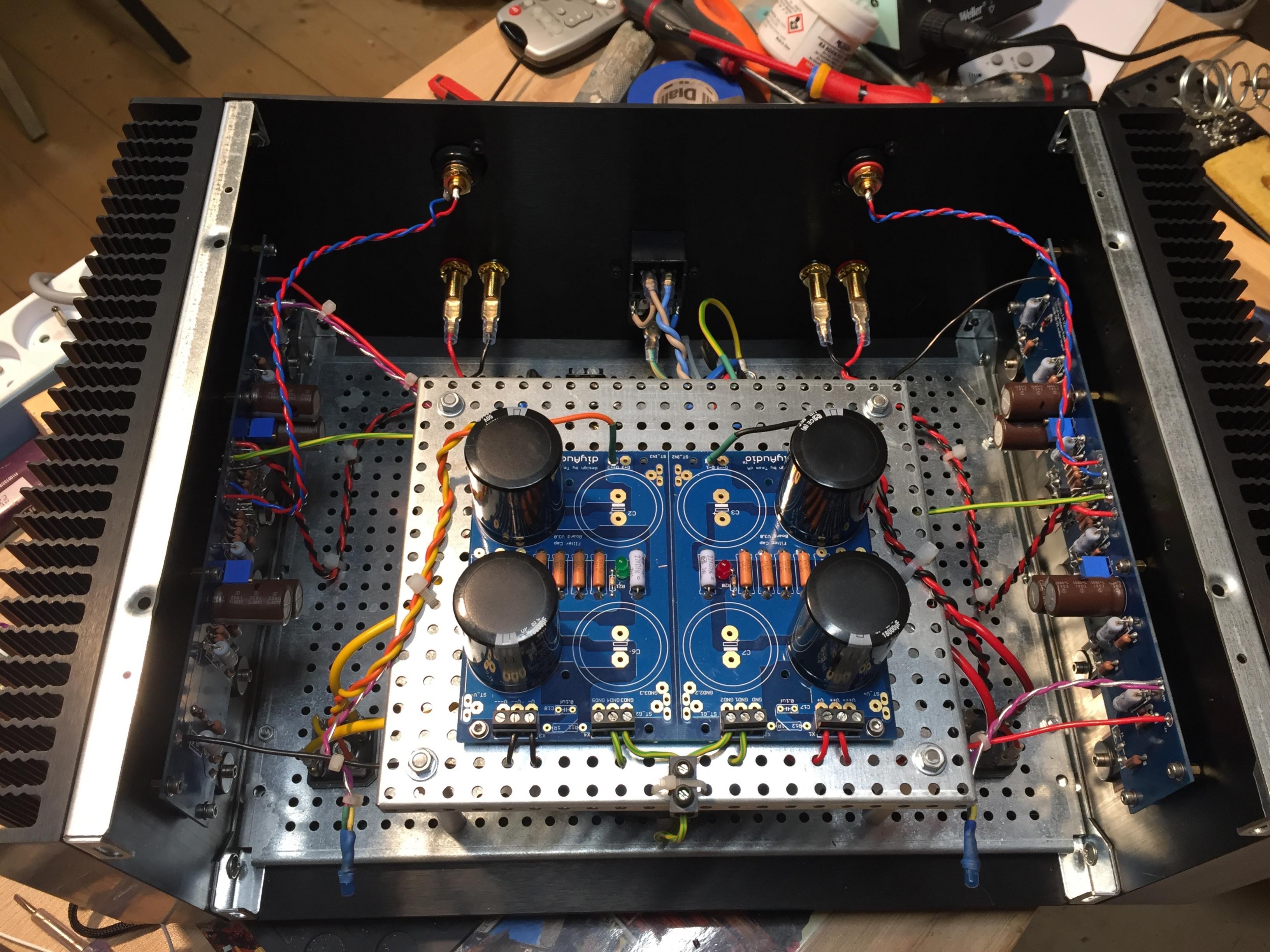

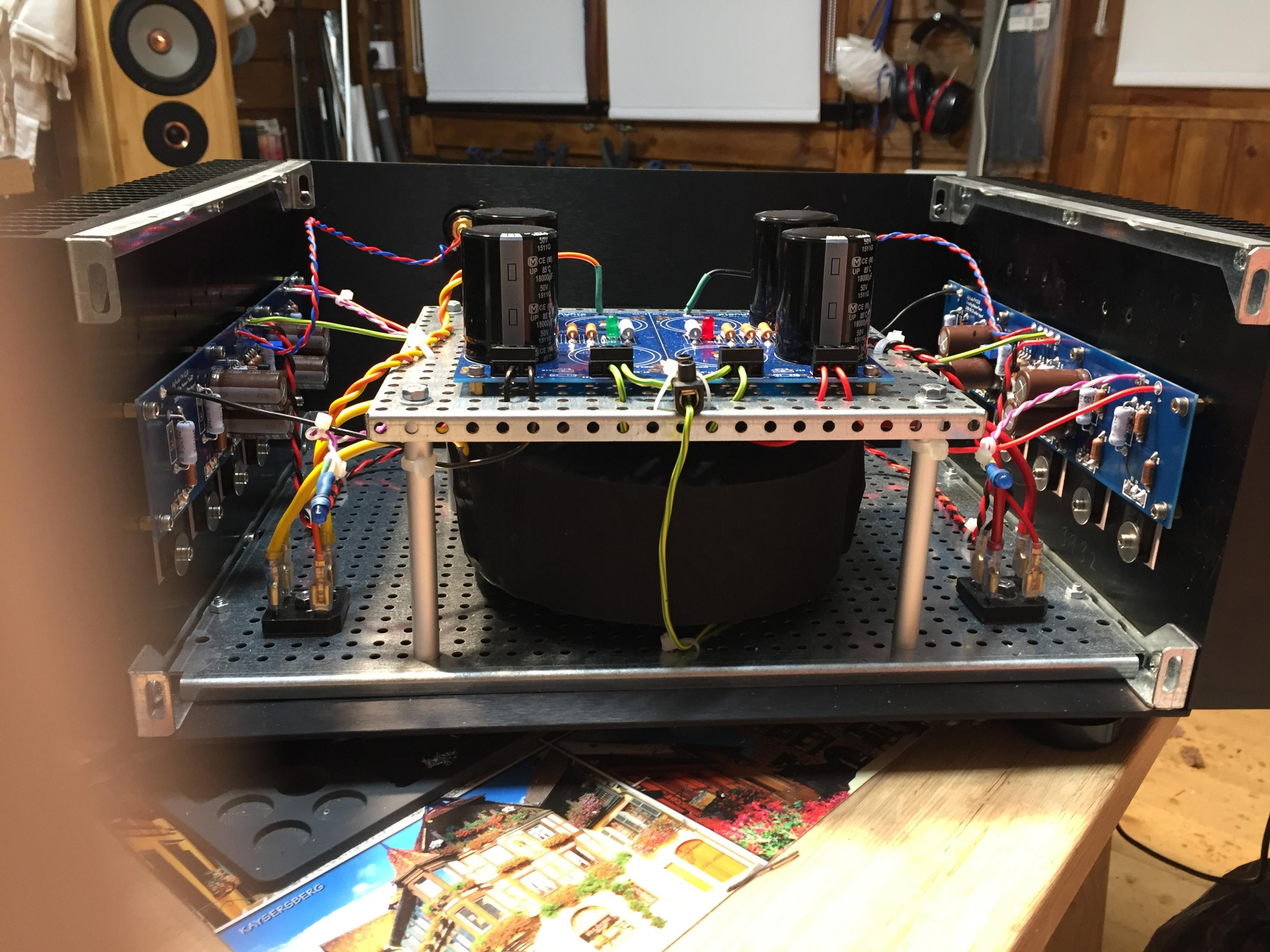

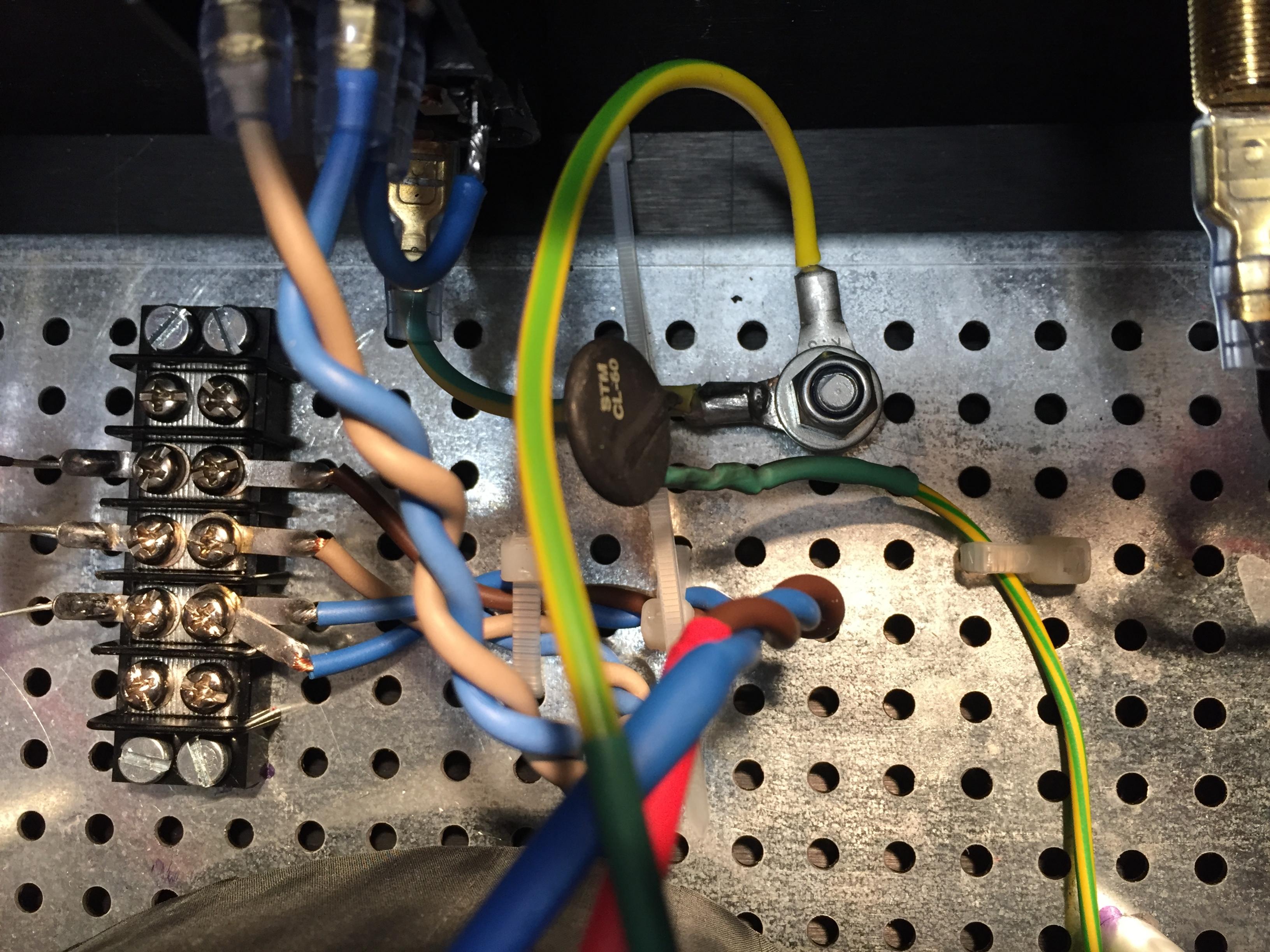

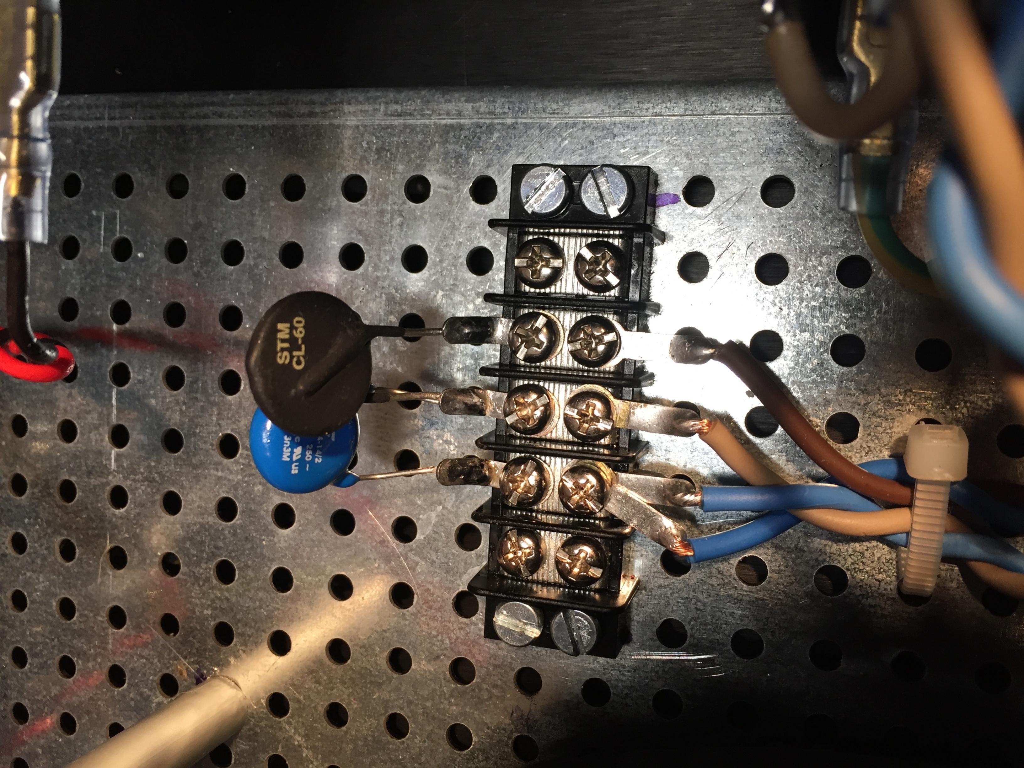

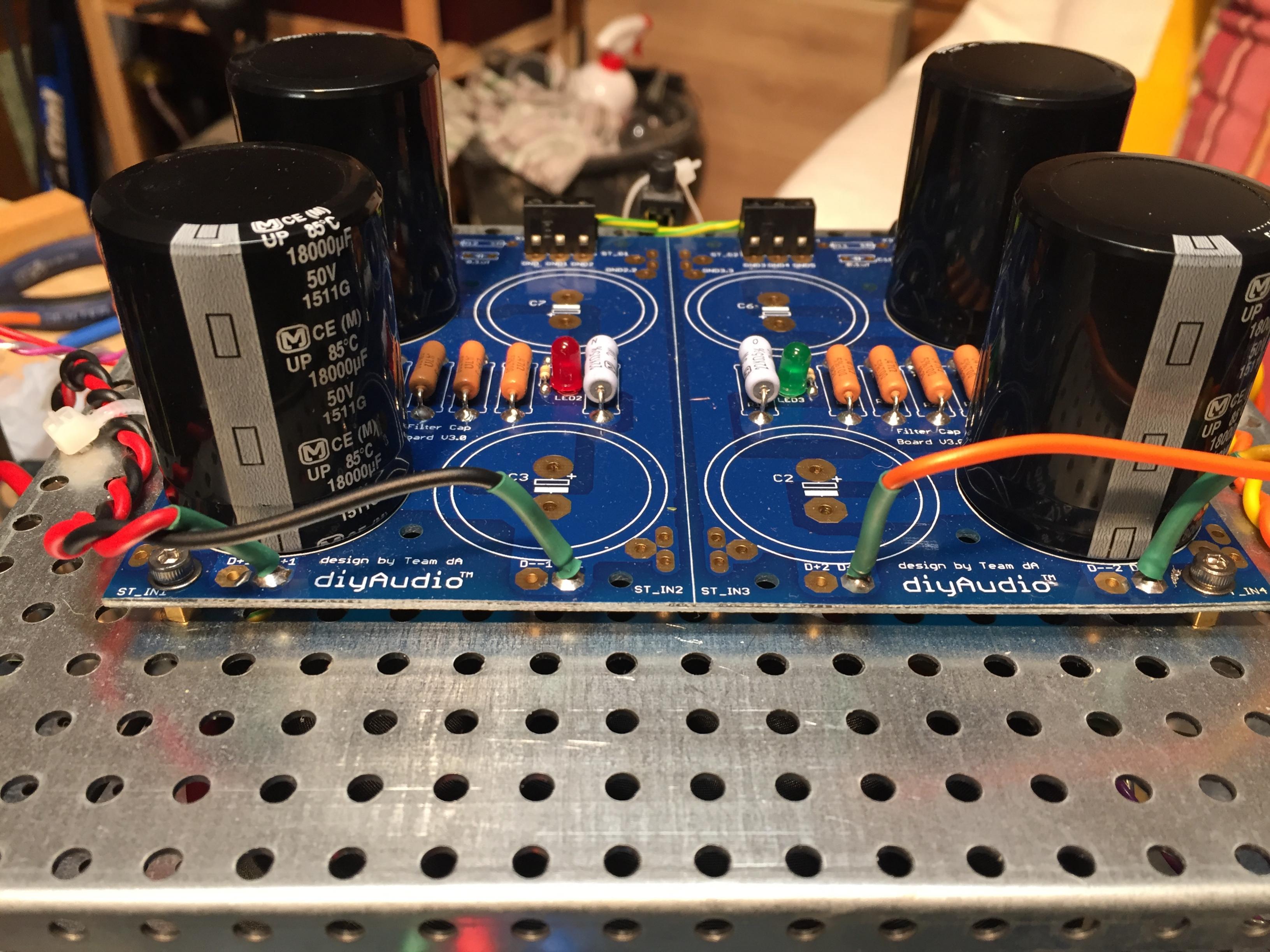

At the moment switch on results in two blown fuses, I must have connected something incorrectly.
The Middle wire on the CL60 connection is from the IEC, I'm fairly sure this is correct and the wires from the transformer are two yellows on the left which were labelled 1&2 and two reds on the right which were labelled in the same way. If that is correct then does anyone have any suggestions as to where I have gone wrong?
two questions :
-do you have datasheet for xformer?
-hope you didn't bolt anything else ( wire , any plate) to central Donut fixing bolt?
No sorry, I don't have a datasheet for xformer.
The transformer has a rubber plate underneath which has one central bolt through the middle, this is in contact with the metal base plate, this and the primary and secondary wire are the only connections for the transformer.
I have checked for continuity on the secondary wires, which is one yellow to one red.
Your picture shows two yellow wires to one bridge and two red wires to the other bridge. If continuity is yellow to red, then you need to connect a continuous pair to each bridge.
