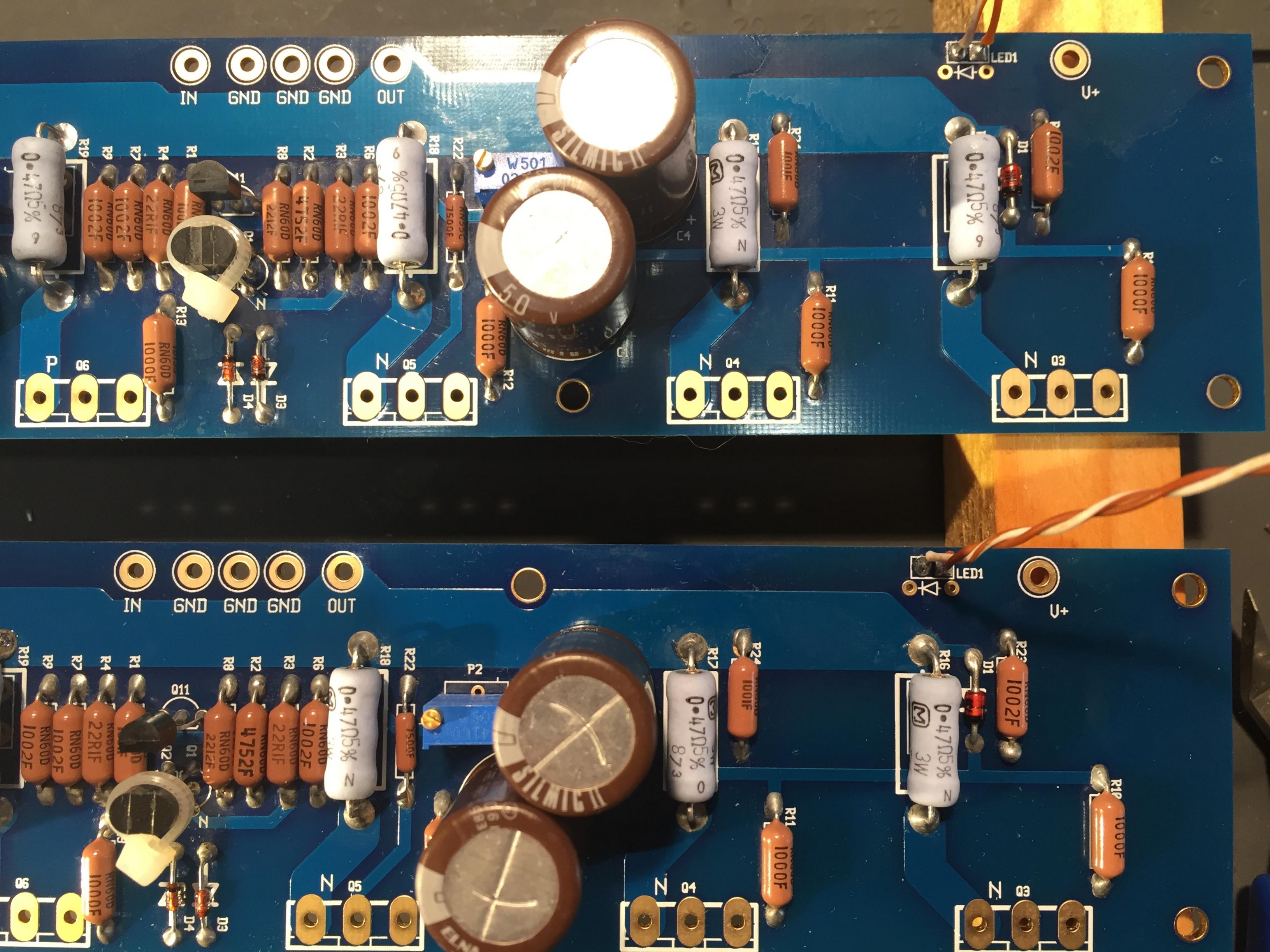

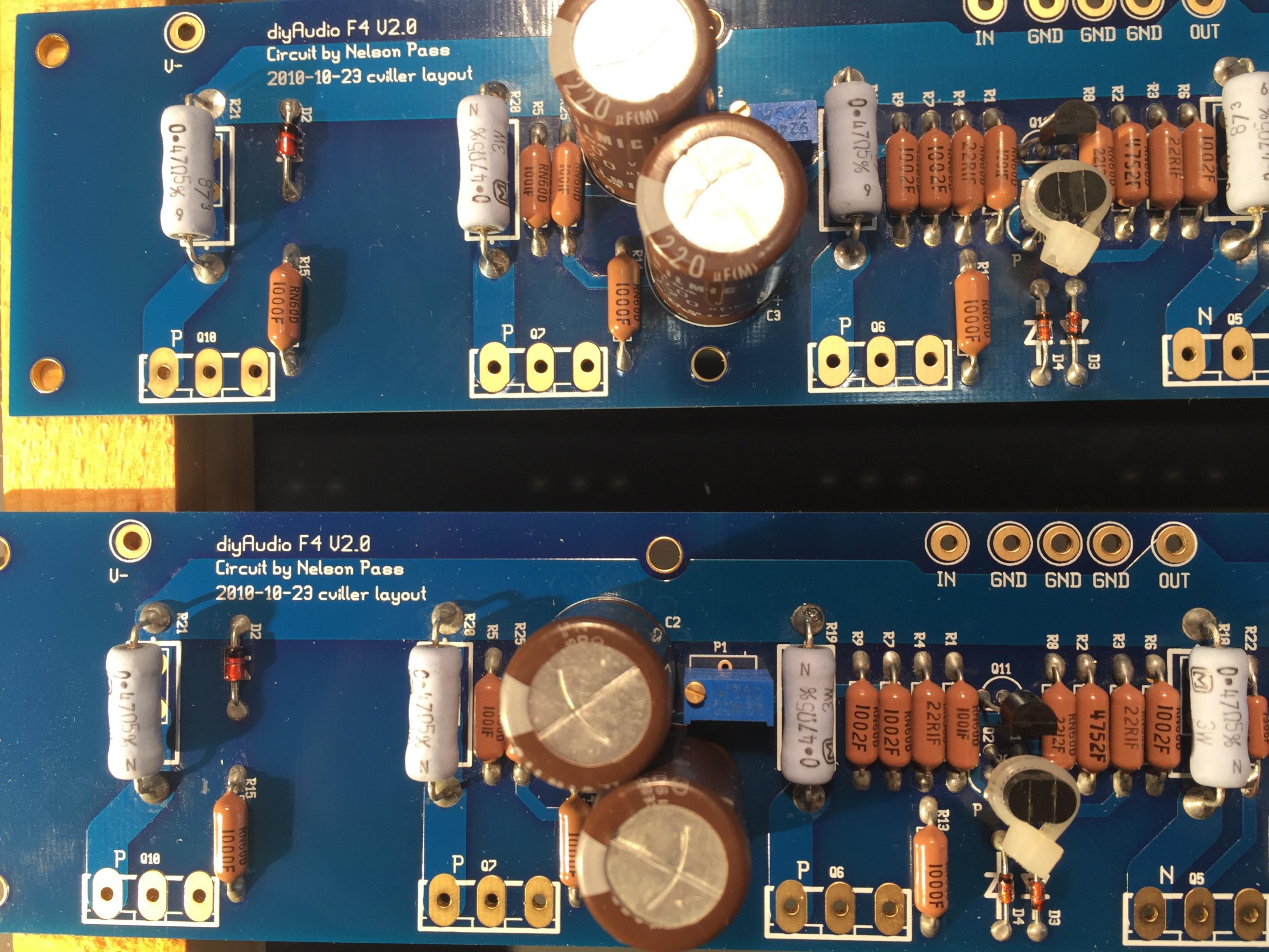

You guys are awesome! One down and one to go. I feel like a one man Pass "F4" pit crew with as many times as I've taken this amp apart and put it back together.

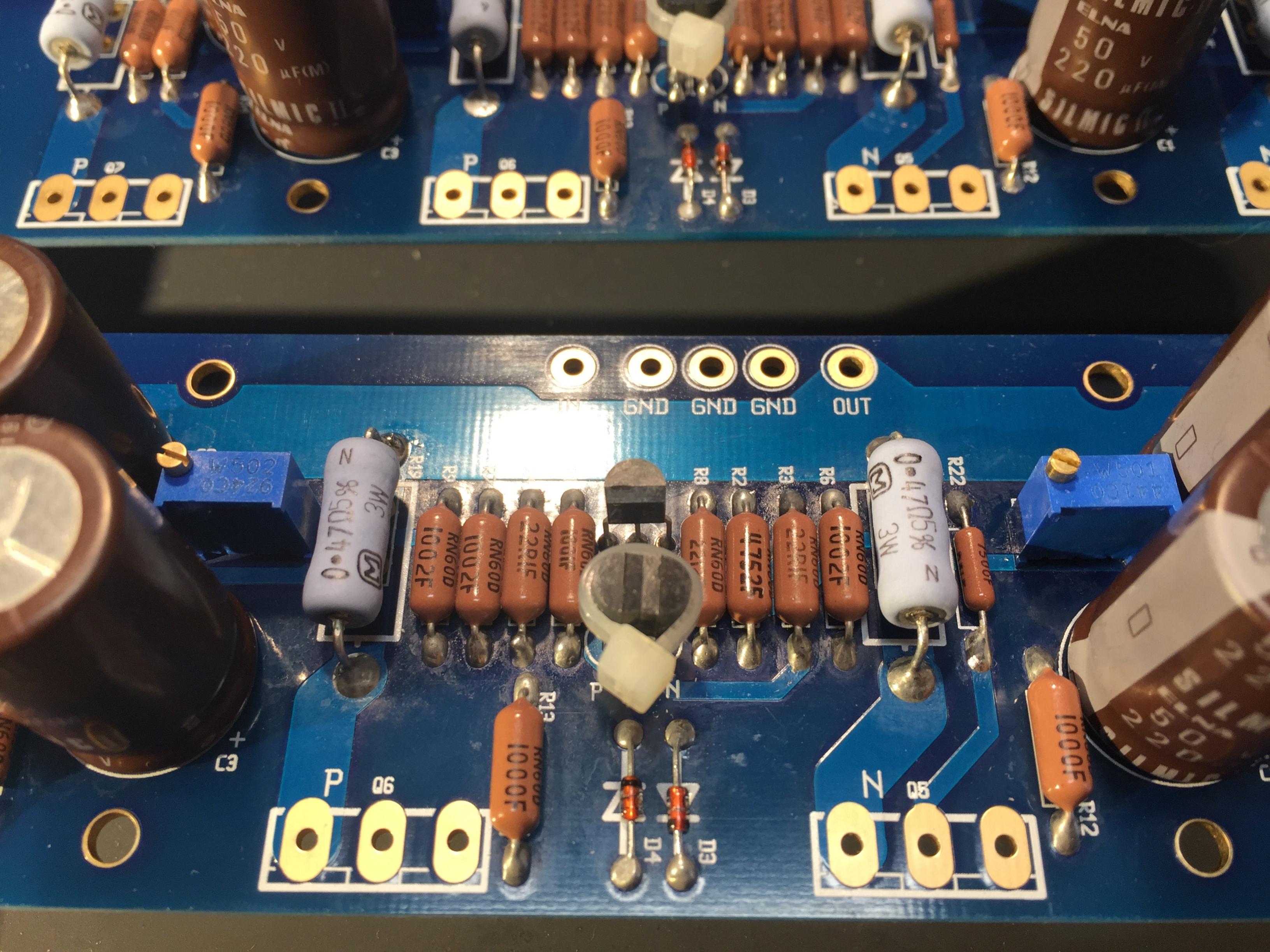

So, I took the PSU out, toroid out, "Channel 2" board out. Took out the 10k of the 22k1 + 10k pair at R8 and replaced 10k with 47k5.
Lookie Lookie Lookie... Woo Hoo.

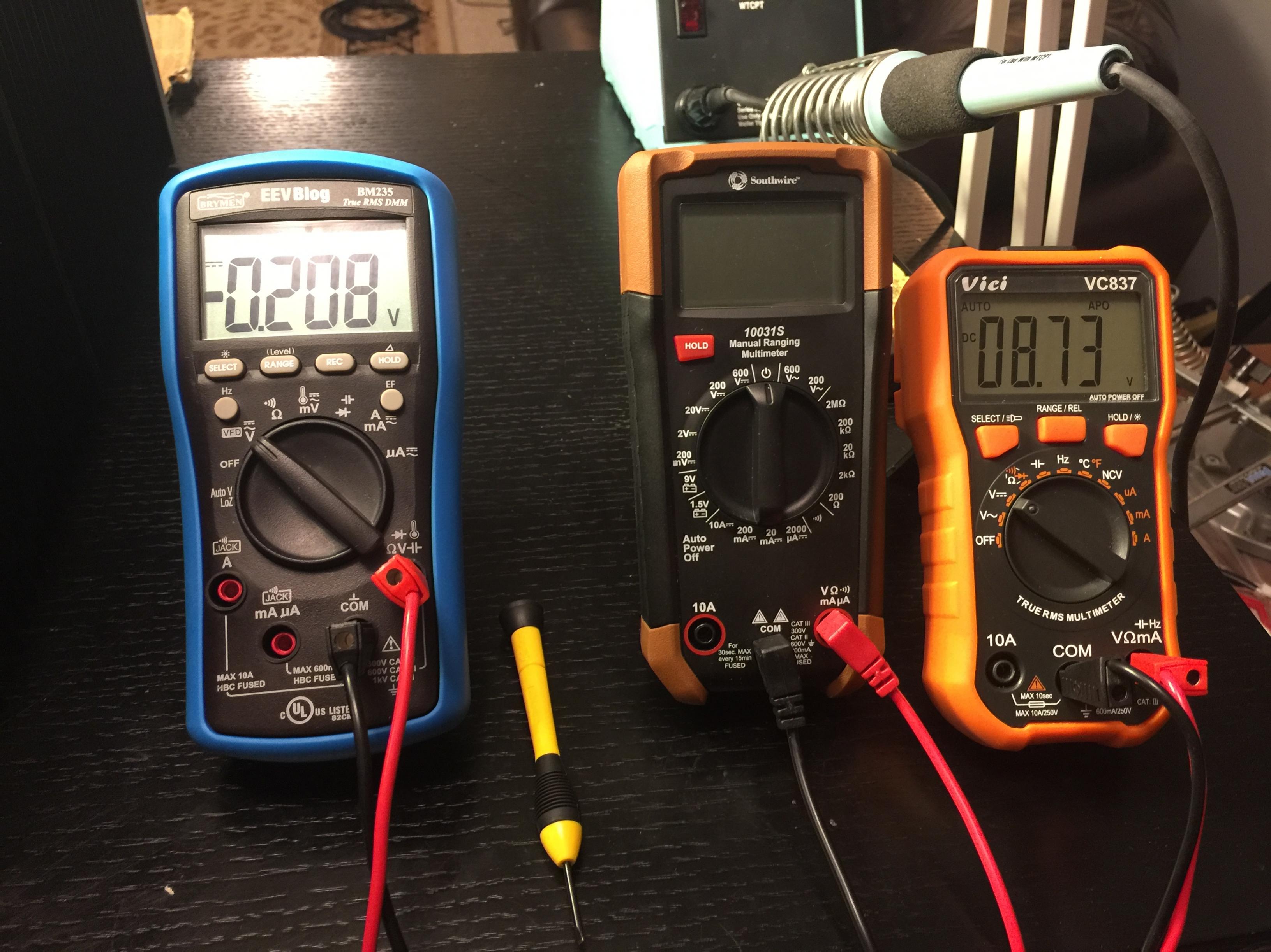

Left is the voltage across the source resistor. Right is the voltage between the gates.
I wanted to get it up to 0V2 just to make sure that I did't run out of room later.
On to add 47k5 to Channel 1 R8.

Another F4 is born with help from the family here! I let it cook for an hour at 0V250 and nulled the offset. Once the correct components are used it is exceptionally simple and very responsive / sensitive to changes to dial it right in. I think b/c the Vgs of my N and P were relatively close, even when I altered the bias substantially, DC offset didn't budge very much from the initial nulling.
I listened for 10 mins or so on the test bench and felt comfortable enough to move it to the main rig. I don't have proper gear to test the distortion levels etc, but Jim mentioned his "sweet spot" was 0V300. I'll monitor temps, but I'm only at 44C on the heatsinks at 0V250. I'll judge by ear and whether I want it to warm me up. MN in the winters is chilly.

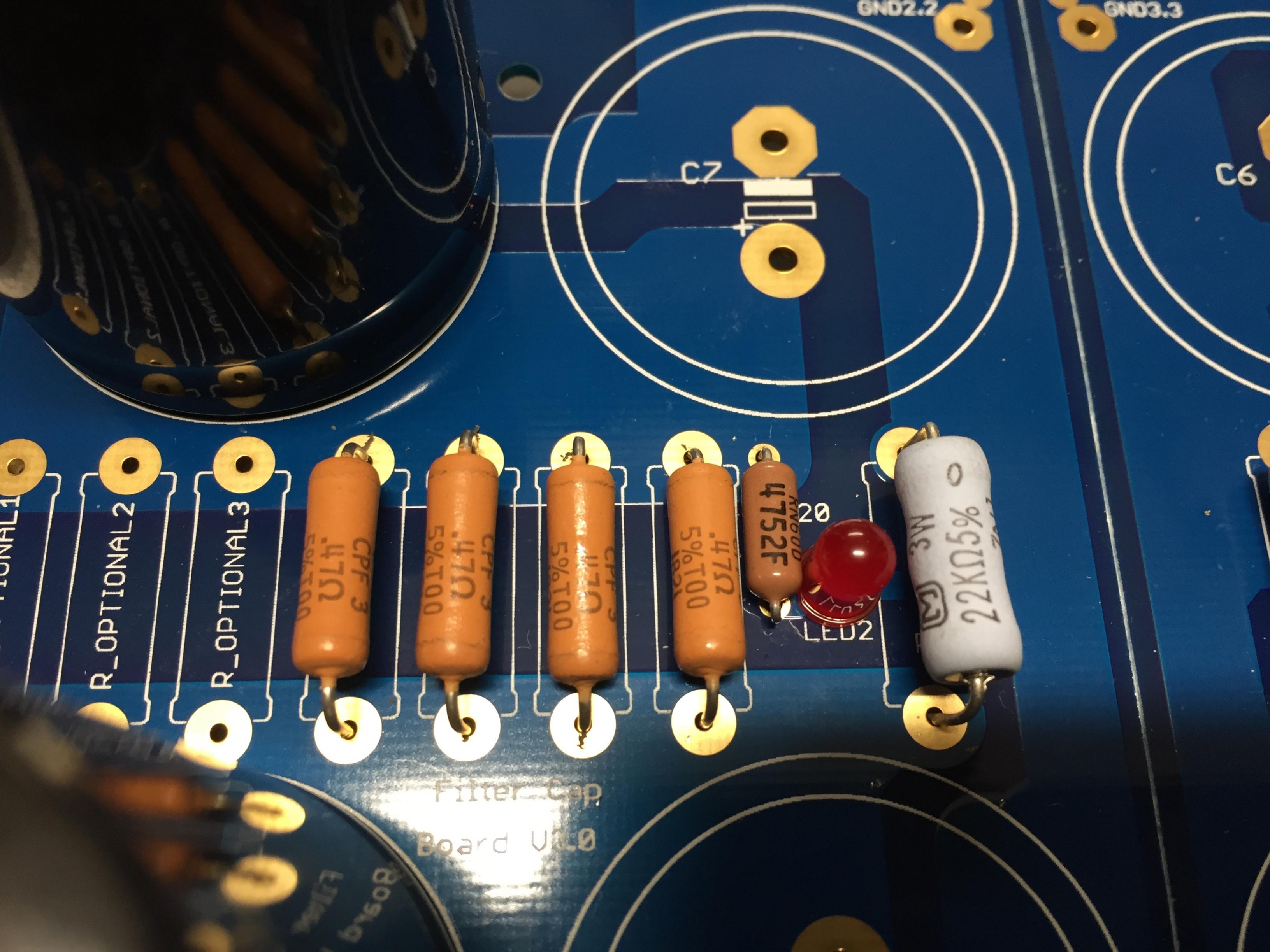

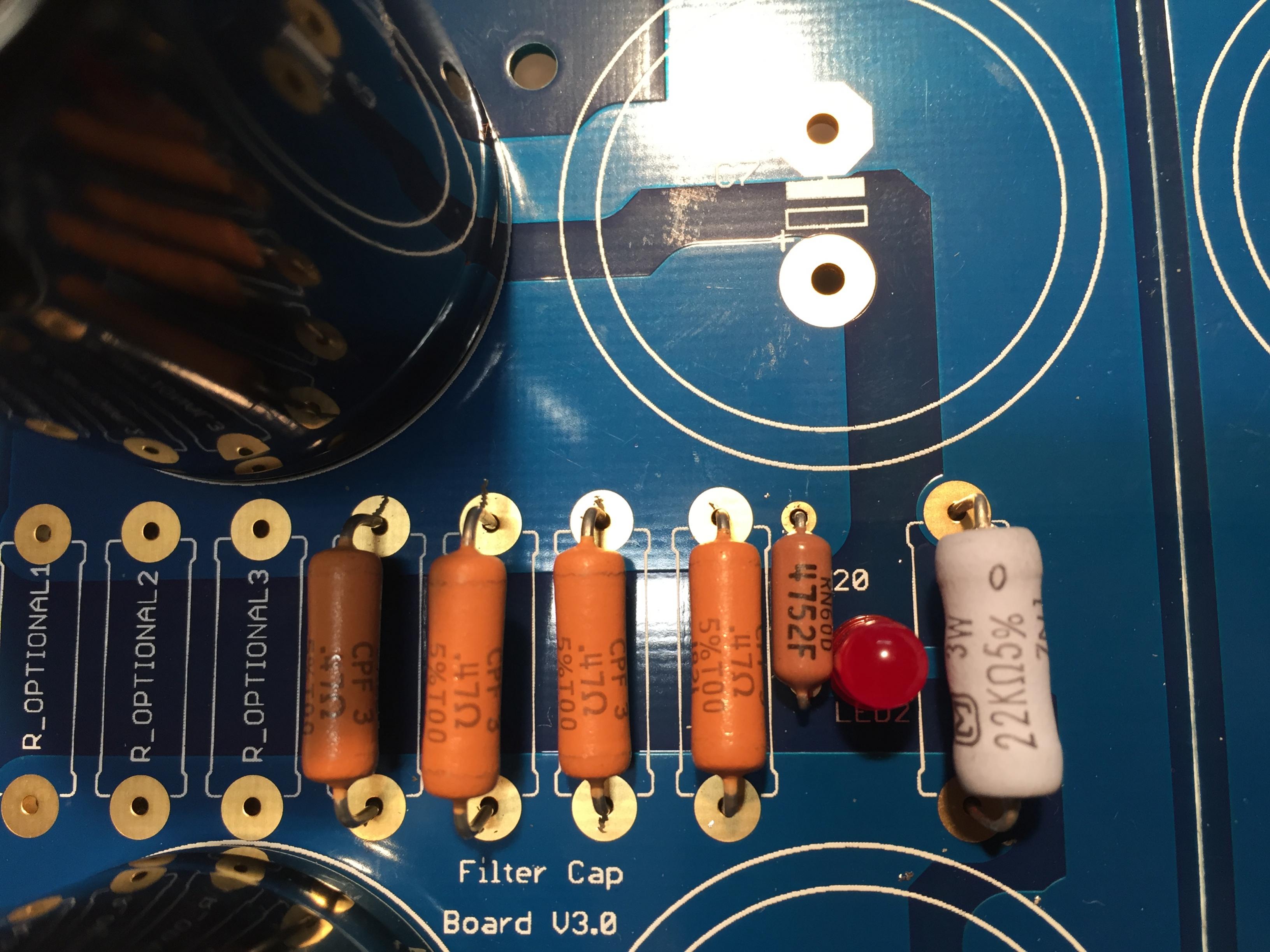

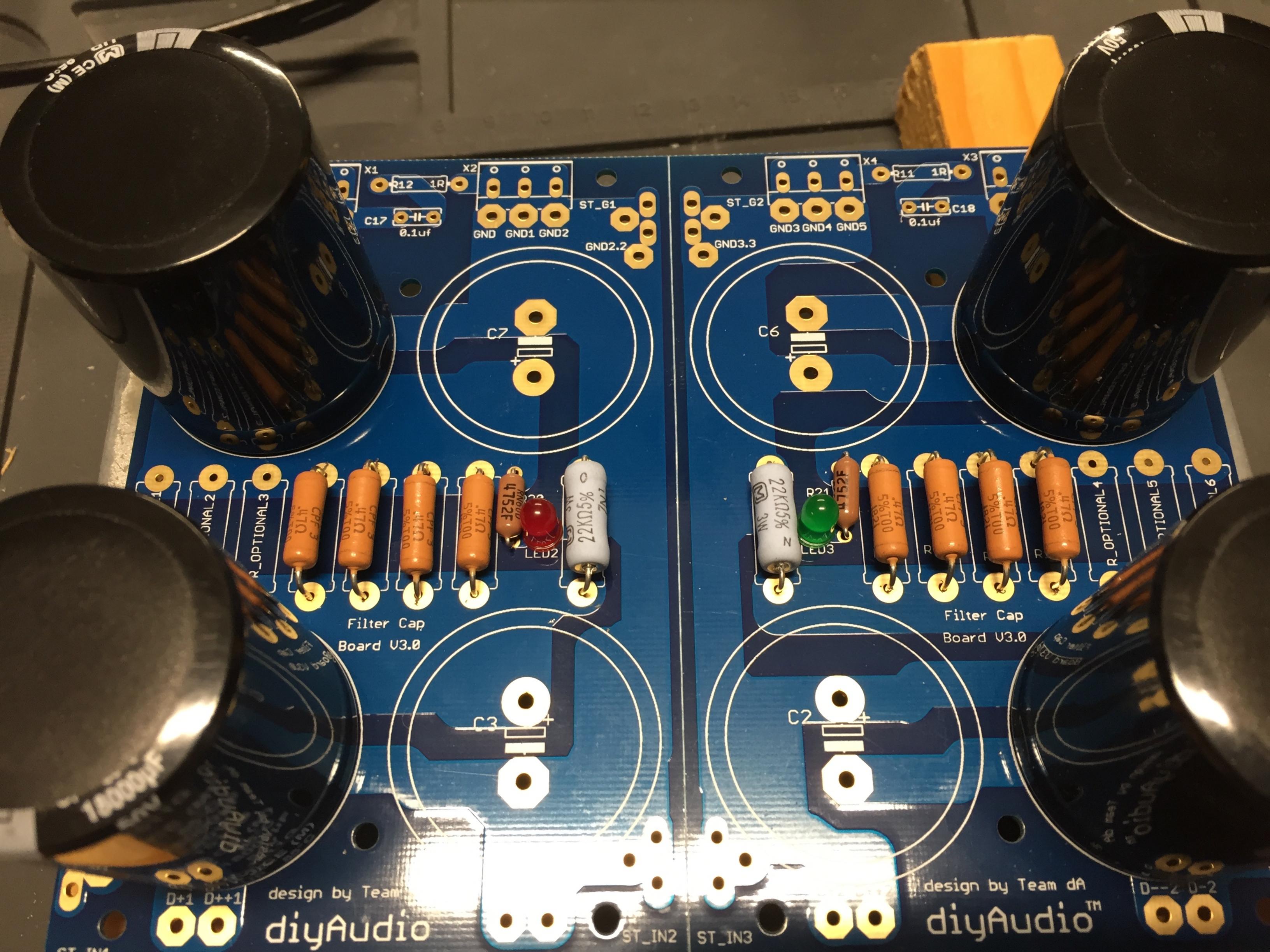

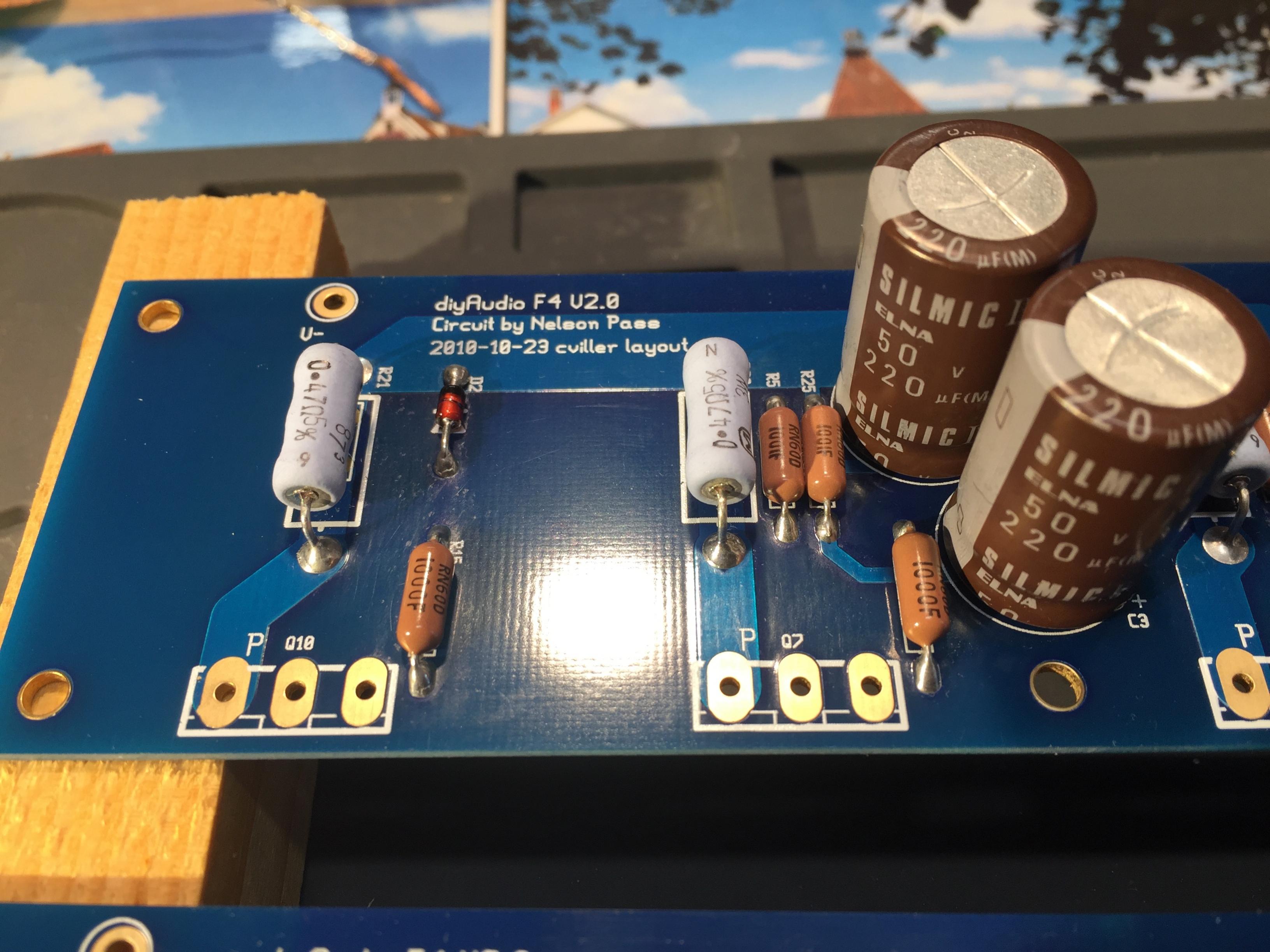

I have also done an unsoldered power supply board and have a few questions.
1) R1 to R8 are all 0.47 ohms 3W 5% but not the big blue ones, are they different in some way?
2)R20 , R21 I can't seem to find a value for these resistors, RN 60 4752f is one of the things leftover (so I put them in for the photo) but I also have some 1K ohms 1/4 w 1% leftover as well, Is either one of these OK or should I order something else.
3) R9, R10 bleeder resistor I think is OK but will simply drain a little slower?
4)My LEDs are positioned cathode - towards the middle, which has a continuation to the ground so fairly sure that is OK.
5) Lastly, my large caps are 18000uf 50V which aren't the same as in the build guide so just wanted to check that as well?

Assuming you're using this schematics: https://cdn.shopify.com/s/files/1/1006/5046/files/P-PSU-1V30-schematic.pdf
1) Those Vishay resistors are fine.
2) Your 4752 resistor is 47.5K. Assuming your rail voltage ~25V and LED drop around 3 volts, you get about 0.5mA through the LED. Might be enough to turn on LED.
If you find it dim, decrease the resistor value. 1k may be too bright.
3) 22K for bleeder will drain quite slowly but otherwise ok.
4) On the + rail, the LED cathode goes to ground, while on the - rail, the LED
anode goes to ground. You can see that in the schematics.
5) Caps are fine.

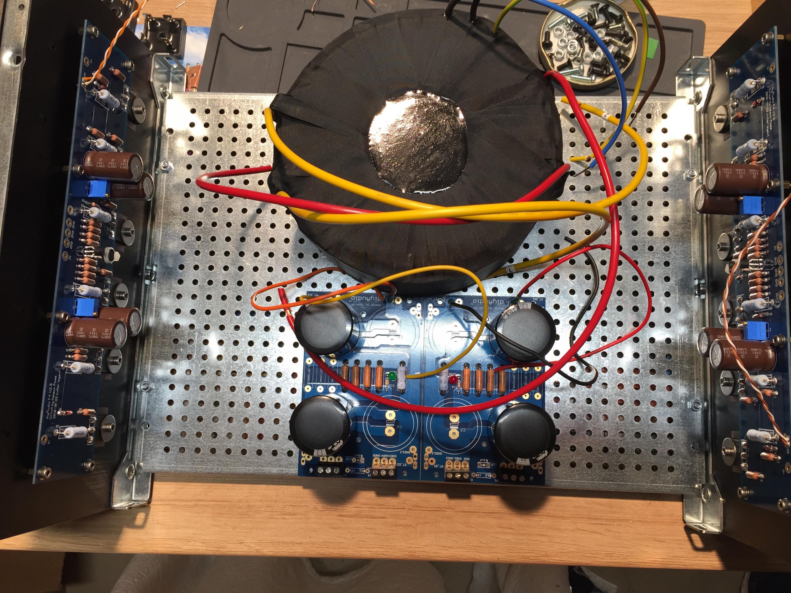

My transformer is quite large which is causing some space issues, is it OK to split the power supply board down the middle. There seem to be no connections in the traces on the boards and I think I would just need to take a wire across on order to connect the two GND.
