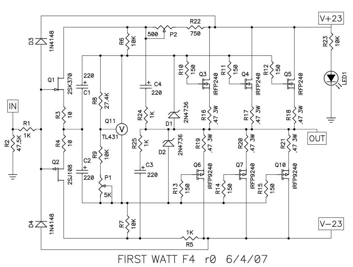

Can you check if the voltage to the mosfet gates os moving as P1 changes?
You can just measure say with one probe at the end where R8 meets the gate resistors R10/R11/R12 and the other probe at where P1 meets R13/R14/R15? Does this
voltage change when you adjust P1?
What resistor value are you using for R8?

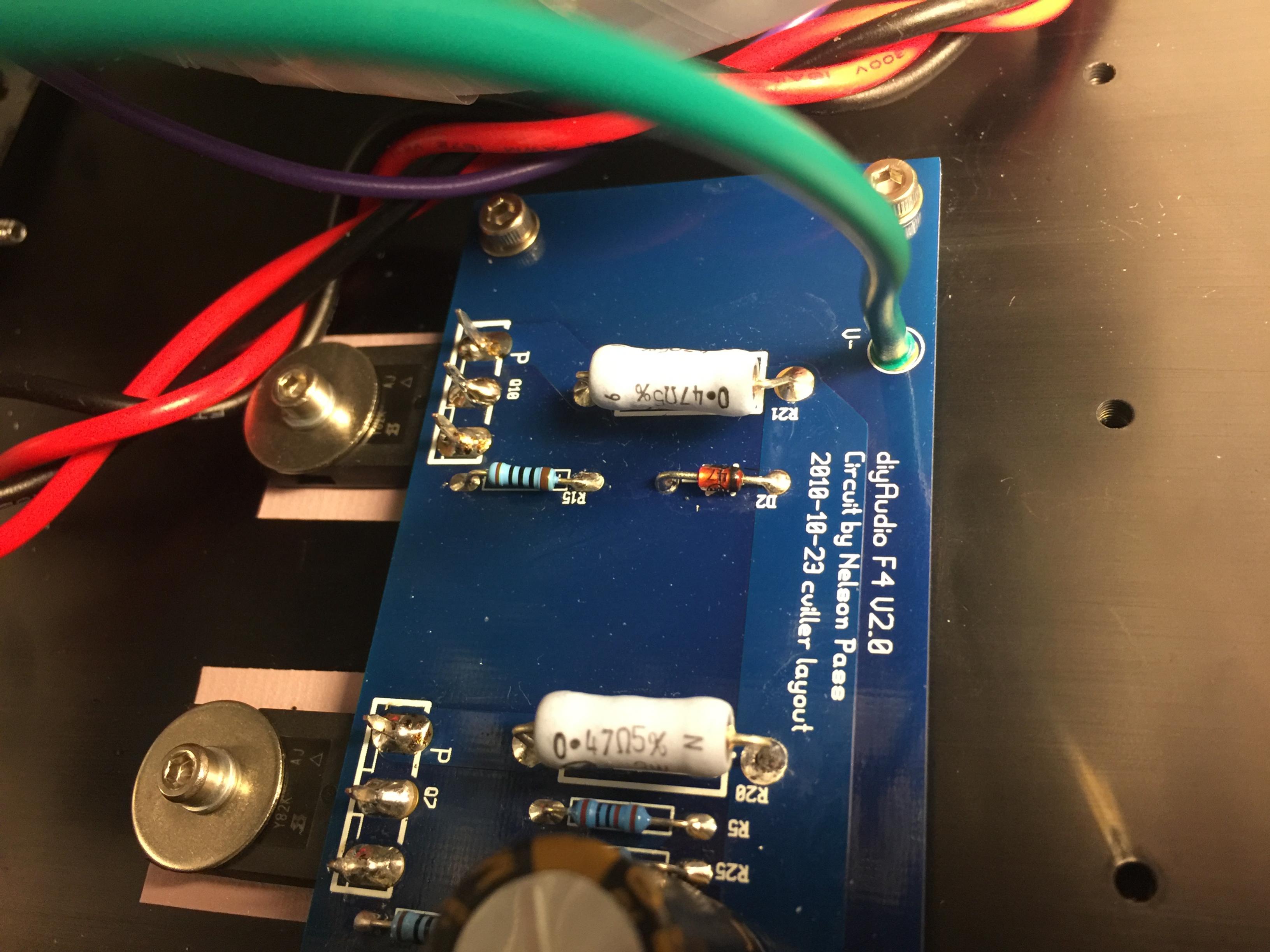

I put a picture below indicating where I measured just to be sure I didn't biff it. 😉 I had to look at the schematic and try to follow the trace, so as is the norm with me, I don't want to waste anyone's time if I did not measure at the correct points. The "Top" of R13, R14, R15 meets R1. I measured at the "Top" of R15 in the pic.
I did a continuity check between R8 and R9. The "bottom" of R8 was showing 0 ohm / continuity with the "top" of R9. So, the "Top" of R8 faces the gate resistors according to my overly simplistic look at things. I measured at the "Top" of R8 in the pic.
"Top" is away from the FETs.
R8 is 22.1k. If it matters, R9 is 10k.

Hi ZM -
I did not see your posts earlier. I got called away.
Below is the schematic. It is the one in post #1.
https://i198.photobucket.com/albums/aa276/aeroplane_album/P-F4-1V20-schematic_zps32c28b0a.jpg
Channel 1
Minimum - 3V12
Maximum - 4V01
Channel 2
Minimum - 1V36
Maximum - 1V36
Does not change. Note. Channel 2 is the same channel I measured in post #1485.
As always, with thanks for your help!

in both channels increase R8 from 22K1 to 27K ; 33K will do also , but , depending of mosfets , you could end with too high Iq in lowest setting ; though , I would use 33K pronto .......
in Mu channel ( undecided one ) replace TL431
report
be sure to start with maxed P1 ; check with ohmmeter , do not trust anyone with rotation directions
