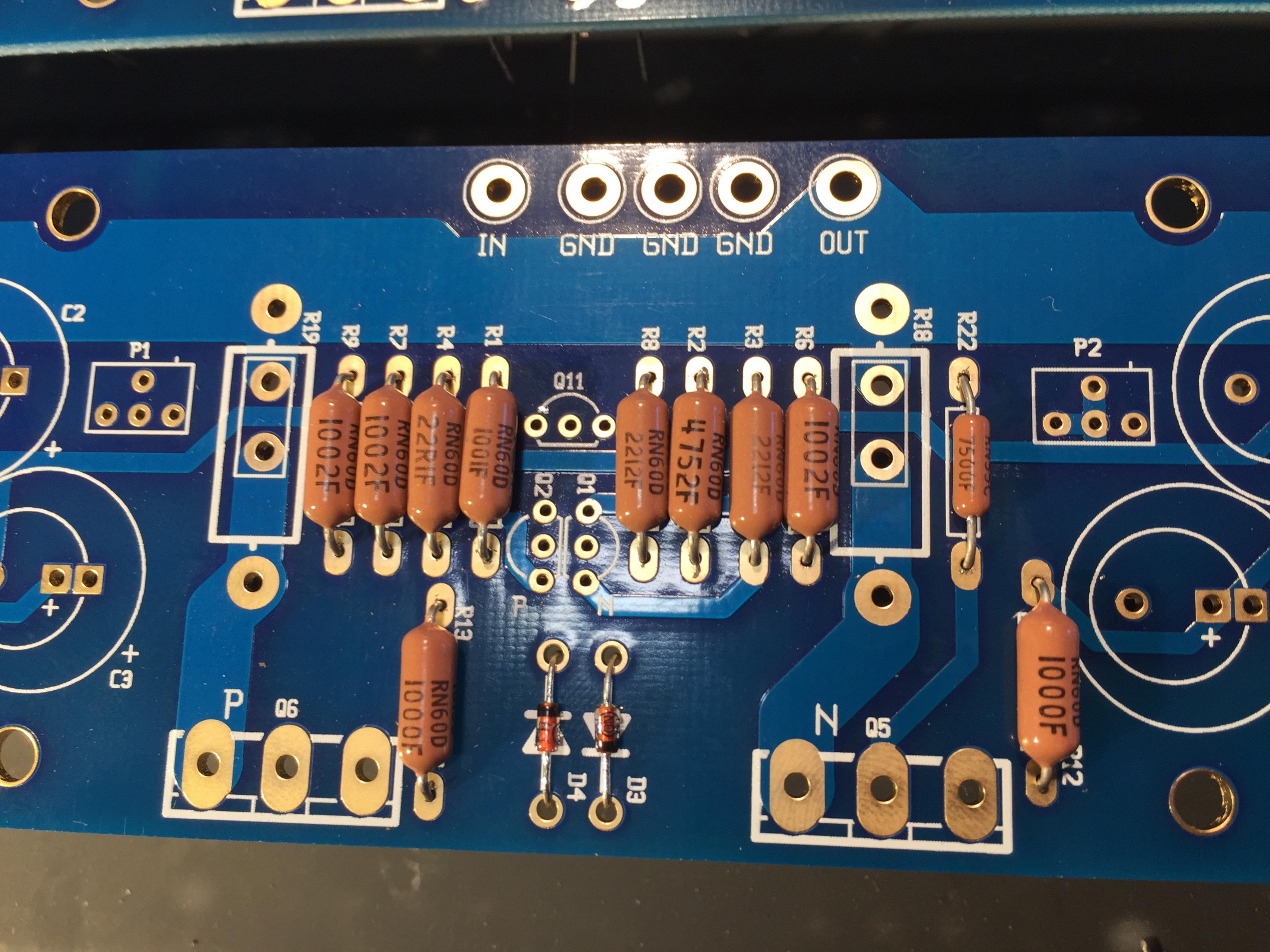

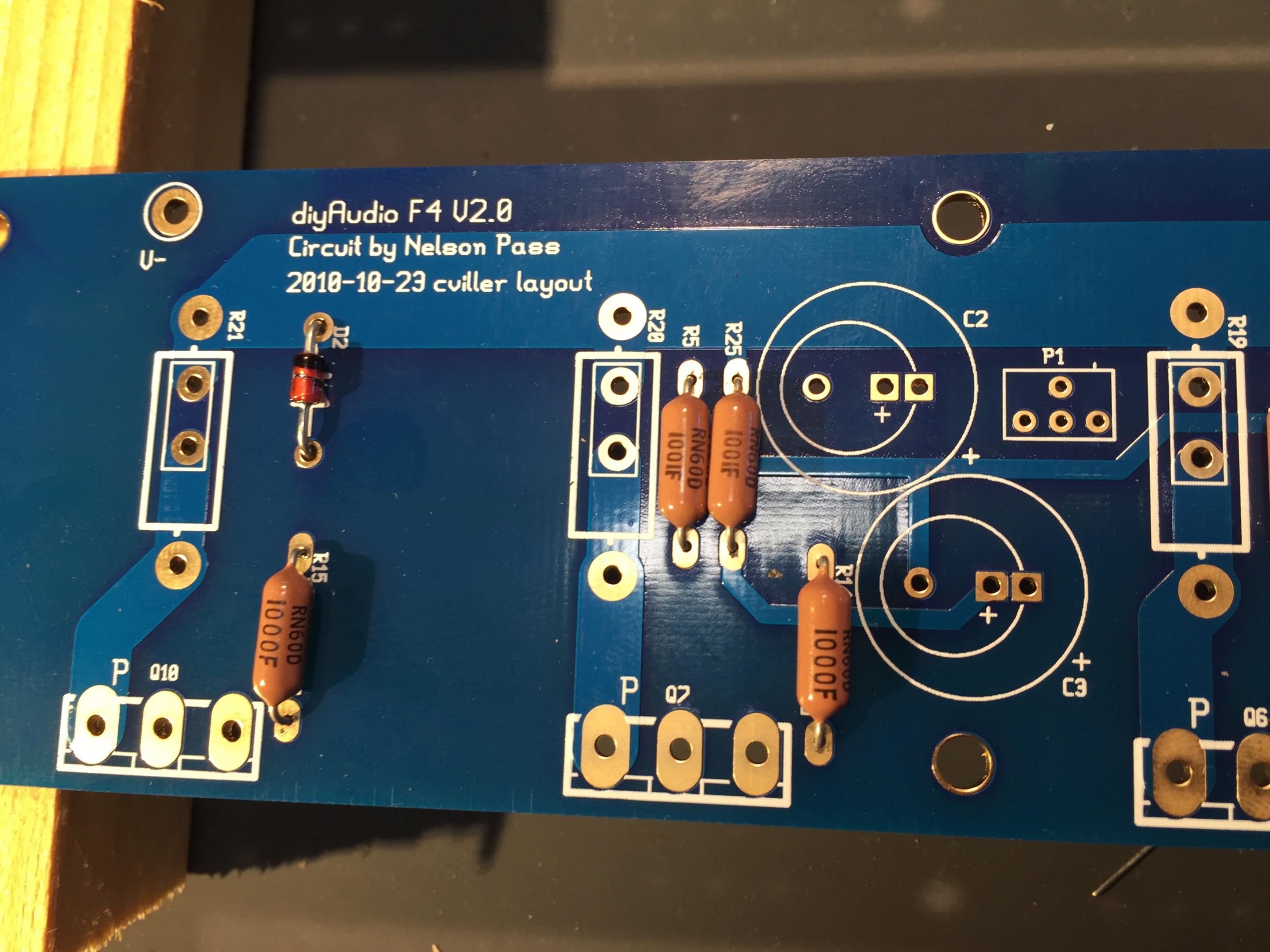

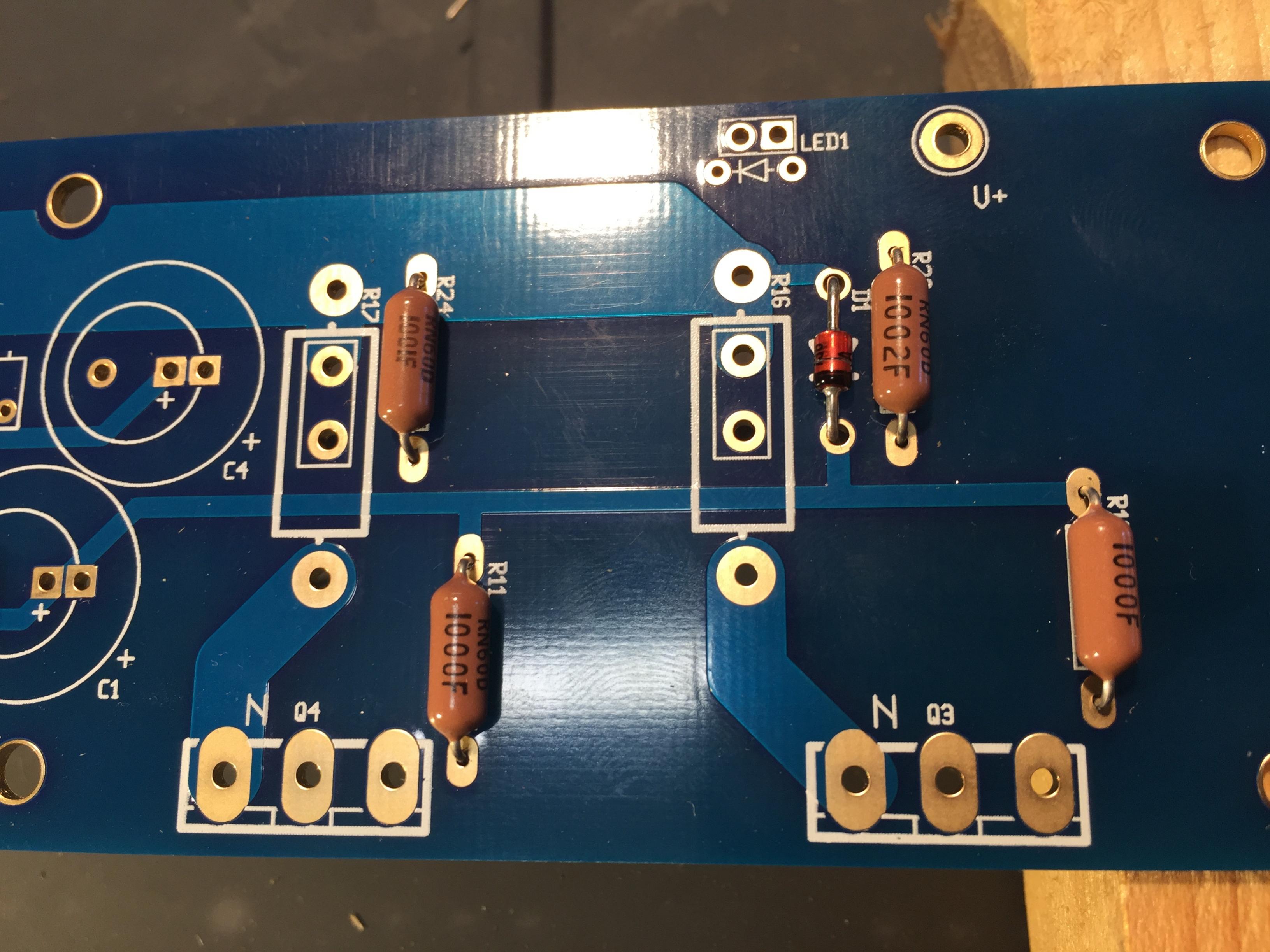

F4 boards.
I have just started stuffing the F4 boards and would like the more experienced builders to have a look for mistakes before soldering. Some of the resistors are very close together, even touching. Is this OK?
This is my first time uploading pictures, so fingers crossed ...
nothing wrong with resistors
if that will help for better sleep , put sheet of paper in between them , while soldering
