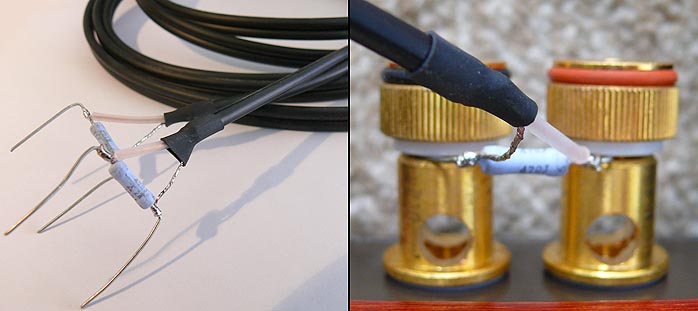

I am in the process of collecting parts for an F4 build and would like to ask a couple of questions. Before we get to them; my proposed setup will be, ARC Ref 3 pre amp - F4 -speakers or ARC Ref 3 PREAMP - Flea watt amp (TU 8100 PCL86) combined with F4 - speakers.
In the second scenario with the flea watt amp I am not sure how they are conected together and I think the flea watt needs to see a load whereas in the first scenario it would just be connected as normal i.e RCA in, speaker binding posts out.
Could I ask how to go about the construction of a flea watt seeing a load
what parts would be required and secondly how it is connected.

That is only 6 mOhm, it is very low as such. You probably want something like 8 Ohm or maybe 16 Ohm, depending on what your flea watt amplifier would be happy to see as a load.
Just to give you an idea what this serves for F4 has an input impedance of 47 kOhm which much higher than any typical speaker load that flea watt amplifier is designed for, so you want to put a resistor in parallel to F4 input so that your tube amp thinks it sees a proper load similar to a speaker.
On the speaker binding posts... you can read a bit more about it at the 6moons review of the F4 (6moons audio reviews: FirstWatt F4). From the 6moons article, here's an image of one cableing solution:

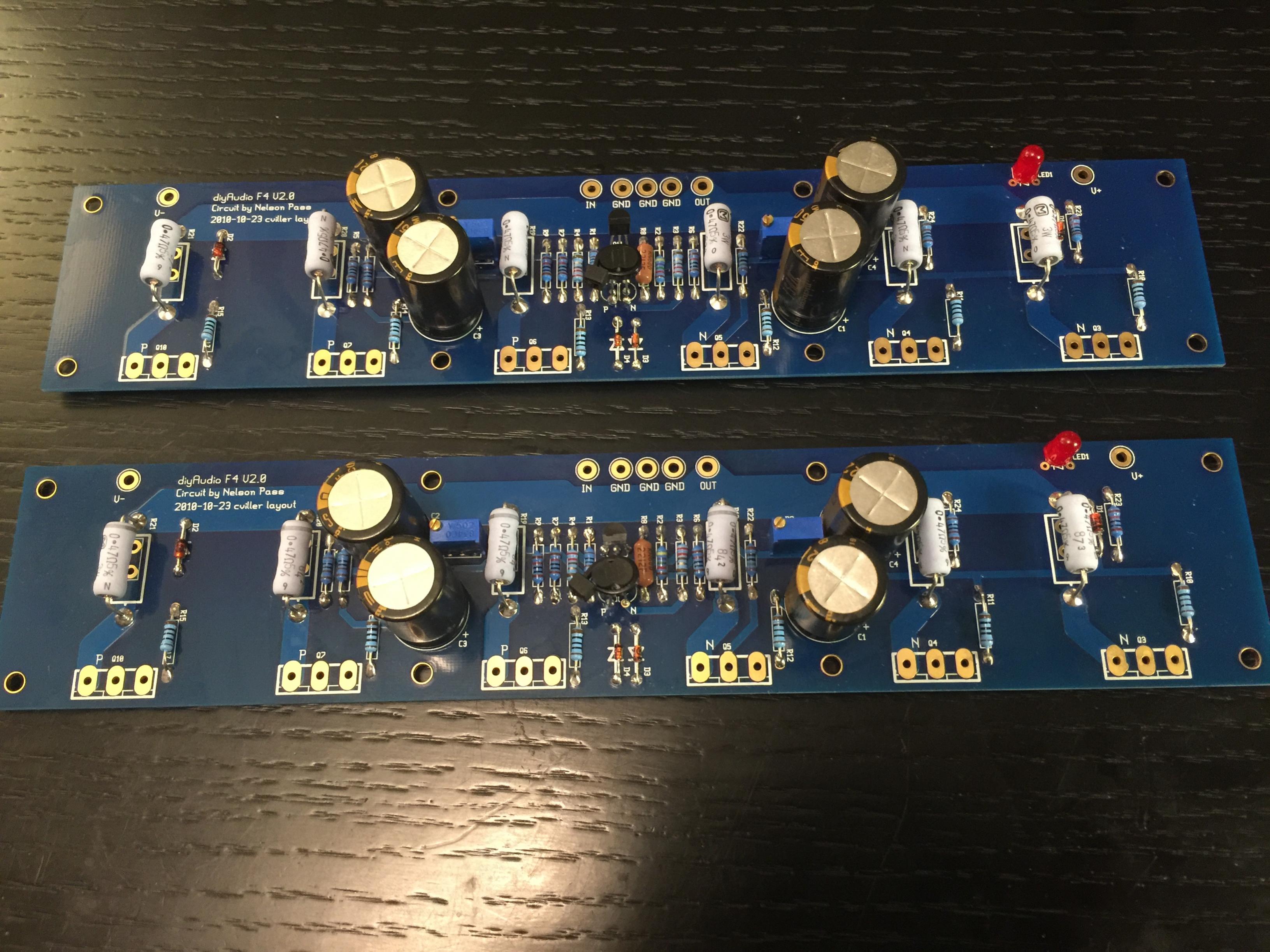

Jim, thank you once again for a fantastic build guide! It'll likely be a week or two before I get it in a chassis and give it a listen, but I had some time this morning to stuff the boards.
