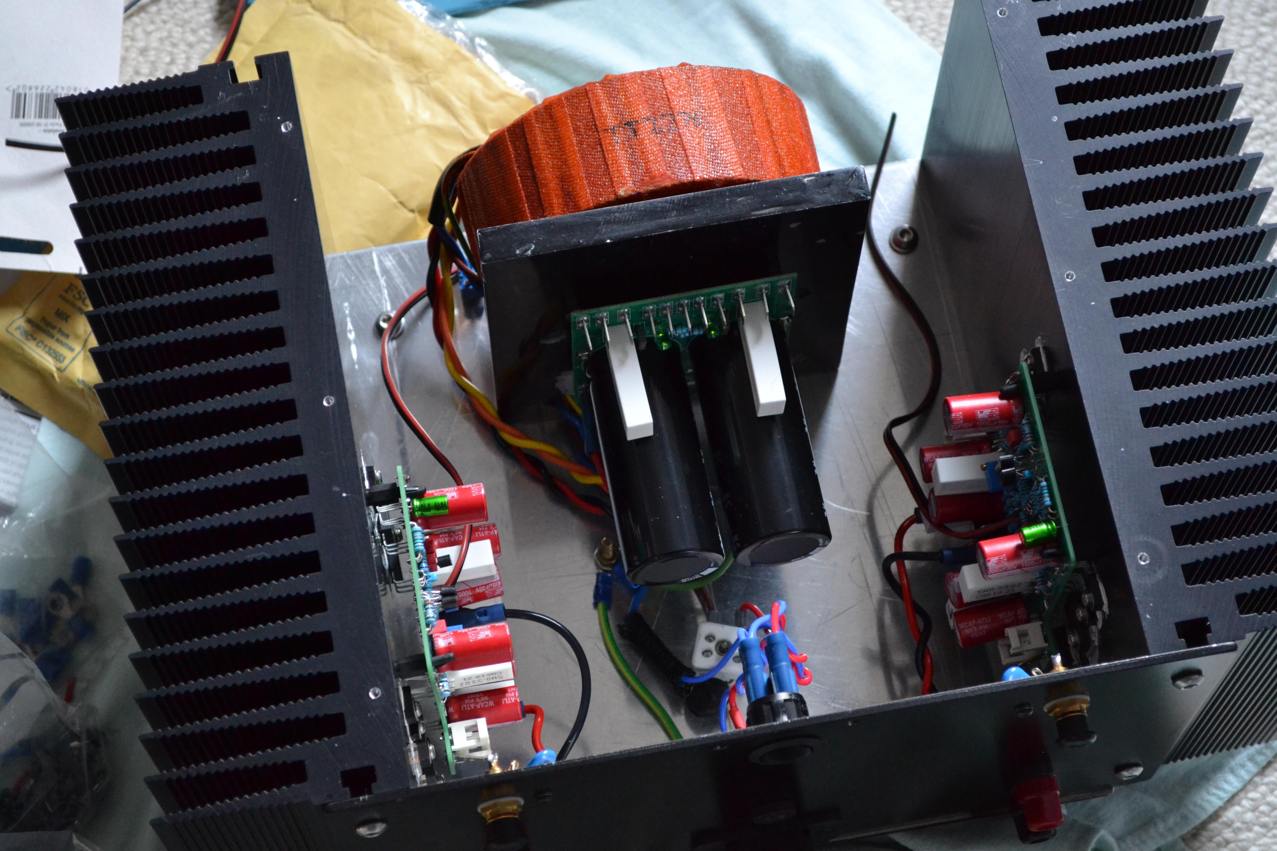

My transformer is quite large which is causing some space issues, is it OK to split the power supply board down the middle. There seem to be no connections in the traces on the boards and I think I would just need to take a wire across on order to connect the two GND.
I would also consider riser panels from the diyaudio store to bring the power supply board on top of the transformer
Riser Panels – diyAudio Store
See examples over there
Splitting the board is an option, however it will probably increase the impedance: ideally you dobt break the board.
See 6l6’s build guides for more details
Does that large transformer happen to have two sets of secondary windings? If so then it could be used in a quasi dual-mono configuration, with a separate PSU board for each channel, each fed from an independent pair of rectifiers.My transformer is quite large which is causing some space issues, is it OK to split the power supply board down the middle. There seem to be no connections in the traces on the boards and I think I would just need to take a wire across on order to connect the two GND.
@ syracuze, I have checked the height and yes a riser board will fit.
@ Tungsten, I,m afraid you've lost me a bit there, below are the specs from Canterbury Windings (if that helps).
The universal power supply board has one of those break lines down the middle it is different from the board used by 6L6 on page one of this thread. The black wire in the 6L6 image goes to the chassis ground bolt and I think that even without splitting my board I would need 2 wires going to chassis ground one from each side .......I think!

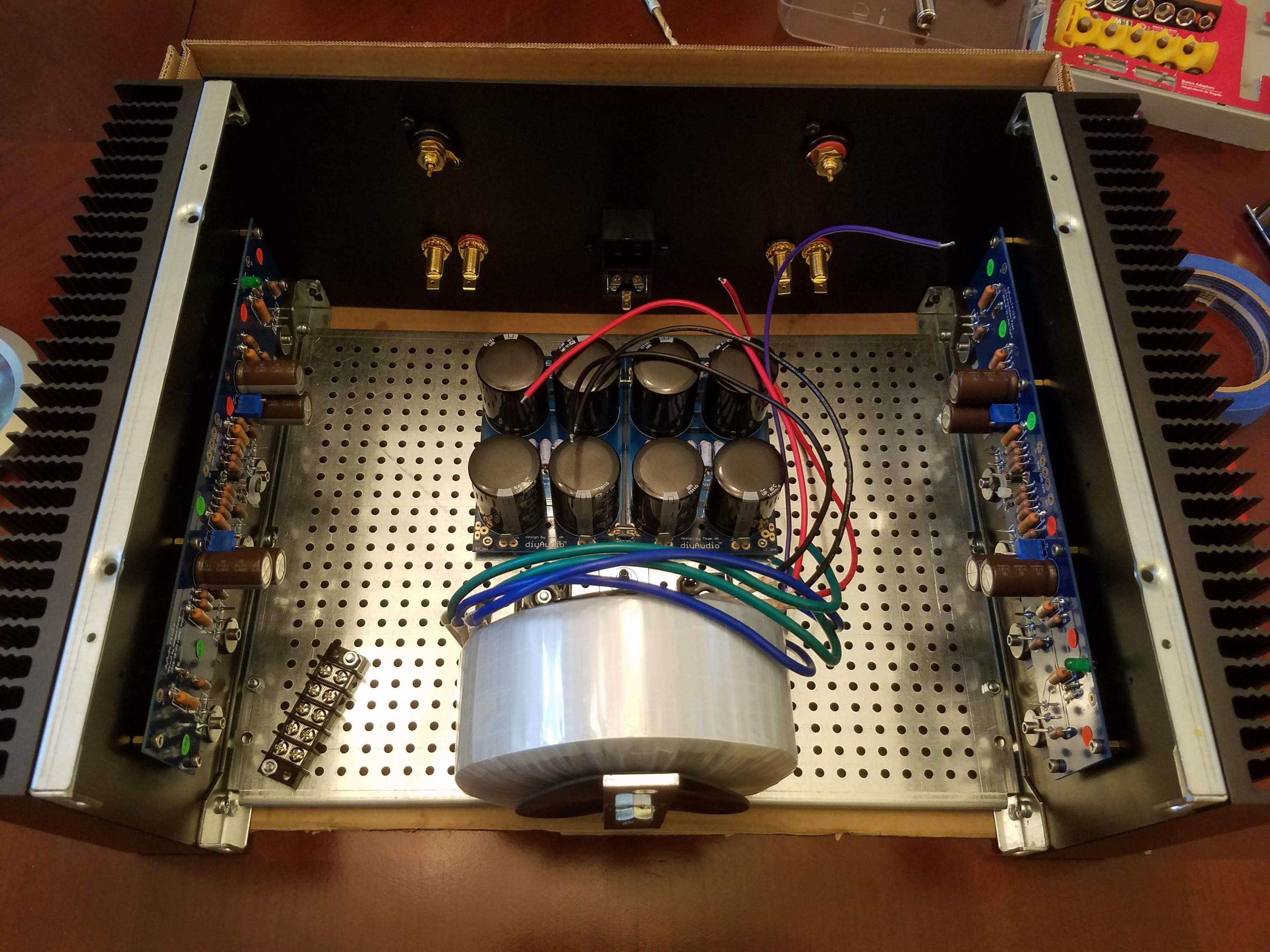

It turned out that vertical would not fit either so I bought a riser board from HiFi 2000 and will fly it over the top of the transformer.

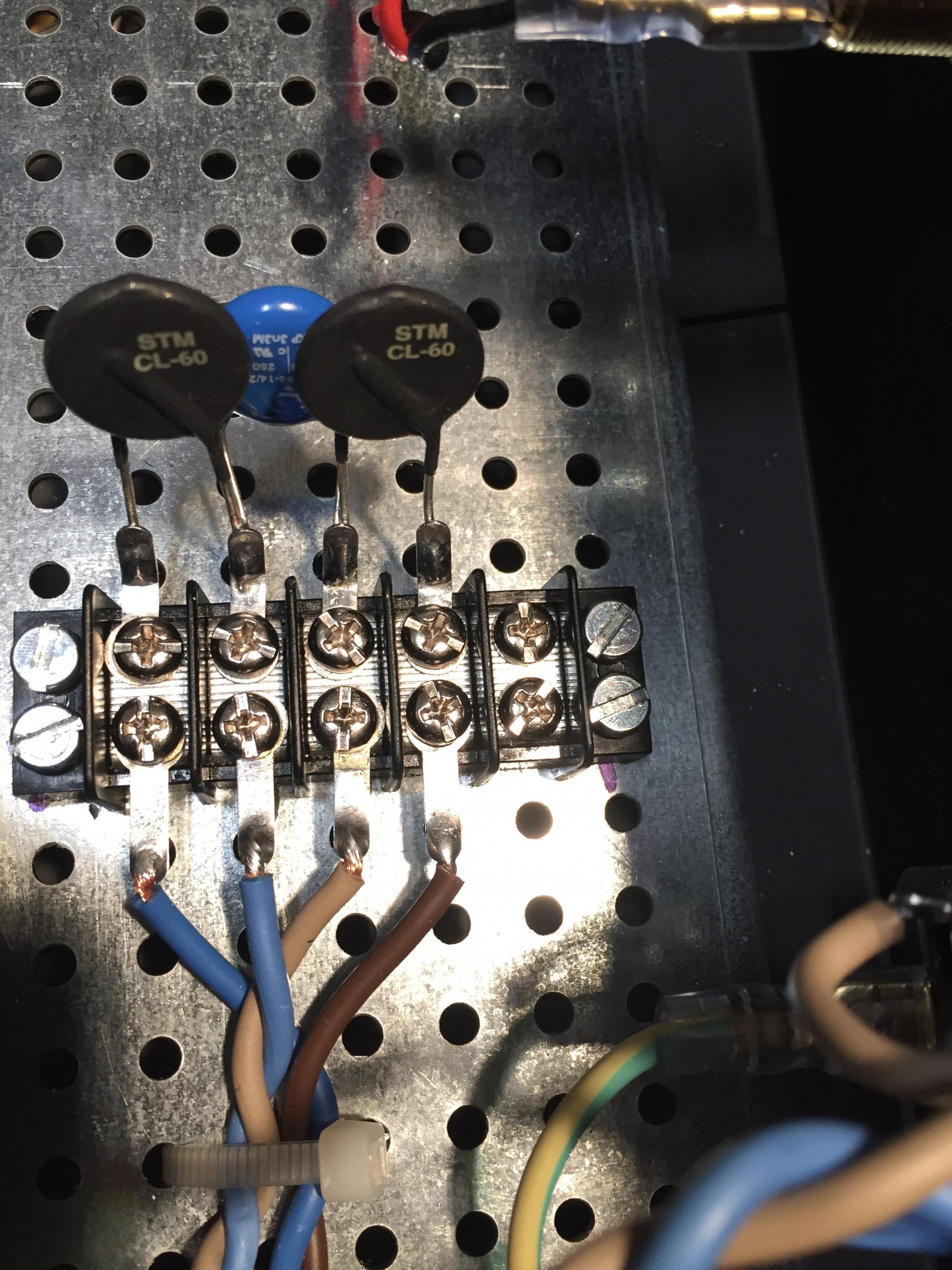

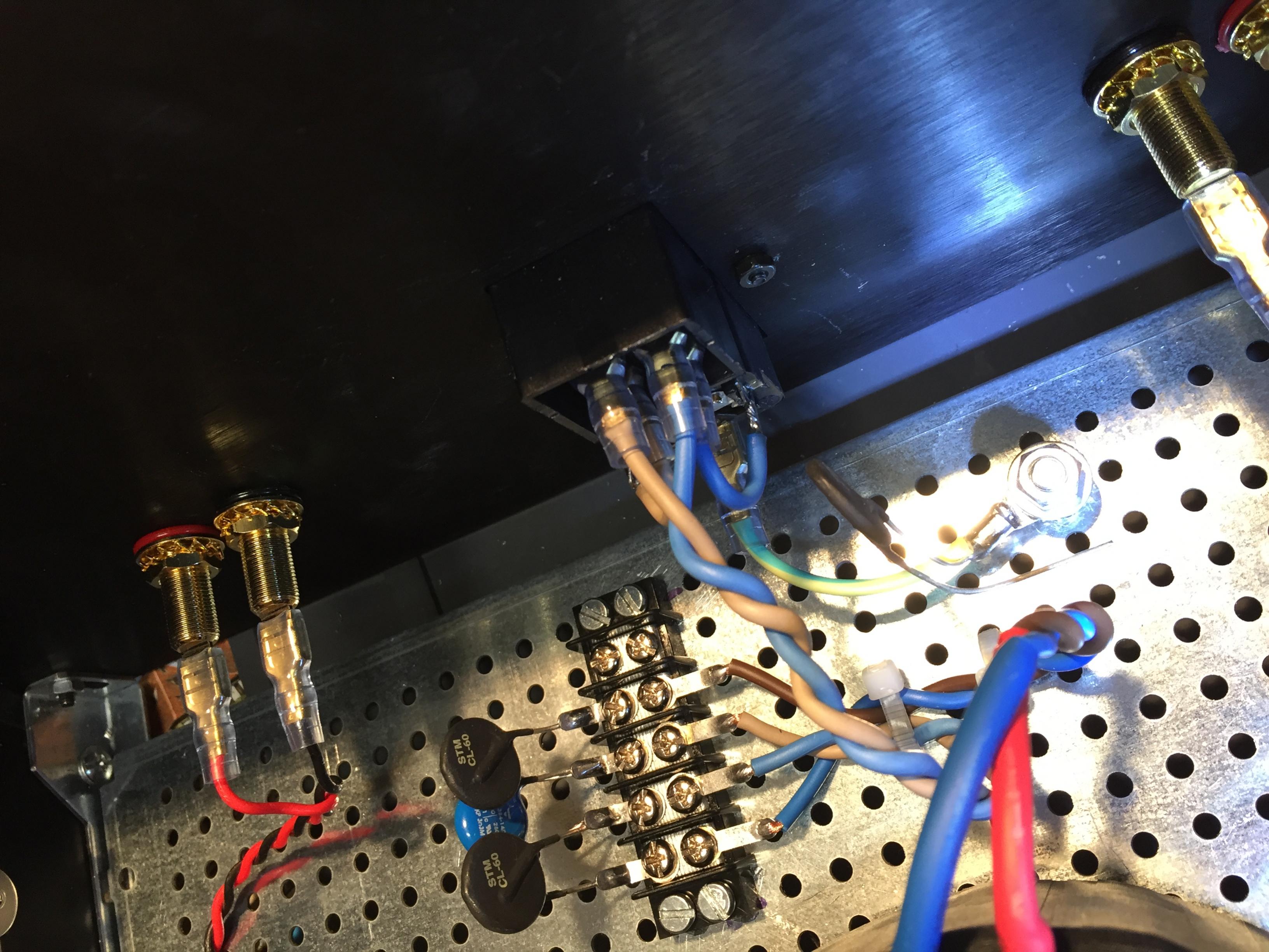

Here are some pics of my 230V primary wiring, from left to right ( in the first image) it goes,
1) Transformer neutral.
2) IEC Neutral.
3) IEC Live.
4) Transformer Live.
2) IEC Neutral.
3) IEC Live.

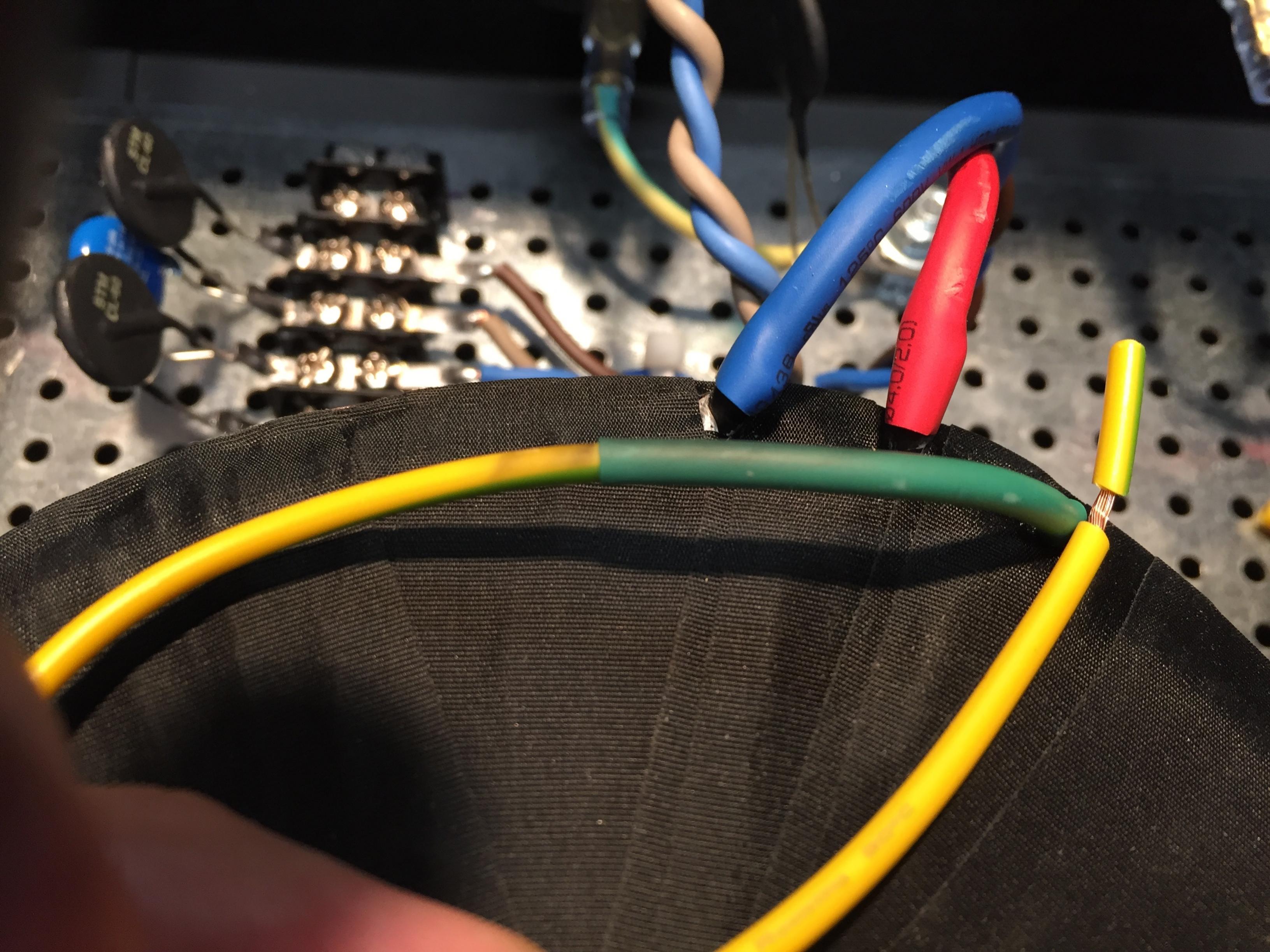

...I have an earth cable out of the transformer...
Connect it directly to the chassis earth point.
