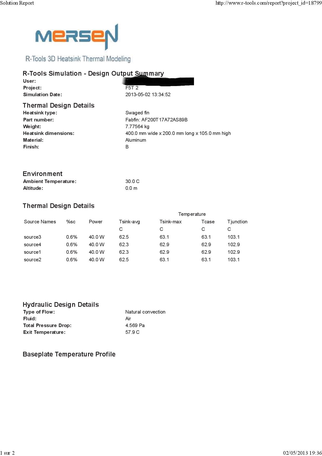

Heatsinkd (not again! 😛 )
Sorry, again about the heatsinks, and good morning to all anyway!

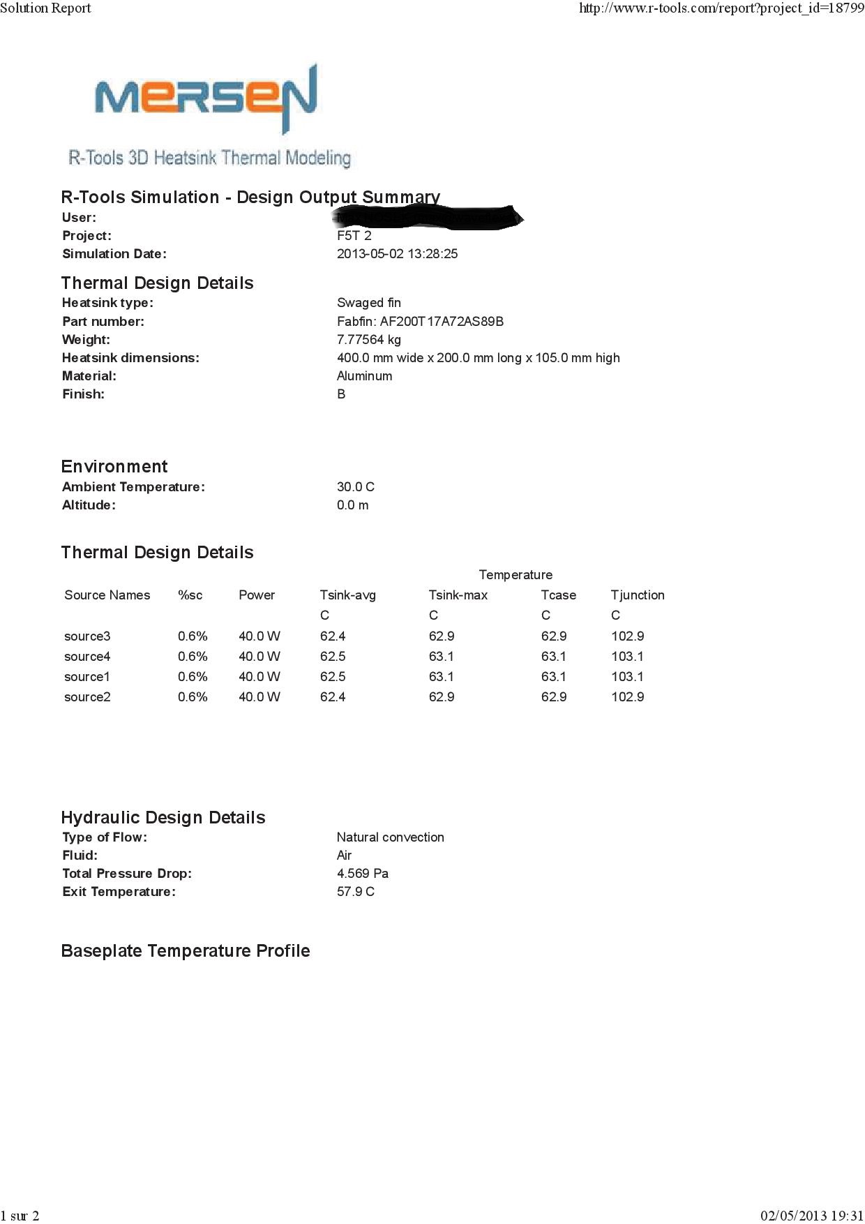

I'm studying 6L6's build guideover and over...
The transistors are mounted at around the lower quarter of the heatsink. Wouldn't it be much more effective if they'd be centered? (Isn't the upper 1/4 wasted?)

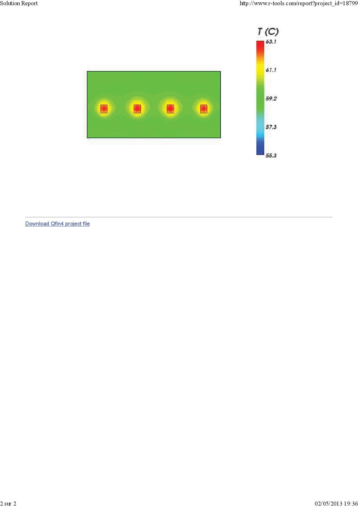

I virtually divide the heat in 3 equal parts horizontally and drill/tap the mounting holes for the transistors on the lower horizontal line.
Others may do it differently, remember heat goes up.....
EDIT: You can model your heatsink and play around with placement of the outputs on that said heatsink and see if you like the results. As per the results hereunder you will see that I omitted some important values, my goal at that time was uniform heat spread more than very excat temp. calc...
Temp Radia, ext de 35mm du bord_ bas du transistors a 75mm du fond(2)1.jpg181.8 KB · Views: 323
Temp Radia, ext de 35mm du bord_ bas du transistors a 75mm du fond(2)2.jpg59.6 KB · Views: 291
Temp Radia, ext. 40mm du bord_bas du transisotr a 75mm du fond1.jpg181.5 KB · Views: 297
Temp Radia, ext. 40mm du bord_bas du transisotr a 75mm du fond2.jpg59.9 KB · Views: 294

Probably because heat rises.
Sorry for getting nitpicky, but I understand it differently: Isn't it so that warm air (relative to the air around) is rises, not "heat"? The heat from the Mosfets is transferred into the heatsink, which it distributes (warms up). I imagine it more like a blotting paper, concentrically soaking up fluid ...
The air floating around the heat source takes up the energy and begins to rise due to the thermal expansion. (Thus, wouldn't it be that the upper region of the heatsink becomes a little less effective because the air already got warmer?)
but anyway: 😕 it's complicated.
david
That is a big heat transfer question but the difference is small. It could be easily measured if proper protocol is followed. I would theorize that between center and the bottom 1/4 of the smooth side of the heatsinks with the fins aligned vertically will result in the highest heat dissipation.
david
It is a very complicated dynamic: as the air goes up, the flow changes from laminar to turbulent based on Rayleigh’s number. The exact calculation requires solving partial differential equations, but best to rely on manufacturers empirical measurement data
Take it with a pinch of salt, just a rusty mechanical engineer is speaking 🙂
