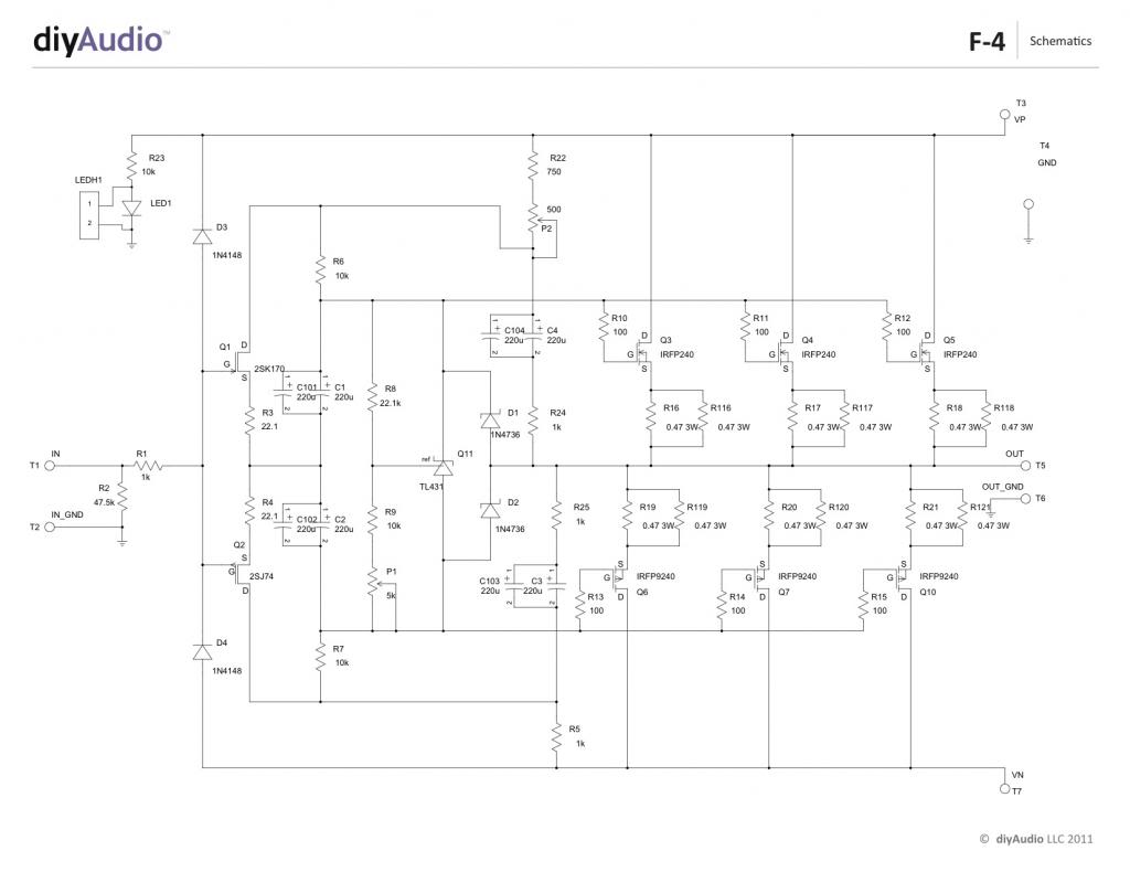

A few detail questions for the ones in the know:
1) What are R24/25 and C3/4/103/104 for?
2) Why are they not used in BA-3 complementary OS for example?
3) When using BA-3 FE can I loose R12/13 and C3 of BA-3 FE as well as R1/2, D3/4 and input jfets Q1/2 of F4?
Any insight is greatly appreciated ;-)

referring to this one , photobucketed in first post?
also , place link to ref. BA3 FE schematic

1. remember that F4 is made to be driven from something else , not sharing PSU rails ......so - let's say that I'm idiot user , connecting Good Ole :Pumpkin: , set to max gain ad fed from +/-36V rails ....... having two shots too much , Volume Pot is my relief and - voila ! - poor input JFet buffer is banged way above and below own PSU rails
so to connect that seesaw in manner not so dangerous for input buffer , Papa did what he did
think what's happening when input is driven with enormous swing
2. intended to be driven with more brain , but also from stage sharing same rails , so not being able to overshoot them (by much)
3. from pdf you linked - R13 is necessary - doing I/V conversion of BA3 FE output stage action , so it must stay ; more ohms - more swing...... so , R12 and C3 can go with the wind from BA3 FE ,and connect output node ( mosfet drains) ditto to common point of C1 and C2 in F4
remove input JFets , everything else can stay without any harm
