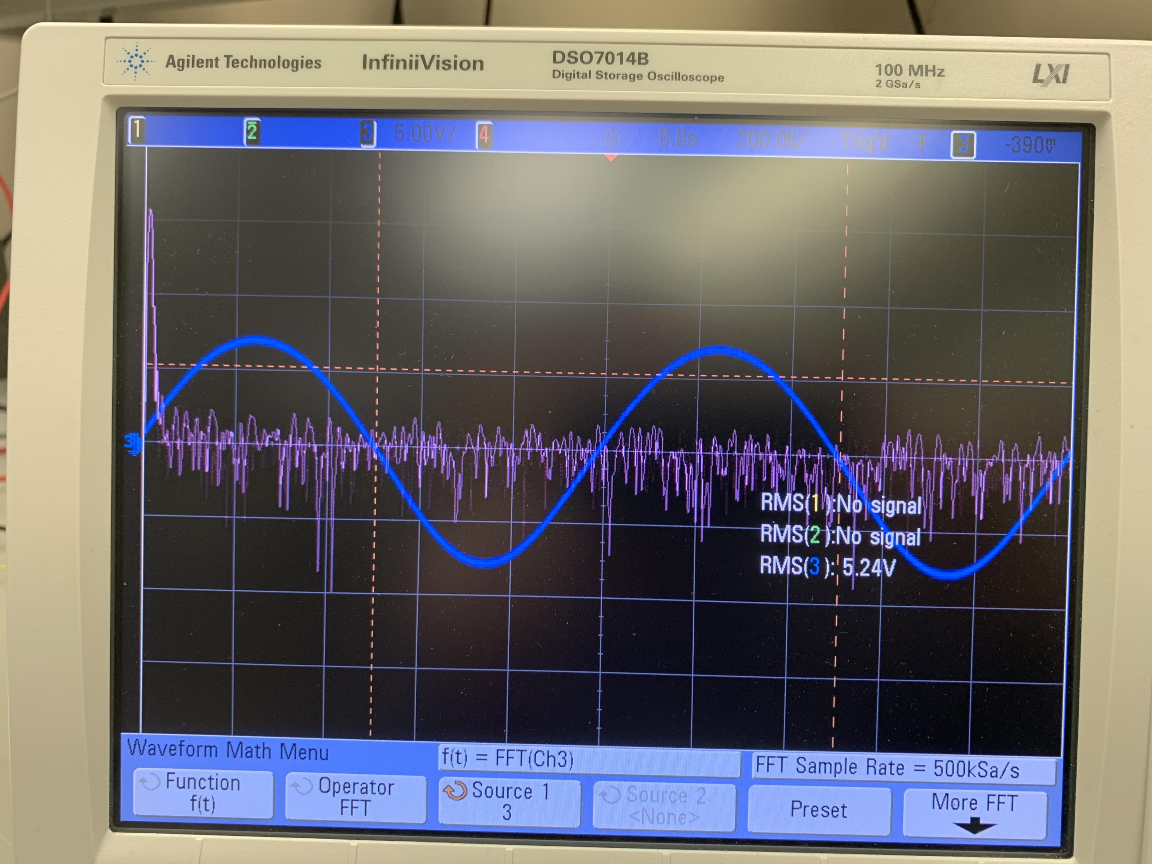

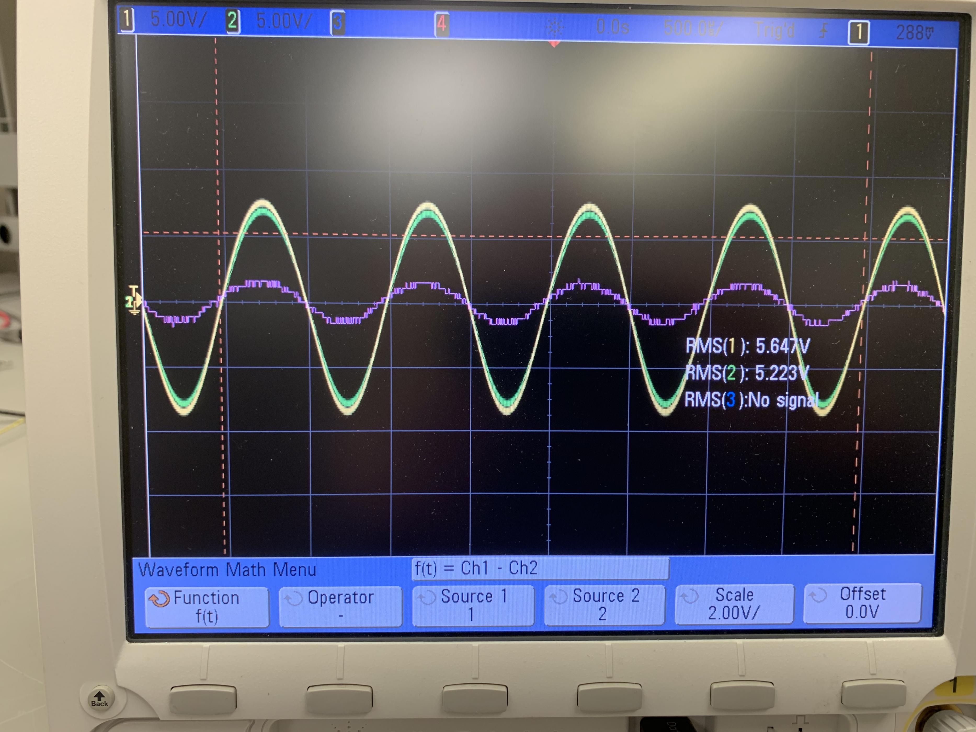

Hello everyone. I have built the F4 amp in the DIY deluxe chassis from the disystore. The amp sounds great to me but I would like to take some measurements. I have read that one can subtract the incoming waveform from the output to see the distortion left behind. That image is attached, but I have no reference of what is consider good or bad. The other attached image is a FFT of the output waveform. Both input signals are a 1K Hz sinewave. In my lab there is a power analyzer, which I could hook up to the amp on a Friday, if anyone thinks that would be helpful.
I had a few hiccups during the build, but overall things went smoothly. For example I used non-matched JFETs on the input buffer and the amp sounded like electronic garbage. The matched pair of Toshiba JFETs from punkydawgs saved the amp! The power MOSFET were not matched and due to this, I believe, the voltage drop across the 0.47 Ohm power resistors are not the same. Does the voltage differences effect the quality of the sound and can it be fixed by change the resistors?
...with a distortion analyzer. It has a very steep and deep notch filter at the fundamental frequency, subtracts that, and what you get left over is the wave without the big signal; the "distortion residual."
You can run an FFT on the amp's output signal like you are trying, but it's very rare for anything other than a megabuck scope to have the vertical resolution to see that deep. Almost all digital scopes have 8-bit vertical resolution, that's not even remotely enough to see something that's 80db or more down from the signal, because 8-bit can't see anything more than 48db.

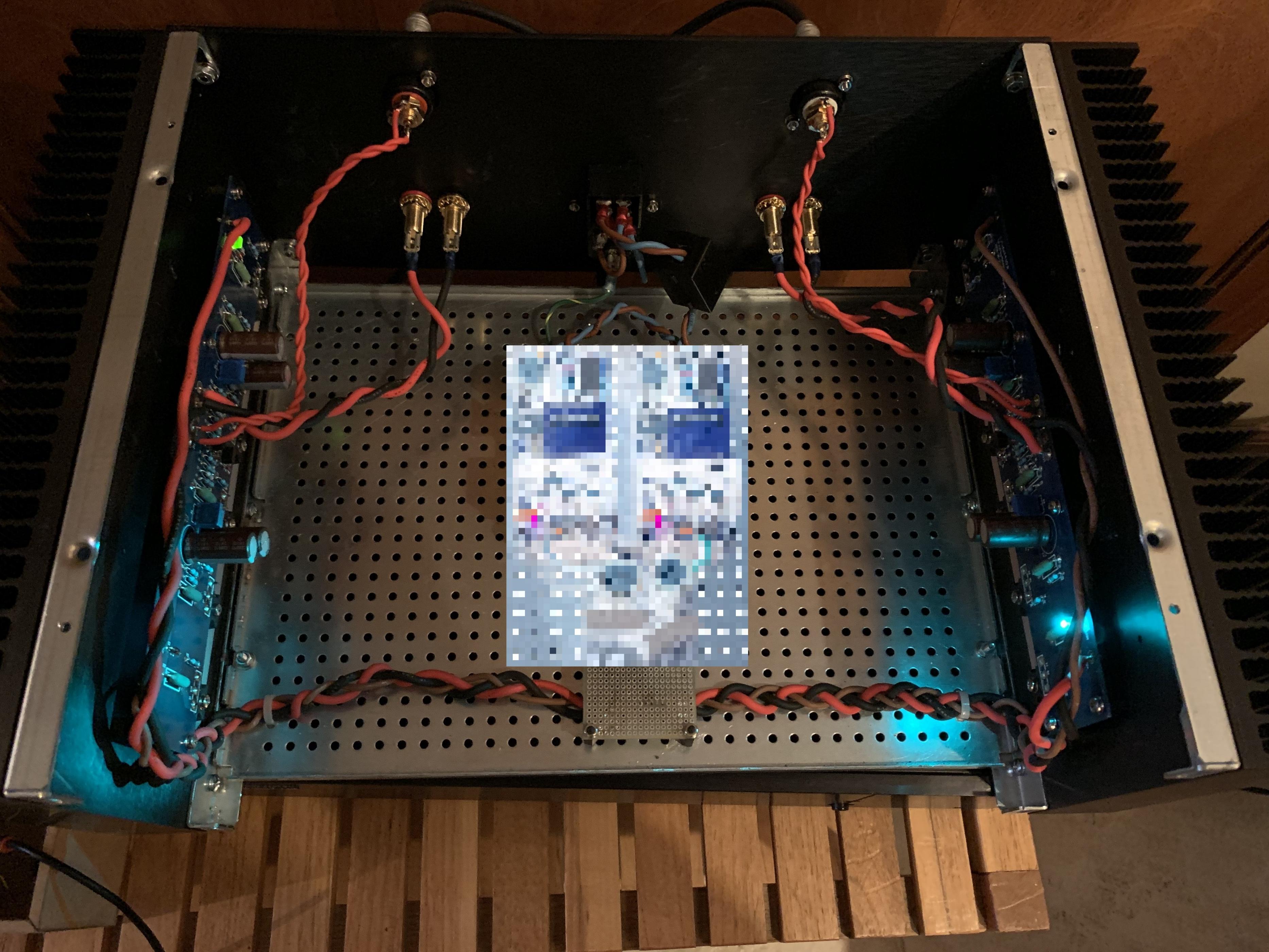

I just watched 6L6's YouTube video from Burning Amp 2018 and it has inspired me to post a picture of my ongoing F4 build. Coincidentally, the release of the Amp Camp Amp is what lead me to build the F4, despite not having built the ACA! The F4 is my first solid state amp I build from components and it has been a great learning experience (& one that is no where complete). I was a little nervous about posting a picture of my project because I did not exactly follow the build guide and didn't want to upset any of the audiophiles here (the pic has been censored just in case).
Currently I am using the DIY ECC802S (12AU7 / ECC82) Vacuum Tube SRPP Preamplifier to provide the voltage gain for the F4. I had made the 4S Universal Preamplifier for 12A*7 Tubes prior to building the F4 and it did a decent job driving the F4 however the ECC802S SRPP has way less distortion.
“Not following the build guide...?” Who cares! You built your amp, it works, everybody want to see what you did and how you did it!
Looks like you used switchers for power, LOTS of people are interested in that, please tell us all about it! 🙂 🙂 🙂
My entire point about the photos is to show all the wonderful ways these can be built, and that threads with lots of photos get more engagement.
As for upsetting the Audiophiles... um, this is DIY, we’re the happiest guys in all of audio. The audiophiles are already upset because they believe in voodoo, whereas we take control, educate ourselves and actually understand what actually makes a difference 😀 😀 😀
