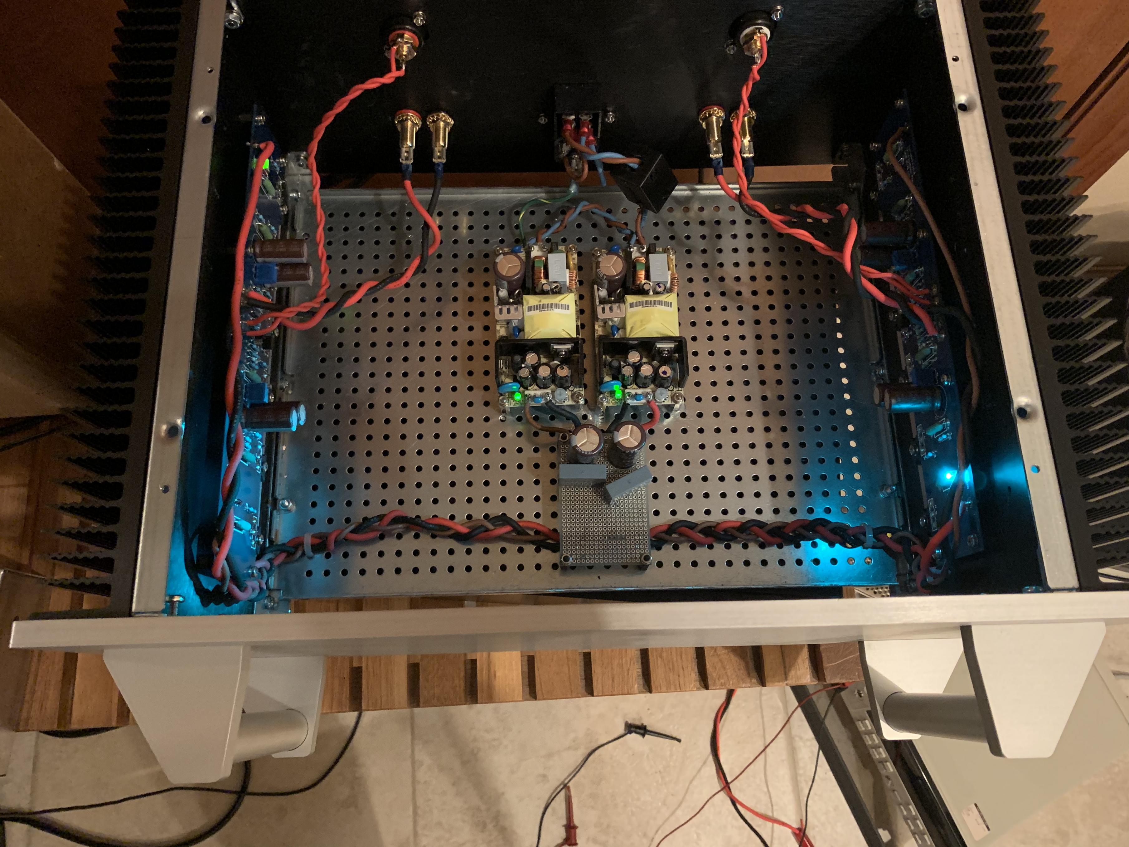

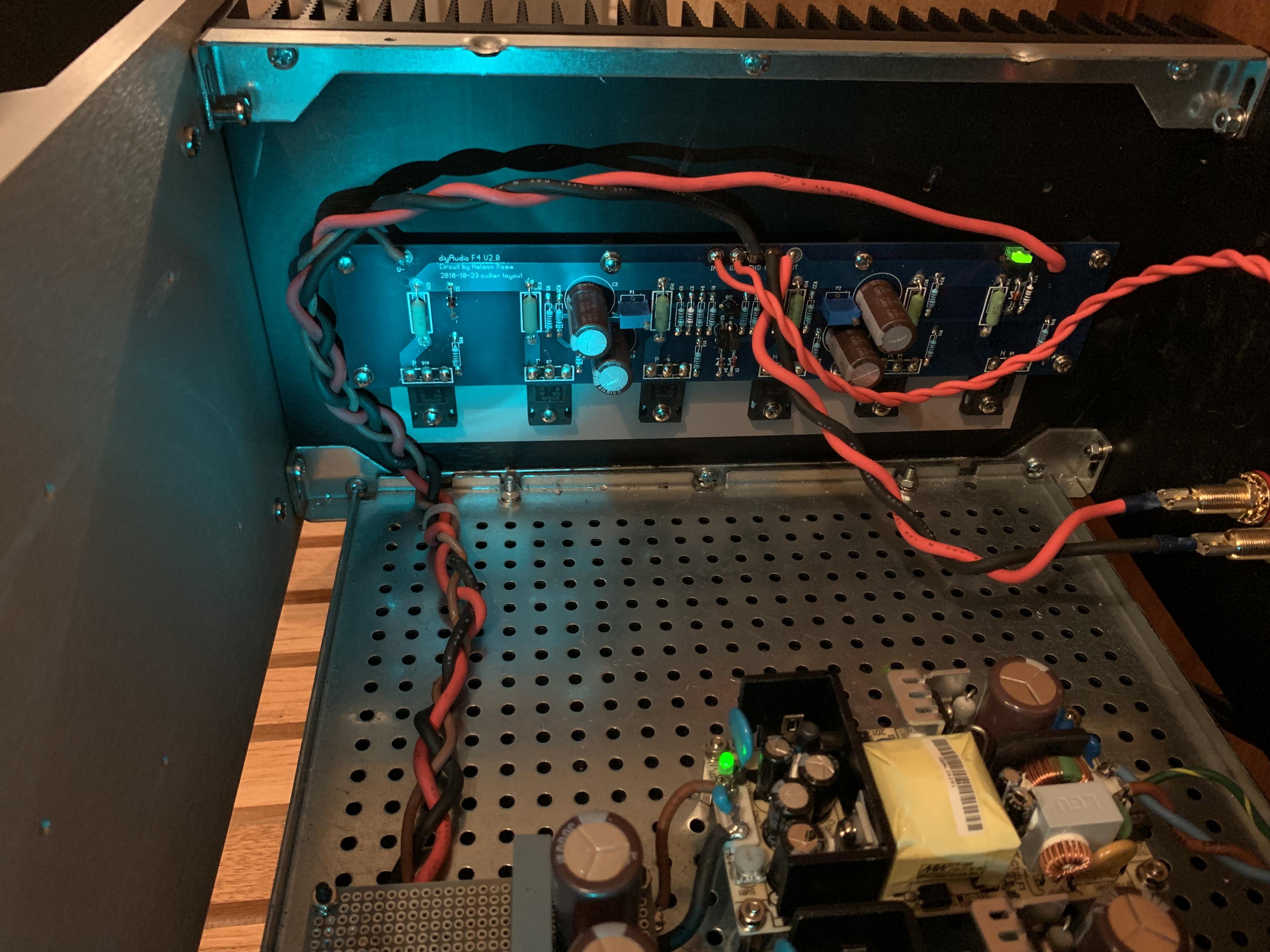

My first choice was to use two Mean Well LRS-100-24, however they were out of stock (at Mouser, where they are crazy cheap) and my patience got the best of me. I did purchase an Antek AS-4222 (400VA 22V) transformer to perform some comparisons in the future (or build another amp!). The SMPS I used for my build are two (one for each rail) Mean Well EPS-65-24, which are rated for 65.04W 24V 2.71A each. I believe this is the bare minimum power needed, if not underrated for the F4. I have yet to drive my amp to it's full capabilities at this time to see if there is an issue. Although, using this potentially underrated power supply allows for some forgiveness. For example if one makes a mistake when tinkering with the amp circuits or if your tube pre-amp gets turned on while the power amp is running, hiccup mode with auto recover to the rescue! I have yet to blow any input fuses, but I have toasted a couple of TL431 and a set of MOSFETs... 🙄
Even though the switching frequency of this power supply is above the audio band one still needs to add addition filtering. Filtering cost money, so most manufactures will use the bare min to pass federal standards. There are many ways to do this and I am looking to see what is the most effective for audio. In my build I am using a ferrite clamp on the AC input to the power supply (the clamp would have been more effective if I had used longer wires and looped it through the clamp, but I had already cut, crimped and solder everything together). I did a test to hear if there was any difference without it and the only time I heard noise was when I was physically touching the clamp to remove/attach it (my body acted like an antenna and induced audible noises). Just because one cannot hear the difference with and without doesn't mean it is not working, because the type of noise it's filtering out is above the audio range! There are three types of capacitors being used on the output of each module. A ceramic 22uF/50Vdc (RDEC71H226MWK1H03B) cap is soldered directly to the pins of the unit. Following that is a 5600uF/35Vdc electrolytic (EKYB350ELL562MMP1S) and a lower voltage film cap that I had left over from building passive crossovers (I don't remember the exact value or part number). Some SMPS manufacturers will list the max capacitance load their units can handle, but Mean Well did not so I am starting small. Once I can make some better performance measurements I will start adding more capacitors to see if there is any change.

Interesting topic - how best to use SMPS power supplies to provide +/- rail voltages. On one hand, one of the favorite amps of the community, the ACA, is powered by a simple but effective brick style SMPS. Since these units are fully enclosed and usually external to the rest of the amp, they tend not to cause audible interference from either mains or their internal switching frequency.

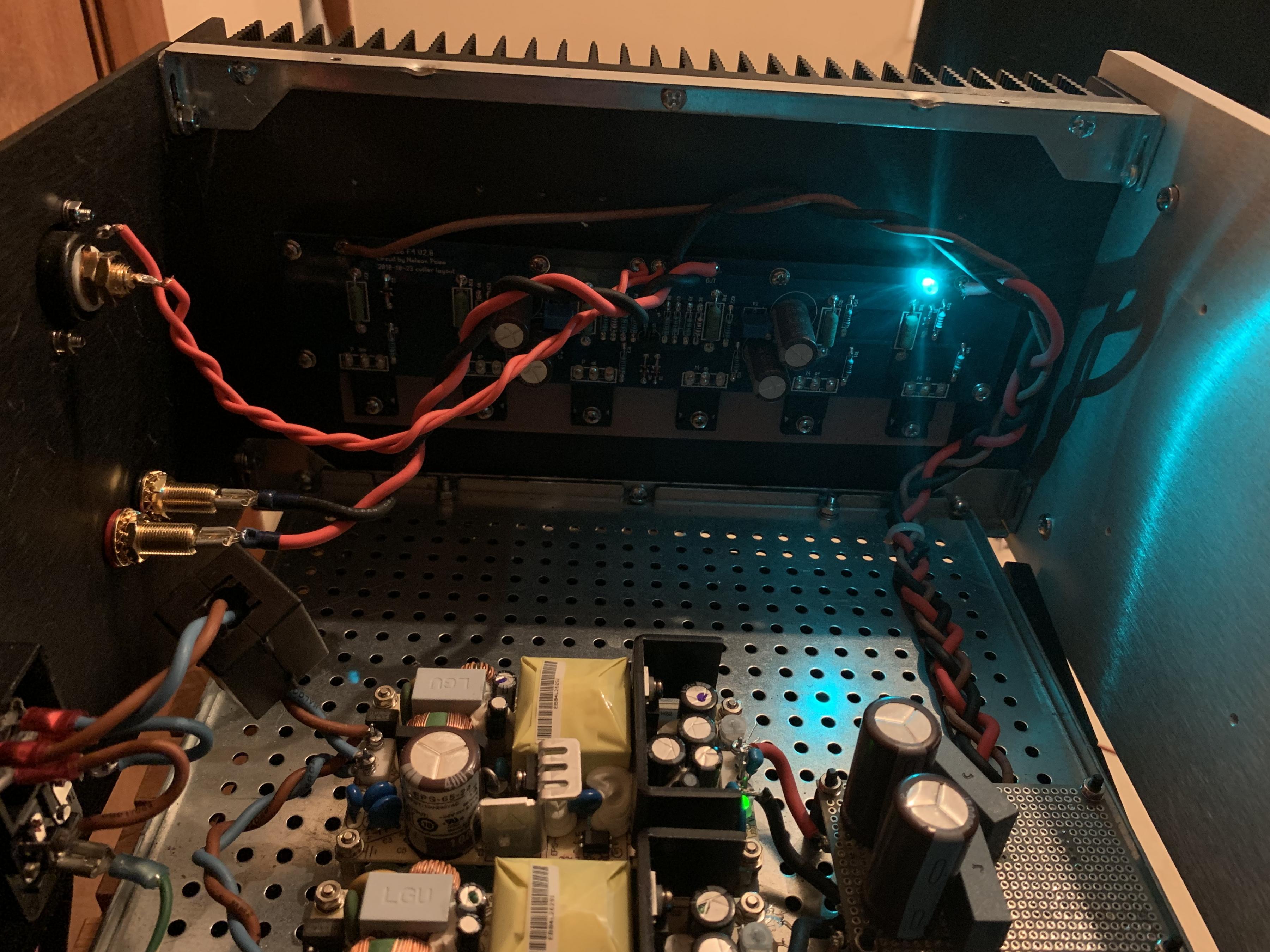

However, ‘stacking’ a pair of SMPS units inside a chassis to make +/- power rails has extra challenges. Since the switching frequencies of a pair of units do not exactly match each other, multiple beat frequencies consisting of sums and differences of the primary will be present. The beat frequencies will be conducted by the power wires, and may also be radiated by unshielded units. Using enclosed SMPS units will help greatly reduce the radiated interference. Conducted interference needs to be attenuated by filtering and / or regulation.
If I were stacking SMPS units, I would probably use a capacitance multiplier to filter each power rail.

Metal enclosures will help shield radiated noise and in fact there are enclosures made for that unit for a $$. I choose not to use one because of the spacing between the amp board and pwrsply. Using a capictance mulitplier would be a great way to increase the as seen total farads to the amp all while keeping the starting surge of the smps within its limits. I will use the the remaining portion of my pref board to build one!

There are many positives, absolutely.
The negatives include -
Beat frequency interactions down into the audio band
Radiated noise (RF)
If one fails, the entire other rail will appear on your speaker as DC.
In the time being, issues such as this are why the linear supply will always be the standard.
These are not insurmountable issues, but do require some attention. There's been some look into it, and believe me, I'd love to see something like an interface board in the amp chassis that takes 2 of the external 24v 150w bricks that the ACA uses to make a bipolar, while providing filtering and shutdown protection. No AC wiring at all? That would be great.
However, as soon as you add complexity you add cost, and fairly soon the normal linear PSU doesn't look like a big deal anymore.
You mention a universal chassis where you don't have to worry about the supply - The last couple build guides have been exactly that. 🙂 Chassis/PSU/Transformer are all the same, I'm just swapping amp PCBs. 😀 Works great! 😀
There' no question in my mind that there will be a solution to use SMPS in these projects with minimum or no downside. I'm looking forward to that!
