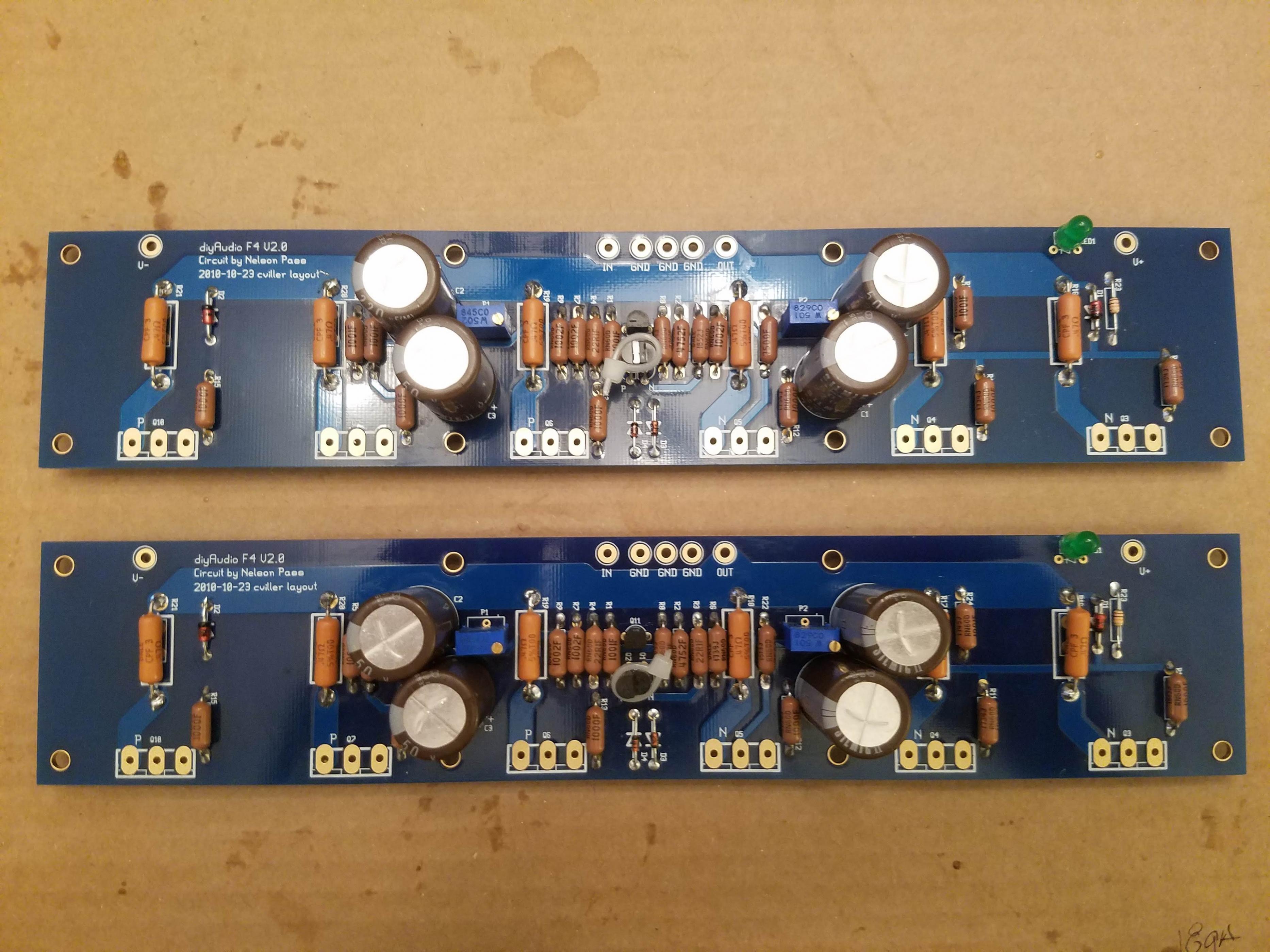

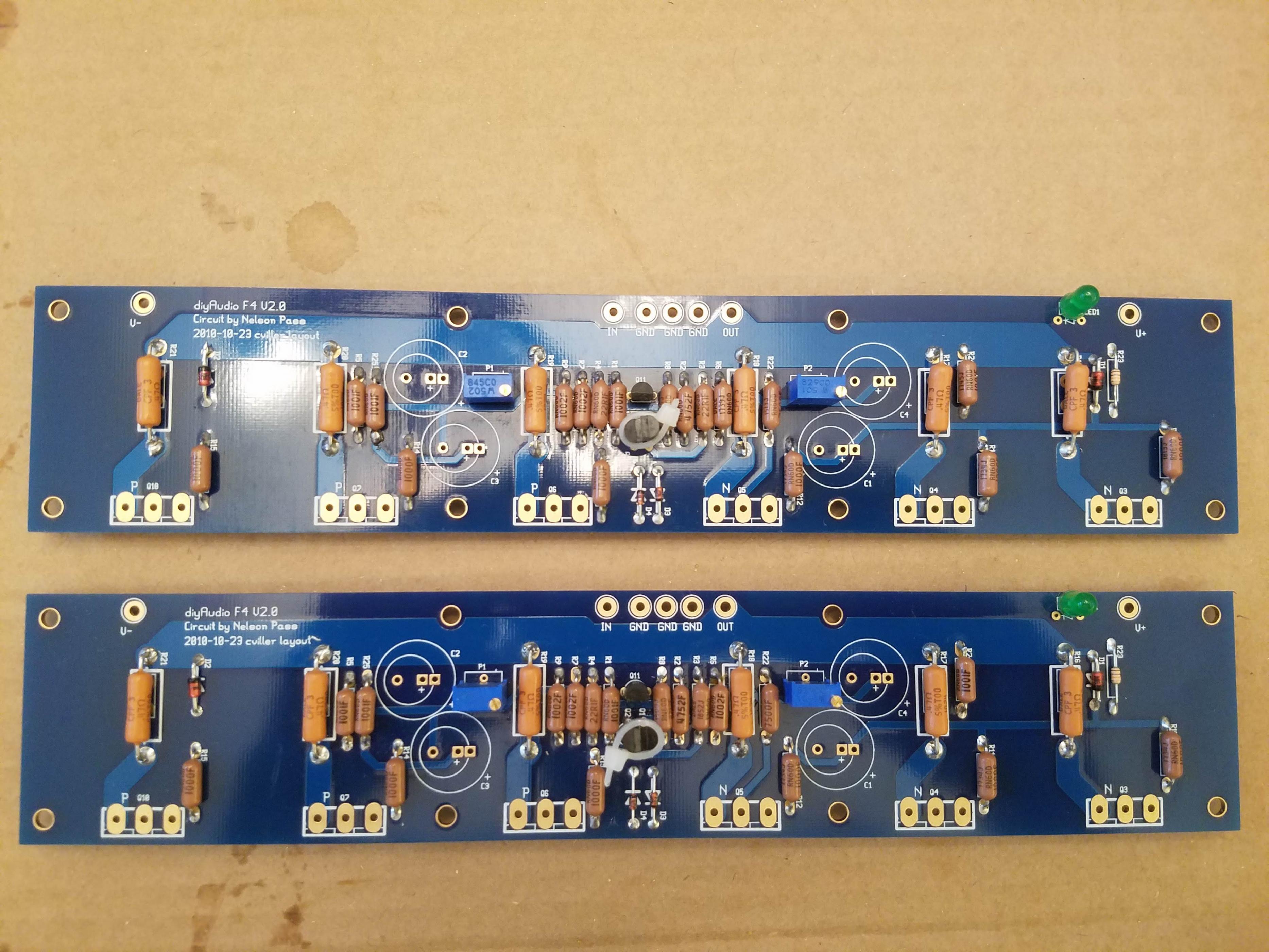

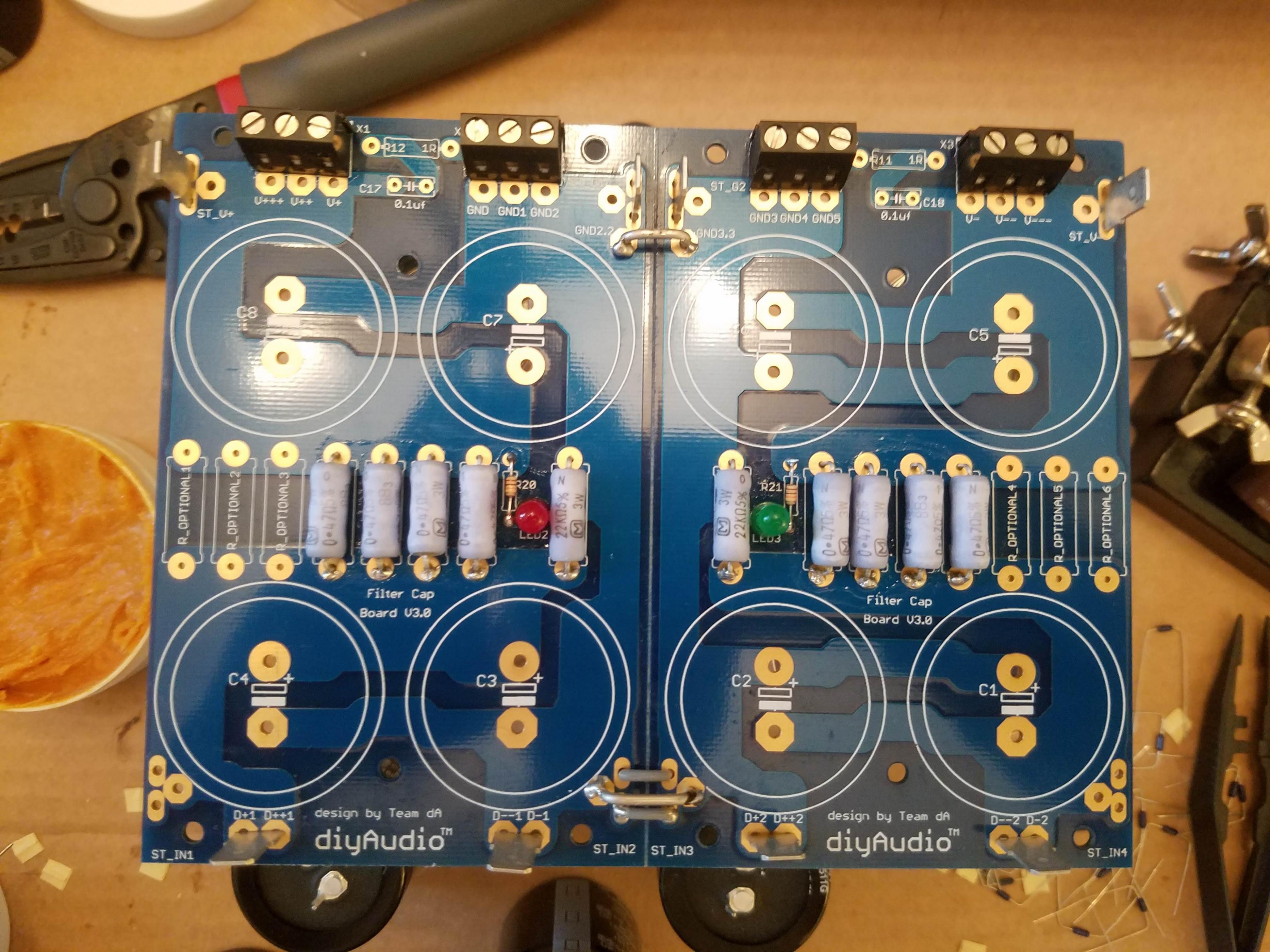

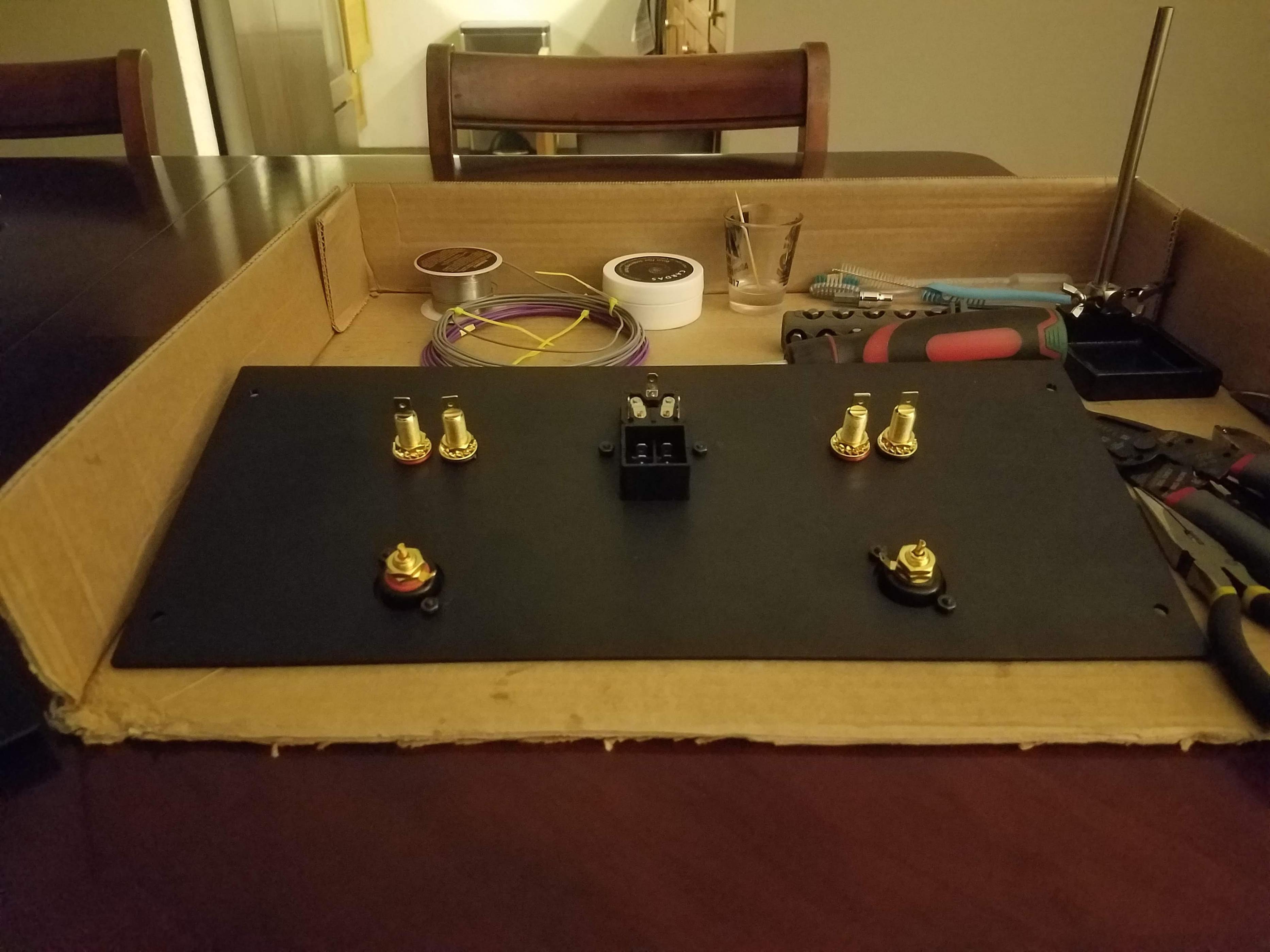

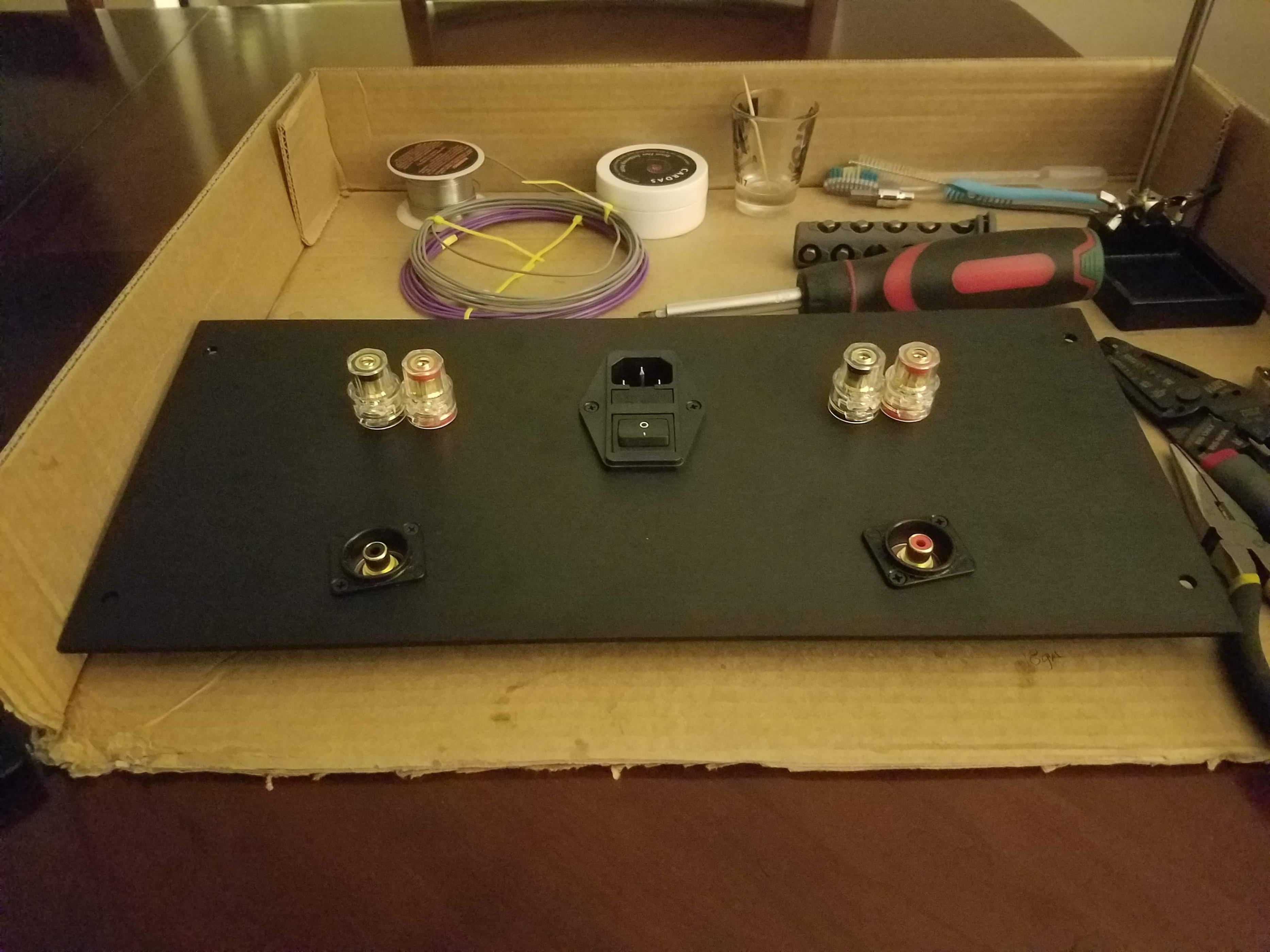

Just finished ordering all my parts. Looking forward to building. Gave up on the monoblock option so I could just follow 6L6's build guide more directly... I built a lot of lego kits as a kid (before free-building), so I feel well prepared. Wish me luck.
Ready for assembly

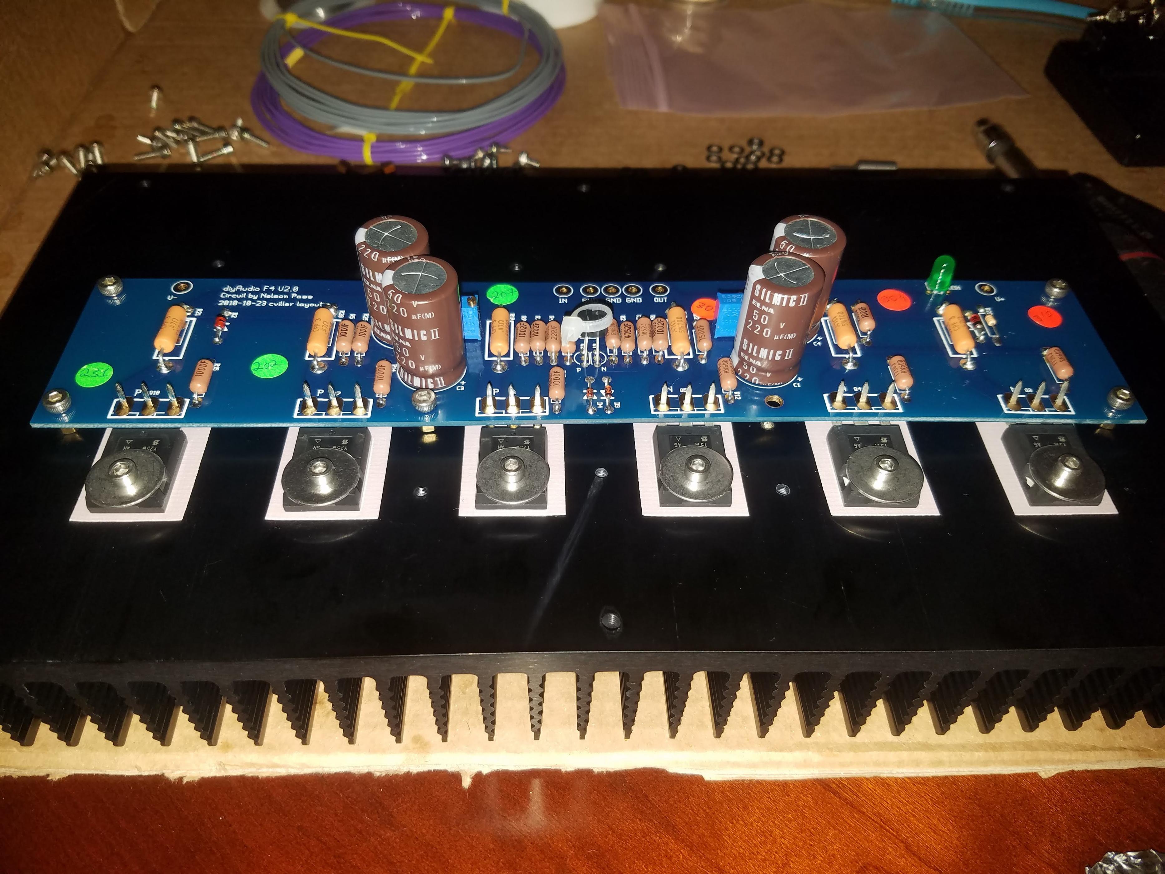

Finished the hardest part (I think). Just waiting on my Mosfets to arrive from Isreal to put everything together and start testing...

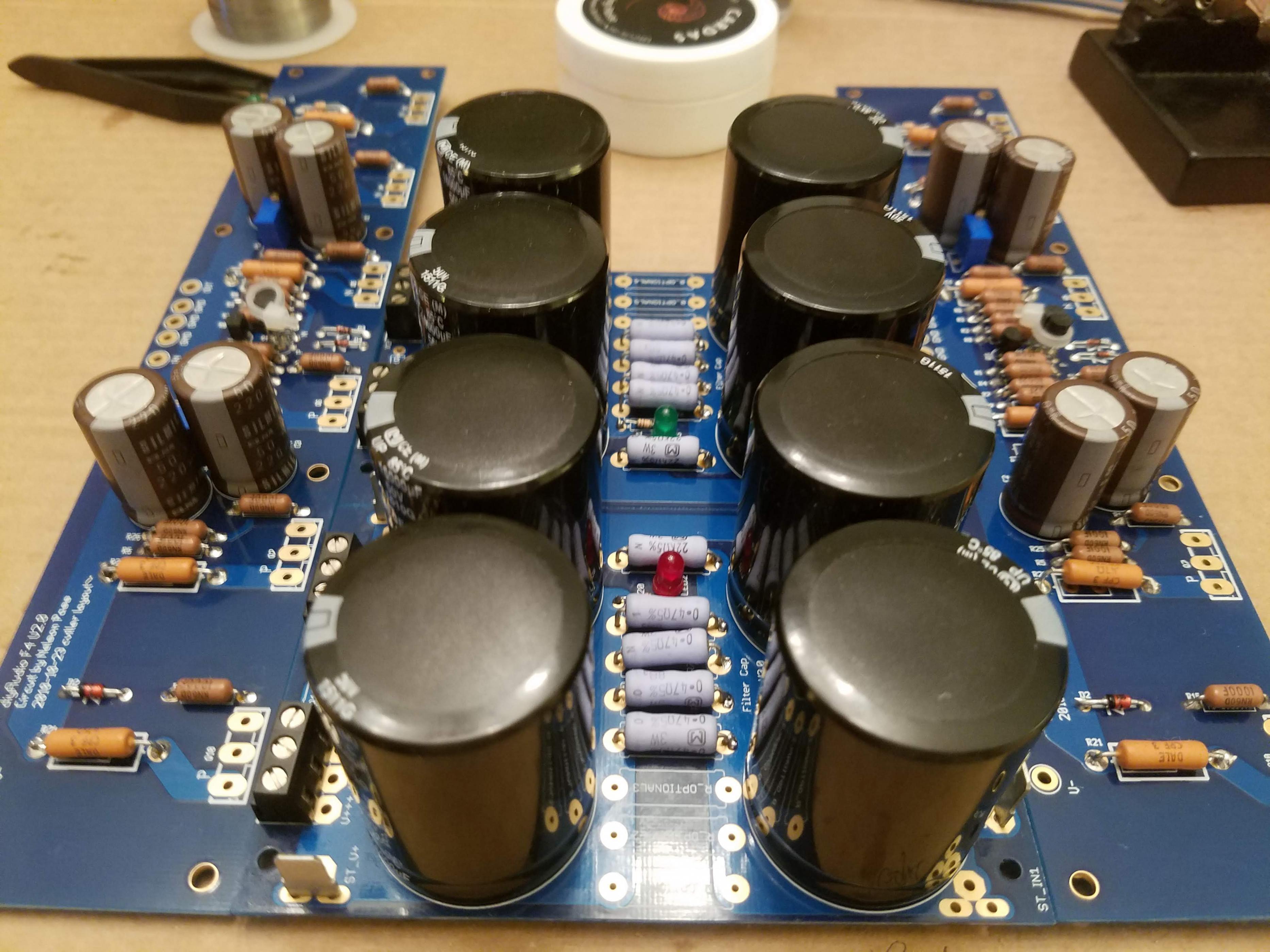

The easiest part of building an amp probably varies from person to person as much as personalities. My least favorite parts are sourcing parts and metal work...I'm sure others enjoy that. The easiest and most enjoyable to me is stuffing the boards. You're probably 25% complete!
And still would have been way easier if Mouser simply had all parts I needed instead of being out of RN55 and RN60 for at least 4 of the resistor values required.
Or grab a resistor that is .1 different.
I have used 33.1k resistors in place of 33k for example and they are even cheaper sometimes.
then just go fishing
that's hobby with much easier and secure outcome
Not necessarily

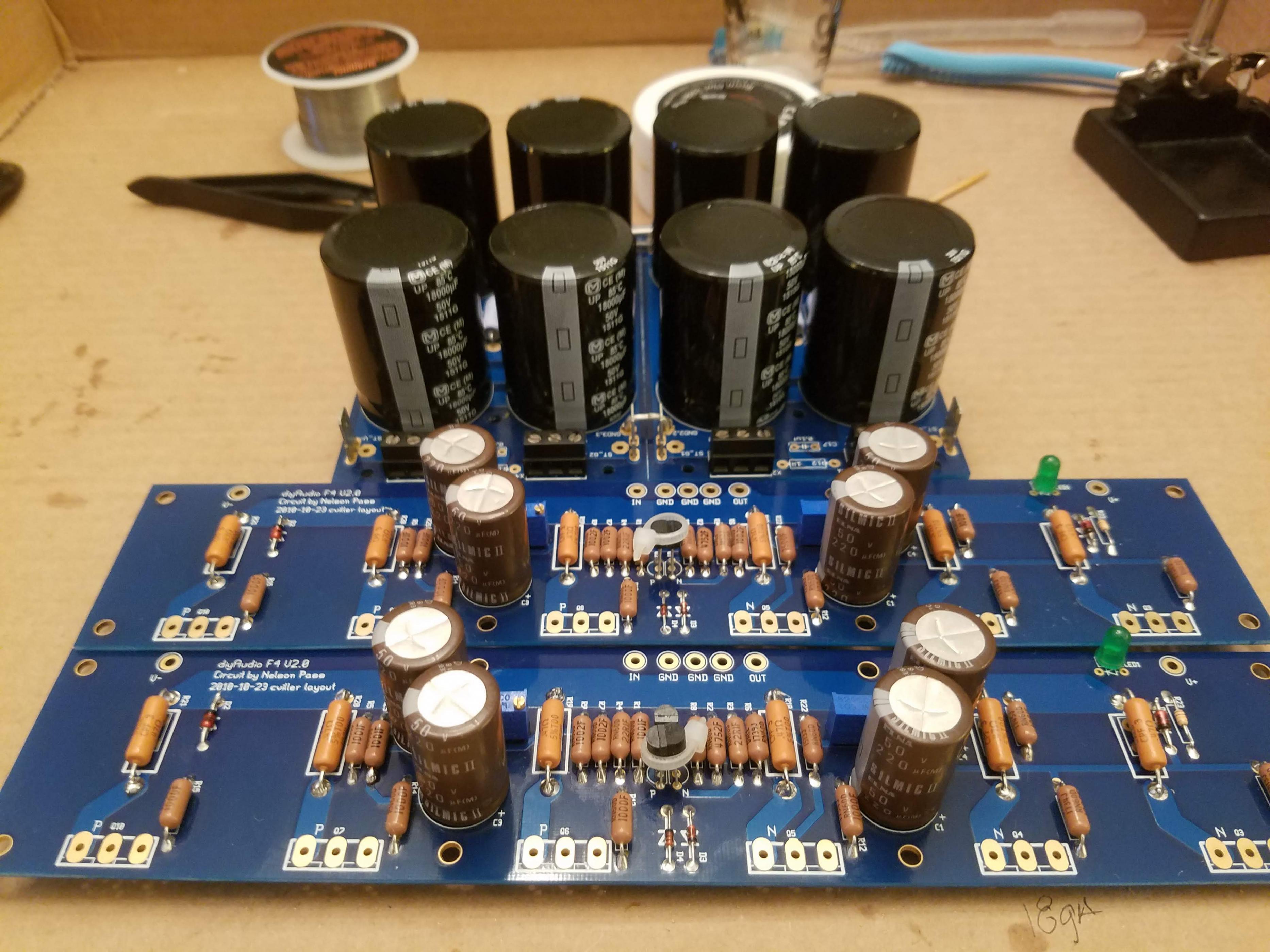

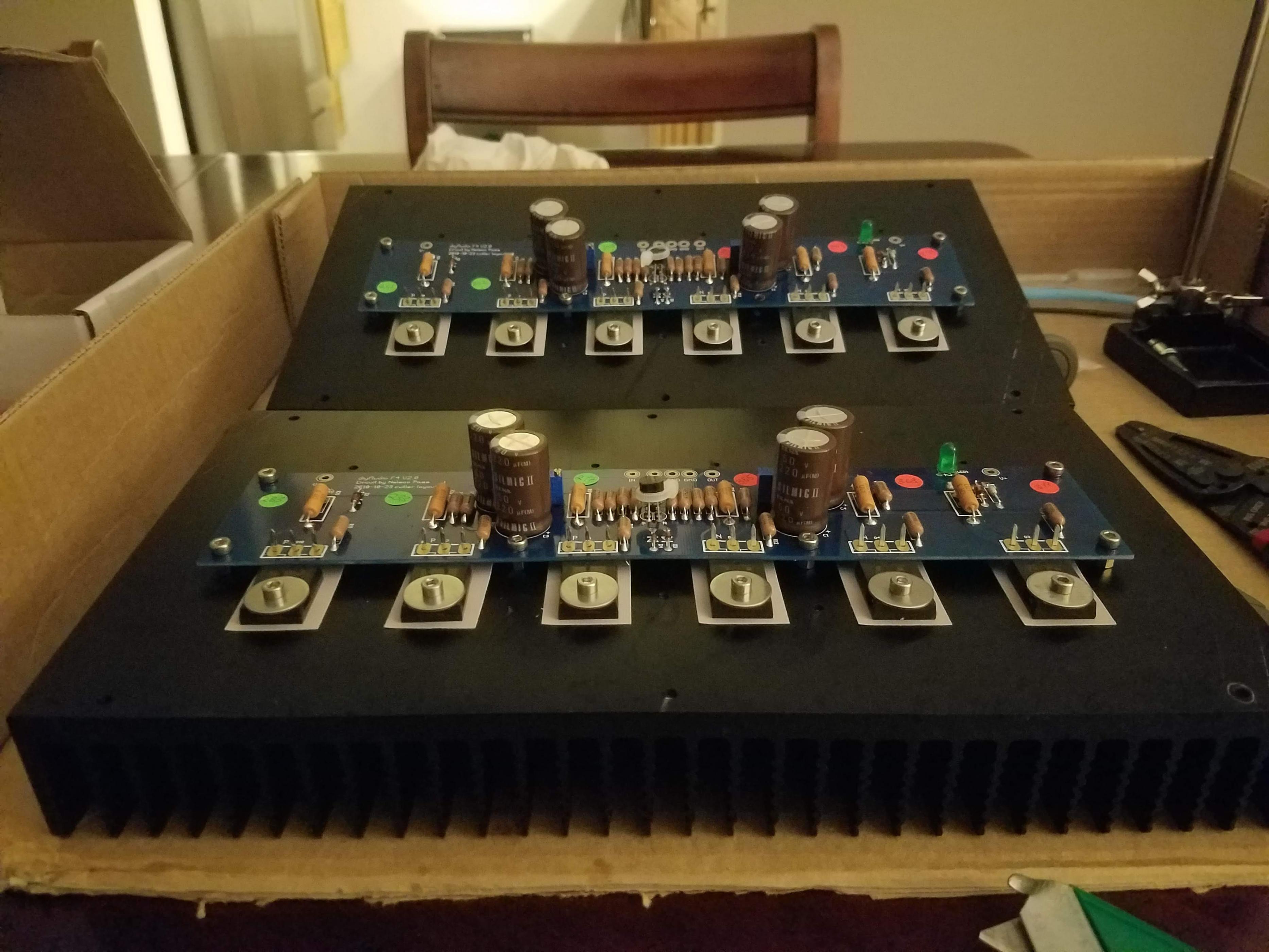

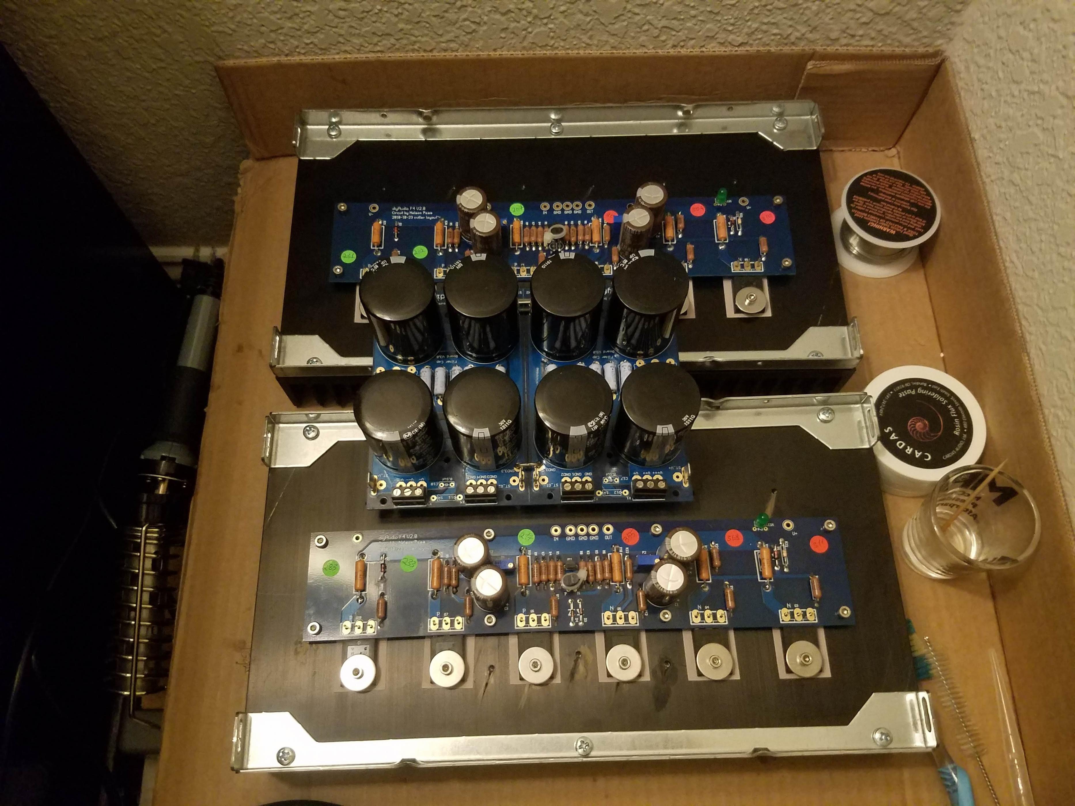

Unbeknownst to me, my MOSFETS came in the mail while I was soldering this afternoon... couldn't fume out my girl out with any tonight, but got a decent amount put together.
Pass DIY Addict
Joined 2000
Looks like you've got most of the work done! My recommendation at this point is to wire/power ONE CHANNEL AT A TIME. If you have a dim-bulb tester or a variac, now is the time to use them to make sure you don't blow something up. I like using the dim bulb tester with the variac. This will let you see if there are any significant power problems and often provides "just enough" voltage to connect an input and a old test speaker to see if it makes sound.
Had to travel this weekend, but got really close right before leaving. Just finishing up wiring the power supply and then got to build the dim bulb tester and I'm ready to roll. Definitely will have a new amp by next weekend.
Having some issues with an F4 build and looking for suggestions on how to troubleshoot. PS measures 25.2V. However, when connected to the audio boards I have 0mV Bias and 25V offset no matter how P1 and P2 are adjusted. Checked continuity for all ground points and V+ and V- from PS to Audio boards. Not sure what to look at next. 😕
