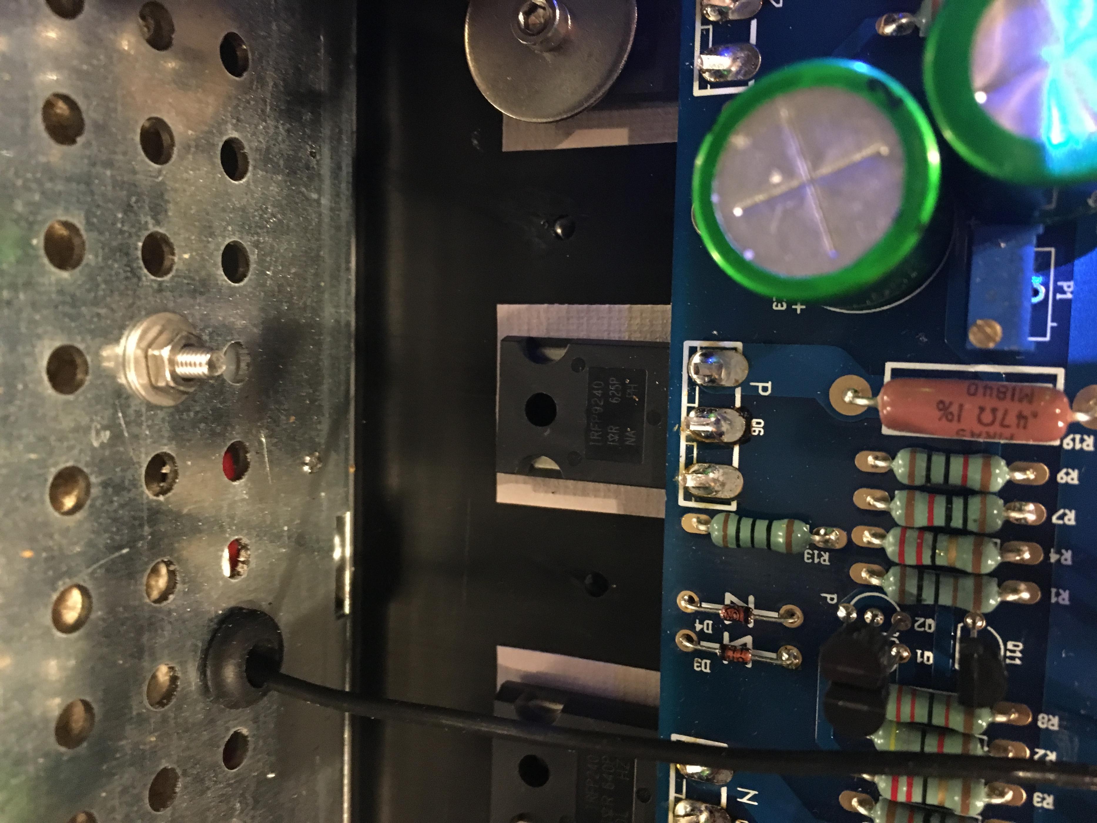

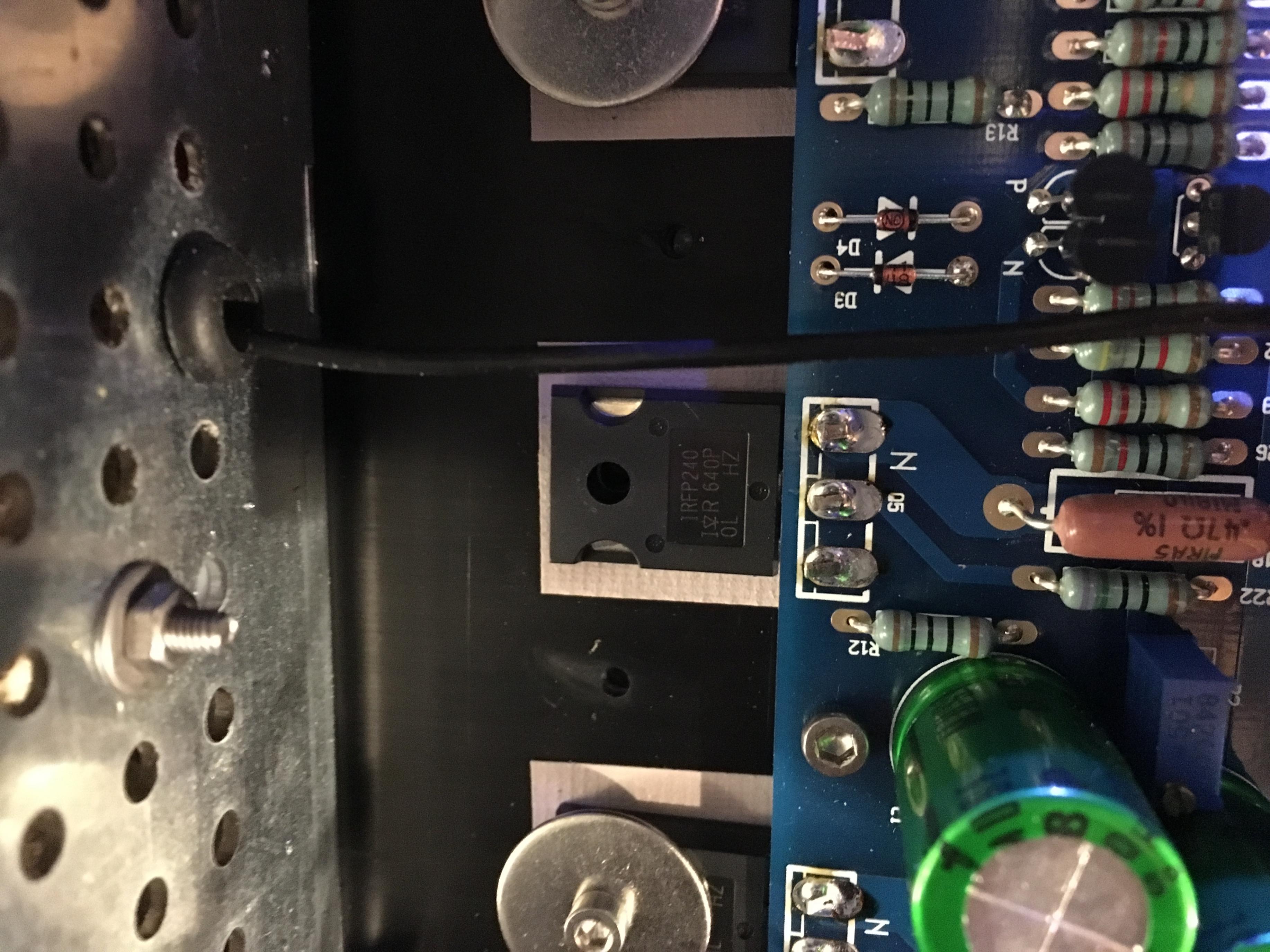

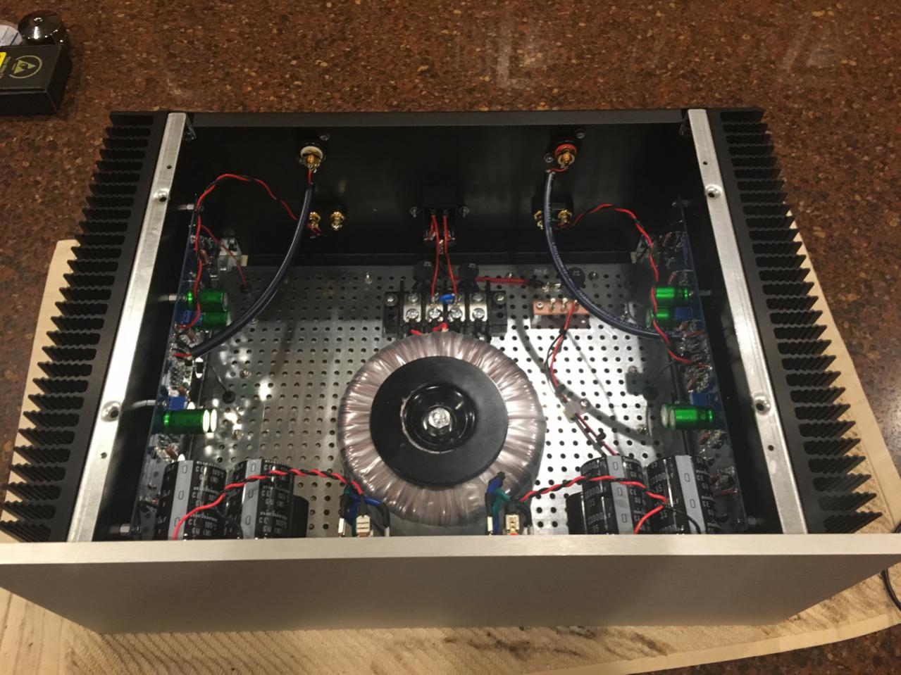

Check polarity of mosfets, soldering of source resistors, and shorts under the keratherm.
Polarity is correct (9240 for P; 240 for N); source resistors solder good; no shorts on Mosfets if I did it right (checked Drain Pin to Ground).
Ok, that looks good so far.

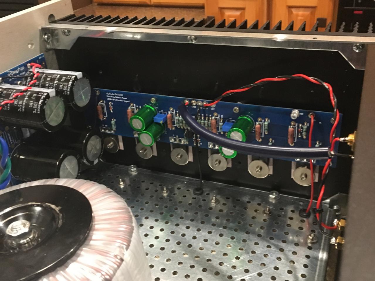

More photos please, of the boards, the PSU, the wiring, and a few overview. 🙂

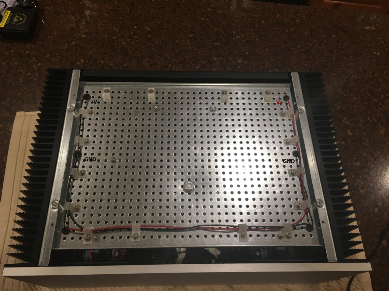

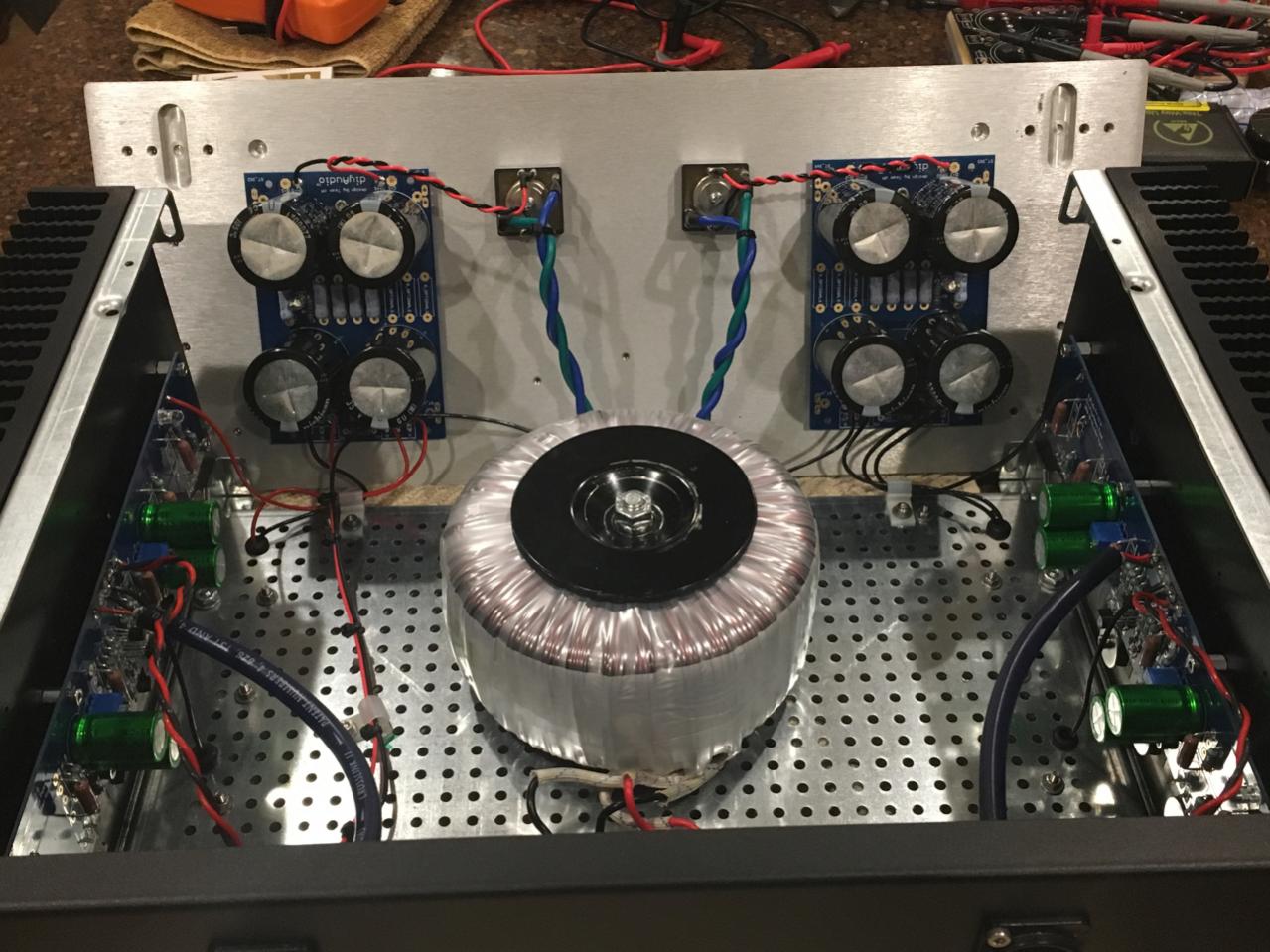

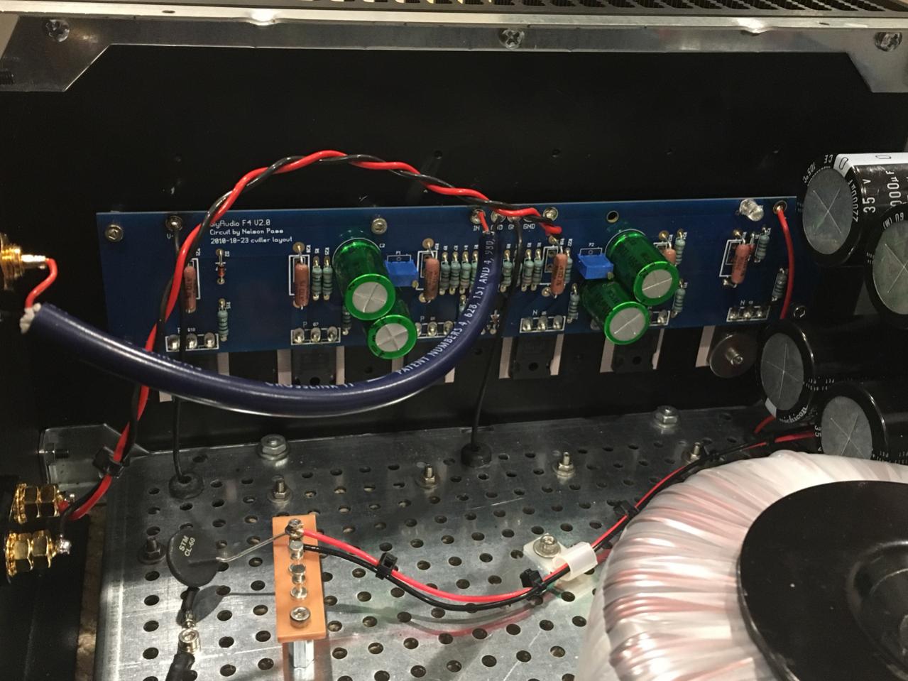

PS wiring is bit hard to track as it is routed underneath the bottom plate. I labeled the wires in the photo. My M2 and F6 builds went without a hitch. This was suppose to be a quick and dirty build but it is making me work for it.
It looks like you’ve got your power supply turned inside out after you split the PCB. (The LEDs should be on the inside) It’s one of those things that might not matter if you are really clever and were planning on doing that , but all the labeling will be backwards...

They are but I didn't think that would matter as long as the V-, V+ and GND were connected properly. Will check everything again today. Thanks for taking the time to look at the photos!
Okay, found it. V- and GND are reversed on the PS board. I looked at that at least 5 times and redid the wiring twice while assembling (was done correct first time then brain must have focused on orientation instead of actual labeling on the board second time). Nice example of why not to rush even if you think you know what you're doing.
Fixed the negative rail wiring. DC offset is now normal. Still how 0mV for bias. I'll see if changing R9 makes a difference but I would have expected to get some reading even if R9 is too large.

Thank you for all your help. I think I would have stared at the wiring for a week before noticing the mistake if you hadn't mentioned the PS boards.
That’s the whole point of posting the photos... you need different eyes to see the mistakes.
