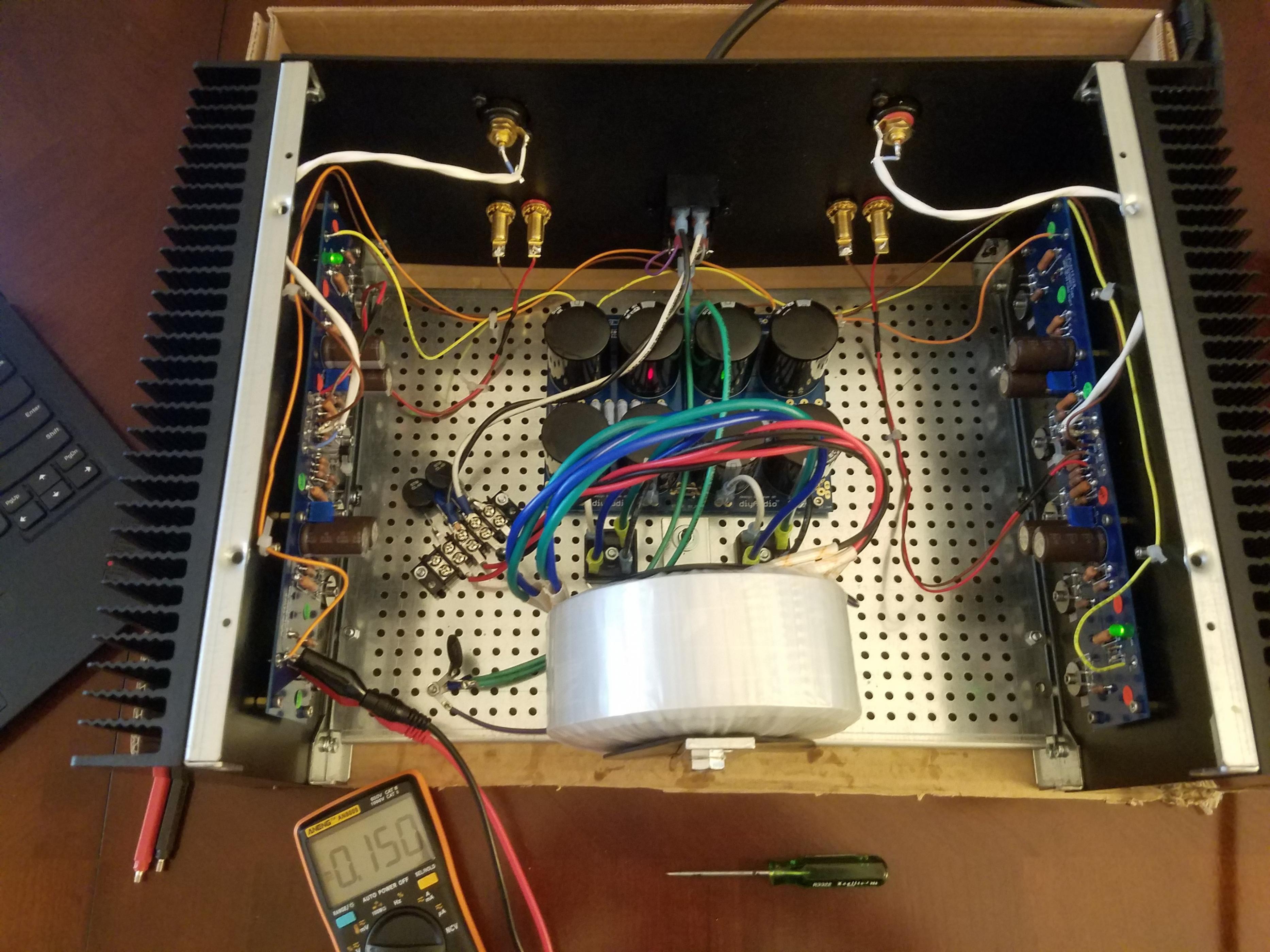

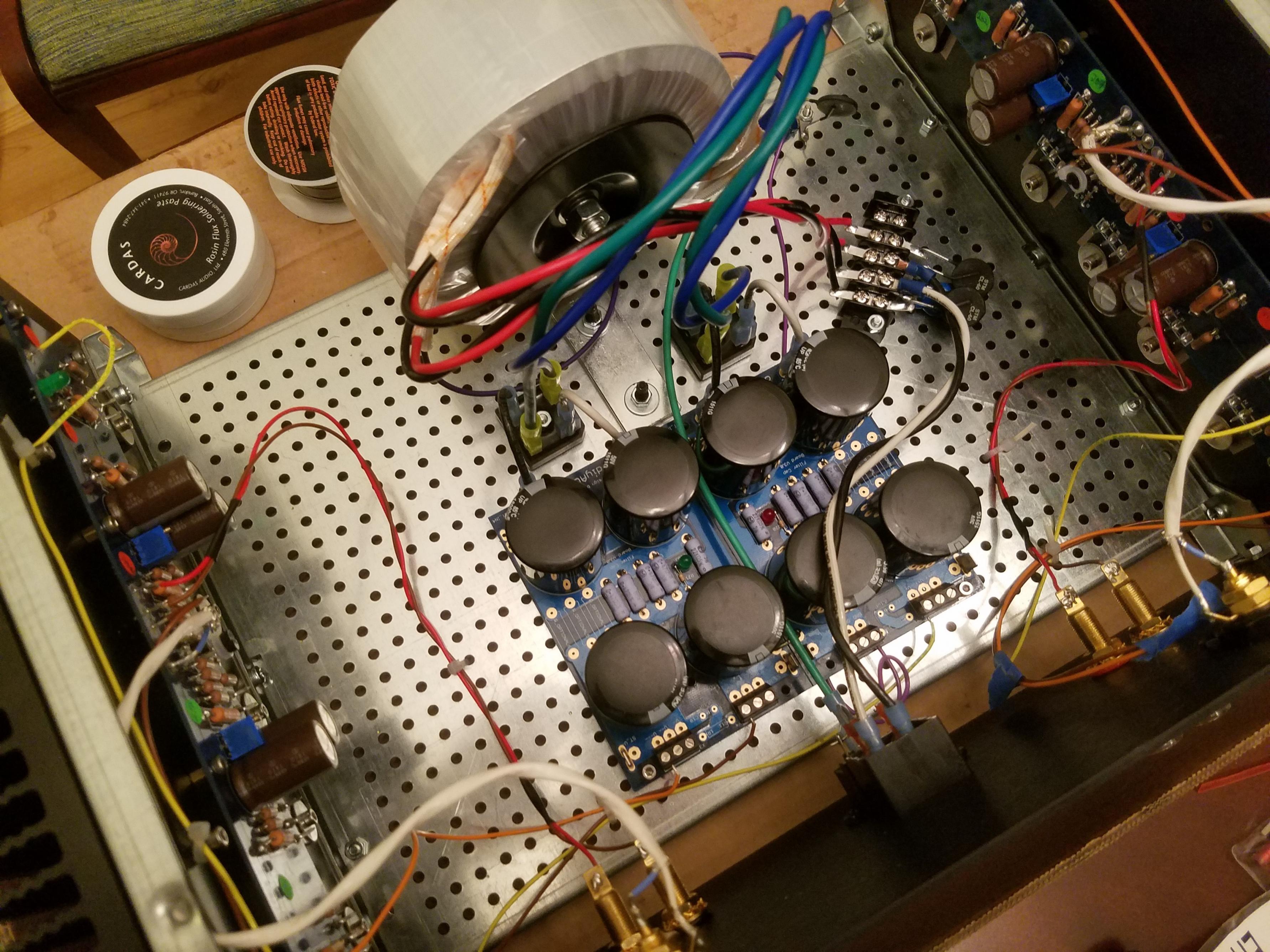

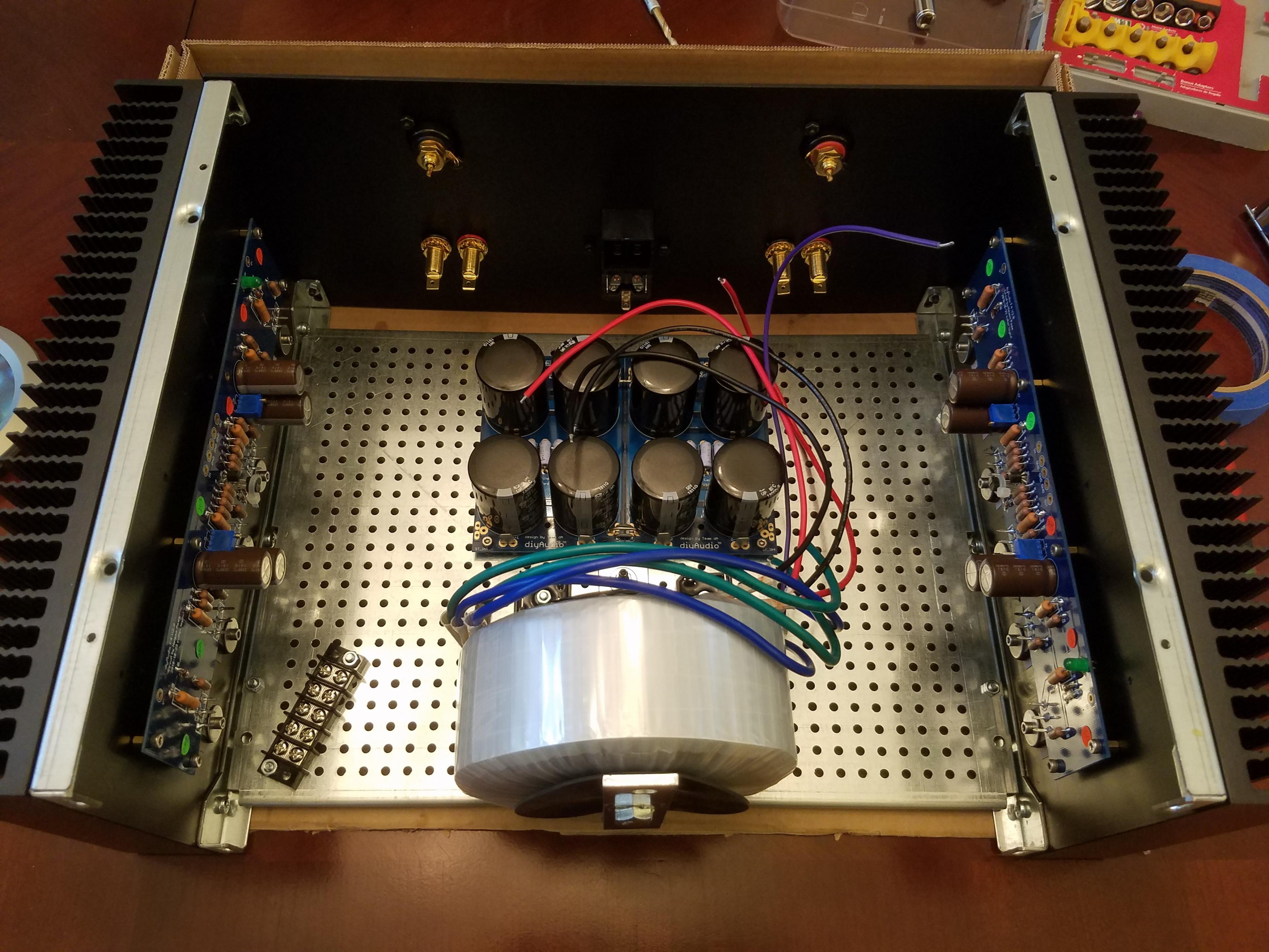

Getting close. Building the bulb limiter, double checking all wiring, and then powering up board by board tonight...

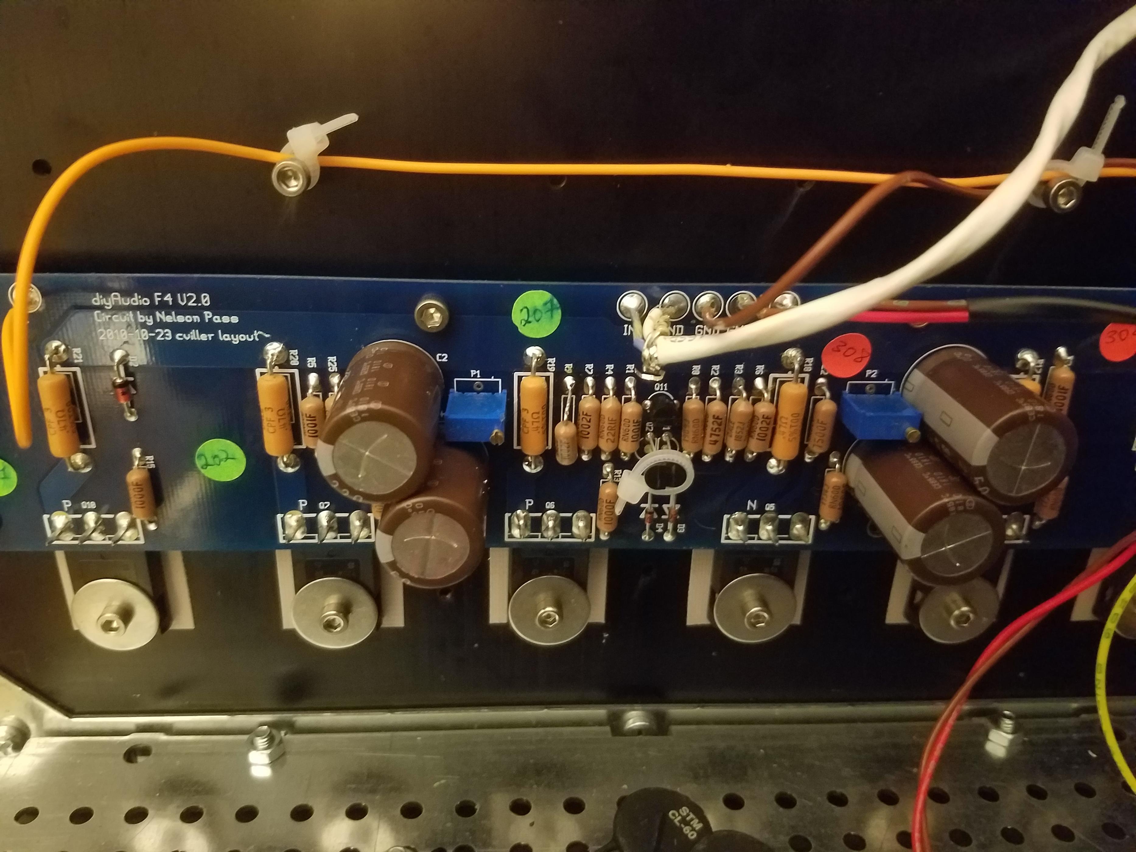

Finished all wiring and used the bulb limiter to check the PS and both boards, everything looked good.
Then tried to set bias and could only get up to .06V. Switched out R9 for 47.5K and realized that I'd been trying to set the bias with the amp plugged into the limiter. ****. Plugged into the wall to test the left channel, immediately sent it well over .5V, smelled something (light, no smoke) and unplugged quickly. Switched back to the stock 10k resistor and now I get a bias of .000V (with power LED illuminated). Not real happy with myself tonight.
On the plus side, the right channel at least biased up to .13v when tested by itself.
Any thoughts would be greatly appreciated. I saw the "potentially blown tl431" thought earlier in response to a bias of 0V...
