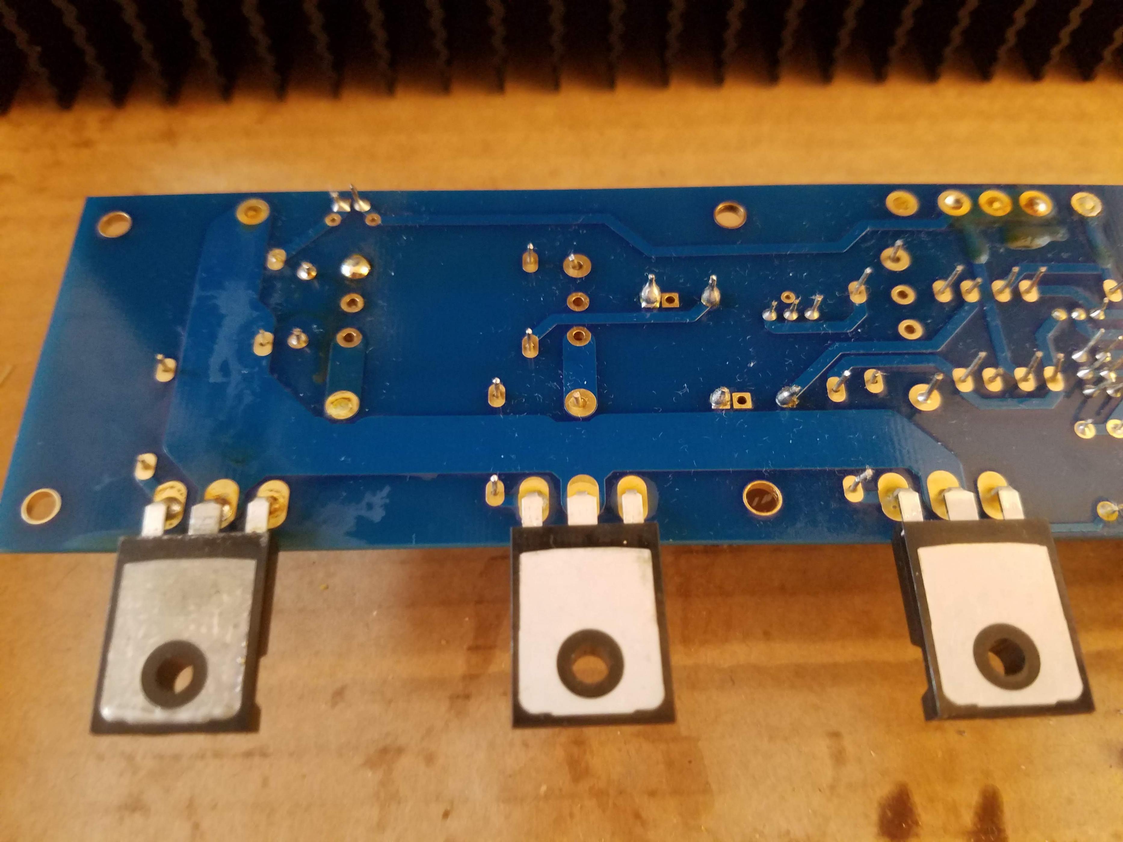

I'm using the Cardas Quad Eutectic (not lead free) and have been using my iron at 350 degrees. First time soldering circuit boards, so I'm still learning. I think I've got good joints on top, but clearly the solder isn't flowing through the hole. I didn't even realize it should be, so I guess that's a fine place to start on my second attempt. And I'll shore up my good board by soldering the back side as well.
Thanks again for all the help folks.
Ok, don't worry about the solder, that's some of the best stuff available anywhere.
I suspect you are suffering from some cold joints. Place the iron against the lead and solder blob on the board, melt it until you can get the iron tip against the PCB itself, (since the solder is now liquid, and then count one Mississippi, and remove the iron.
Do that on all the joints on the PCB that's acting funny.

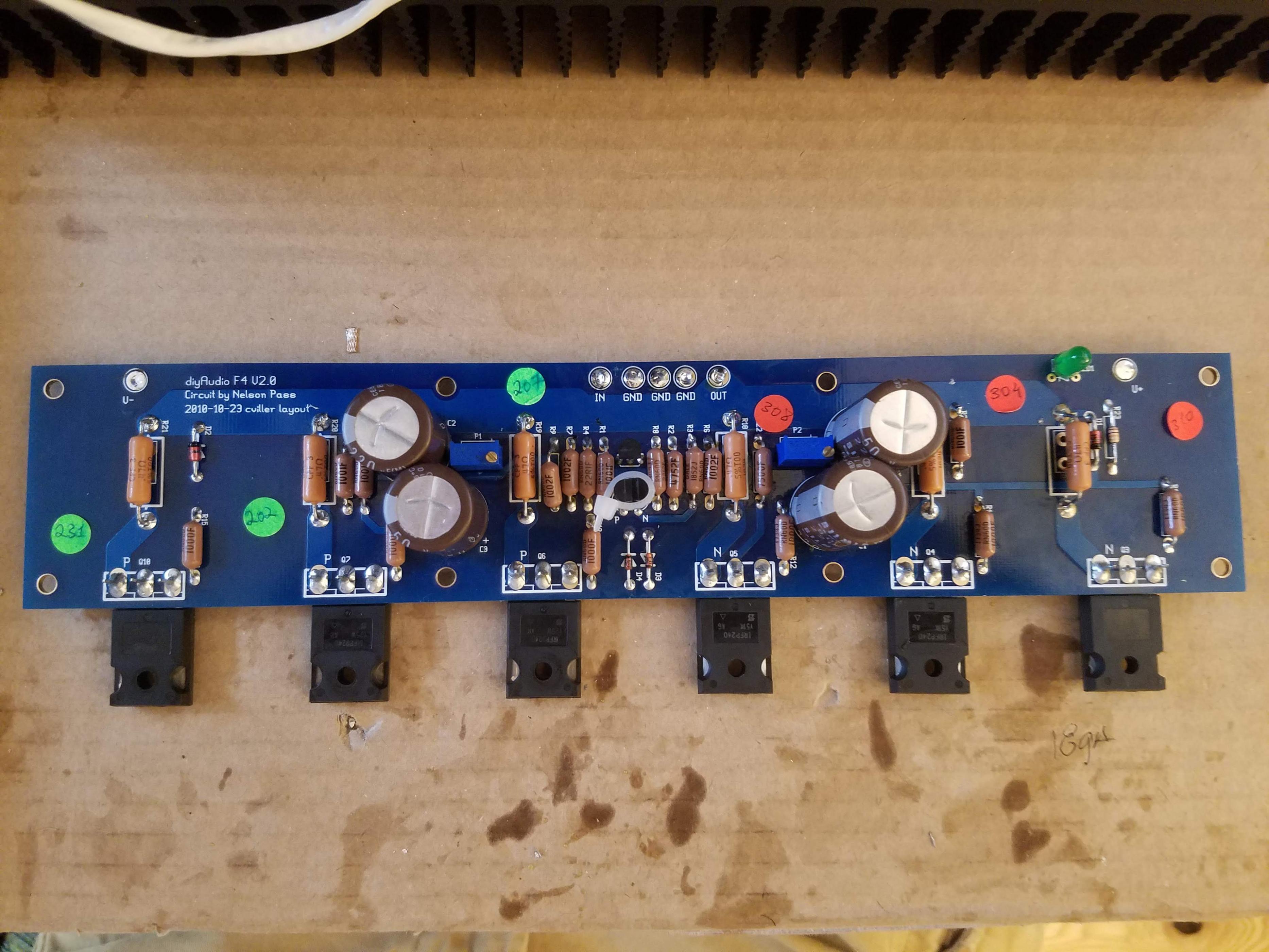

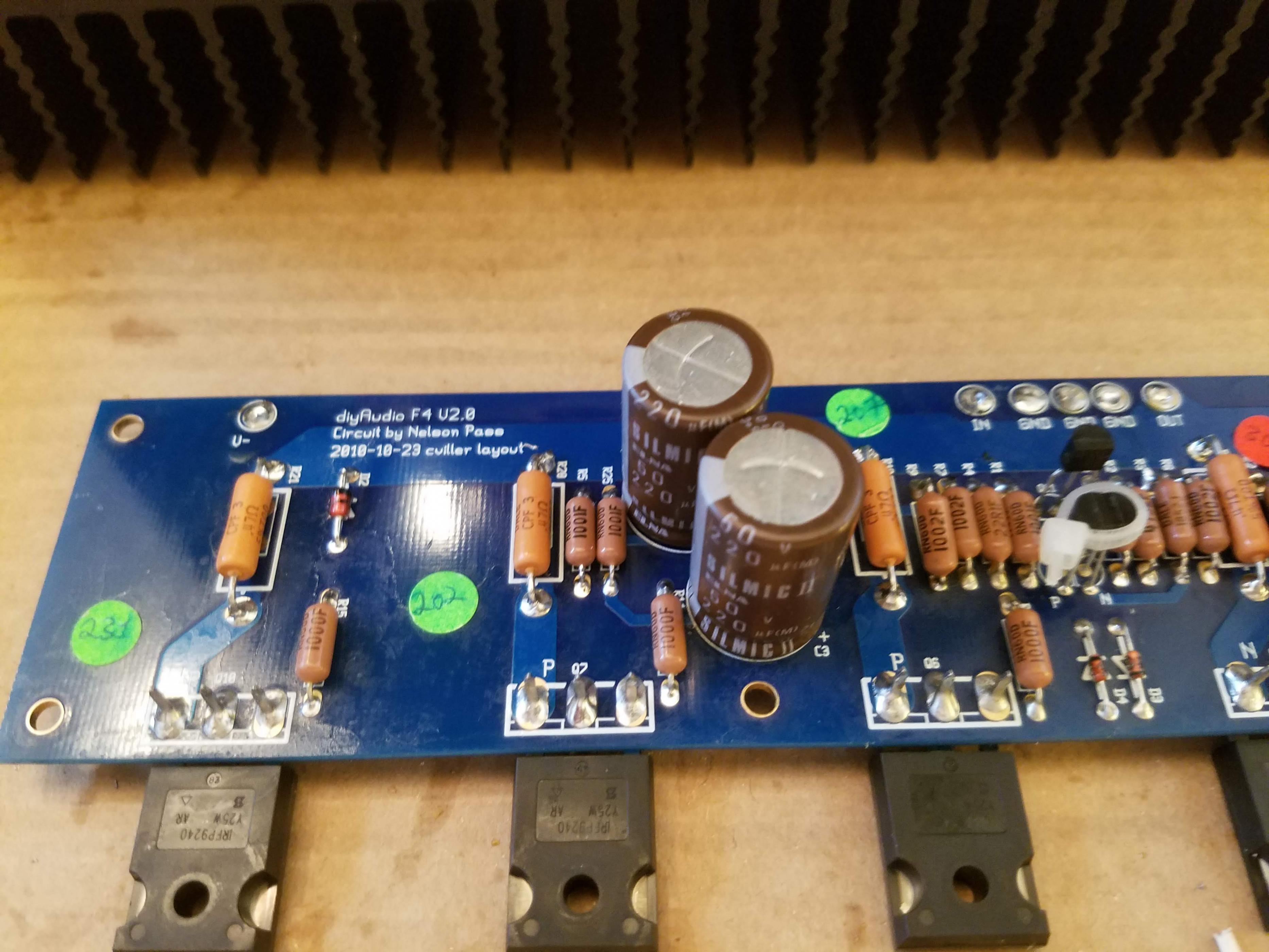

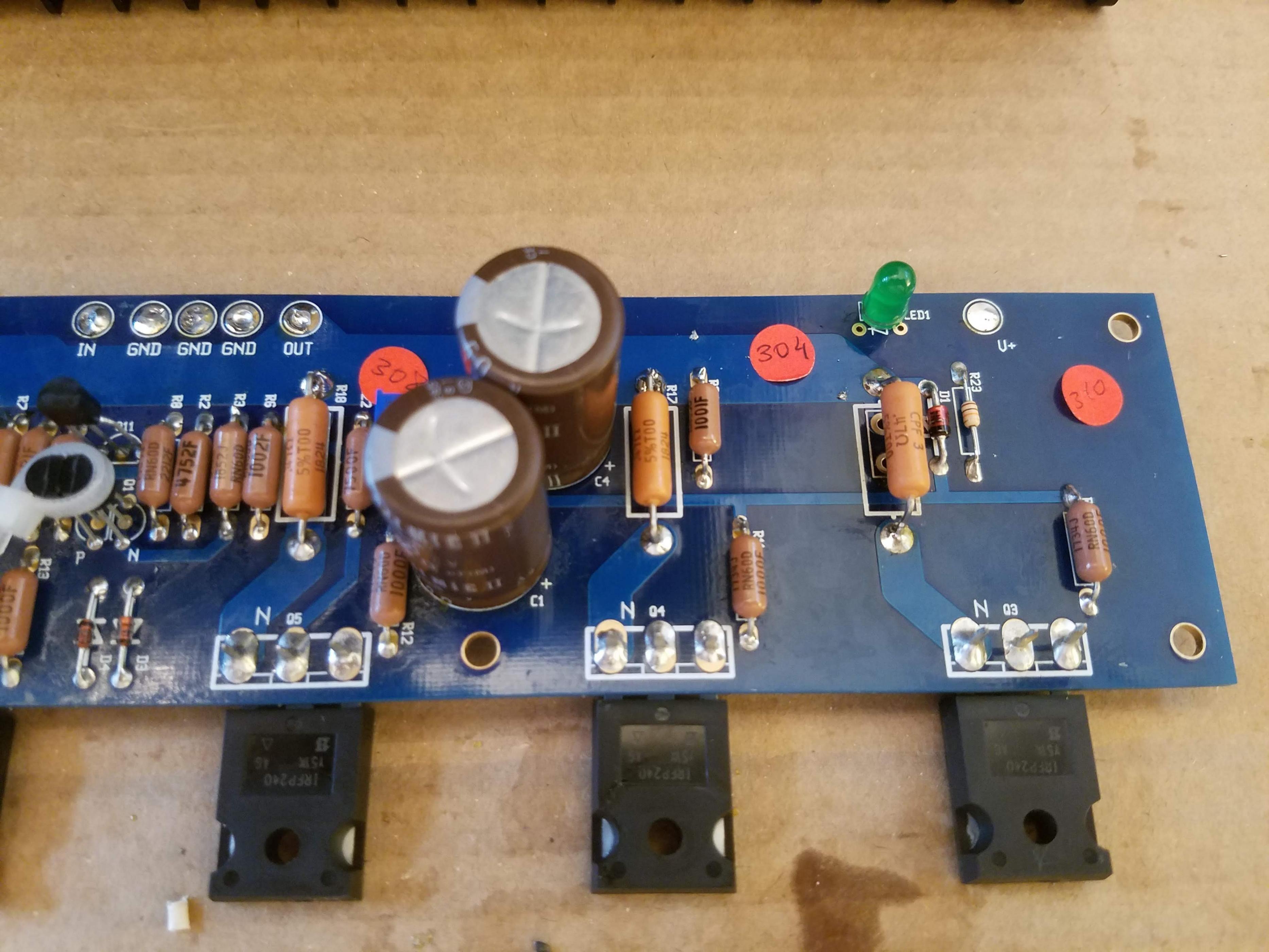

Seems like you all have probably identified the problem, but here are some board pics anyway... perhaps they'll be useful to future builders.
I'm worried about that one mosfet on the end. That's where the resistor smoked and you can see a singe mark on the keratherm.

Ohh, and in regards to the mosfet matching, you can see the values associated with each stuck onto the top of the board. Anyone have a good US source that would sell me a matched single if that one is bad? It took 3 weeks I think to get them from Isreal...

The trick is getting the iron on the lead and the PCB at the same time, feeding solder into that, and watching the surface tension change (once everything gets to the same temperature) and the solder wick into the hole.
Yeah, and keep feeding solder to the joint for one or two seconds more. That will basically disappear into the hole and build some nice joint the other side as well.
One more thing, about which I'm not sure you (cal) are doing, from your description on how you stuffed your boards: usually, I stick the leads through the holes and solder everything from the underside - let the molten solder wick back through the hole to the top side.
Only the big MOSFETs will be soldered from above - because we tighten them to the heatsink first, and only then solder them to the board, to prevent putting mechanical stress on the solder joint by tightening the bolt on a MOSFET that is already firmly connected to the board.

Just did the mosfet test on the suspect looking one (How to Check a MOSFET Using a Digital Multimeter | Homemade Circuit Projects)...
1) Set the DMM to the diode range.
2) Keep the mosfet on a dry wooden table on its metal tab, with the printed side facing you and leads pointed towards you.
3) With a screwdriver or meter probe, short the gate and drain pins of the mosfet. This will initially keep the internal capacitance of the device completely discharged.
4) Now Touch the meter black probe to source and the red probe to drain of the device.
5)You should see an "open" circuit indication on the meter.
6) Now keeping the black probe touched to the source, lift the red probe from drain and touch it to the gate of the mosfet momentarily, and bring it back to the drain of the mosfet.
7) This time the meter will show a short circuit (sorry, not short-circuit rather "continuity).
The results from the point 5 and 7 confirms that the mosfet is OK.
Repeat this procedure many times for proper confirmation. That's it, this will confirm your mosfet is alright, and without any problems. Any other form of reading will indicate a faulty mosfet.
For repeating the above procedure each time, you will need to reset the mosfet by shorting the gate and the source leads using meter probe as explained earlier.
Unfortunately I get a voltage drop reading (not an open circuit) at step 5. Looks like I need some new N channels (at least).
