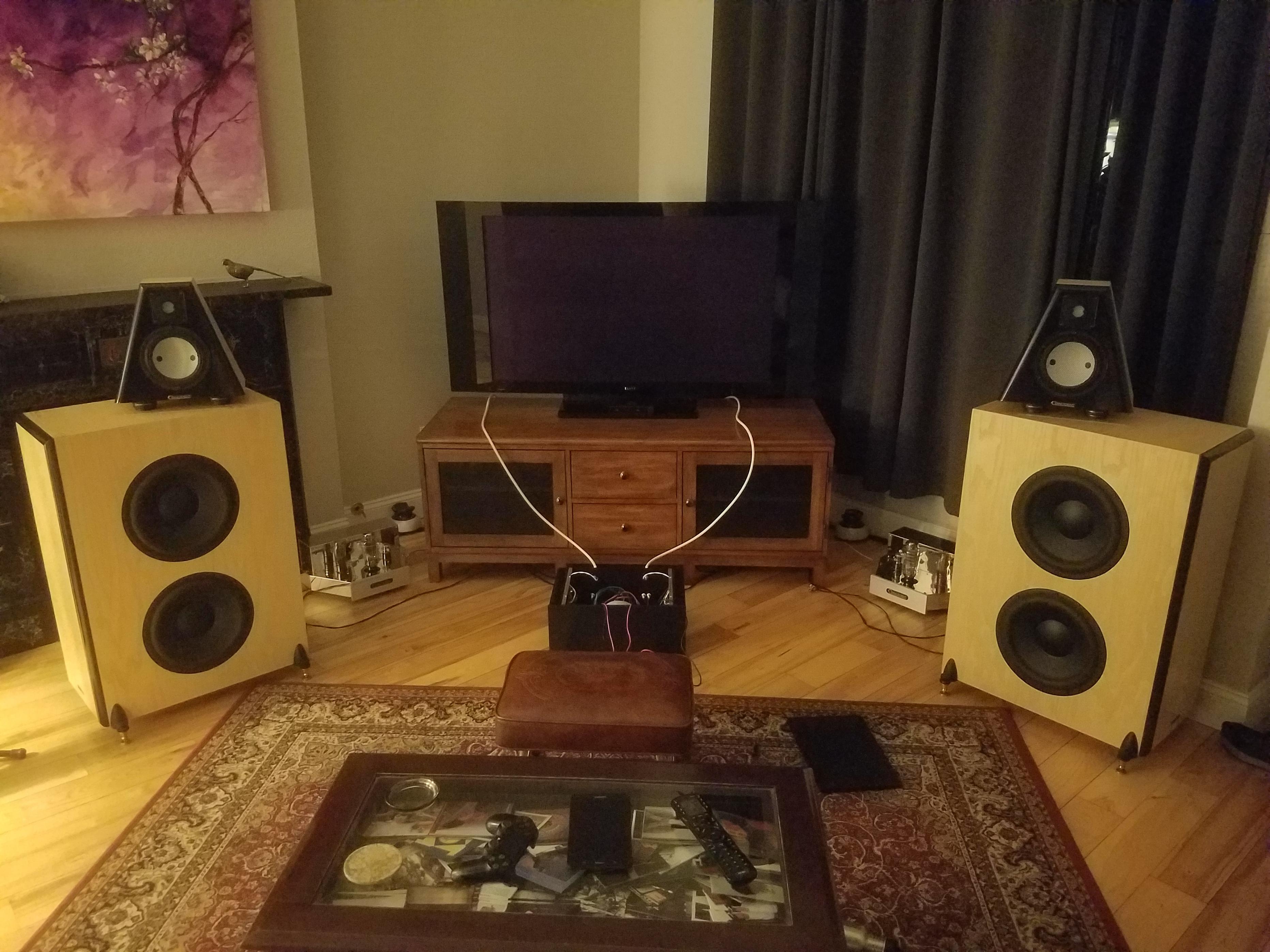

I've got an 8W DHT SET that I'll be using for voltage. Will be trying the F4 on bottom of a bi-amp setup and driving everything with the SET running a resistor. Really looking forward to hearing it this week/end, I've been trying to solve a bass problem for a year. Any amp I try beats the SET in bass, but loses too many other places... And bi-amping with an active crossover killed coherency. Hoping the F4 solves all of that.
Yesterday I hooked the F4 up as follows: PS Audio Directstream -> PassLabs XP10 -> Bottlehead S.E.X. -> F4 -> Harbeth 7es3. It sounds exactly as Nelson and everyone else has claimed: tone, texture and warmth of the S.E.X. with drive and bass of a much more powerful amp. I am thrilled with the sound and the flexibility of this amp. I have used tube amps for the past 15 years...various Audio Research and Conrad Johnson amps. I've tried a few solid state amps on occasion, the last being a PassLabs Int-60 that replaced an Audio Research VSi-75. I could live with that amp, as well as the F6 I built, instead of any of the Audio Research amps, except maybe my old CA-50 (it has a bit of a mid-bass bump and warmth not found in current AR models that makes it a very engaging amp to listen to). But no solid state amp I have heard to date has ever gotten me to consider giving up my Conrad Johnson Classic 60. It is the one I have always come back to. While there are certainly solid state and tube amps that are quieter, more detailed, more accurate, more of all the things high-end reviewers generally rave about, none have the the BIG sound that the Classic 60 has. The F4 driven by the S.E.X. has it. It sounds warm, rich and BIG with all the resolution I want. I built the S.E.X. for occasional headphone use and it is obviously not a state of the art DHT amp by any measure. So now I am wondering how good the F4 would be with an even better DHT driving it. I could easily imagine ending the amp game altogether with a pair of F4 mono blocks and just exploring different preamps in the future.

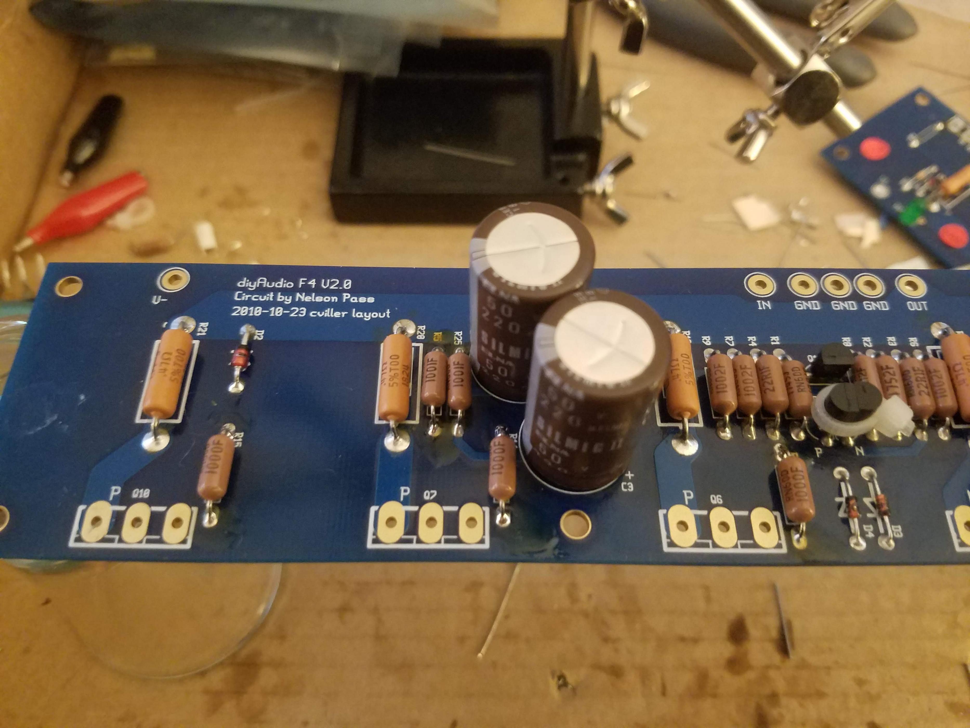

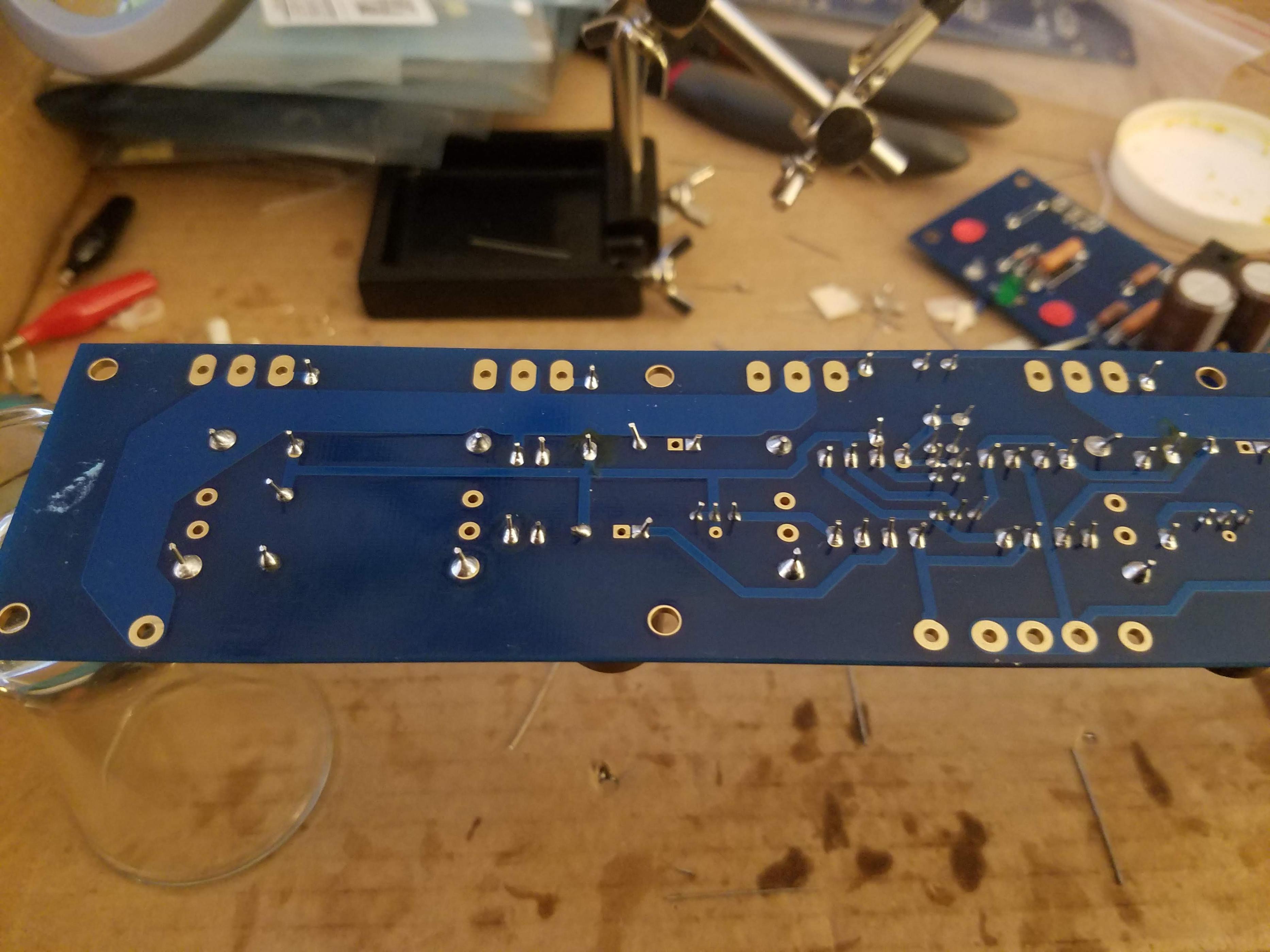

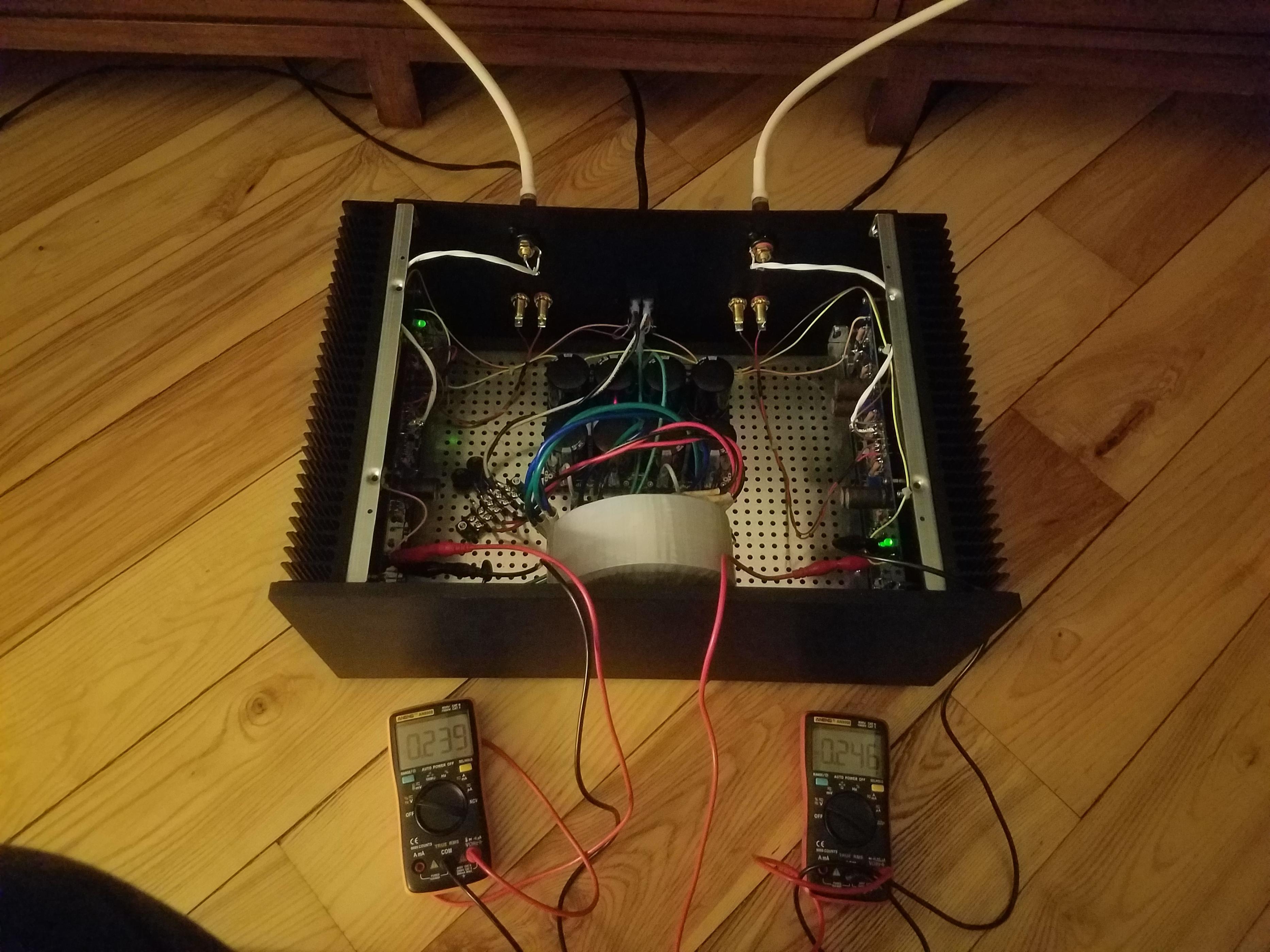

Missing a couple resistors, but stuffed and soldered a new board today. Much better. After soldering (the top again), I flipped the board and had fully soldered leads on almost all of the bottom. Just went ahead and hit those few from the other side too. Looks much better, thanks for all the tips...
Got the remainder of the parts yesterday (thanks for the mosfets Wade!) and finished up the boards.
Started the biasing procedure, but unfortunately 10k at P9 is too high (can only get up to .10v bias at cold startup) and 4.75k is too low (can only get down to .15v at cold startup). Linked a couple 4.75s to try and get down a bit from the 10k, but didn't get a chance to bring it up before bed time. Hopefully I can finish today and order some 7.5k resistors to get the bias in the sweet spot.
Also, here's some pictoral evidence of the improved soldering technique... only needed to add solder to two leads on the bottom here, everything else flowed fully through.
Thanks again for all the help... and the super fast shipping Wade (wdavis009).

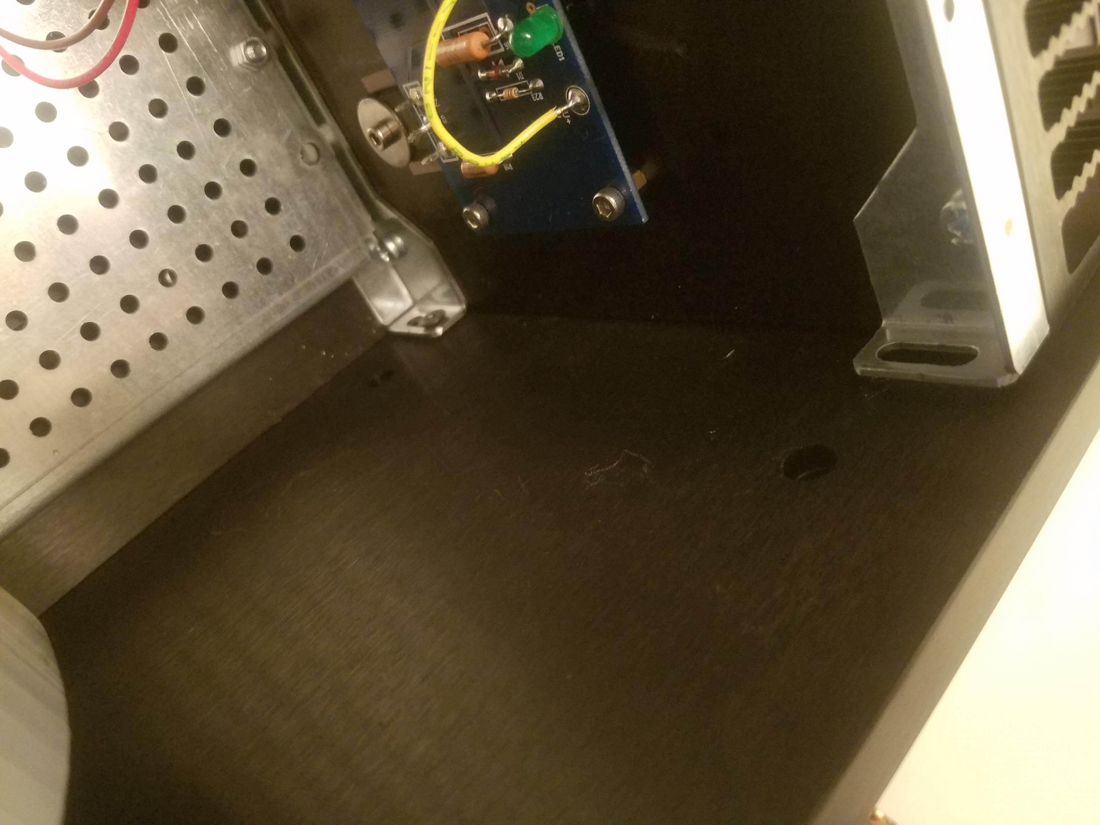

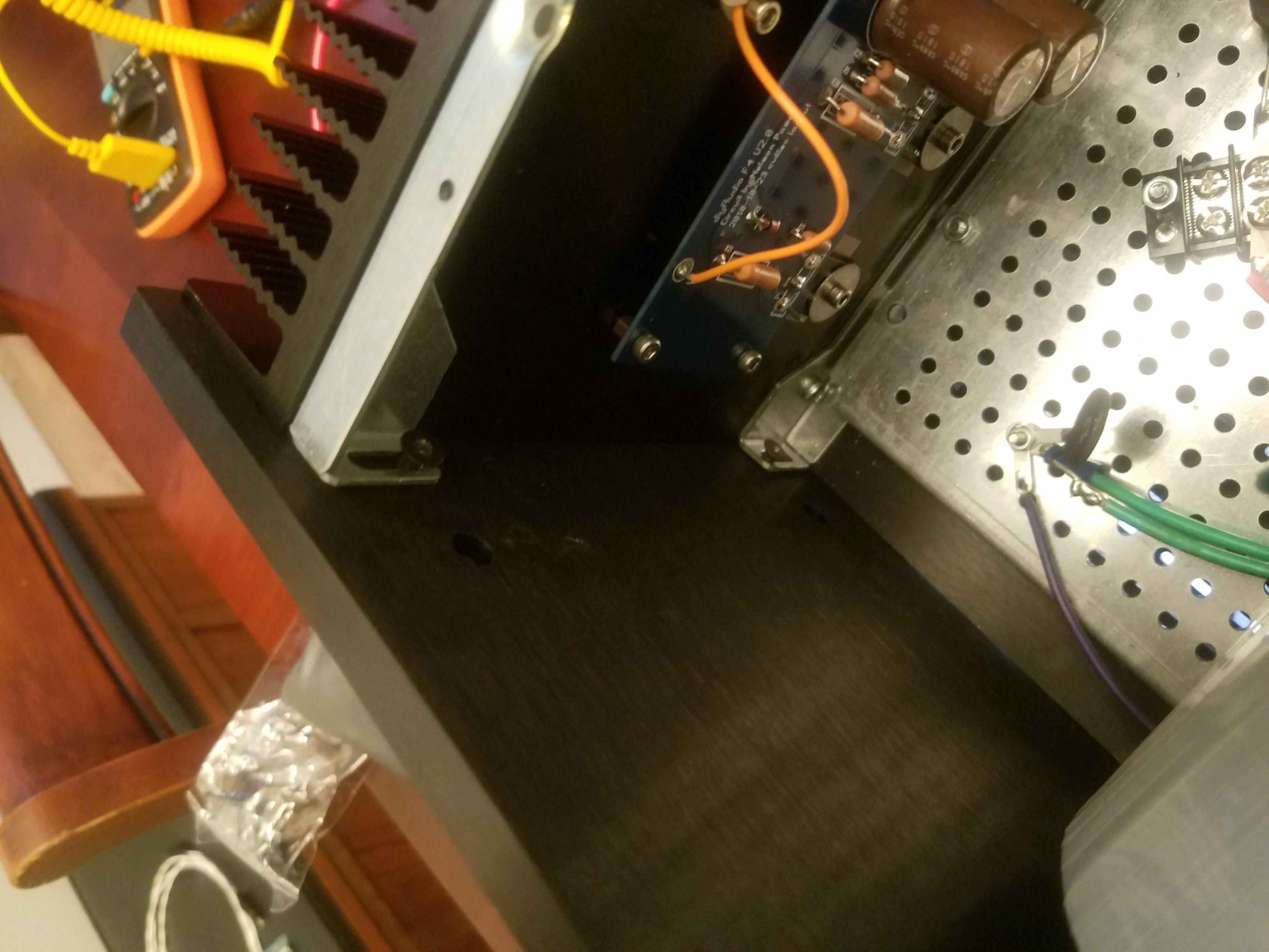

Any tips for how to remove stripped screws?
My front face plate screw holes didn't quite line up, resulting in lots of anger and two stripped screws I can't get out. Ended up only getting a single screw flush and couldn't even get the fourth in there at all. I jammed some felt pads in the gaps so the face plate doesn't rattle too much...
Otherwise, got everything biased up (to .280) and am ready to go. Just have to open up my SET amps and make sure I know which speaker terminal is grounded. Later tonight or tomorrow...
Those are the wrong screws for the faceplate. You should use the silver panhead screws. You can see them in the pictures I posted previously. If the holes aren't lined up you should loosen the bolts attaching the bottom plate so that the heat sinks can be moved in or out until the holes line up. Once the screws for the faceplate are snug you can then tighten the bottom plate back up. For squaring everything up, I find it easiest to attached everything loosely, stand the amp up on its faceplate, aligned the heatsinks evenly on each side of the faceplate and then tighten everything up.
To get the screws out you can use a small pair of vice grips and lock them tight on the screw head. Threads on the faceplate will probably be stripped now but you can use a tap set (available at Home Depot, etc.) to clean them up. Just don't tighten the screws too much after doing that as the threads will be weaker.
With probably less than 1/4th of a rotation per turn, the vice grips were a slow go, but effective. After loosening everything I was pretty much able to get the front on. Had to use one metal screw so it could work itself in at an angle.

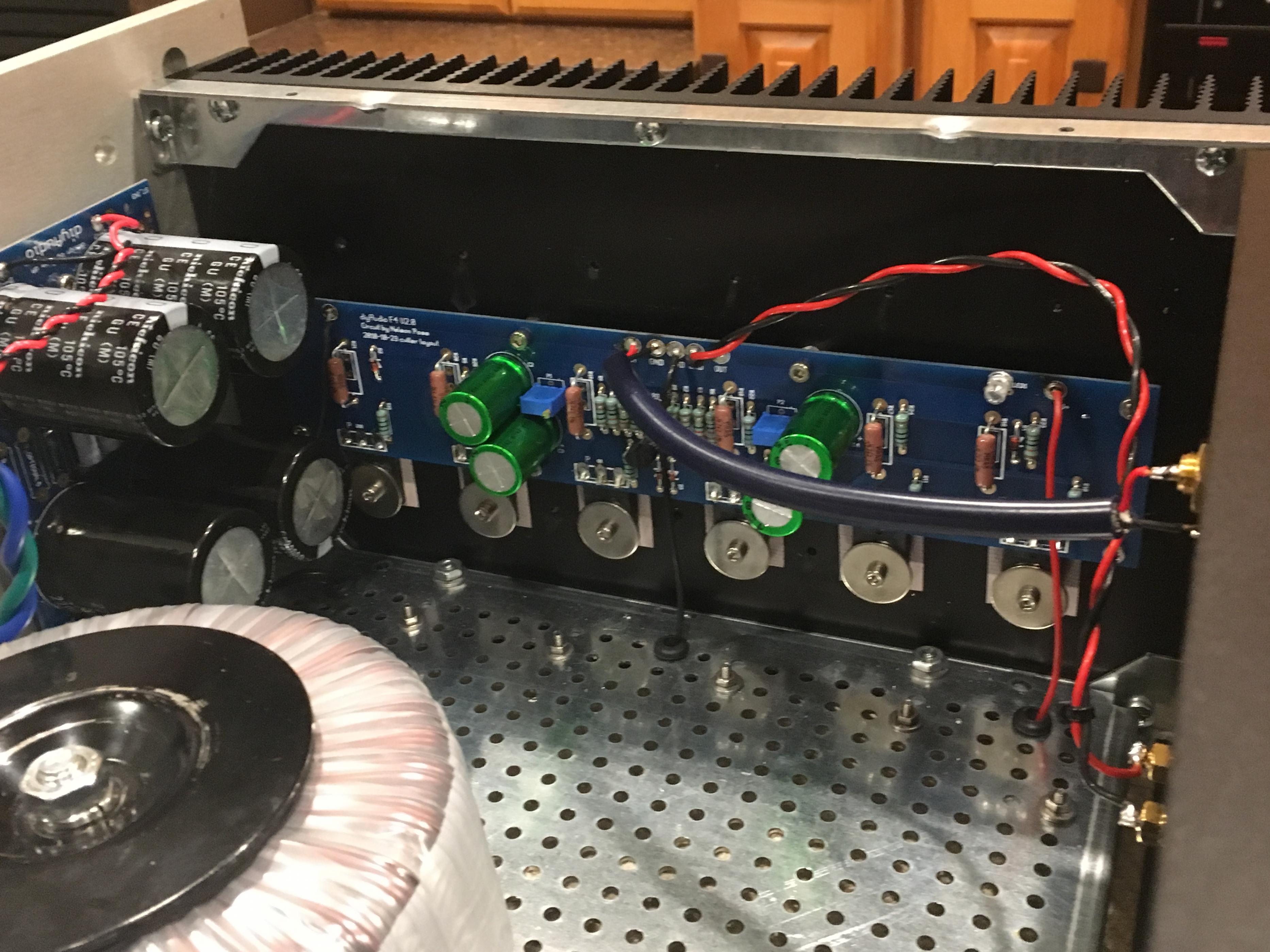

Got everything hooked up and am just slowly bringing it up to temp to check the bias again. Tried each channel on a test speaker yesterday and am about to give it a go on the real system...
