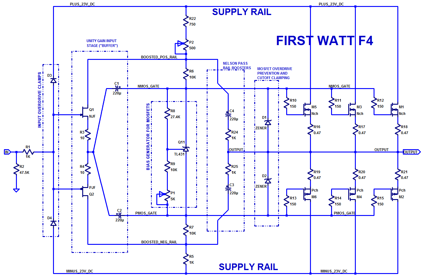

It helped me understand the F4 circuit design better, after I drew the schematic diagram all spread apart, as shown below. In case it helps other members, here you go.
Nelson uses rail boosters in several of his amplifiers, including the "A20" Class-A DIY amplifier, published in 1974 (!). He seems to like them.
Please remember that this amplifier was designed by initials N.P. and not by initials M.J. If you want to ask "why did you do X rather than Y?" be sure to address your question to the correct person.

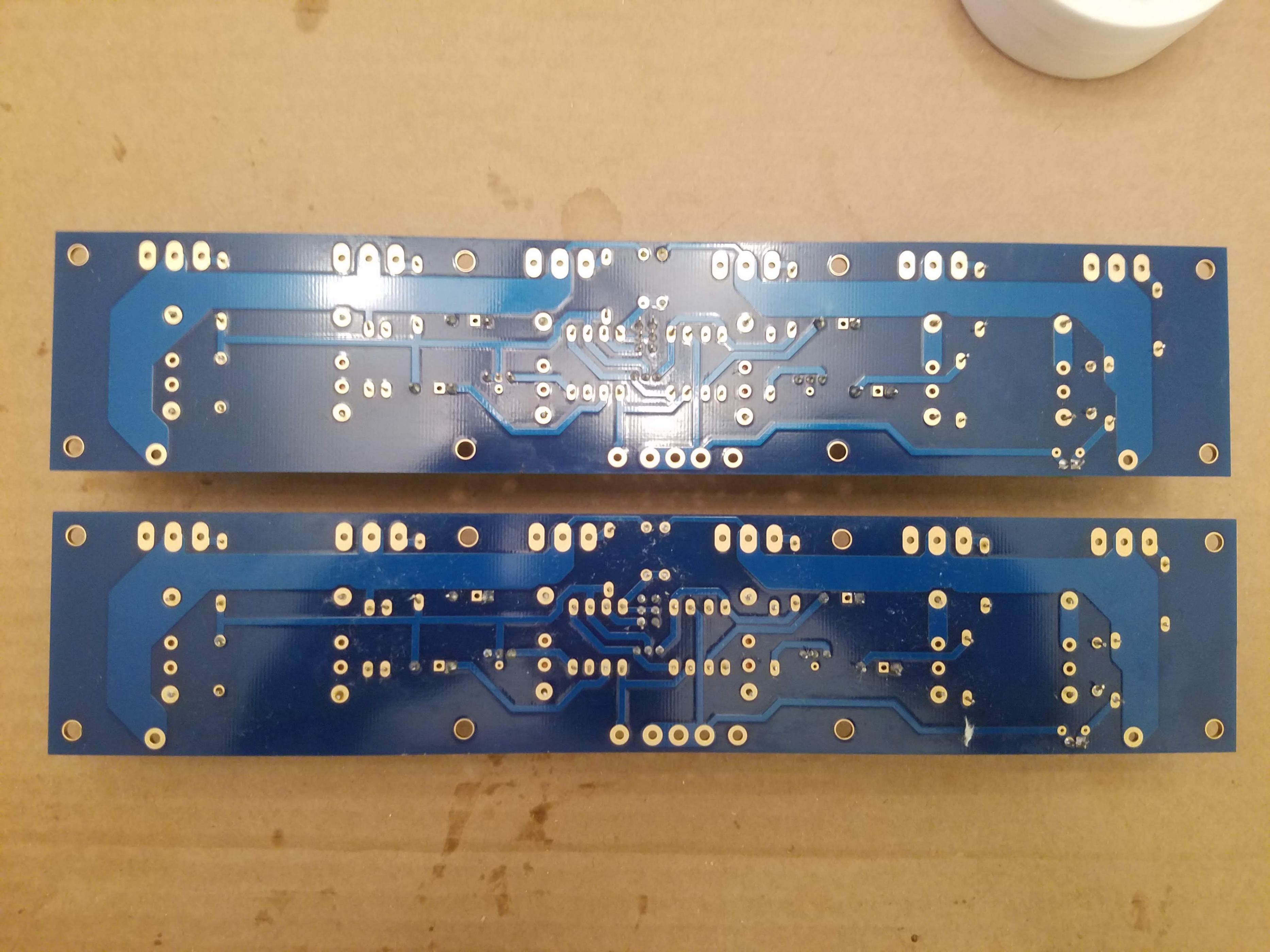

Alweit is a good seller and I doubt thats the issue. I'd really like to see some good photos of the back of the PCB.
Should I be soldering both sides of the PCB??
There's not really much happening back there because I soldered everything on top except the caps, the variable resisistors, the JFETS, and the shunt regulator...
