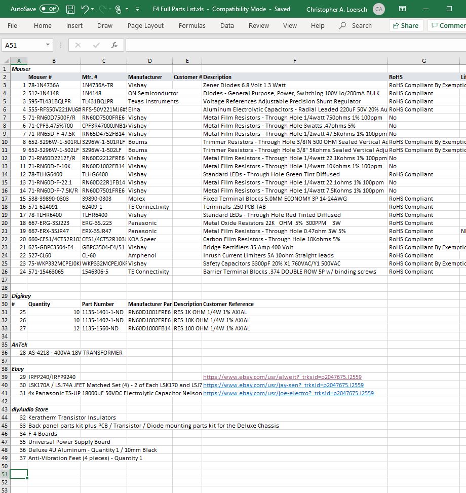

F4 Full BOM
Just purchased the parts for my second F4 & thought I'd post my full BOM in case it helps future builders...
Happy to send the excel spreadsheet too, just PM me.
  • F4 BOM.pdf

Also, had one error in my bom, a set of rn65 resistors snuck in there. Once it's all built and I'm sure there aren't any other ingredients missing, I'll repost the corrected bom.

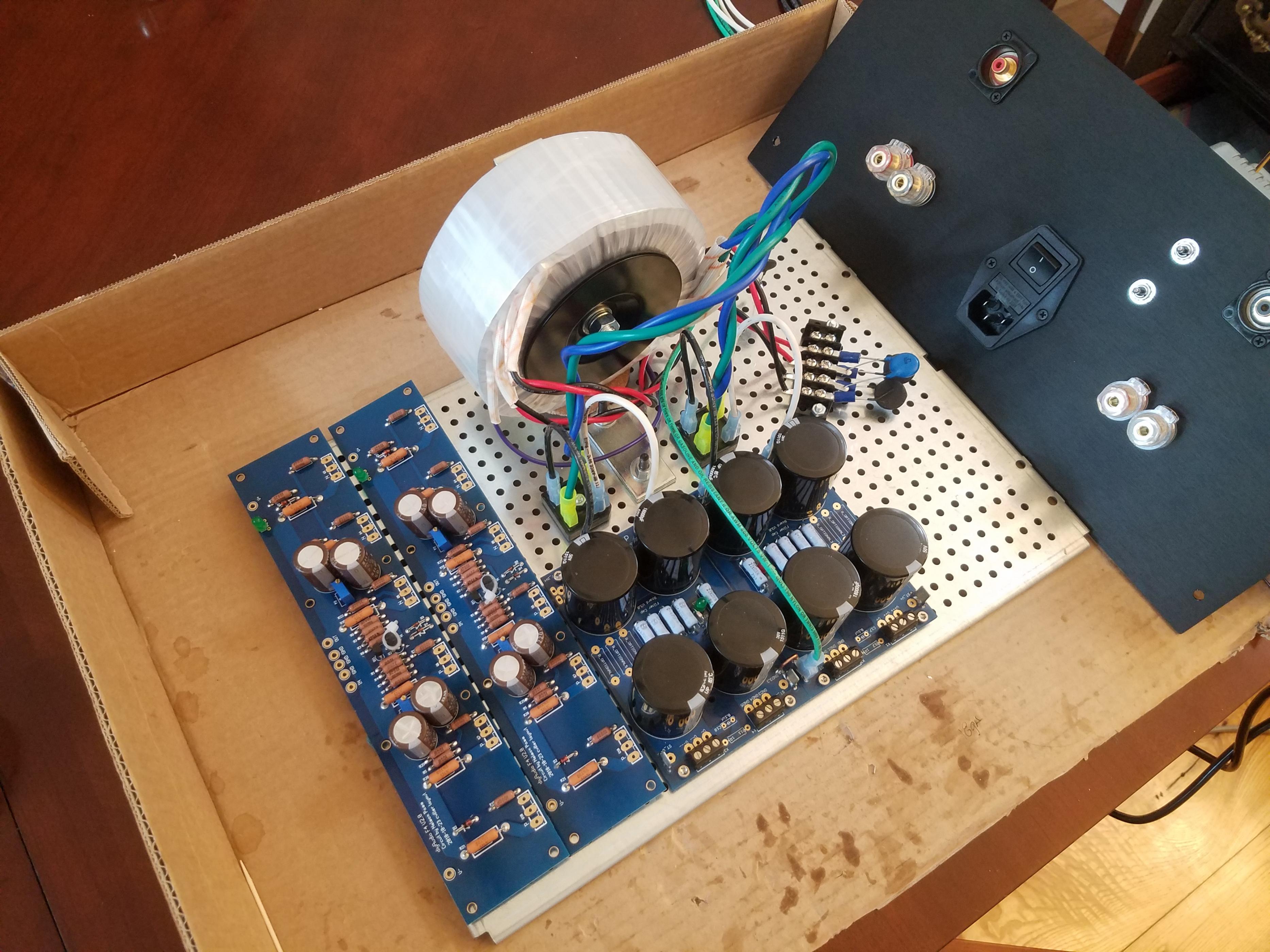

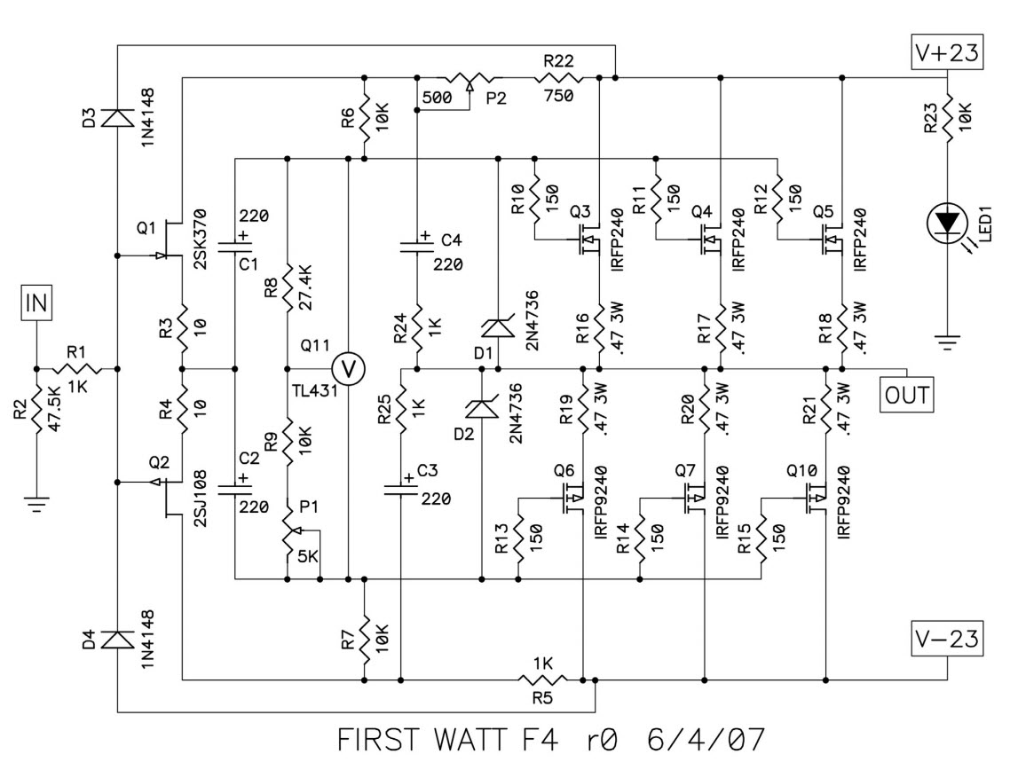

Just purchased a couple tubes of IRFP9140 and IRFP140 MOSFETs.
Need to match them. This instructional article says to bias to .2V across the MOSFET source resistor.
Is the actual parallel Source resistance actually .235 Ohm?
What's the actual current each mosfet sees?
What's the total bias for a push-pull F4 channel?

there is a whole different world out there ..... on FIRST WATT
always go there for first hand info ...... this here is still second hand one
(second) edit: now I see that Store pcb is having paralleled 0R47 resistors in sources , though - if you observe pcbs , having two on each position (in schematic) is "just" to place two different footprints ...... practically and physically - you still are going to populate just one 0R47 in each source
so , everything applies from my previous post
Joined 2000
Ok. The boards I have do use axial or radial, but not both.
Just thought maybe it was an after thought and the .47 ohm resistors needed to be paralleled.
I'm going to match at 24v .5A. That sound like a plan?
Would running the test for 30 minutes be too long or too short to get Vds?
Would like for the heat sink to warm up to operational temp. Maybe 1 hour is better.
