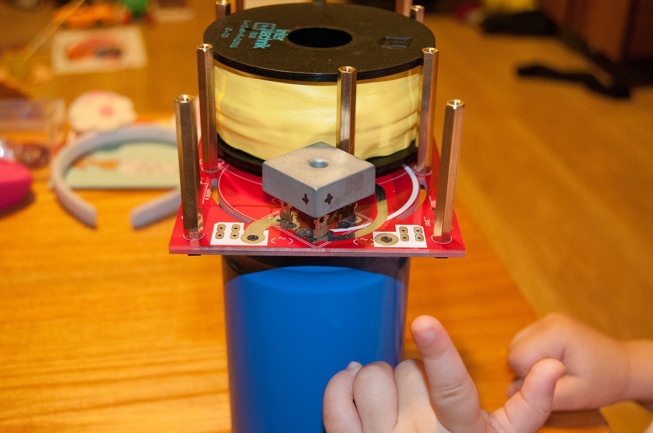

Anyone knows or measured the heat dissipated by the rectifiers ?
Do they really need sinking to case like Zen nicely did in his "papas koan" superb build?
I ask because i can solder them directly on the rectifier circuit board, but in this case they will "float"
BUT
if they heat up under the full load i can do extensions and mount them on the underlying steel case.
But i cant see much benefit on mounting them on steel or even painted steel.
Anyway I guess my question narrows down to : how much will a rectifier dissipate under 10 A load if it is rated @50A and drops 1.1V?
Sinking it onto the painted steel bottom case even enough (considering i have 2 of them)? I must be missing something. (happened before :))
rectifier on the loose
So they will go like this :)

they drop 1.1V so ... no
but why:
P=VI so dissipates 1.1*10 ~11w
so no... i'm an idiot after 12AM
count on , say, 1V3 of voltage drop .... or something like that
dissipation is indeed VI , in case of dual mono PSU you'll have one Iq for I , but in case of shared PSU between channels , that's 2x Iq
so , for latter - 1V3x (say) 2x 1A6=4.16W
and I know for sure that they tend to go Dodo , in shared PSU , inside of an A class amp case , when dangling on the base plate
