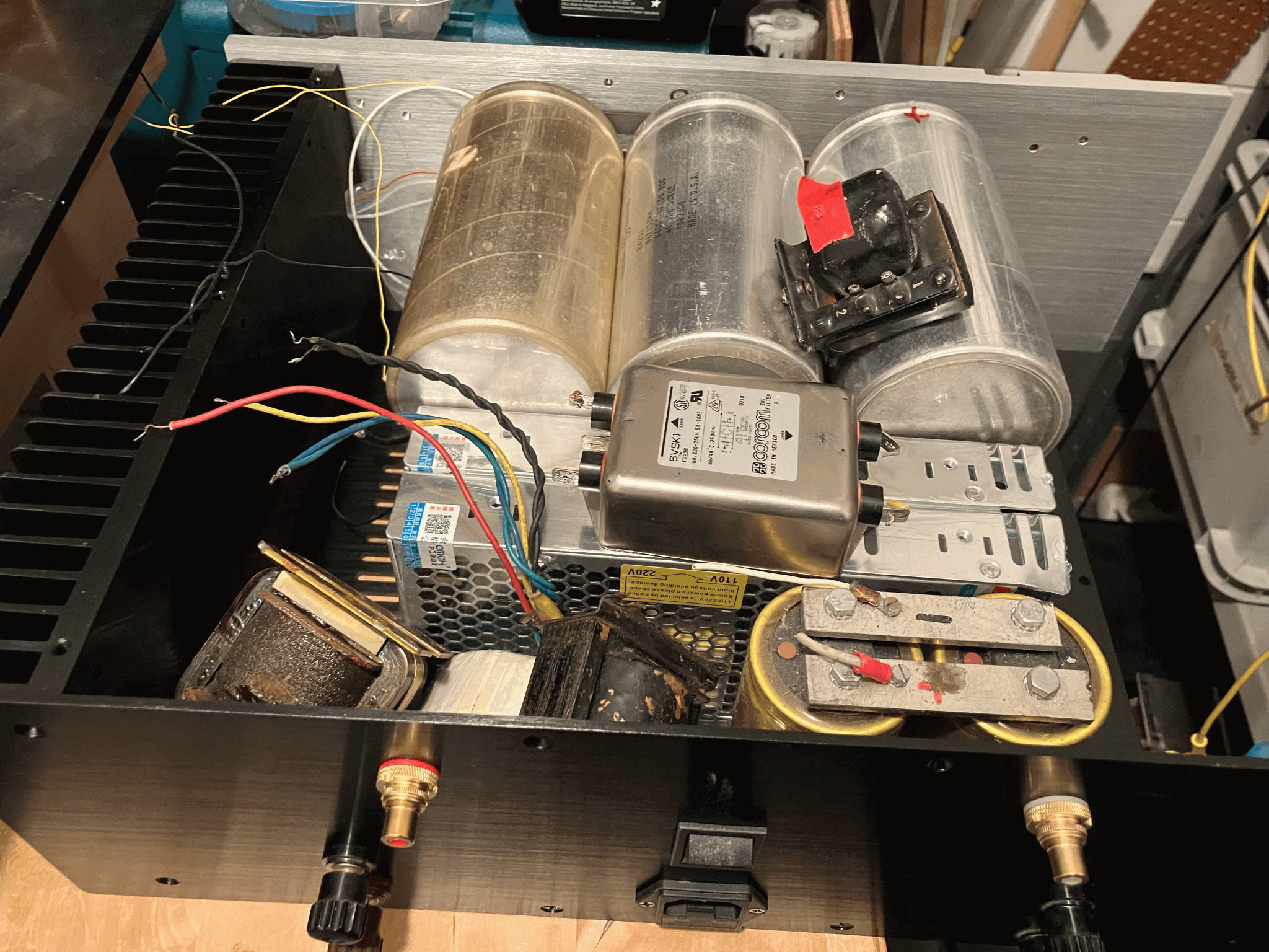

Yes, I am using a fairly large CRC supply with (8) 33,000 uF caps. I’ve also used CLC. Pretty beefy for a brute force analog supply.

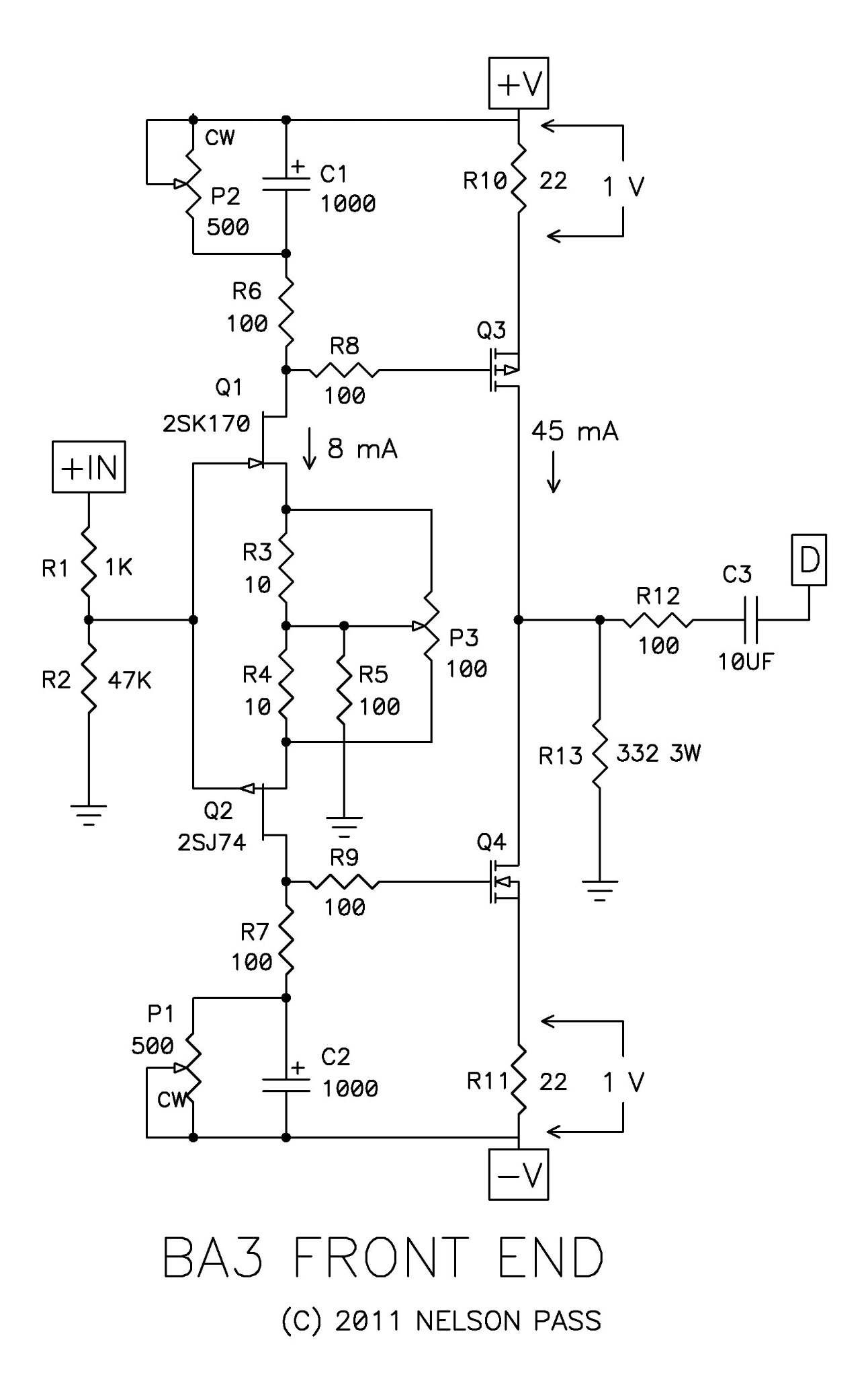

I put a scope differentially across the jfet drains and indeed see the power supply ripple (~4mv) at idle as expected. DC voltage about 27 from drain to drain. All as expected. With music playing the power supply noise signal becomes mixed with audio signal as expected with the passive mixer of bias and bootstrap signals. Ideally for lowest distortion and noise from a source follower circuit I’d like to see constant voltage gate to drain. I tried adding a 100 uF cap jfet drain to drain and it worked well. The drain to drain DC voltage stayed fairly constant even with the amp driven hard. I could no longer see any ripple voltage drain to drain with my oscilloscope. I don’t have any great tools to measure PSRR or distortion to verify any signal improvements, but from a jfet power supply noise perspective this looks like an improvement. Super easy to implement without removing boards, just tack solder cap from top of R6 to top of R7.

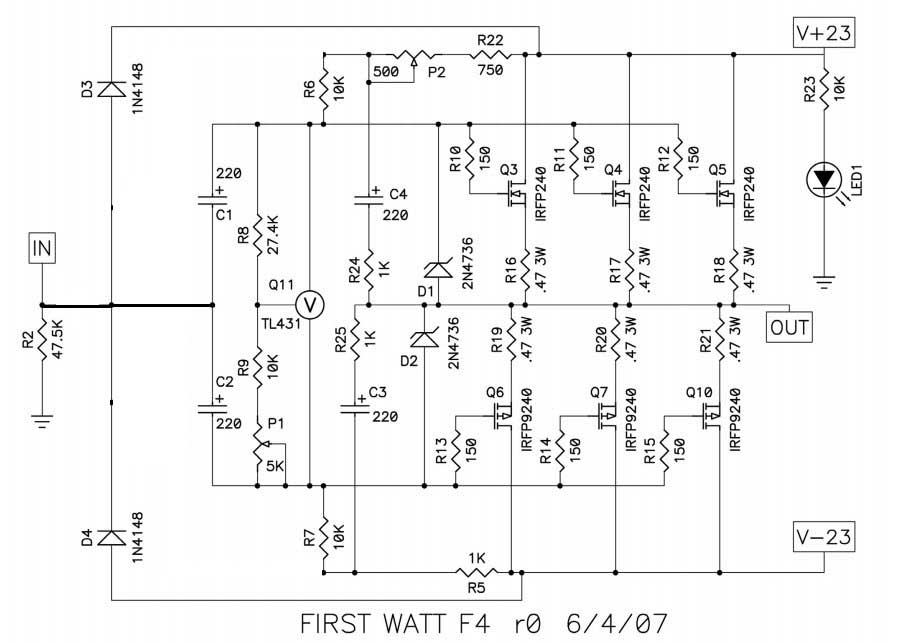

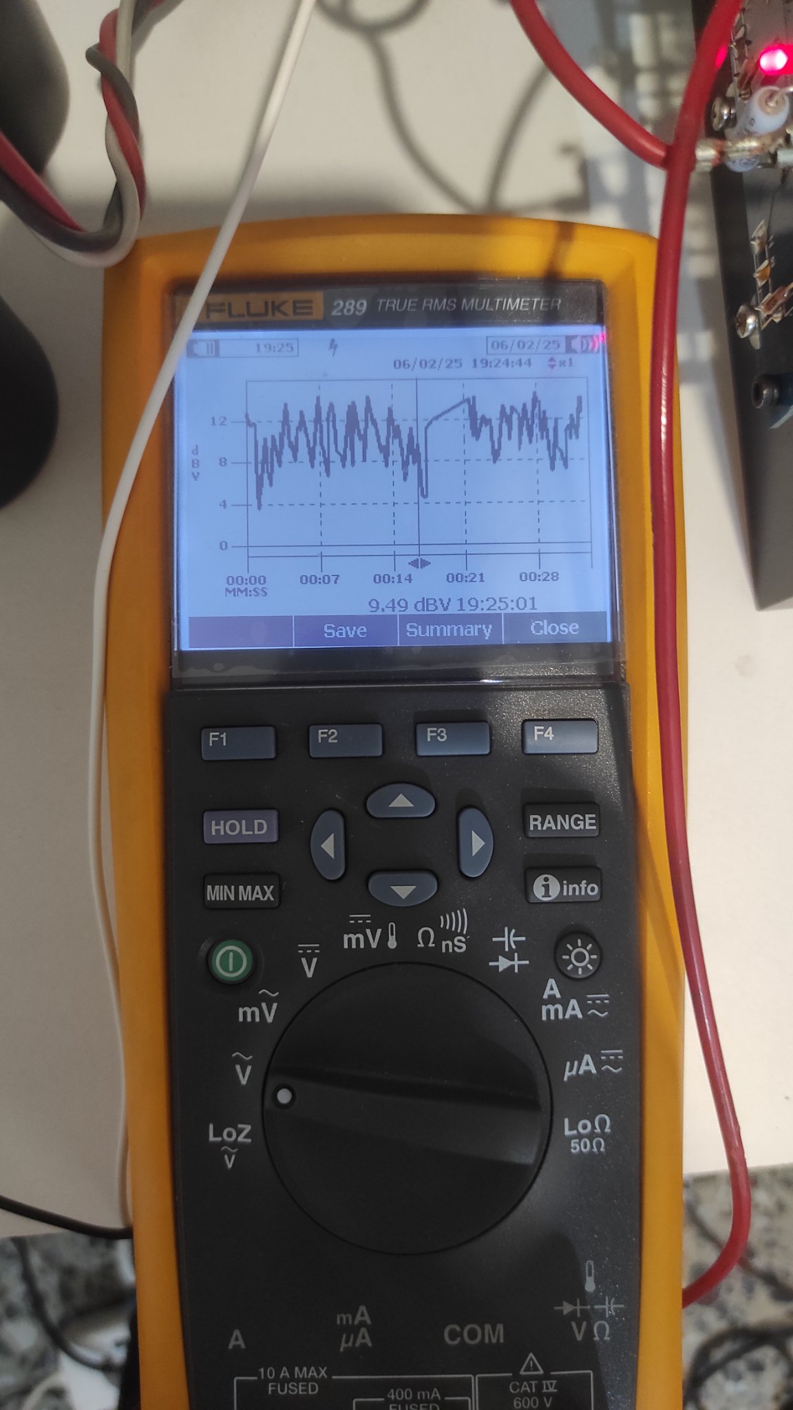

Just finished my F4 and everything went well with no magic smoke being released. Ran the amp at 130mV for about an hour with everything stable, bias and offset. When I tried bringing the amp up to 200mV I could only reach 170mV. This is the same on both the left and right. The power supplies are dual mono and I’m using a 5U 500mm chassis.
I’m thinking that I need to lower the resistance on R9 from 10k ohms to 5k ohms by paralleling another 10k resistor across R9. Please let me know if I have this fix incorrect.
so, yes, proper thinking
though, take care to dial trimpot all the other way (adding its 5K) before powering up, so you'll practically have same Iq as when amp was powered off
Reactions: BRN
I paralleled R9 with another 10k resistor and the lowest I can get the bias is 200mV at startup and after an hour it settles at 229mV. This is in both channels. I could change R9 to a higher value but with all the cooling I have with heat sinks I’m not going to change R9. I may even increase bias to 300mV and call it done.
